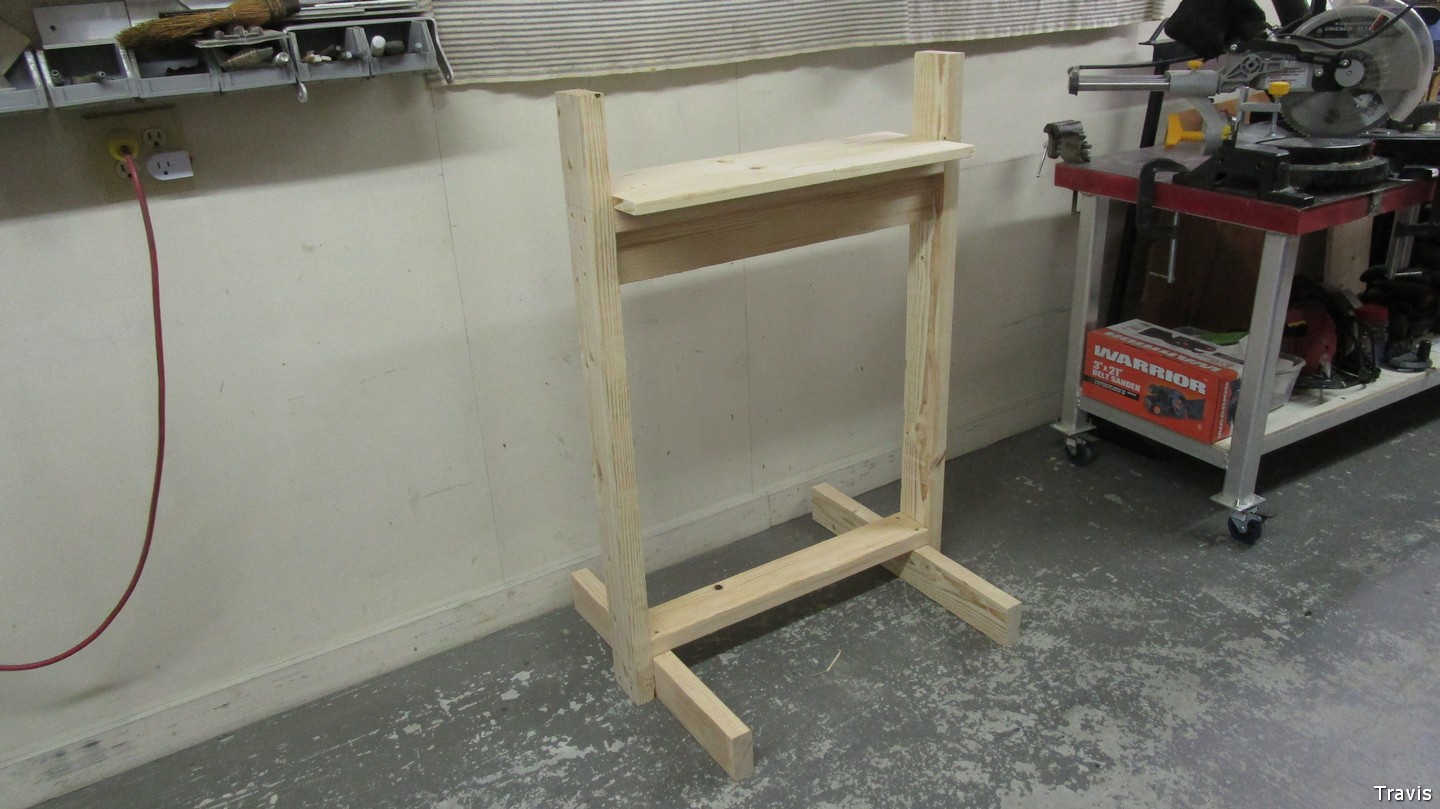

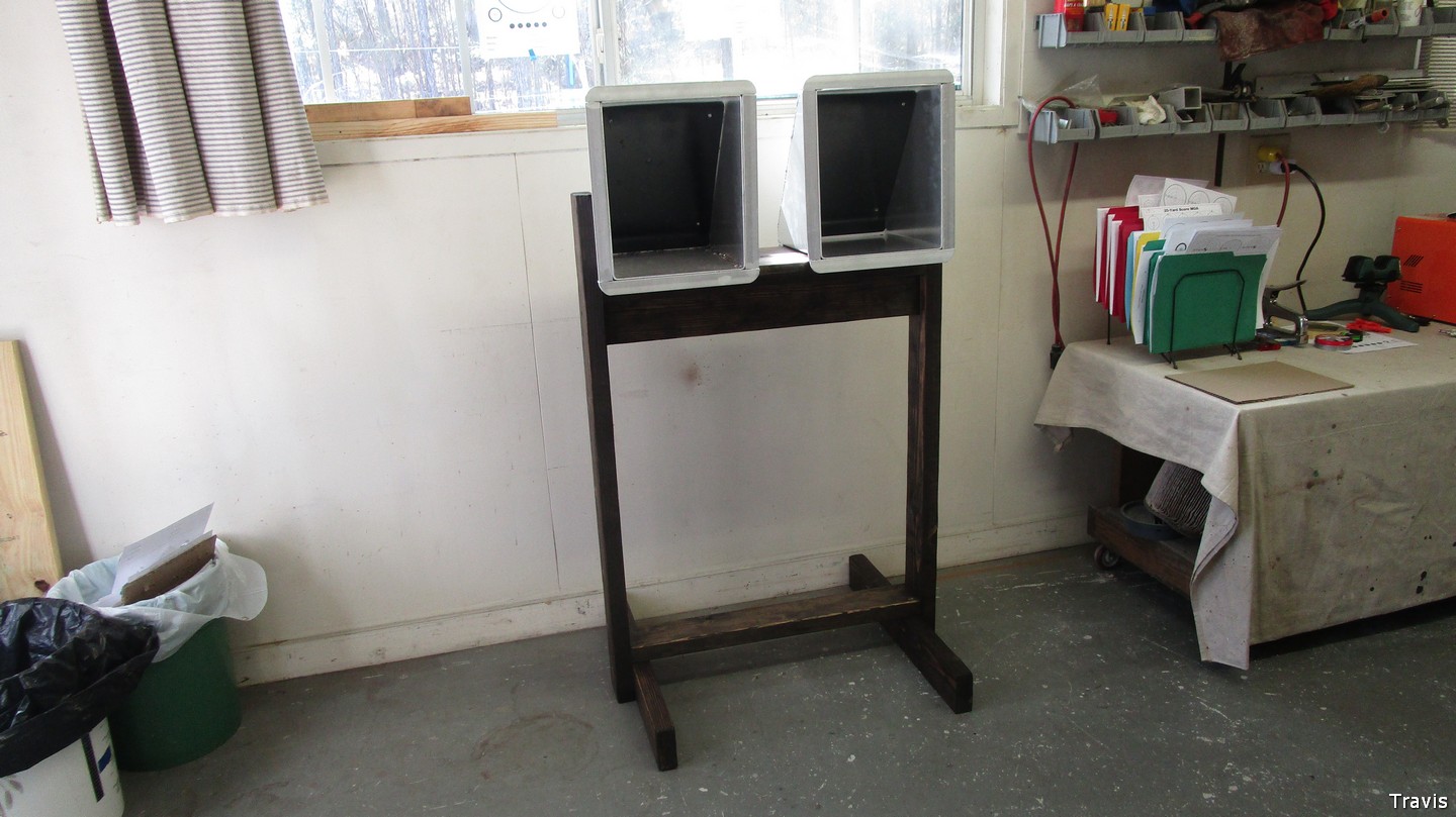

Hello everyone,
I have had several people ask me what stand I have the Big Bang Pellet Traps sitting on. Here are couple of photos showing the stand that I made using 2x4 lumber and one piece of 1x10 lumber. I used decking screws to put it all together and applied a coat of stain. It is very simple to build and designed to hold two Traps, it could be “cut down” in width for just one Trap. It is light weight making it really easy for me to move around to shoot at different distances.

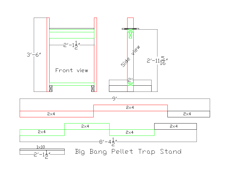

Update: By request, I just added a png file showing the drawing for construction and the material required. As you can see I color coded the individual parts and pieces for assembly. Hope this will help.

That's a nice straight knot free looking 2x4 :)

OR, one could simply buy several traps to place at different distances. Options are always available.
