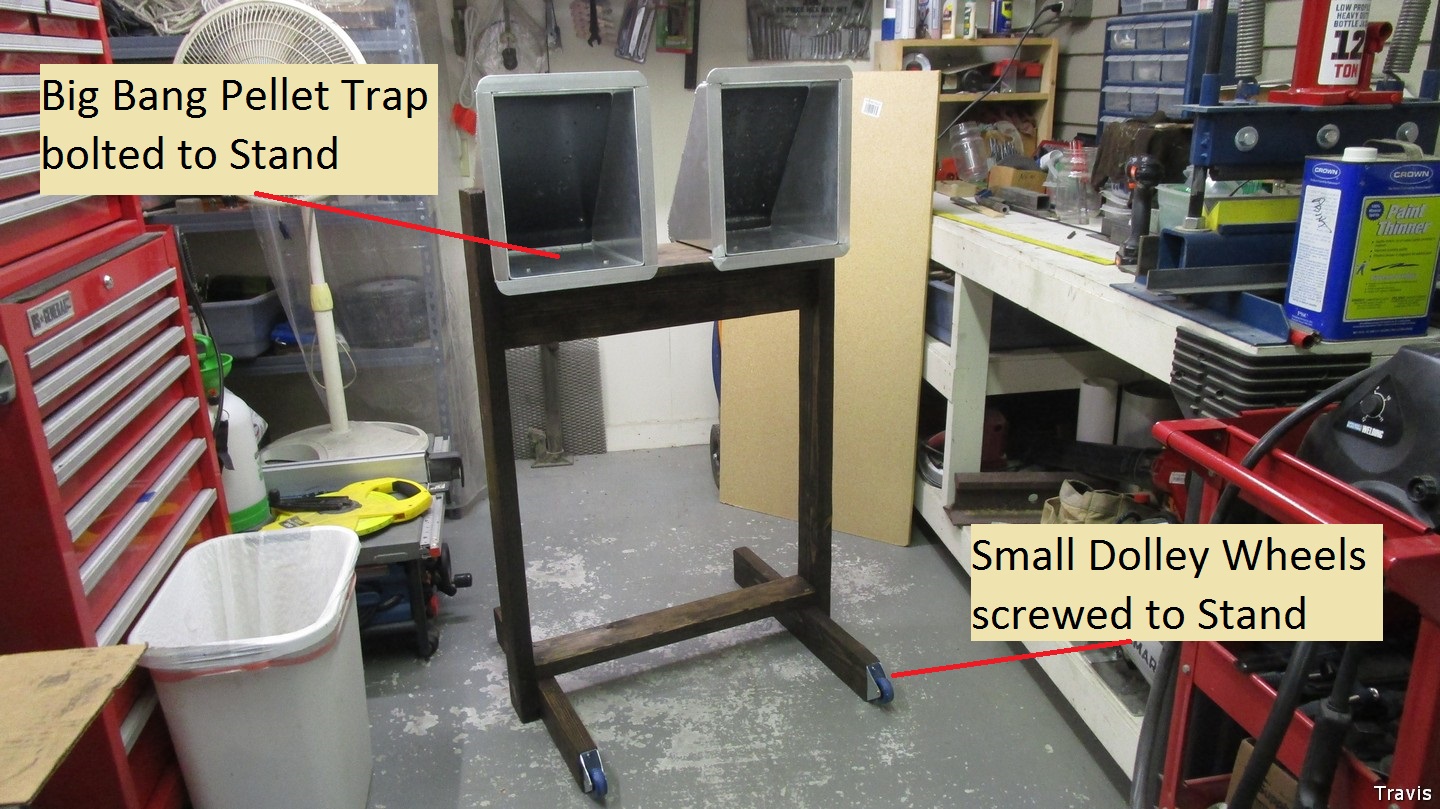

Hello @jccams
Glad to hear you are getting some shooting time on your BBPT. I have now gone over 3,000 pellets shot at my number one BBPT and close to 200 on my number two BBPT. With the weather so nice now I am moving both traps outside to shoot 10-meter targets. I drilled two holes in the bottom of each trap and bolted them down to the wood stand. Then I added a set of caster wheels to the stand and now the whole assembly is mobile.
ThomasT

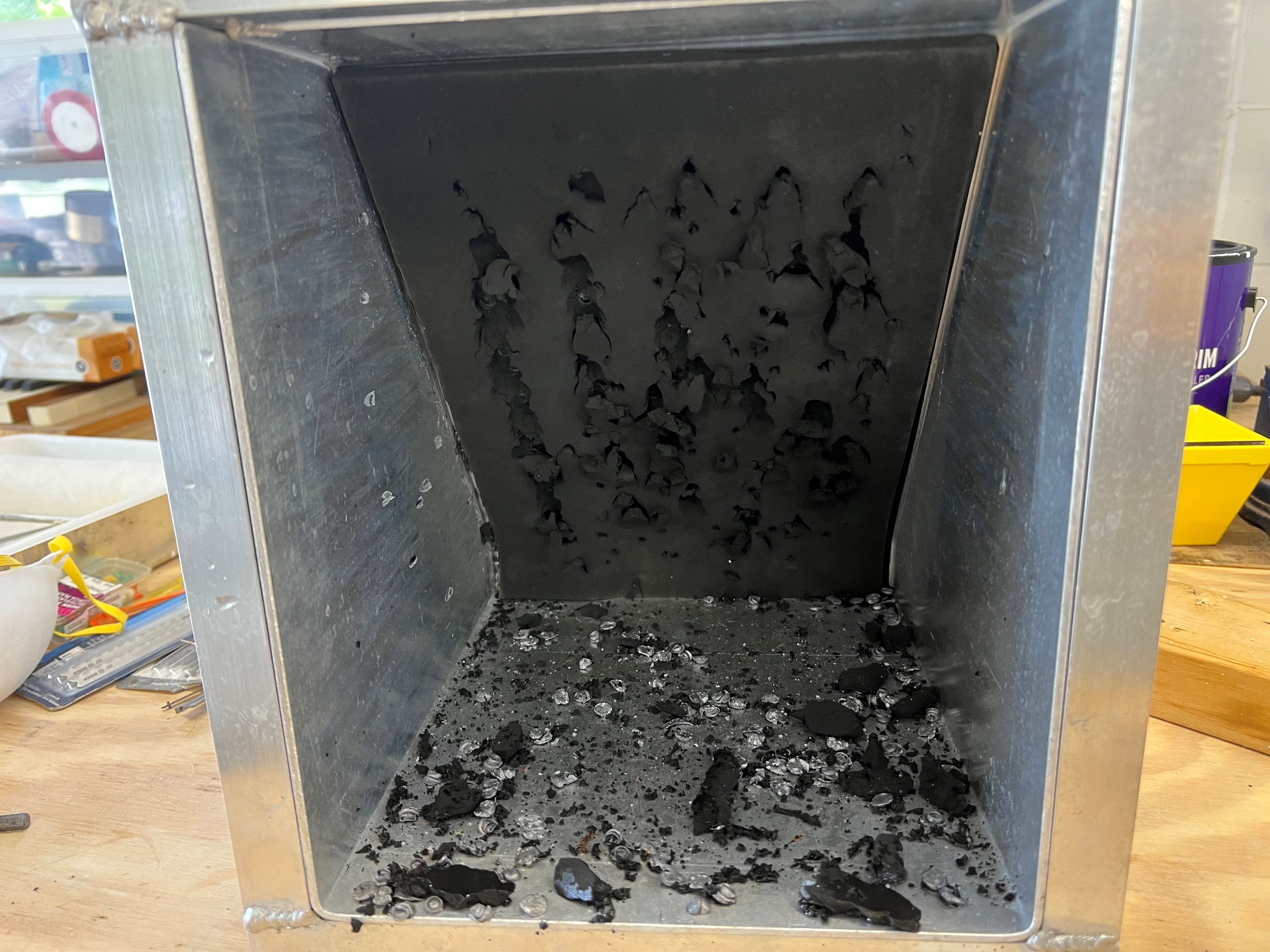

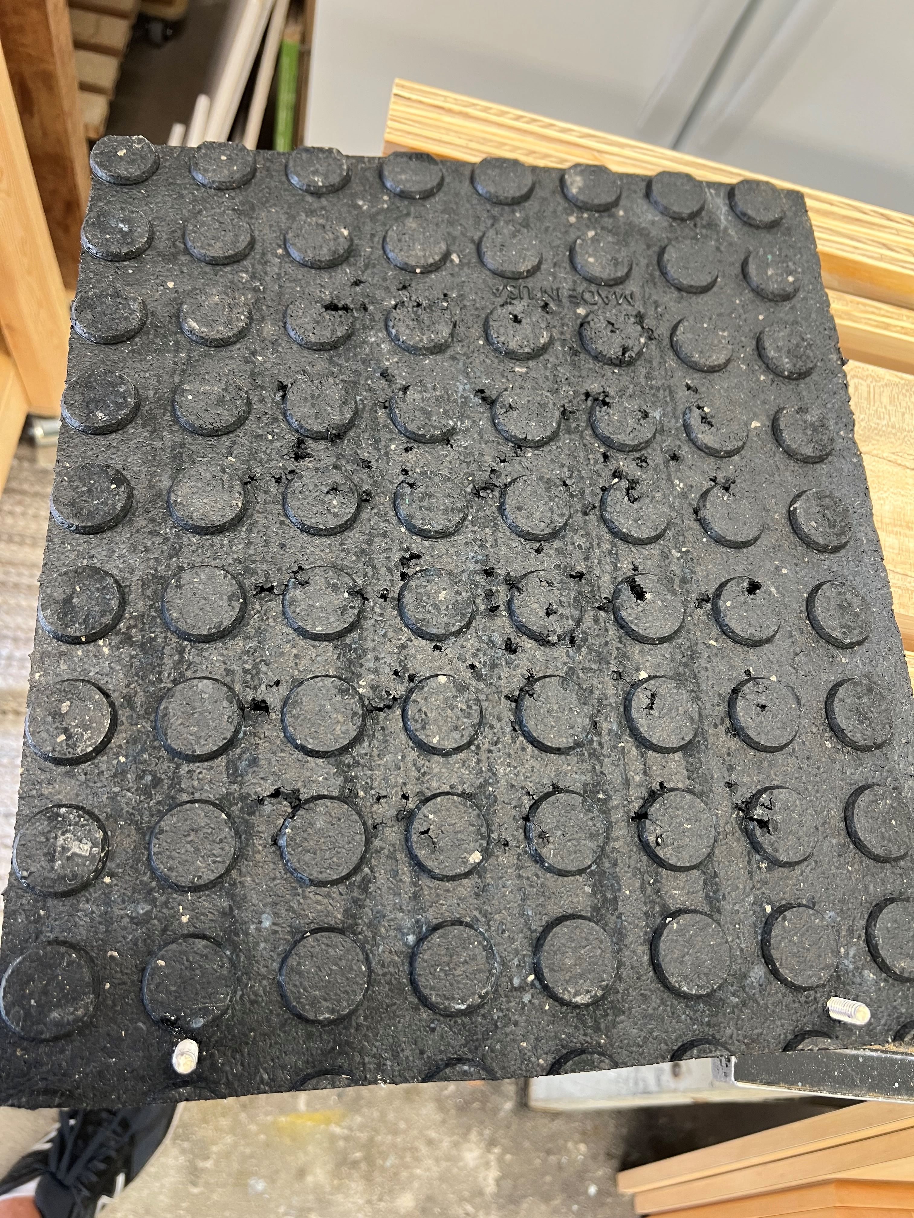

That's exactly what I did. Got some 1/4" thick self adhesive rubber from Amazon, stuck it on the face of the steel sheet. So that with the 3/4" horse stall mat material hanging in front makes it pretty quiet, and easy to collect spent pellets. You still hear the paper being punched but that's not very loud.

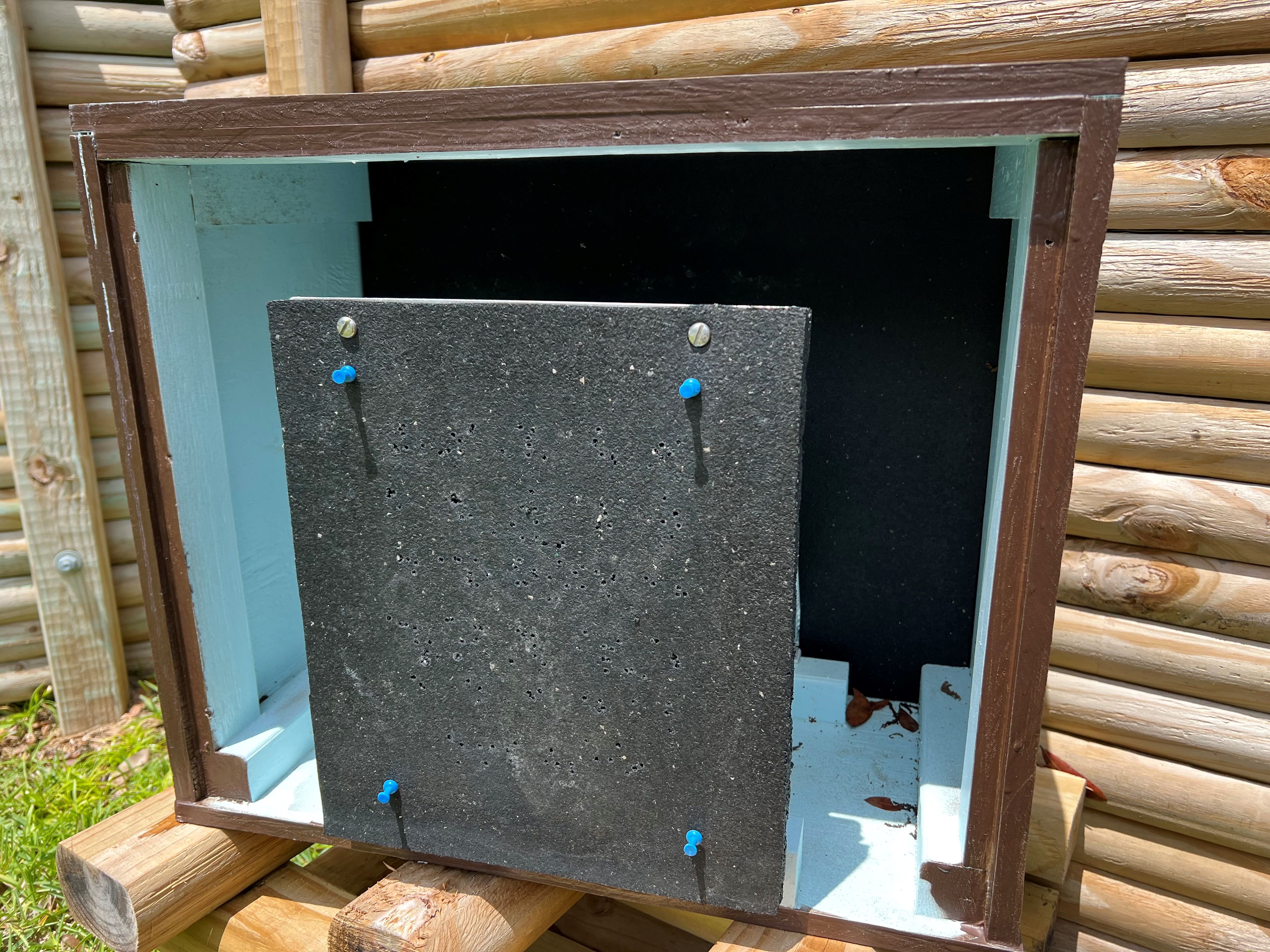

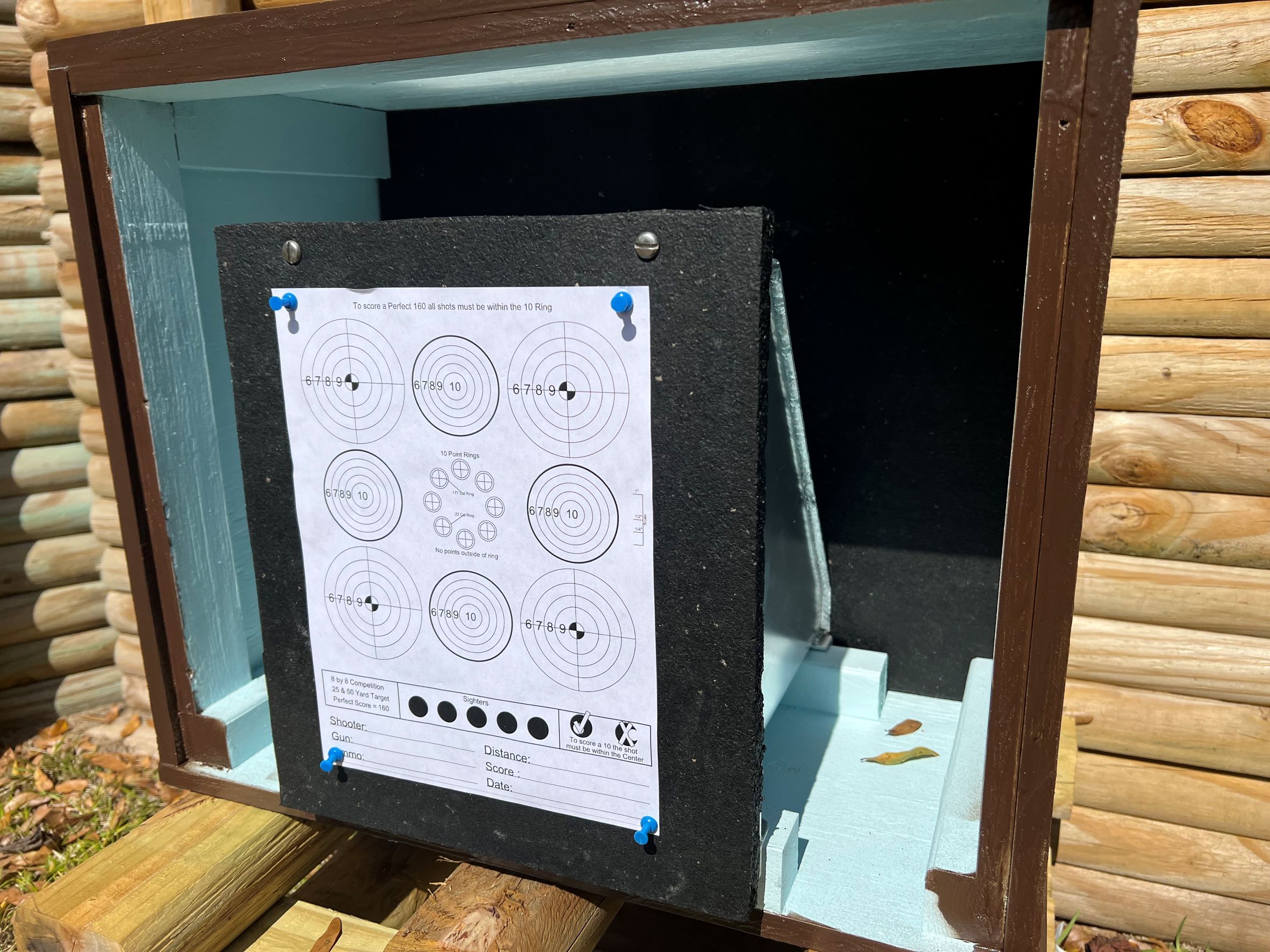

Here are some pics of my current set up. The 3/4" horse mat works great on the front for knocking off a bit of velocity and for sound. The 1/4" neoprene self-adhesive material I put on the steel sheet isn't holding up well at all. Probably around 100 pellets in it and it's falling apart. It's not dense enough.
No complaints from neighbors on sound so far, so I'll just keep it as it is.
I put a pic of the inside face of the horse stall mat and it is holding up good. This pellet trap is easy as crap to clean out too. I recommend them if your looking for one.

Hello @kirkair
That mat looks like it is holding up really well and I still like you blue paint job (y)
ThomasT
