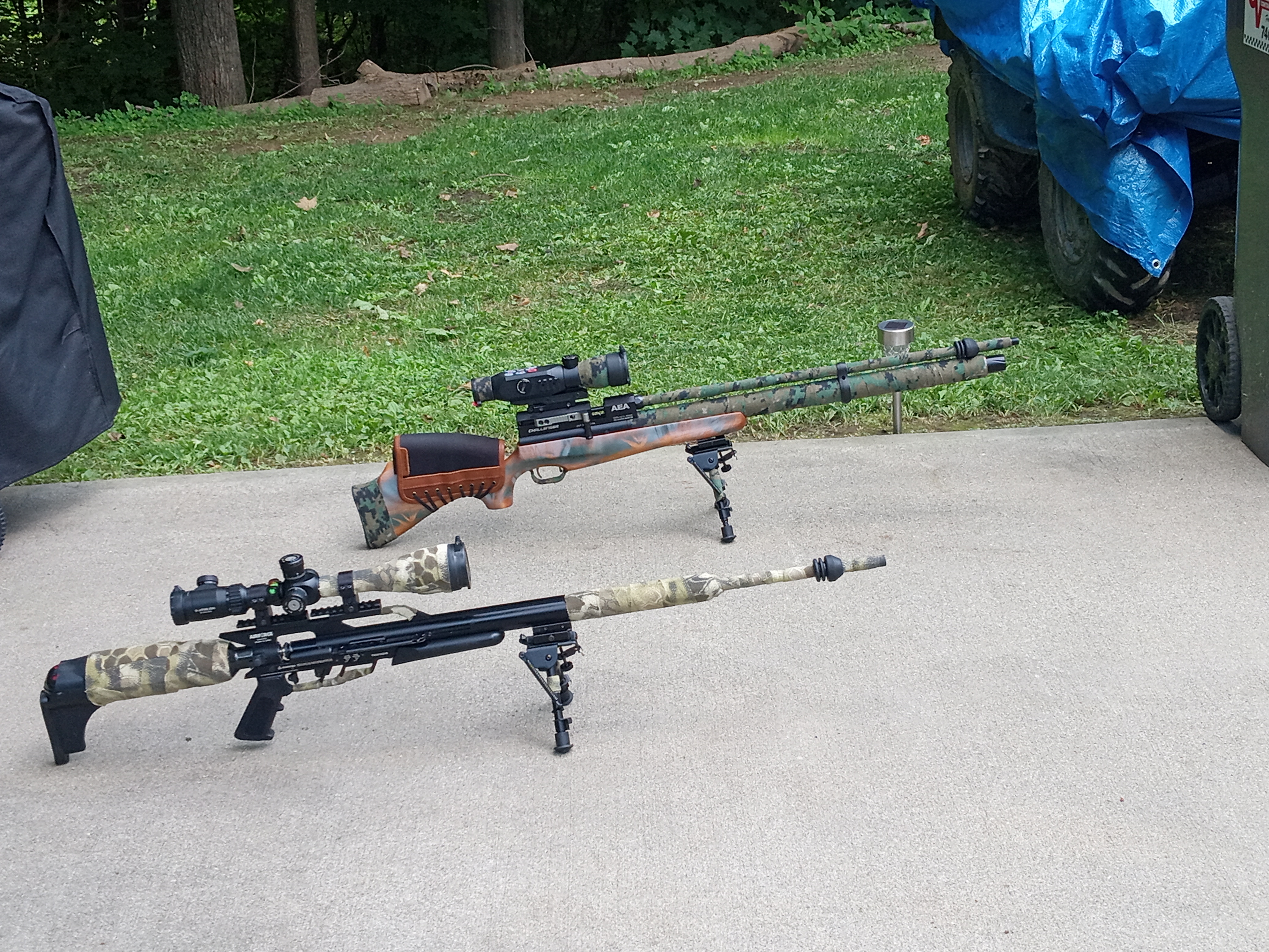

Don't take this the wrong way, but you want a lot of performance with a lot of limitations. 200 yard accuracy, not a lot of money, don't like the aesthetics of the best long-range gun, no tether, and you don't cast your own slugs.
Without a doubt you're going to have compromise somewhere. I don't particularly like the look or feel of 'black' rifles, but I gave up some of the afore mentioned for performance, power and accuracy. I have a couple of Texans, and my .308 is my long-range gun. A .257 might be a better choice for what you want to do, but the .308 gets it done. I have had zero luck with over-the-counter slugs and have to cast my own. If you don't want to cast your own, I would suggest buying them from someone who does and that way you have the perfectly sized (.309) slugs.
An aftermarket stock is basically a requirement for accuracy.
I can't think of another big bore option that would cost less than $2k (with the add-ons needed) and still deliver on what you want it to do. In a nutshell, just get over it on the look and feel of the Texan and go with what's going to do the job. Eventually we all have to, lol. If there's a plus side, there's a ton of great info on how to get them to shoot straight.
