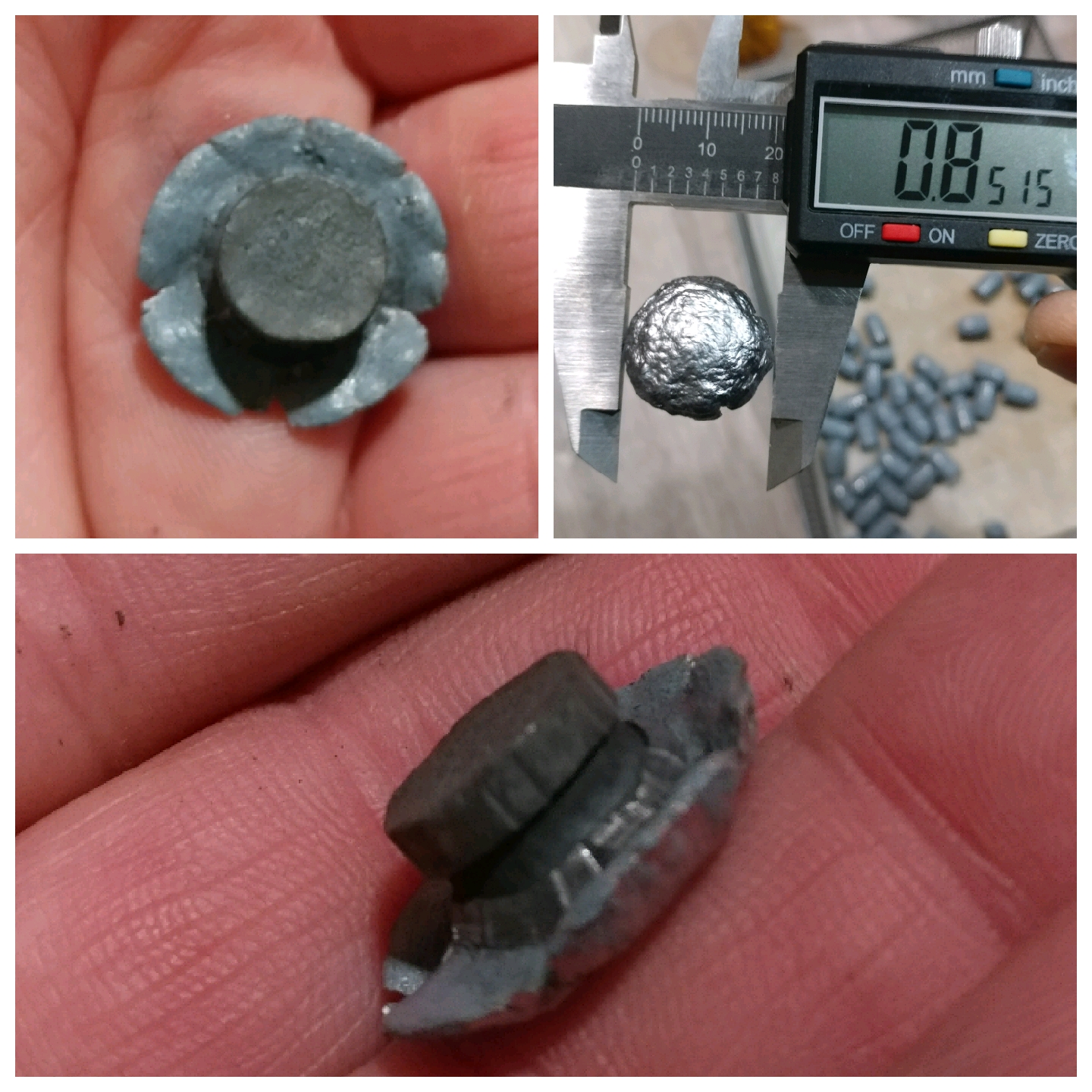

This is what you are wanting. I made 500 of these when I had surgery and was laid up. Noe mold big hollow point and 25 cal steel slingshot ammo to be cool I guess. I figured the steel ball would go.through the opposite side. They shoot the same as regular hollow points.. From having my noe mold with 3 different hollow point sizes they all shoot exactly the same. I cast for .510

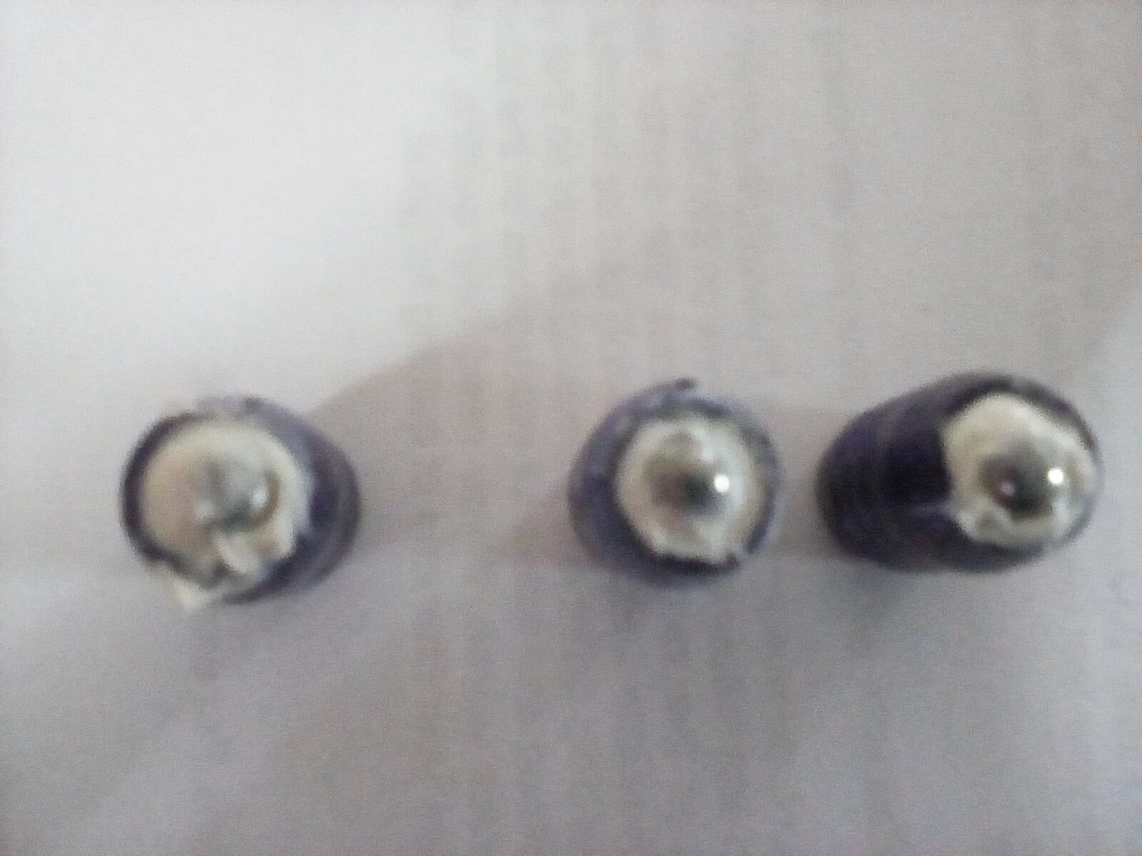

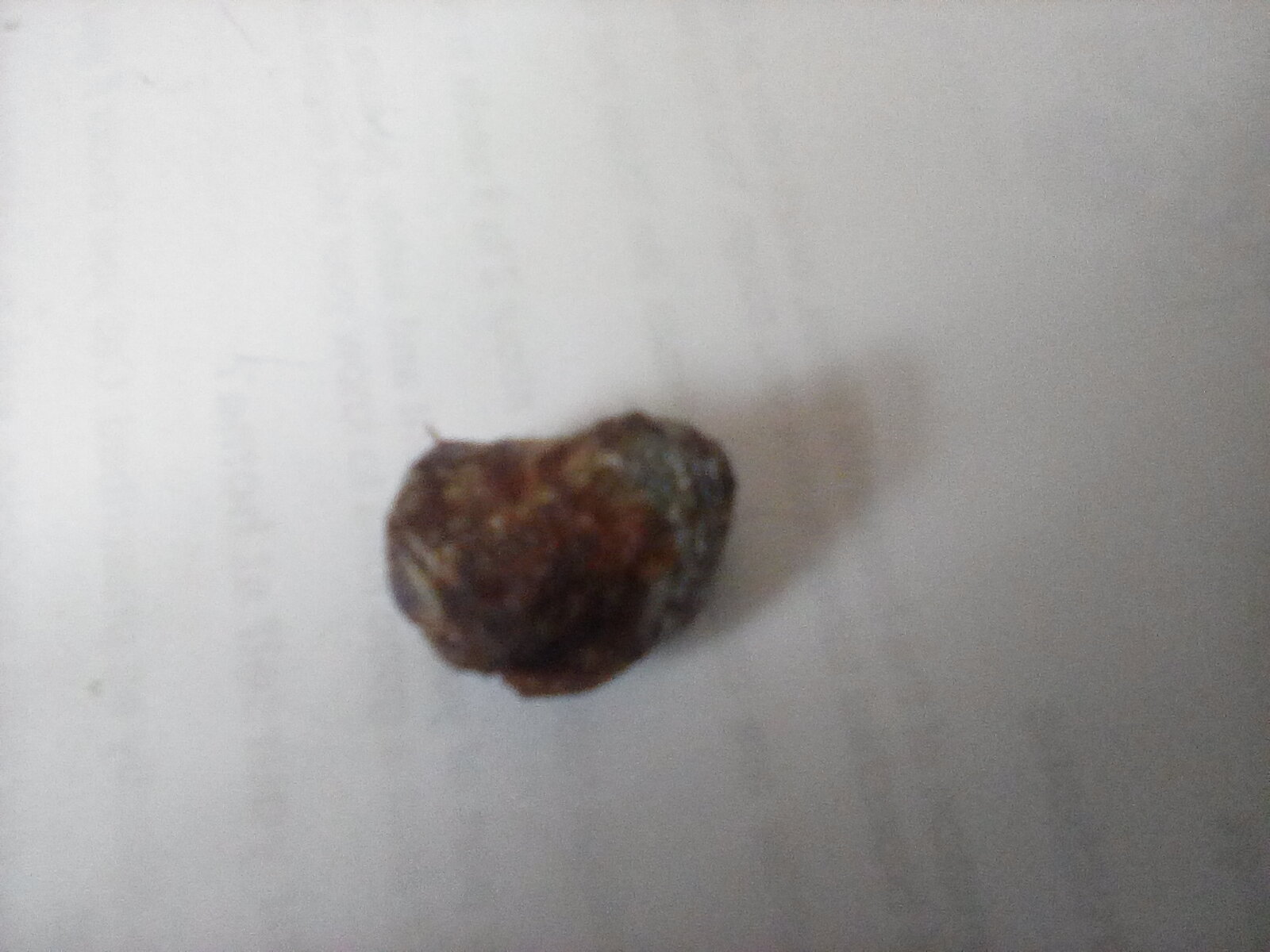

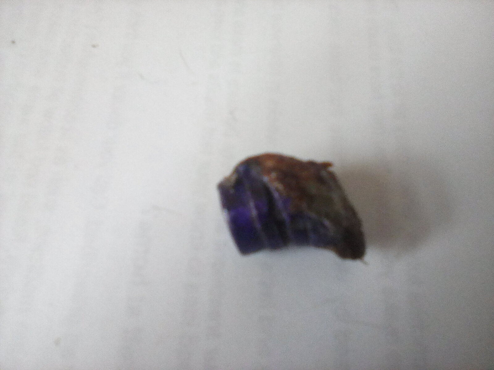

Two .510 slugs N.O.E molds. One 475 grain hollow points one 460 grain solid. Both neck shots... Both animals dropped at shot but didn't die requiring follow up shots.....being honest.... Velocity almost the same on both 840 fps 860 fps.
Since neither died on impact I don't see use in hollow points for big game. I think its mostly marketing.. Look at the pictures ..you decide
