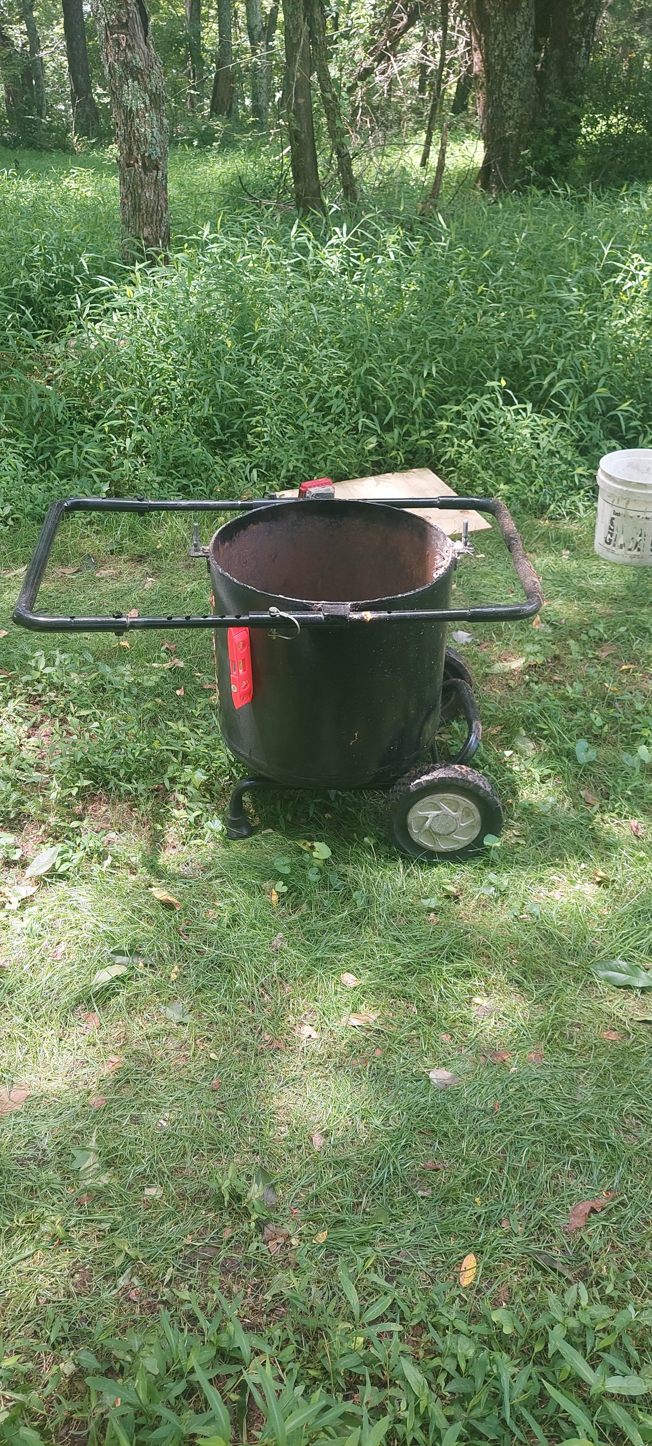

Haven't seen anyone mention making a lead trap target for their big bores. New to pcp's and casting, but I hate wasting money unnecessarily and lead cost money.
Got my idea off another forum for indoor pistol shooting. I wanted something mobile though.

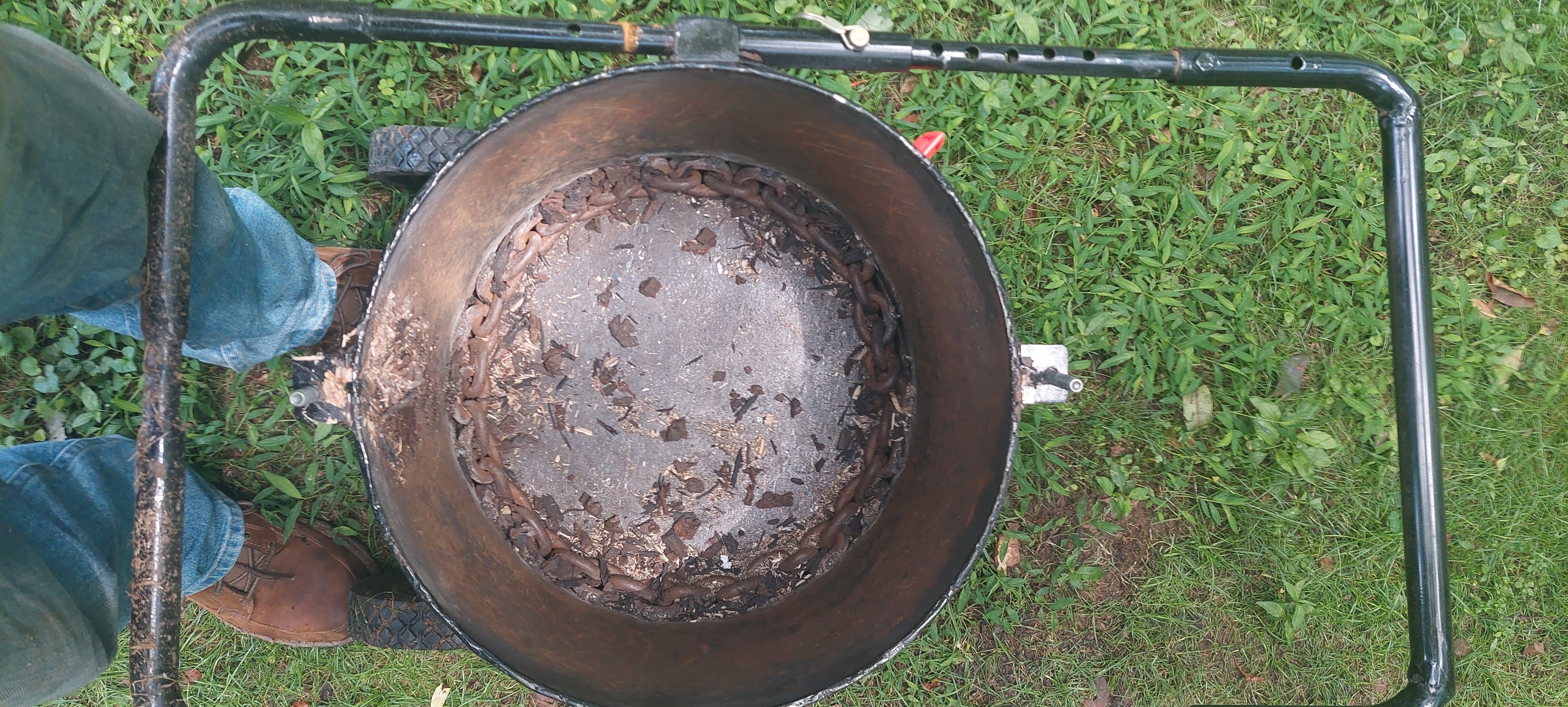

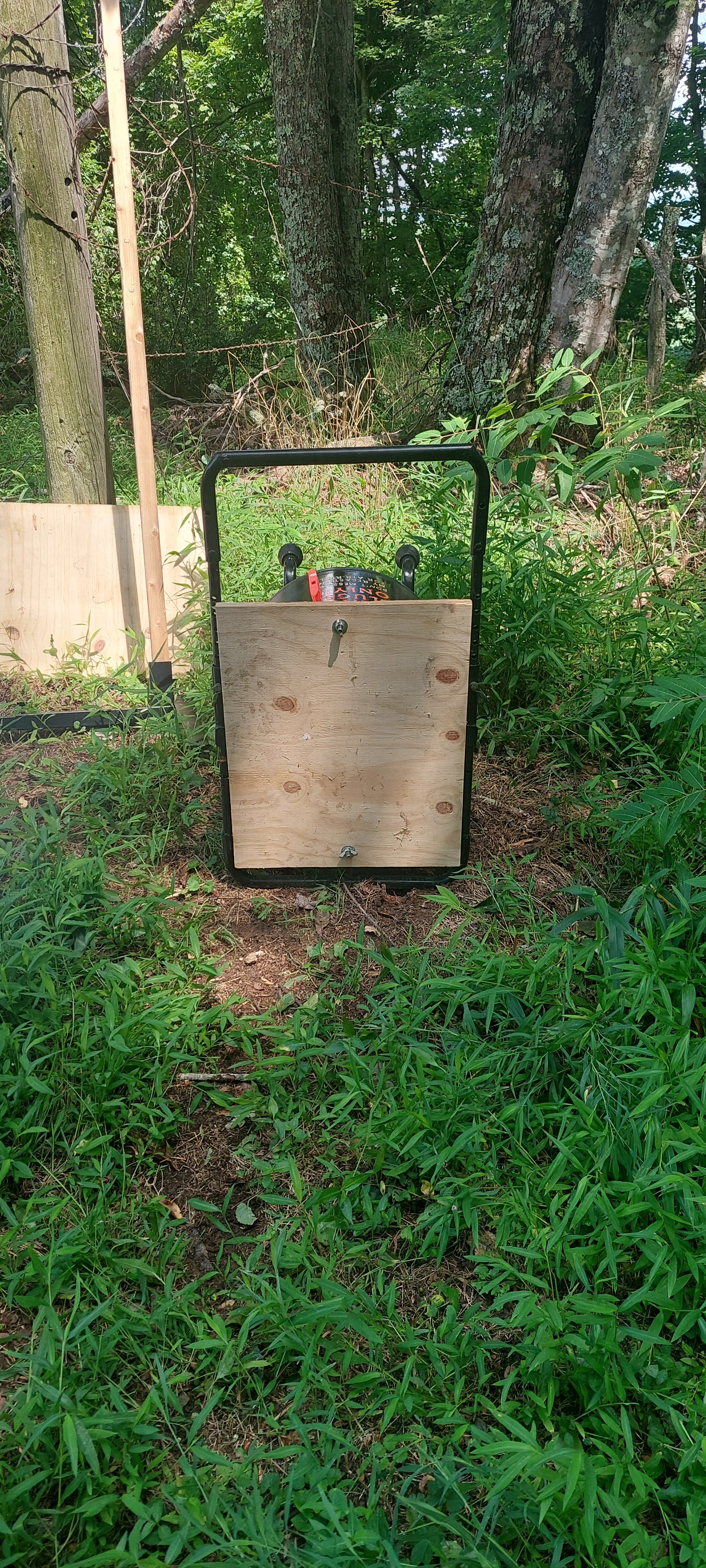

This has worked with no issues shooting my .457 Challenger Elite turned up to shoot 300gr slugs at 800fps/400fpe. Have yet to have a solid hit on the AR steel, even at 35yds.
Took an old 15gal compressor tank, cut it in half, welded cross brace at back/bottom seam and tacked 3/8 AR steel circle to that(chain around edge was because wasn't ordering a custom size and to keep mulch from fall behind it), then split the removed upper portion of tank and inserted to double the wall thickness, and filled with rubber mulch. Arm frame has space holes to allow for leveling adjustments for terrain, and for rolling to any yardage. This contraption is a bit on the heavy side though. (Materials estimate around $125 tops, mostly the AR plate.)
Target area is about 15" diameter and has about 11" of rubber mulch to the steel plate.

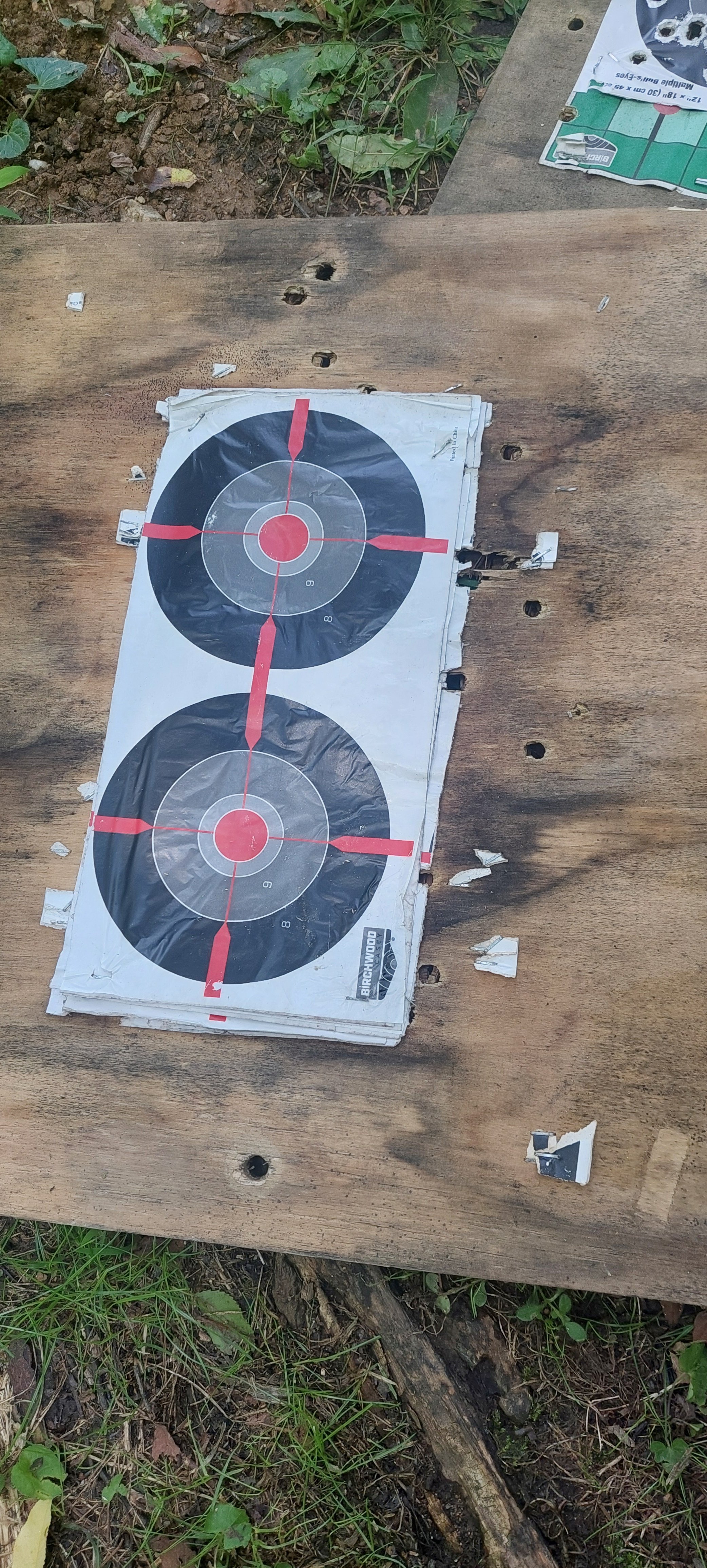

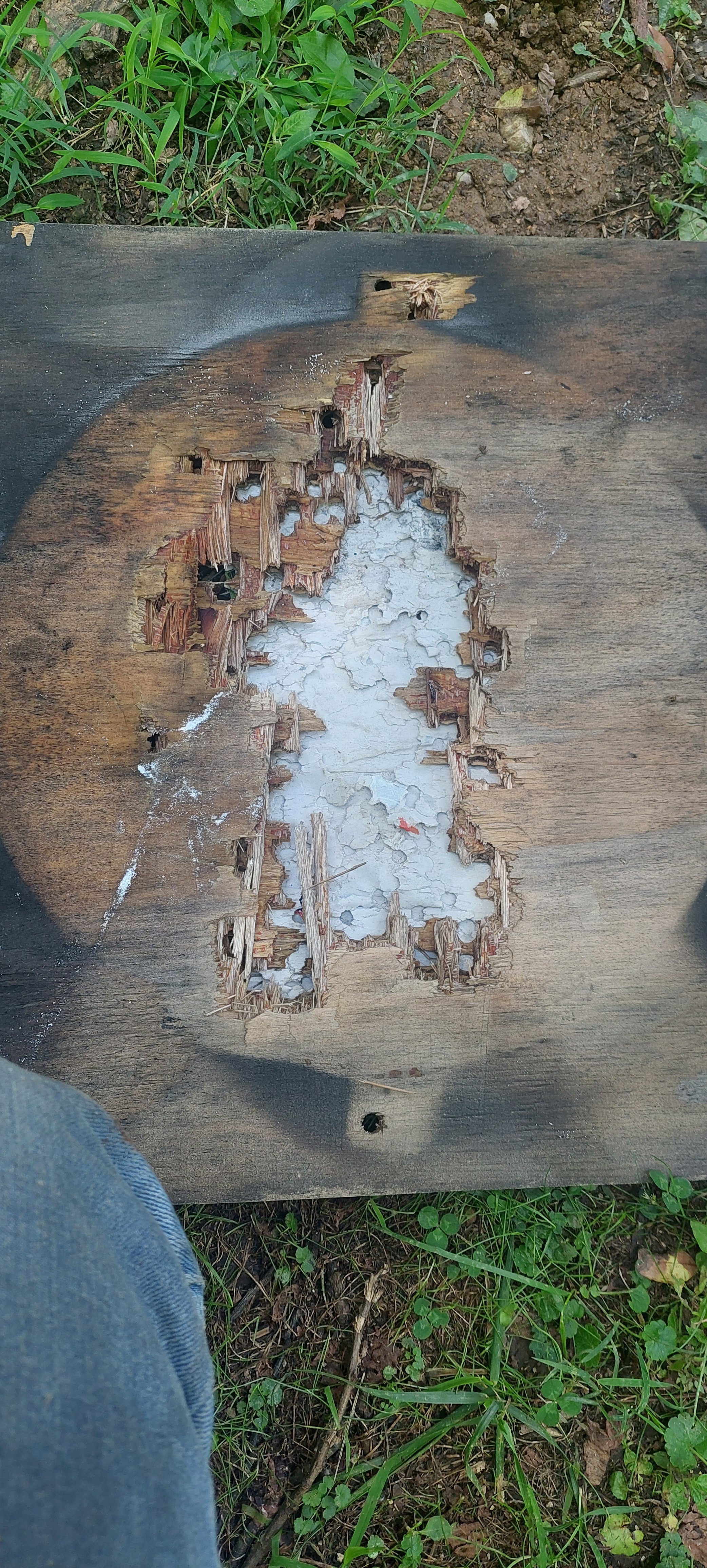

Plywood gets blown out, but stapled on targets actually hold the rubber mulch in really well when leaving them layered.
Collected 21lbs of my pure lead out of it last weekend for recasting.
Happy Shooting
Disclaimer shoot at your own risk, not sure how much power something like this can actually handle.

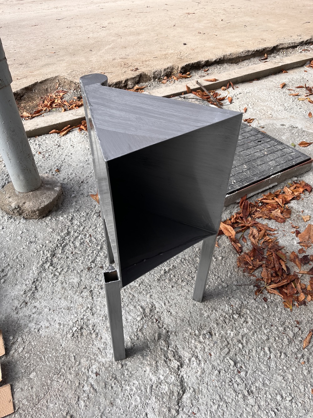

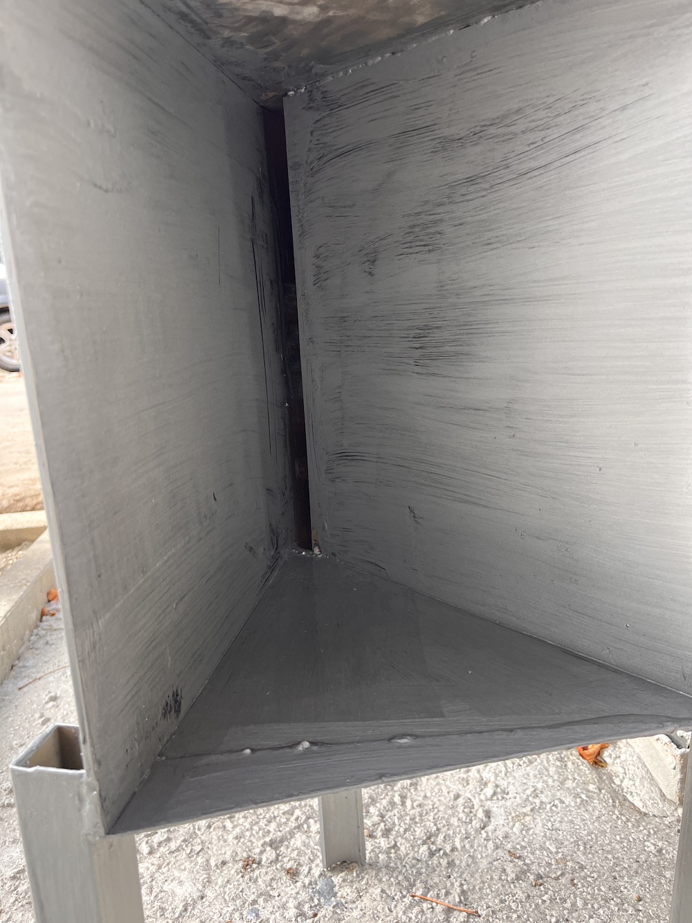

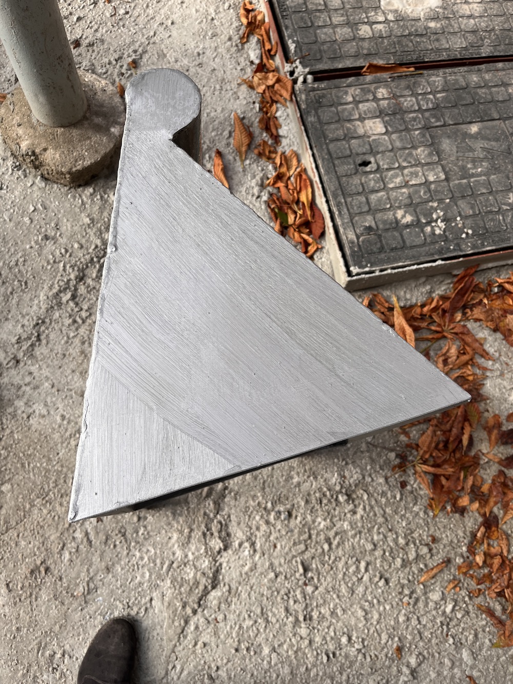

Here is mine - allmost selfmade from scrap :) I just used 4mm steel plate and thick steel pipe!
View attachment 487204View attachment 487204View attachment 487206View attachment 487205

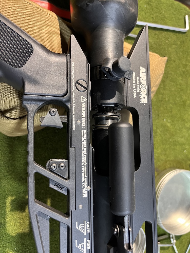

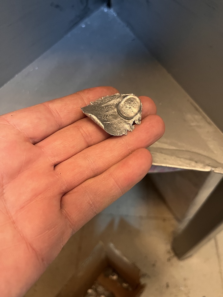

I tested it with Airforce Texan .50 caliber and this happened:
View attachment 487202View attachment 487201View attachment 487200

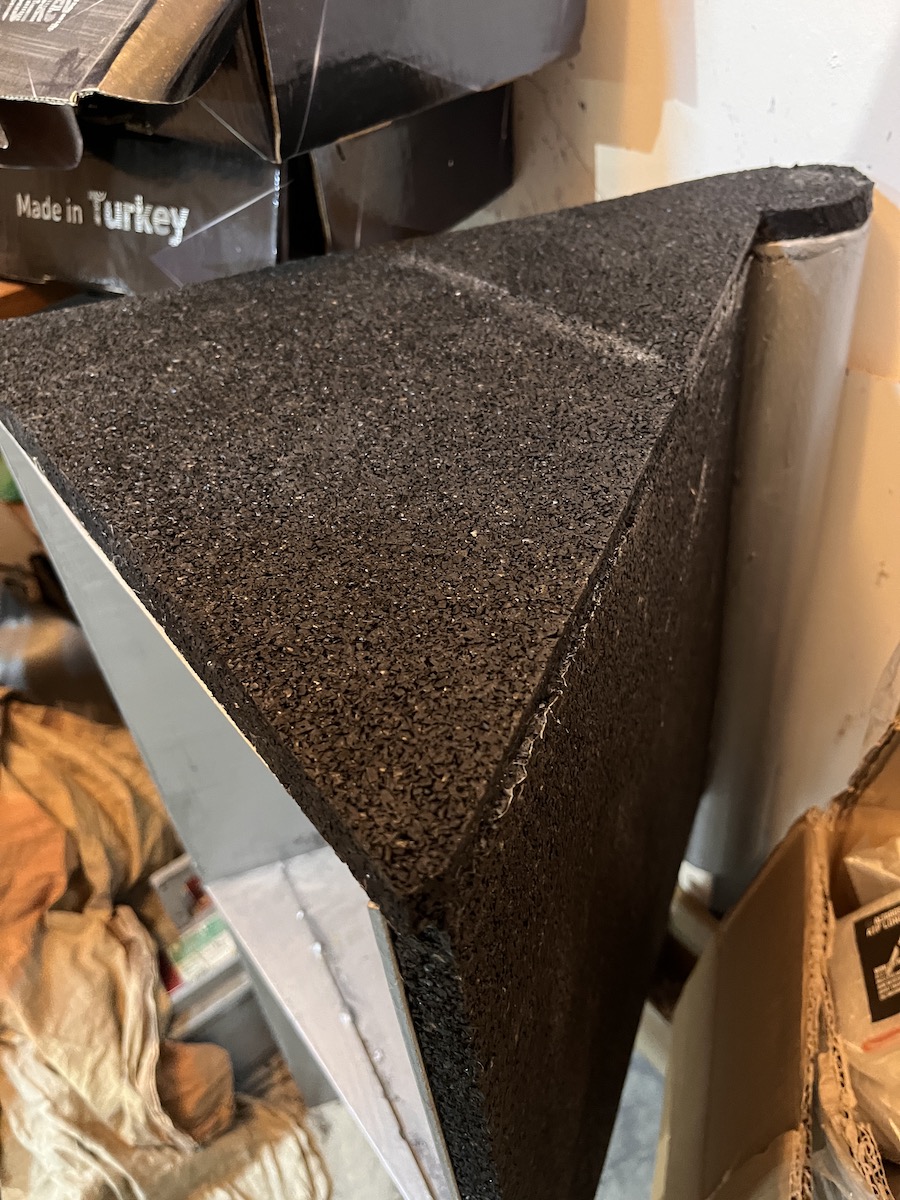

At end i covered it with tick rubber for less noise ;)

Glue a piece of thick rubber to the back side of the steel if possible, use something like silicon caulk/sealant or flex seal glue in the squeeze tube works really well. Use lots of adhesive, spread it with a small putty knife and coat the back of the rubber. It can’t ring when it can’t vibrate, the rubber dampens the vibration. The thicker the rubber , the better the result. old mud flap material works good, or old rubber conveyor belt, rubber roofs have these tread pieces they lay for walk ways on big flat rubber roofs, these things are excellent, I have found those at flea markets. Styrofoam was something I thought may have a similar effect if you don’t have any rubber. Like the dense insulation they sell at lowes and Home Depot.

With mine the steel plate actually isn't being hit at all because of all the rubber mulch in front of it that fills the trap. It was a just incase because I didn't want to shoot thru trap. Mobility to vary yardage, and catching my lead for recasting was my goal. For the most part just used junk I had laying around. Know now I could remove steel without any issues. Would certainly lighten it up when moving it around.

I did this same thing, using horse stall mats material from Tractor Supply, cut to the shape of the outside dimensions and glued with silicone adhesive. Even the 457 is a dull thud now
