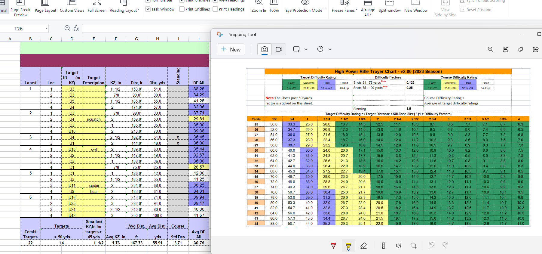

Yes I use the Troyer Scale for Field target match with 20FPE or less !! but starting a Big Bore Field Target matches and would like to have a Troyer Scale for that class !!!
The original Troyer factor for sub20fpe field target is mostly distance/kill zone size but has a difficulty factor applied for targets beyond 45 yards. After consulting with Brad Troyer I concluded that the Extreme Troyer needed two difficulty factors.
So....the Extreme Troyer Factor chart in the link above is also mostly distance/kill zone size but has a difficulty factor applied for targets from 51-75 yards and then a higher difficulty factor for targets from 76-100 yards.
As discussed above, I modified the standard charts with the formulas in the post referenced above and use this to set up our matches.
