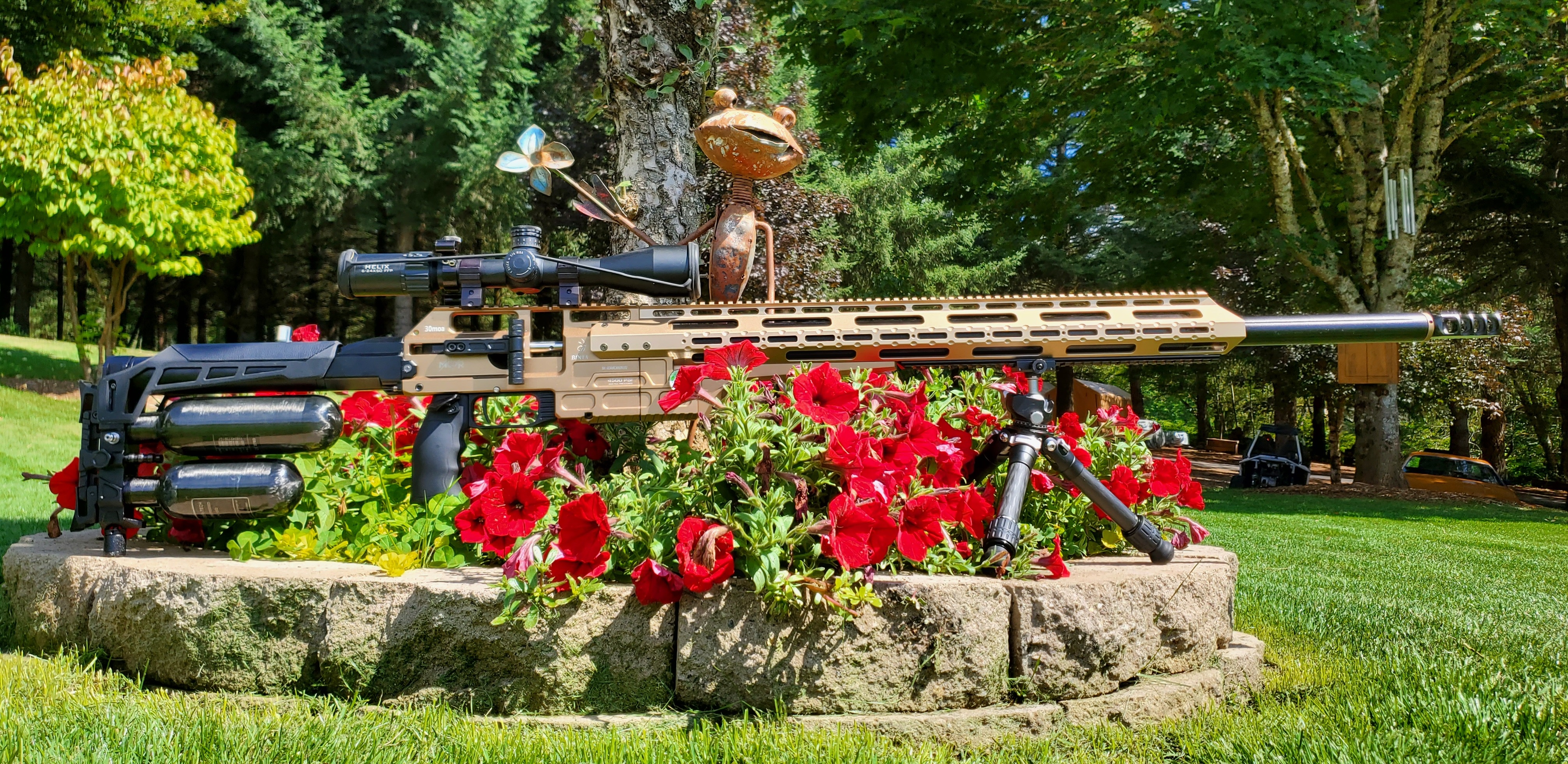

Should AGN ad a section for Bintac? The T9 was awesome and this .457 Bintac MCAR is by far the most easy to shoot and accurate big bore airgun I have seen yet. This thing is amazing! The gun shoots itself if you let it (don't hold it too tight). This amazing PCP is the top of the heap when it comes to big bore long range PCP's. There is nothing better in my opinion. At 19 pounds it's not the best for hunting, but if your looking to win big bore airgun competitions, this is your gun. Great PCP sniper rifle, available NOW at Airgun Tactical. Thanks for tuning in! -Nate

Same. You’re not going to hunt with this monstrosity so a 257 is a much better calibre for long range.
Imagine then power potential in a smaller caliber.
I would expect it to make power similar to a Texan, maybe a little more with the 38” barrel vs the 34” on the Texan…at same pressures. It doesn’t seem to to be making above class power in the .457, but really wouldn’t expect it too either.
