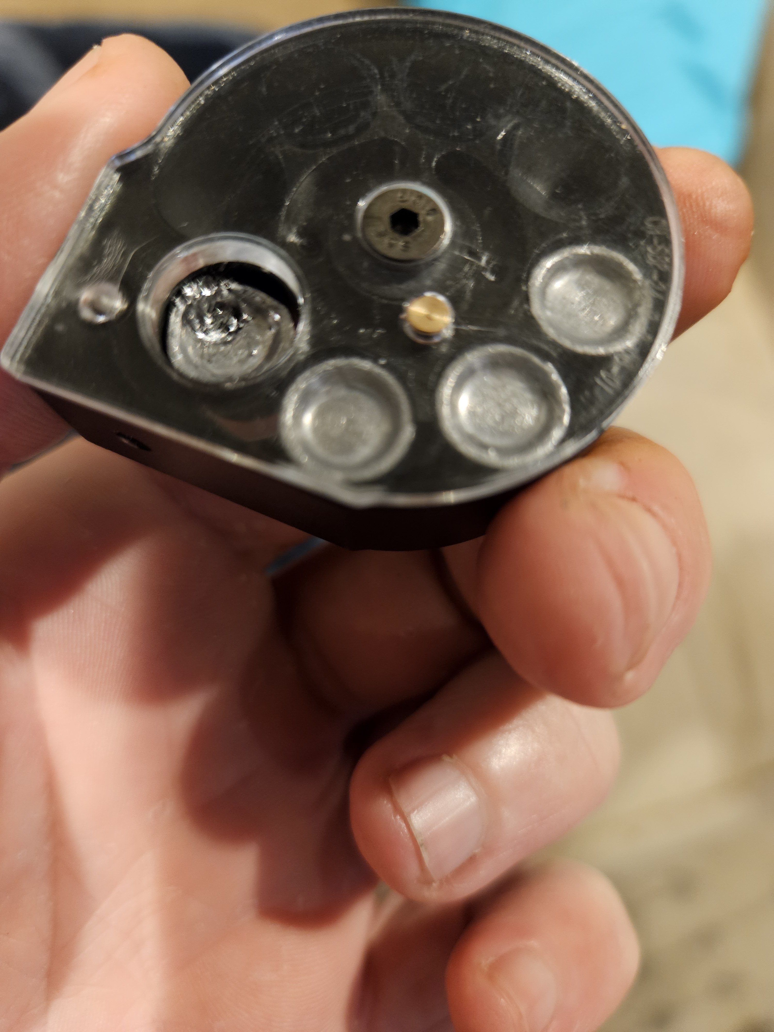

So I just got my bintac T9. Seemed like something fun to play with. The only time I can get it to fire a full mag in semi auto is if the pressure isn't all the way up to 4500psi. At full pressure after the first shot it won't reload, I have to pull the charging handle back to chamber another pellet. It seems to work better if you don't try and rapid fire it. It also doesn't fit very many kinds of slugs since the magazine is so narrow.
I have 7 kinds of slugs in .357. Most won't fit. I have some zan slugs that fit great but it won't cycle them correctly. I bought some texoma T9 pellets but they are too long for the magazine, I tried filing them down but no luck. Polymags are way too long. I got the best results with pellets. The JSB hades and exact .35 pellets worked better, but the only thing that would fire reliably was the pellets that were included with the gun, they don't have a brand on them.

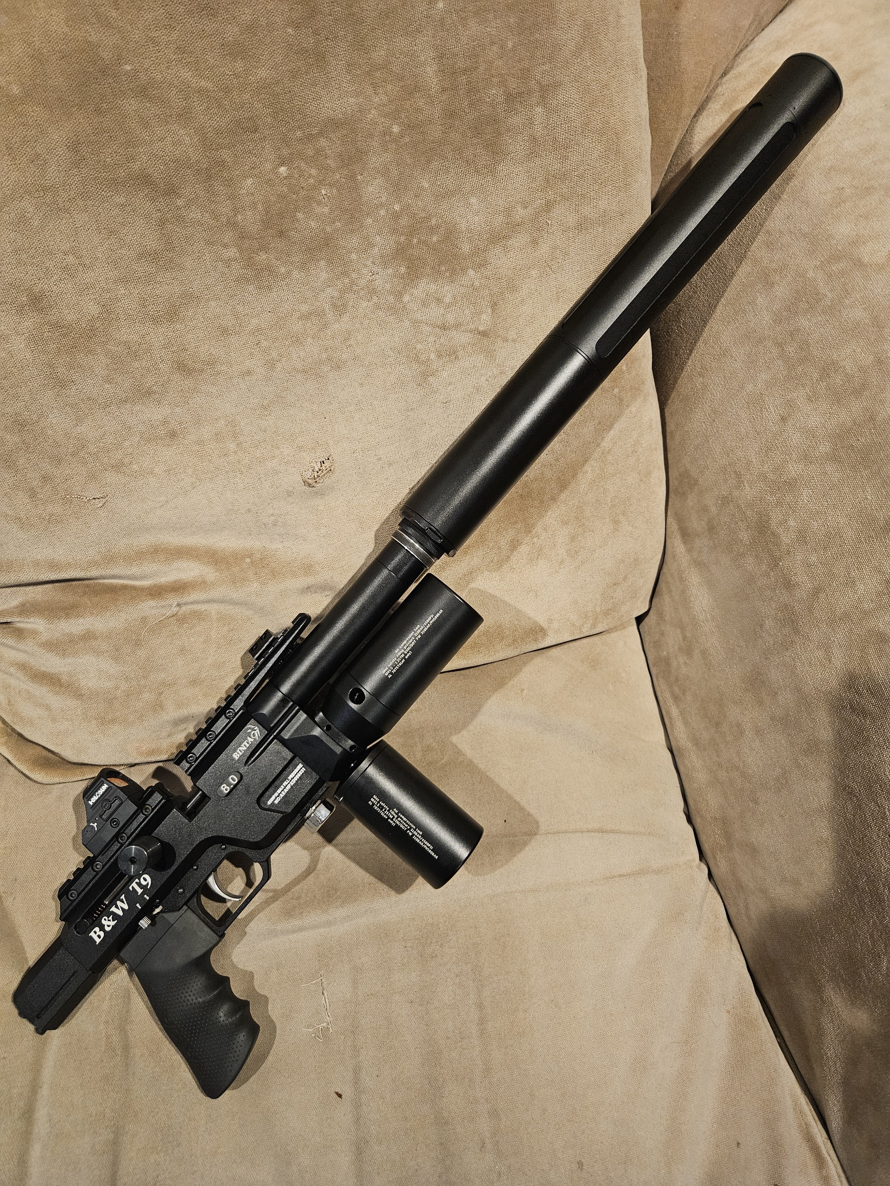

I did figure out that if you have a threaded western rattler adapter from donnyFL it will thread on to the T9 barrel and let you use a moderator. The threaded rattler shroud screws on also. I'm going to test DB readings in a couple days.

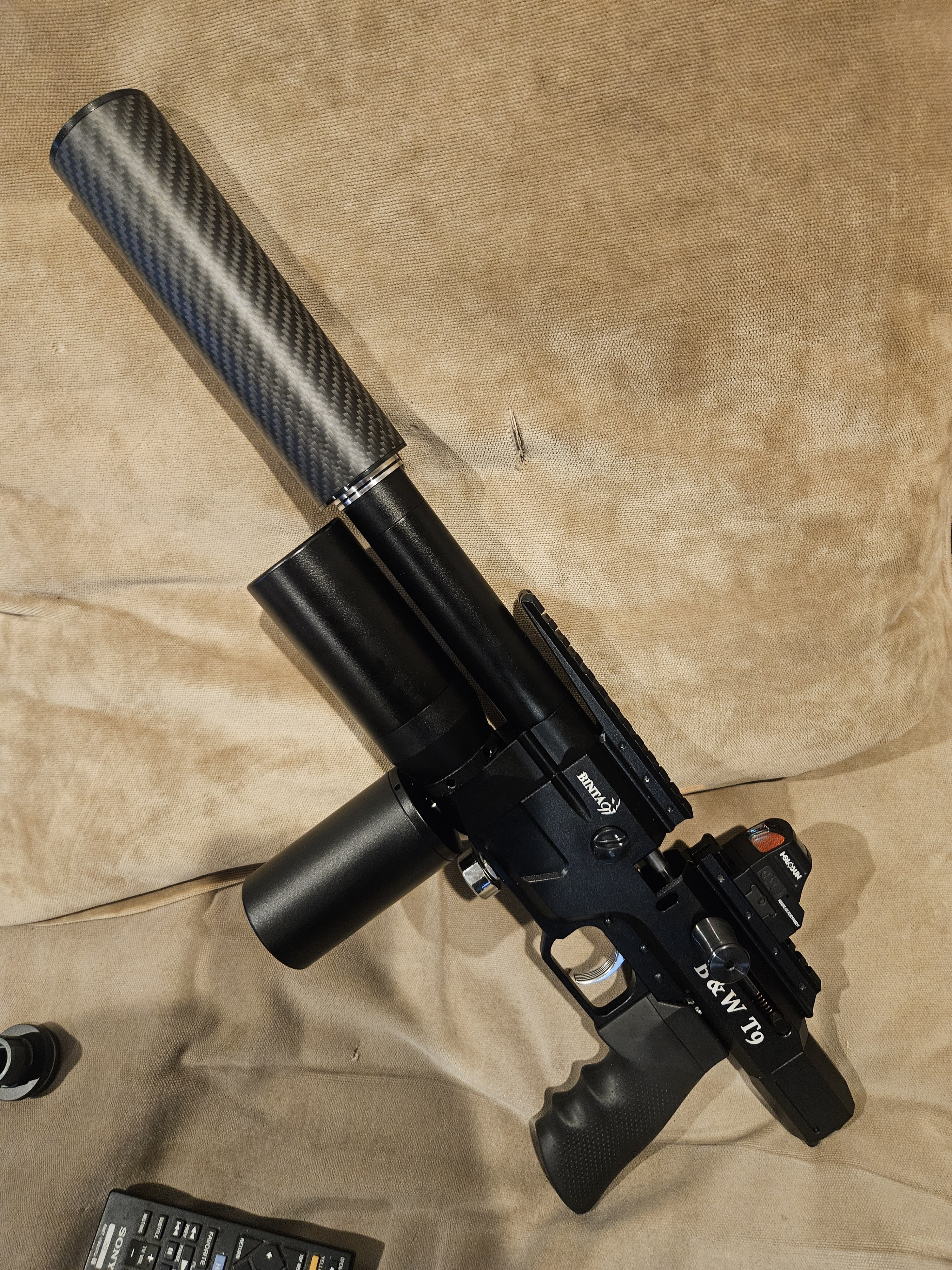

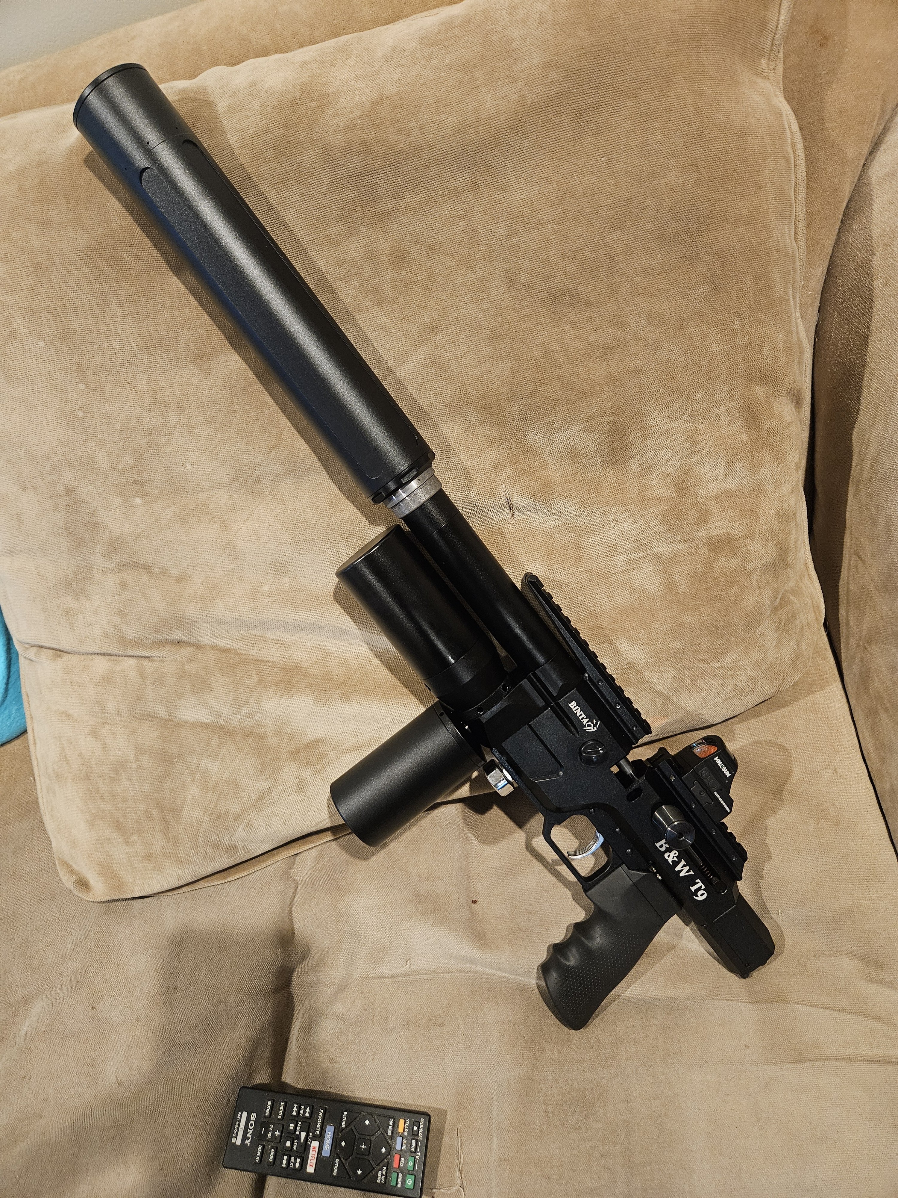

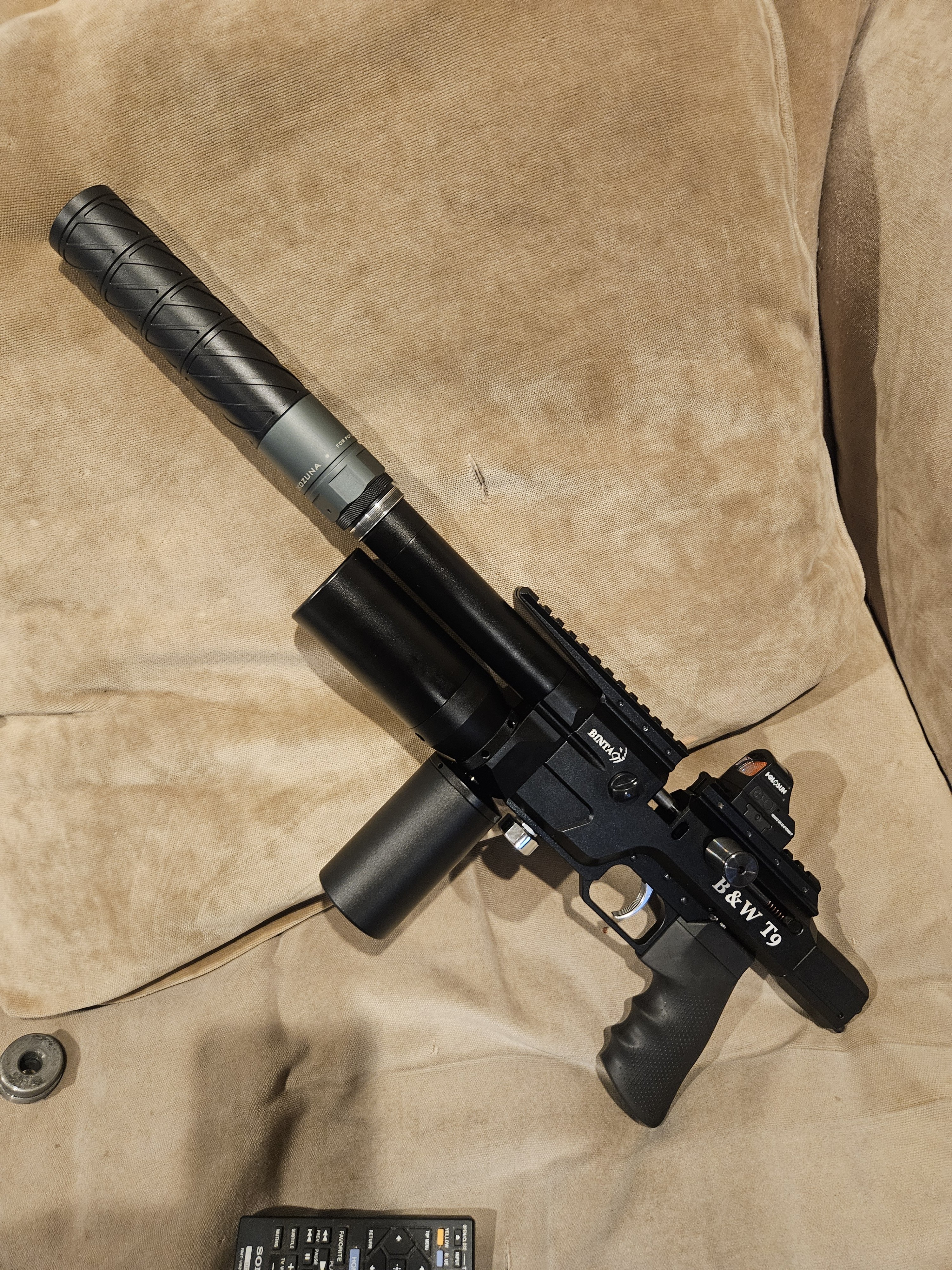

I'm bored so I tested the mods lol.
Without mod: 125db
With donnyFL Yokozuna: 120.5db
With donnyFL Emperor: 117.3db
With Western Rattler .357 threaded shroud: 117db!
The winner was the Rattler shroud lol. Quite a difference. I filled the gun to 280bar and had no problems in cycling rounds, I was using JSB exact diabolo 81.02gr pellets.

AEA mags are cheap and nasty I have a challenger pro in .22 after about a week both mags failed the springs broke , so now I just feed the pellets in one at a time by hand ....
This is why I will not, ever, own an airgun with these types of mags. Done and done. Nothing more frustrating than a semiautomatic that will not cycle properly.
Huben and Edgun have this figured out.
Cool gun, but not for me, sadly.
How much effort would it take to make a proper, reliable magazine? Not much, but it’s obviously not a priority.
