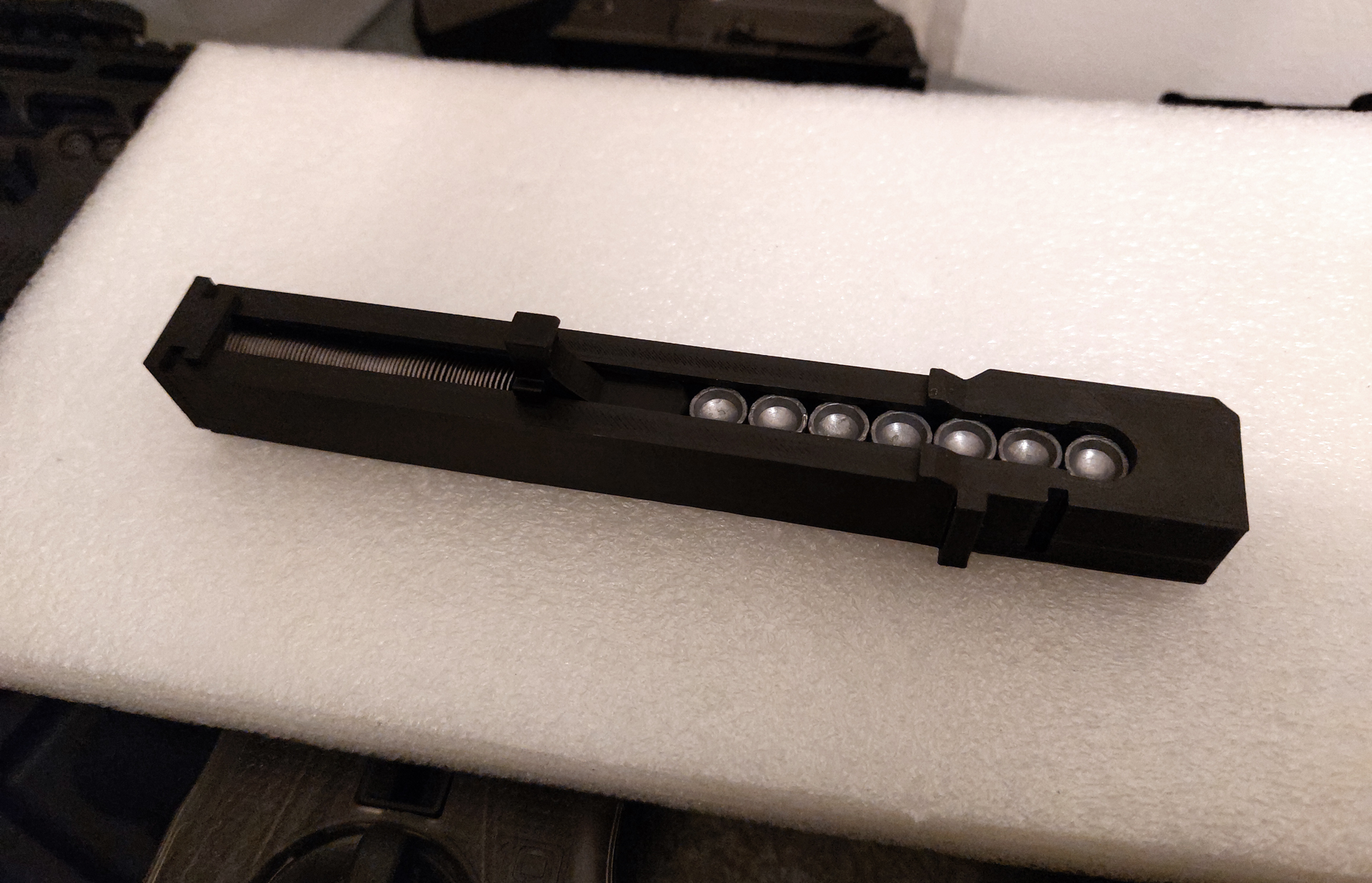

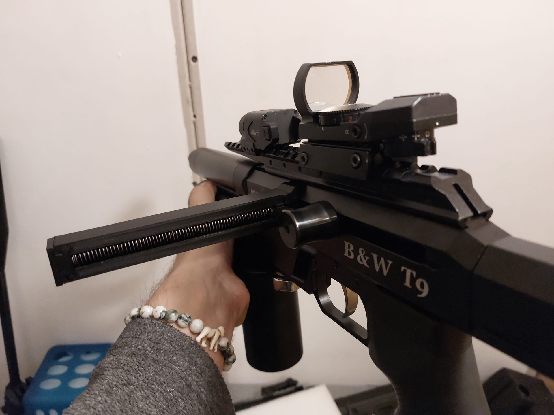

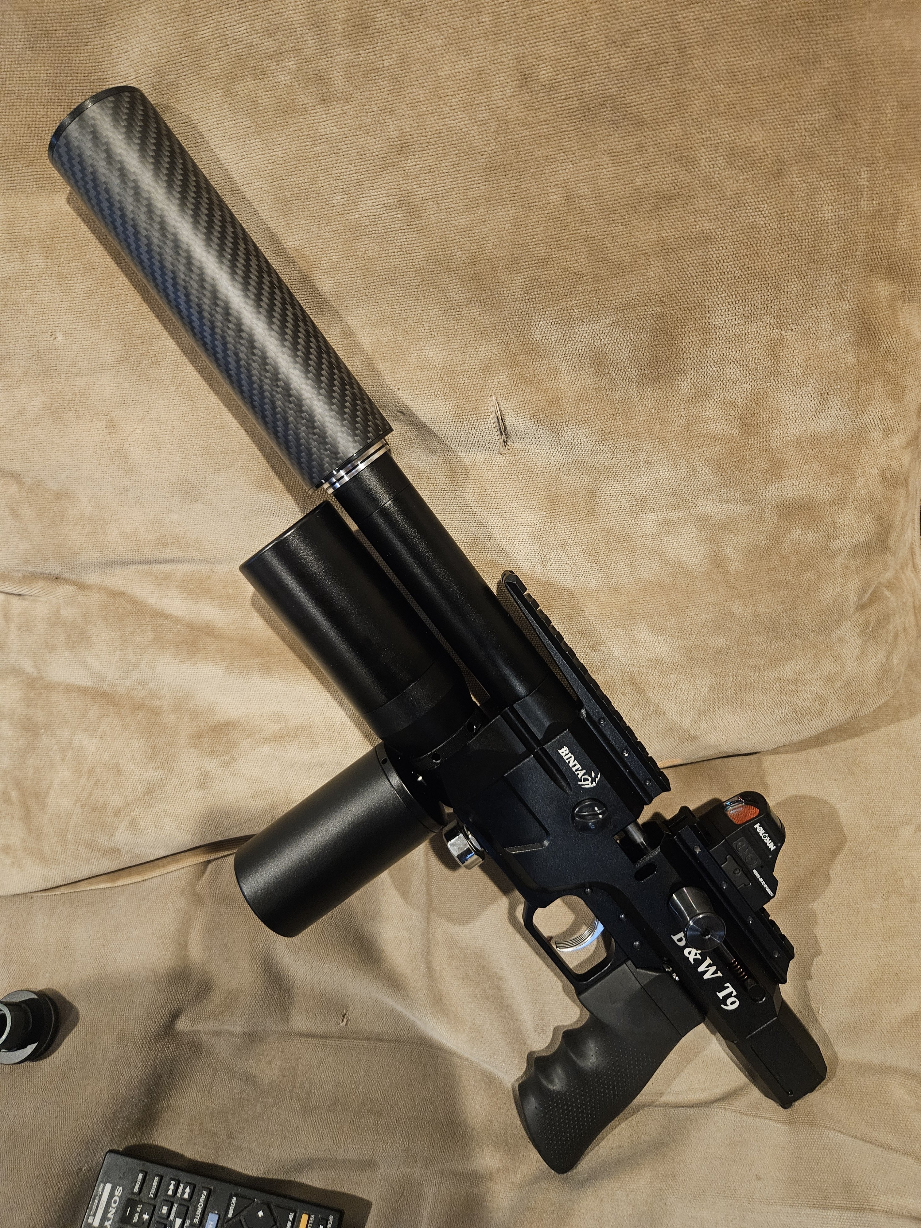

So I just got my bintac T9. Seemed like something fun to play with. The only time I can get it to fire a full mag in semi auto is if the pressure isn't all the way up to 4500psi. At full pressure after the first shot it won't reload, I have to pull the charging handle back to chamber another pellet. It seems to work better if you don't try and rapid fire it. It also doesn't fit very many kinds of slugs since the magazine is so narrow.
I have 7 kinds of slugs in .357. Most won't fit. I have some zan slugs that fit great but it won't cycle them correctly. I bought some texoma T9 pellets but they are too long for the magazine, I tried filing them down but no luck. Polymags are way too long. I got the best results with pellets. The JSB hades and exact .35 pellets worked better, but the only thing that would fire reliably was the pellets that were included with the gun, they don't have a brand on them.

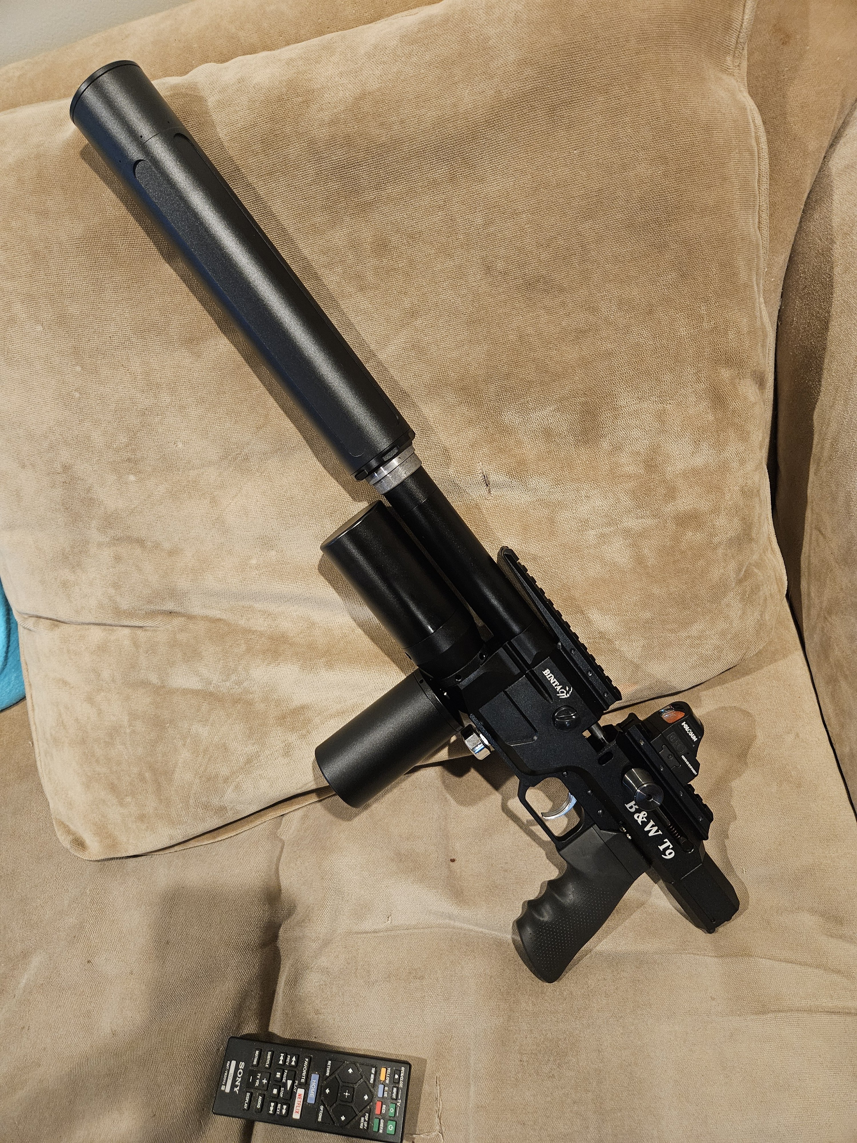

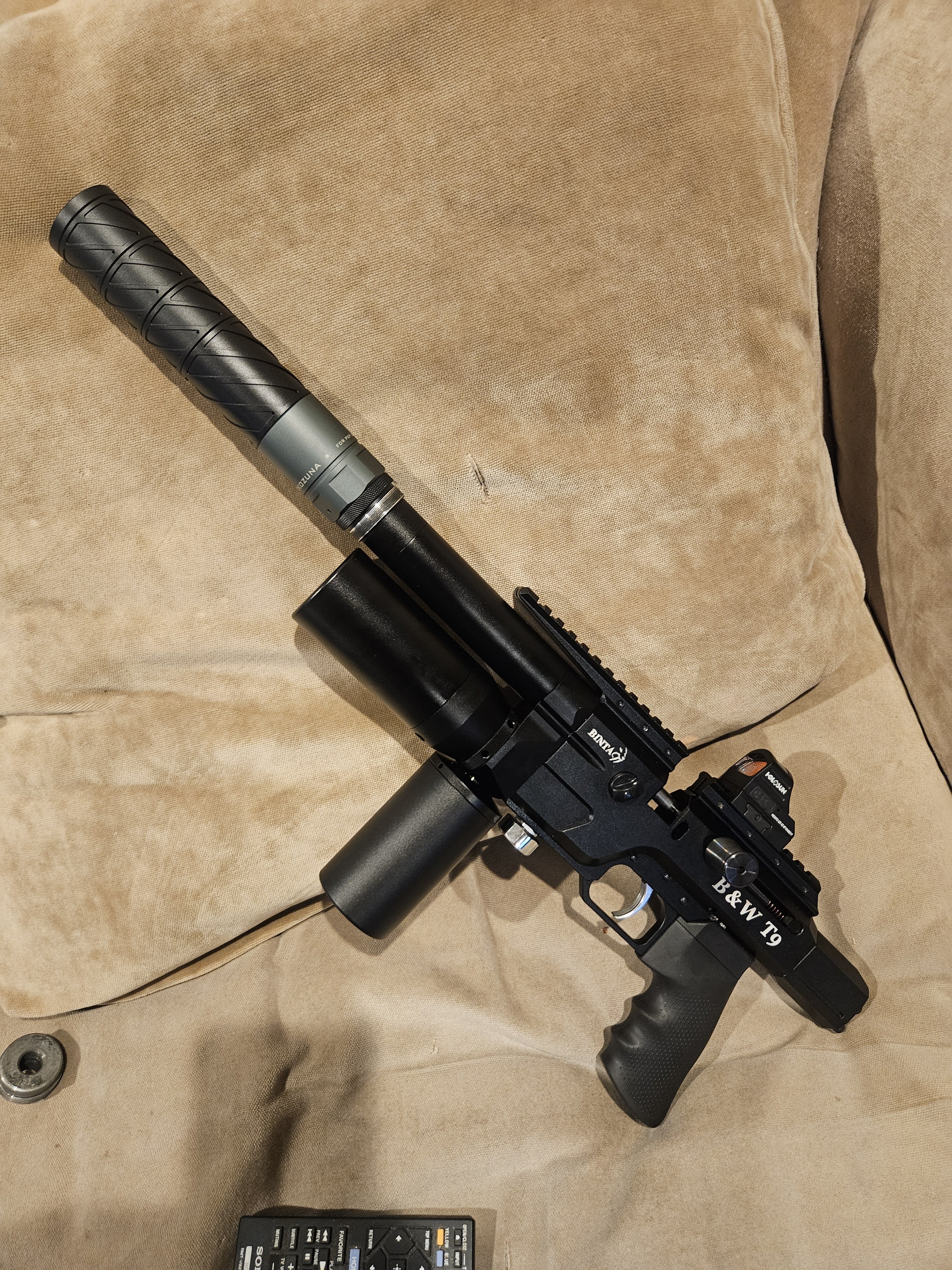

I did figure out that if you have a threaded western rattler adapter from donnyFL it will thread on to the T9 barrel and let you use a moderator. The threaded rattler shroud screws on also. I'm going to test DB readings in a couple days.

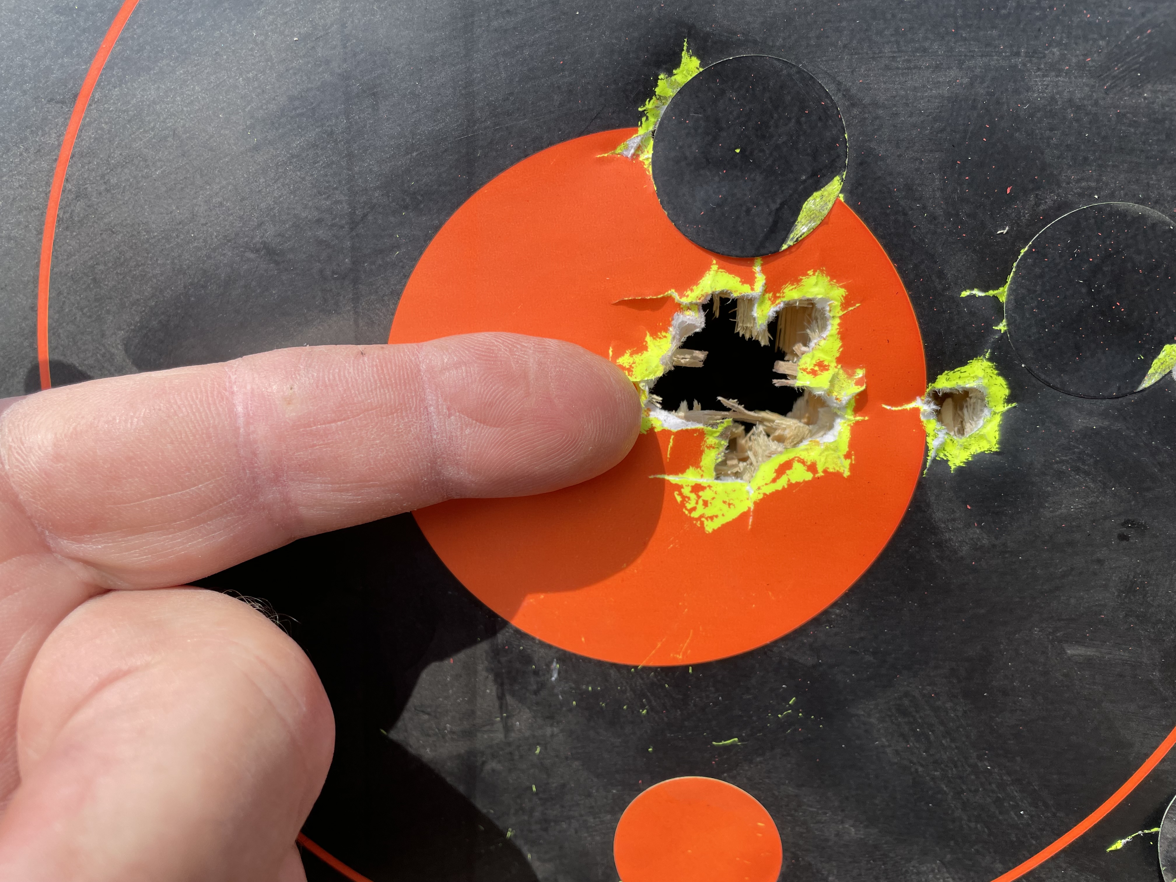

When the thing fires correctly it's pretty accurate at 15 yards, I haven't tried it at any distance yet. I seem to get 16 shots from 4500psi, but the first 8 are a headache having to pull the handle back and try not to double chamber rounds. After 16 shots I was down to around 150 bar.

View attachment 472624 View attachment 472625 View attachment 472626
