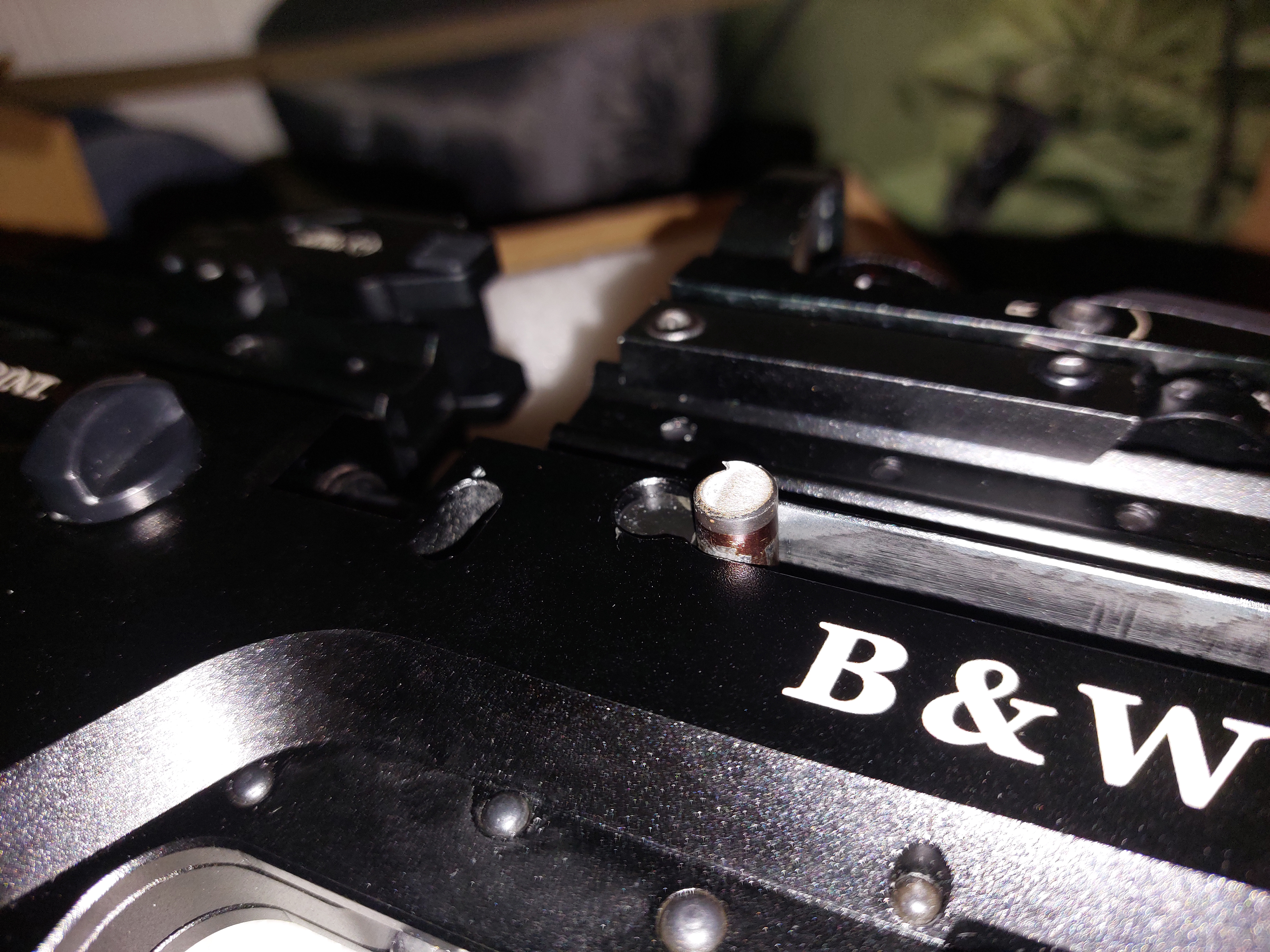

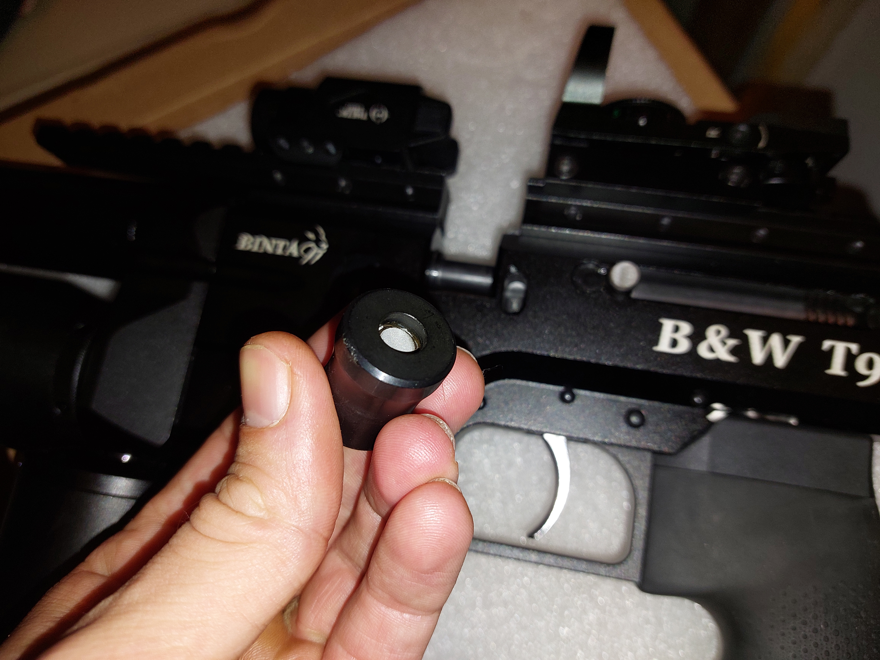

I sent the broken handle back today. Luckily BinTac was kind enough to send a replacement to my local dealer. I hope I will receive it soon. They will also look into the material and see if there is a design issue. Obviously this should not happen. The bolt handle should be able to withstand the force of the blowback. Looking at the material at a glace, it does seem fairly brittle. It has a solid outer shell, but the white-ish inner core looks a bit sus. Im not a metalurgist, so I don't know what that material is called. But it's definitely not solid steel.
Ouch..... but I'm not surprised honestly always thought the Prototype T9 bolt and handle looked more durable and better then the finished product tbh.
