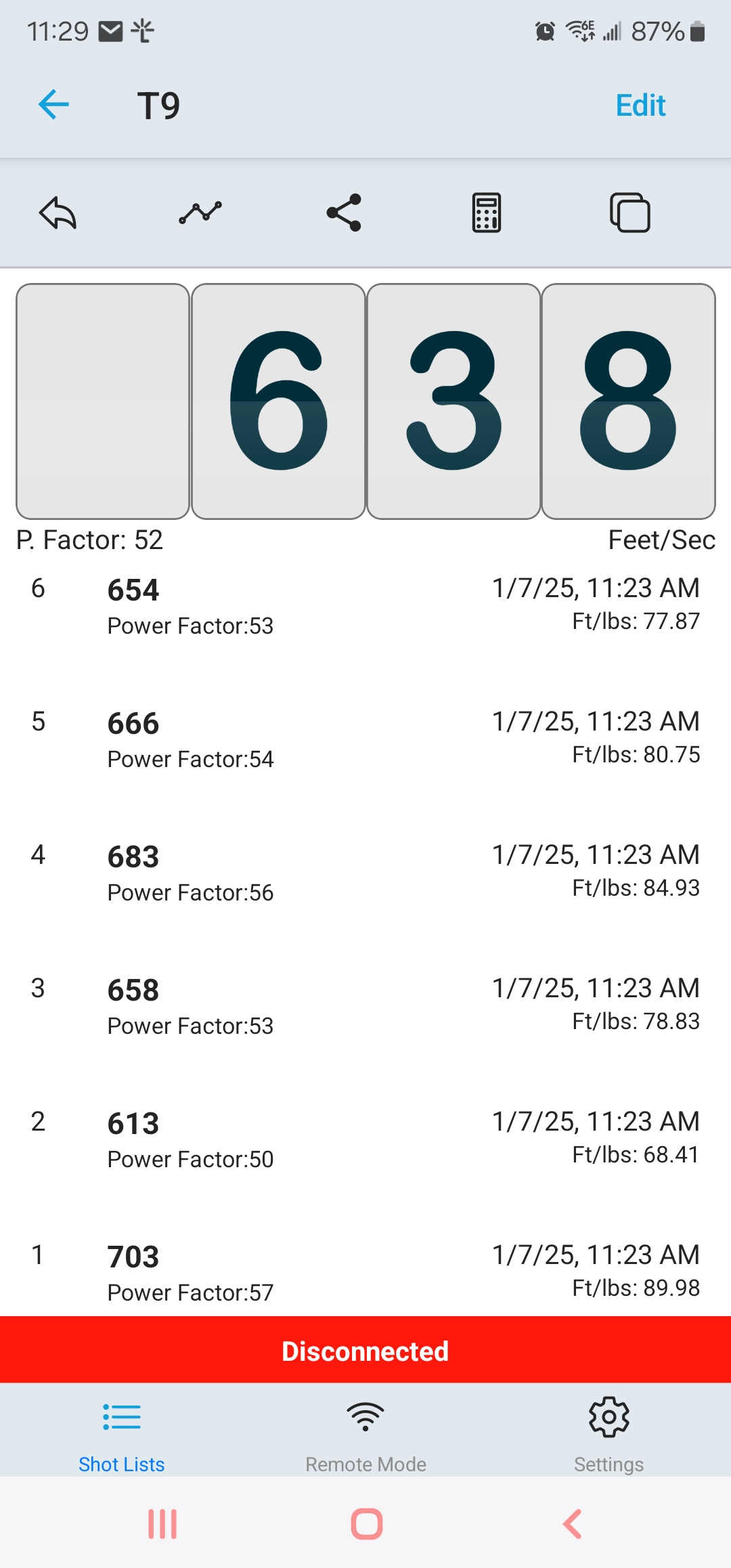

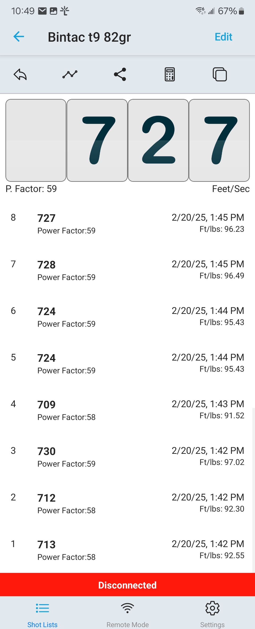

A shot string with 82 gr pellets i thought i would of had better speeds than that to at least pass the 100pfe.. this is a new t9 probably 30 shots through it if so.
Upvote 0
Don't you just love unregulated air guns?A shot string with 82 gr pellets i thought i would of had better speeds than that to at least pass the 100pfe.. this is a new t9 probably 30 shots through it if so.

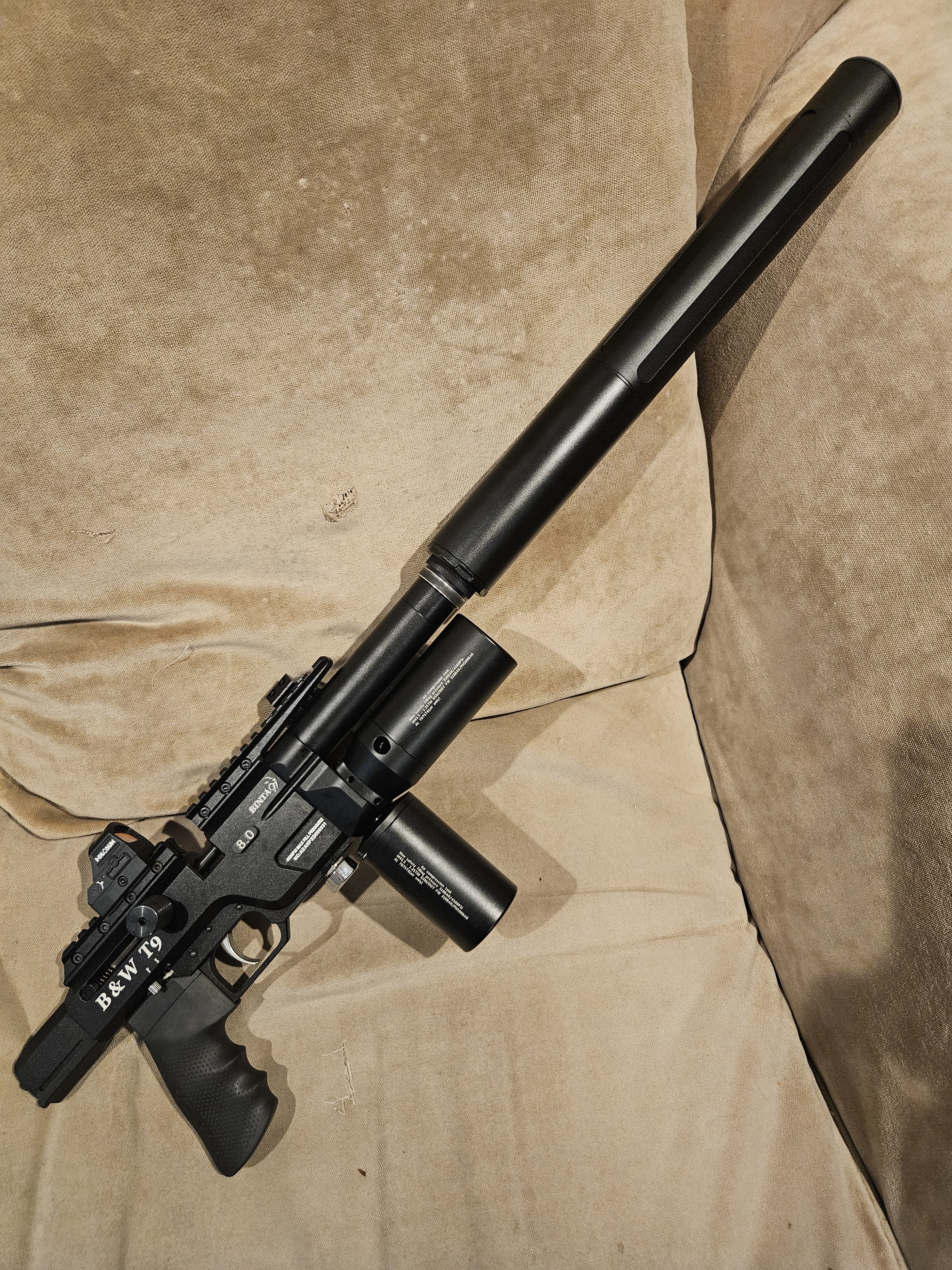

I want to cry reading this because I just ordered it came in today the ronin for my t9 toxic matrix used it on his channel with no issues but he also had the extension tube along with the ronin wich probably relieves alot of that pressure you talking about..I also ordered the extension tube lets see.Hey folks! So I think I figured out what's wrong with the T9 (at least with mine). As Ach3r0n already alluded to... It's the moderator.
I sent mine back to the shop for inspection and they were not able to replicate the problem. They shot dozens of magazines without issue, so they sent it back a few days later. Thing is, I sent it back without the moderator because I also use it for a diferent airgun.
I immediately tested it without the moderator and it worked flawlessly. Even my own custom mags ran smoothly. I tried again, this time with my Yokozuna attached and sure enough... it jammed within the first couple of shots. I took it off again, and shot the rest of my mags without issue again. My guess is that the moderator creates too much back-pressure inside the chamber, causing the bolt to cycle too aggressively.
I also heard that the gun has issues cycling heavier ammo, which I think is part of the same problem. Too much pressure.
So yeah.... the T9 apparantly does not like supressors. Which is a bit of a shame because the T9 is LOUD as hell. I won't be able to shoot this thing in my garage too often. My neighbors will eventually think there's a war going on xD
Maybe there's a moderator out there that doesn't mess with the semi-auto action, or some other solution can be found. But that would require further testing/tinkering. As it stands, the Ronin and Yokozuna are definitely a no-go.
Can you link the extension tube? I was planning on getting one along with a moderator for my T9.I want to cry reading this because I just ordered it came in today the ronin for my t9 toxic matrix used it on his channel with no issues but he also had the extension tube along with the ronin wich probably relieves alot of that pressure you talking about..I also ordered the extension tube lets see.
The extension tubeCan you link the extension tube? I was planning on getting one along with a moderator for my T9.

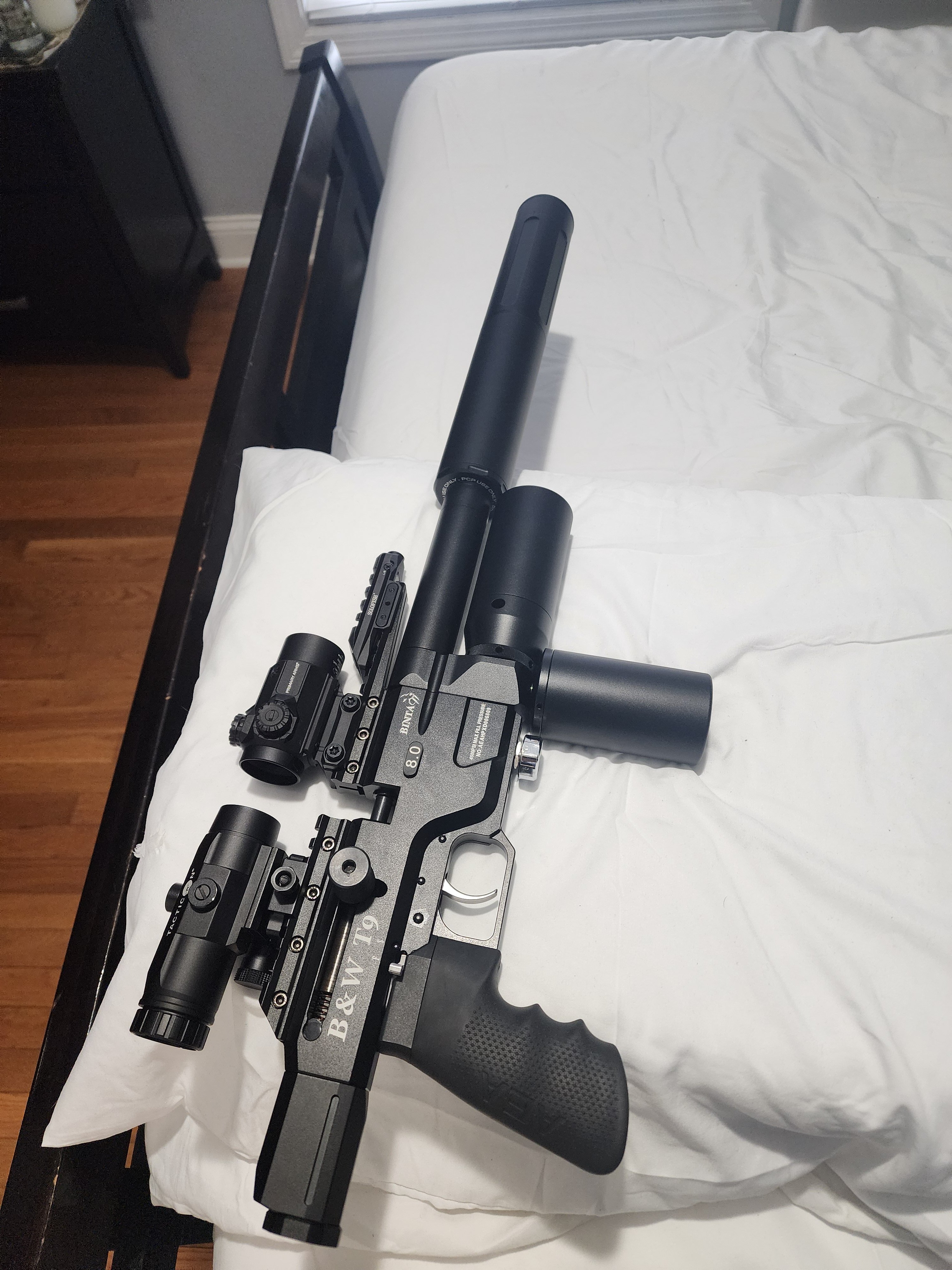

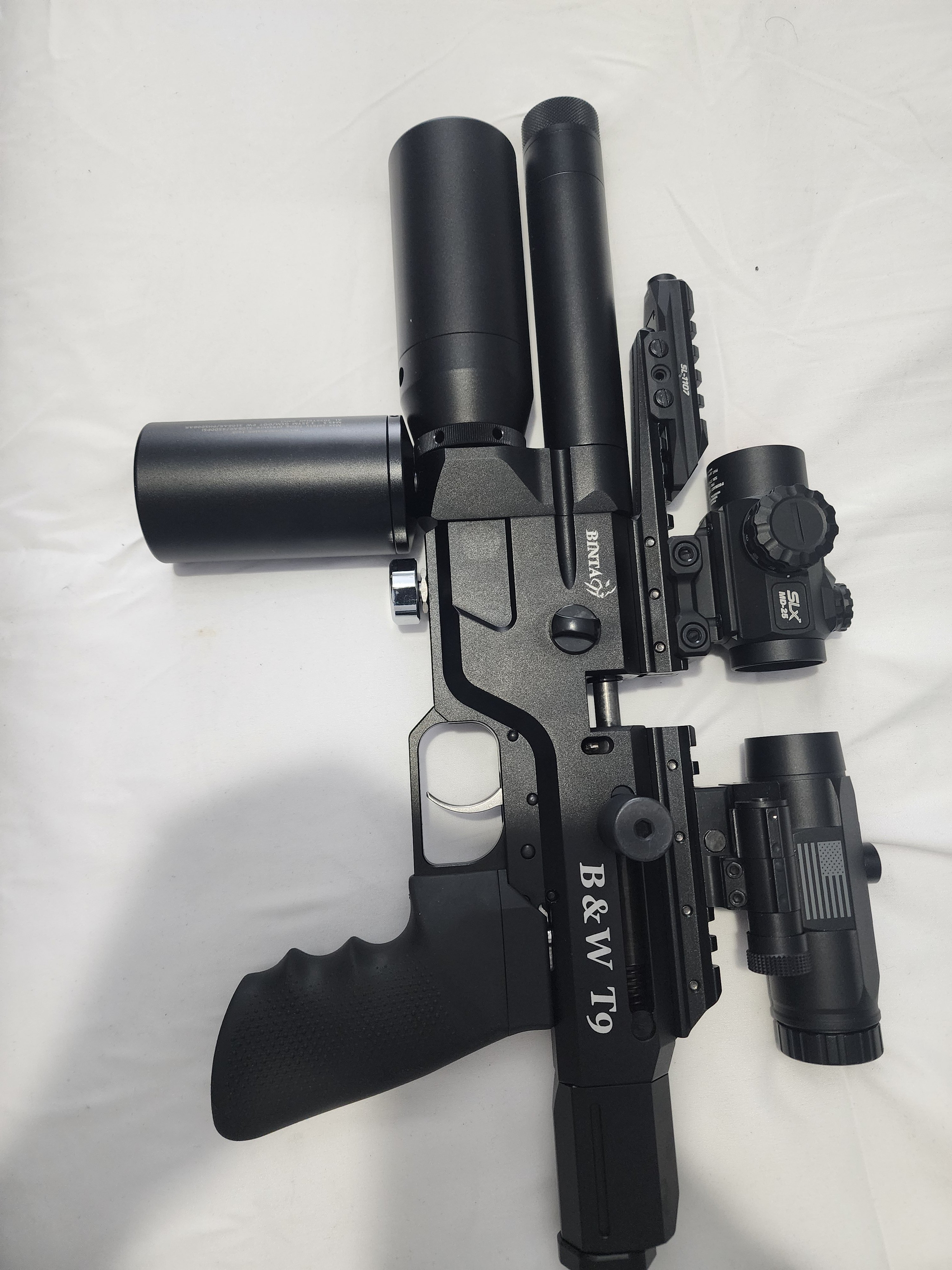

Nice! Can you test slugs? Also would you say it quiets the T9 down pretty good?Ok so i finally put to the test the t9 with the ronin and the extension tube shot about 100 shots not one single misfire

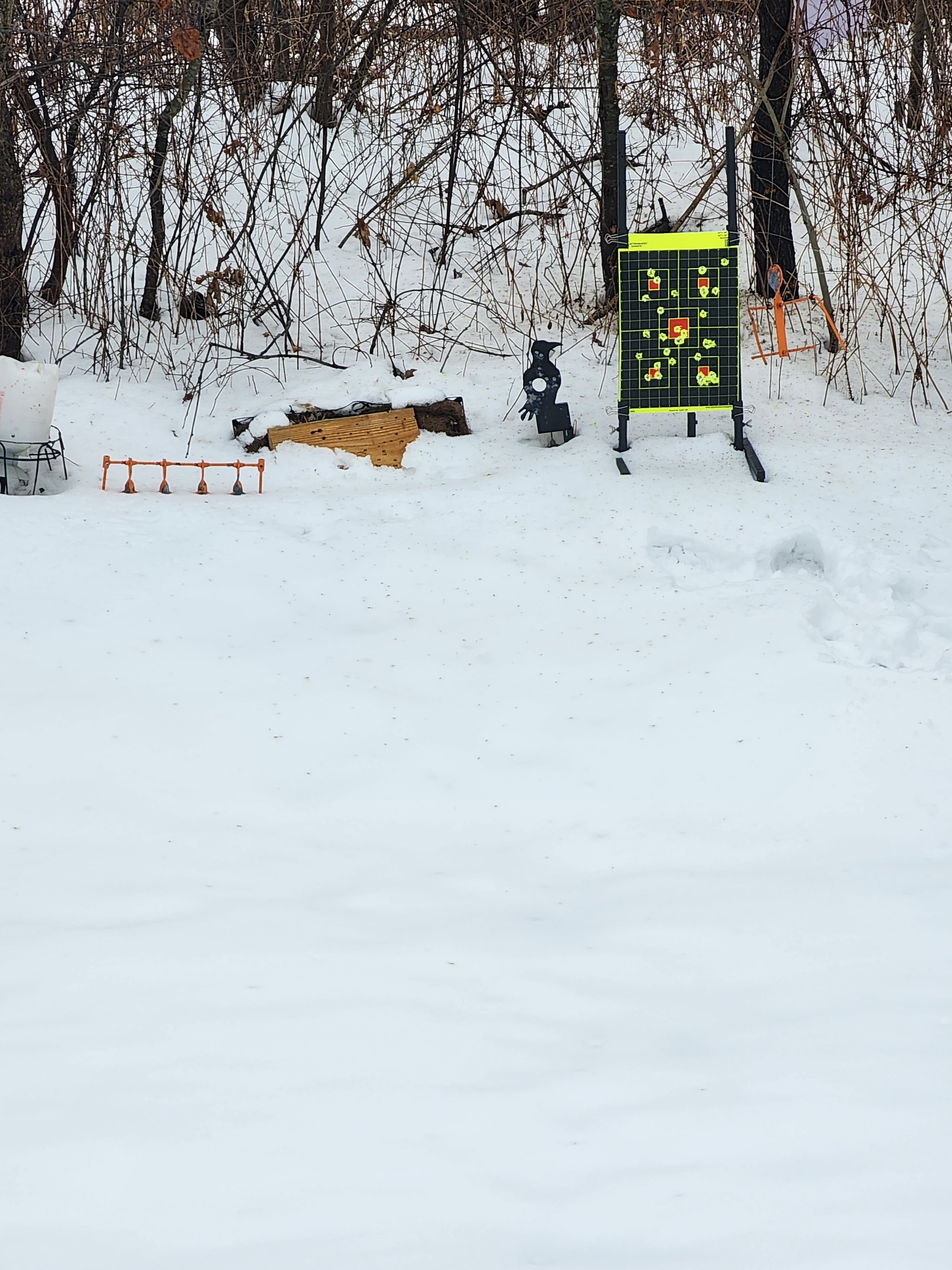

82 gr pellets no slugs my home made range from.my bed
Yes it quites down the t9 alot making it neighborhood friendly goes from the sound of a real gun to like a nail gun type of noise...I have some 68 gr texoma slugs I will try...but this gun just likes pellets it doesn't like slugs most misfires is people using slugsNice! Can you test slugs? Also would you say it quiets the T9 down pretty good?
Almost the same route i have the ronin on it..I do have the emperor v3 but is a .50 cal threads are the same it would fit i suppose going bigger on the bore of the suppressor would not affect the gun?Got it down to 113db using the DonnyFL extension tube!

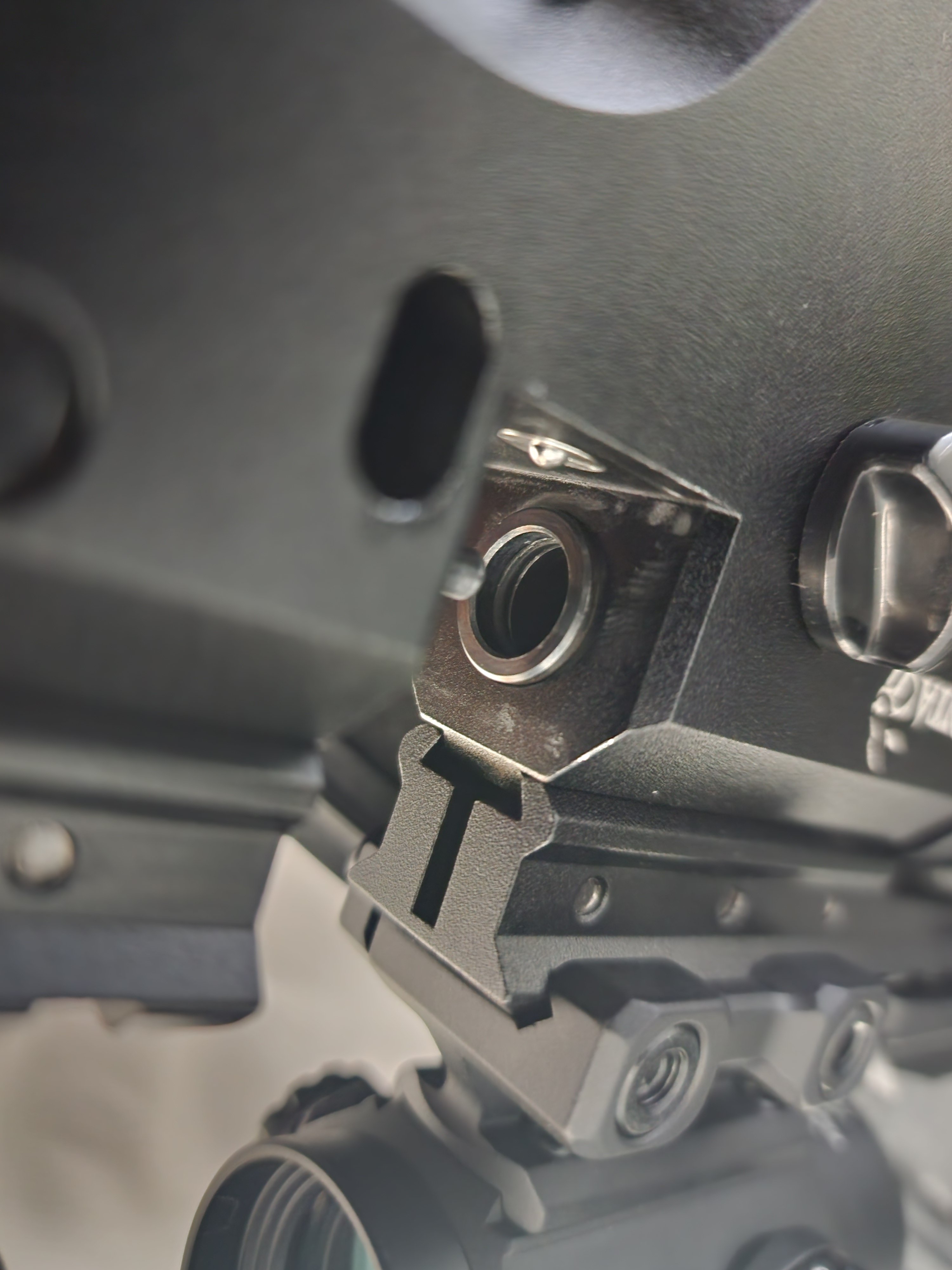

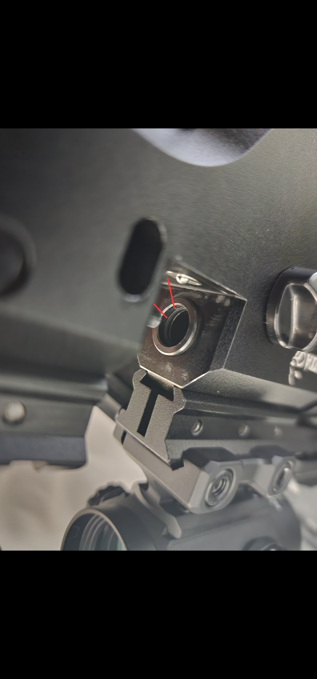

I need help the breach seal on mine just went on like the first 30 shots out of the brand new t9...I have o ring kits from Amazon I tried few but it shreds it in the first shot..please help where did you get the breach seal replacement? ThanksI’ve had my t9 for about 3 months, I got it with the folding stock sporting a ronin. I haven’t been on here in a while. Just got on to read and see what everyone is shooting. I didn’t realize there was this many issues with the t9. I didn’t realize that it must have ejected the breach seal once, maybe on a dry fire. Because it don’t lock out when the mag is empty. Other than replacing that and watching my shot count. I guess I’m lucky, I’m getting 880fps with the fx hybrid 35cal and they are fairly accurate too. 1 inch group ls at 30 yards still deadly at 60 yards. Works wonders at 25 30 yards on raccoons, can’t wait for a fox or coyote to come sniffing around the quail cages.
Impressive what was the ammo used? also question is the breach seal noticeable in the T9? because mines been acting up with shots and I'm curious if my seal was blown but the T9 isn't like my notos which has a very visible white oring that's also protruding a bit which. Makes it easy to tell what's up. Honestly can't tell by looking at my T9 tbh.Some new numbers out of the t9..this was teether gentleman
When you pull the bolt back you will be able to see the breech sealImpressive what was the ammo used? also question is the breach seal noticeable in the T9? because mines been acting up with shots and I'm curious if my seal was blown but the T9 isn't like my notos which has a very visible white oring that's also protruding a bit which. Makes it easy to tell what's up. Honestly can't tell by looking at my T9 tbh.
