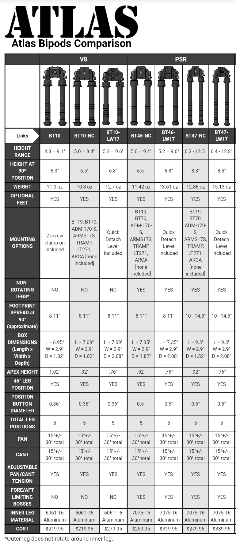

The model you want to get is the Atlas PSR BT46-LW17 which is pretty much the Gen2 version with all the fixes and upgrades. It should also have a wider push button for leg deployment and stowaway. Here's a pic from the Atlas website that shows the differences between the V8 and PSR models.

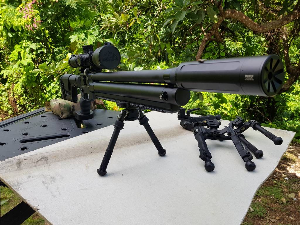

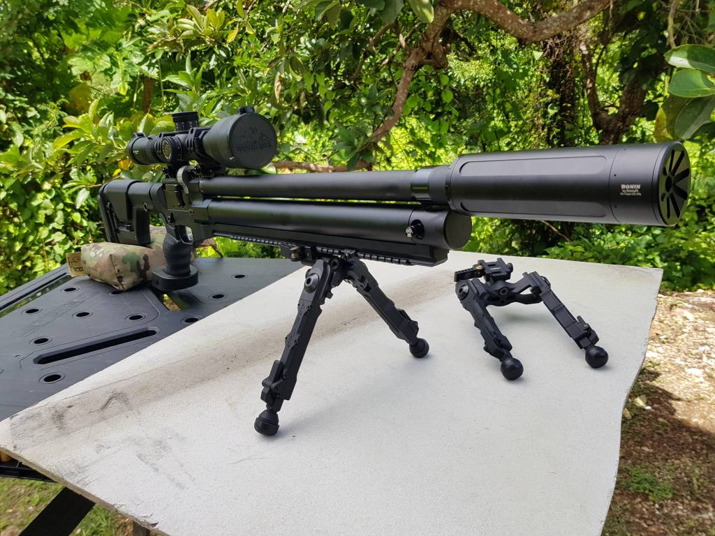

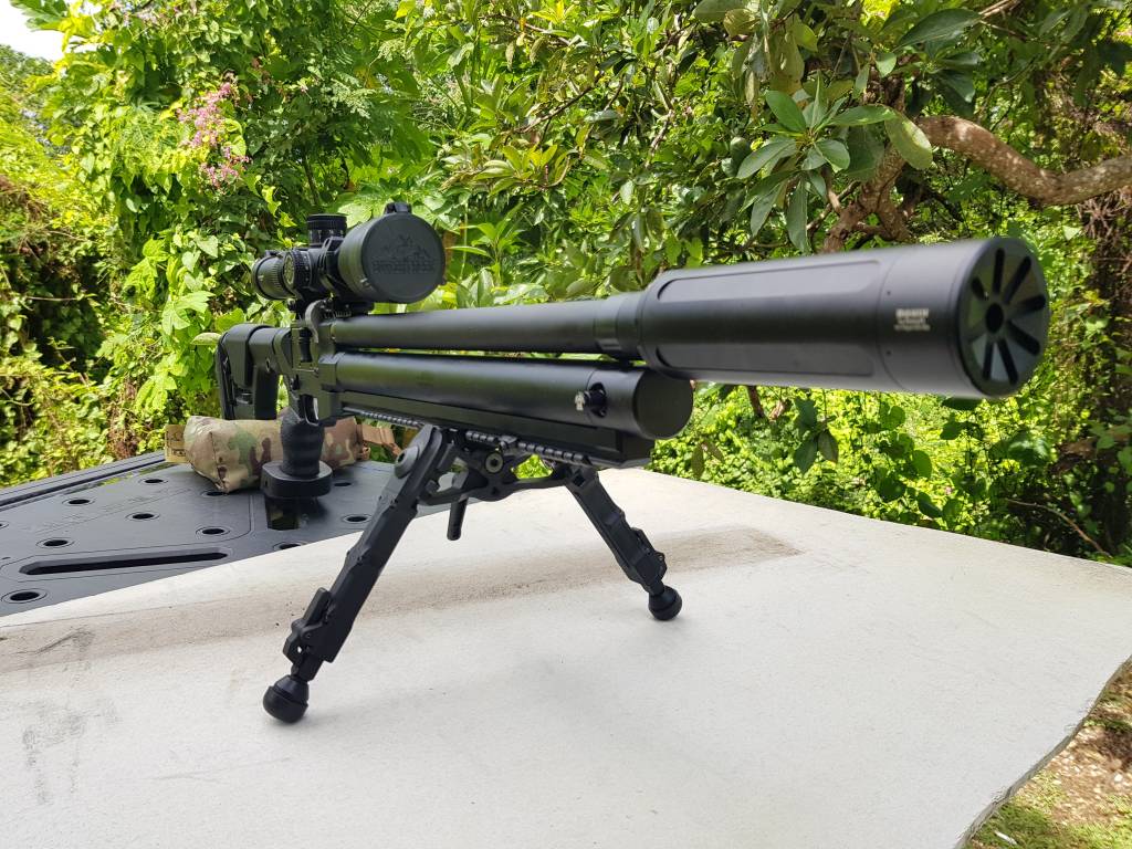

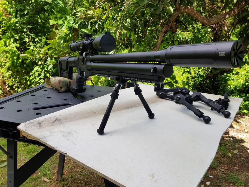

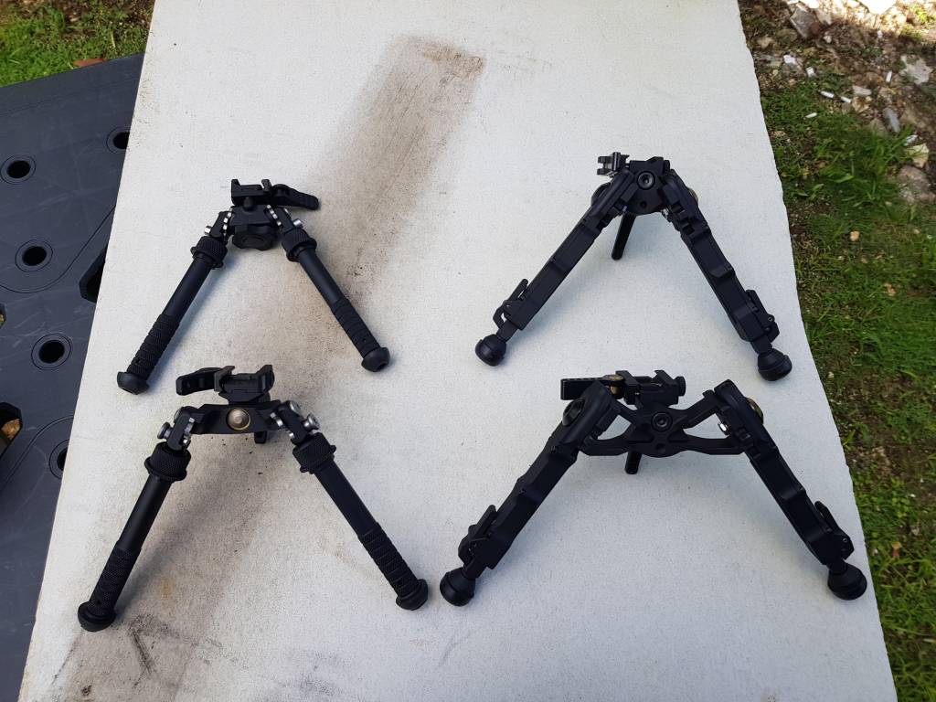

A lot of people also recommended the Accu-Tac BR-4 G2 which is a damn good bipod as well although it's heavier than the Atlas bipods if that's a main concern for you. I do agree with the others about he Accu-Tac BR-4 G2 being one hell of a solid bipod. Since you're mounting it on an Evol, I took a few pics of some bipods mounted on my Evol 30 for comparison.
Atlas PSR BT46-LW17...
Atlas CAL BT65-LW17...
Accu-Tac BR-4 G2...
Accu-Tac WB-4...
Group pic...
