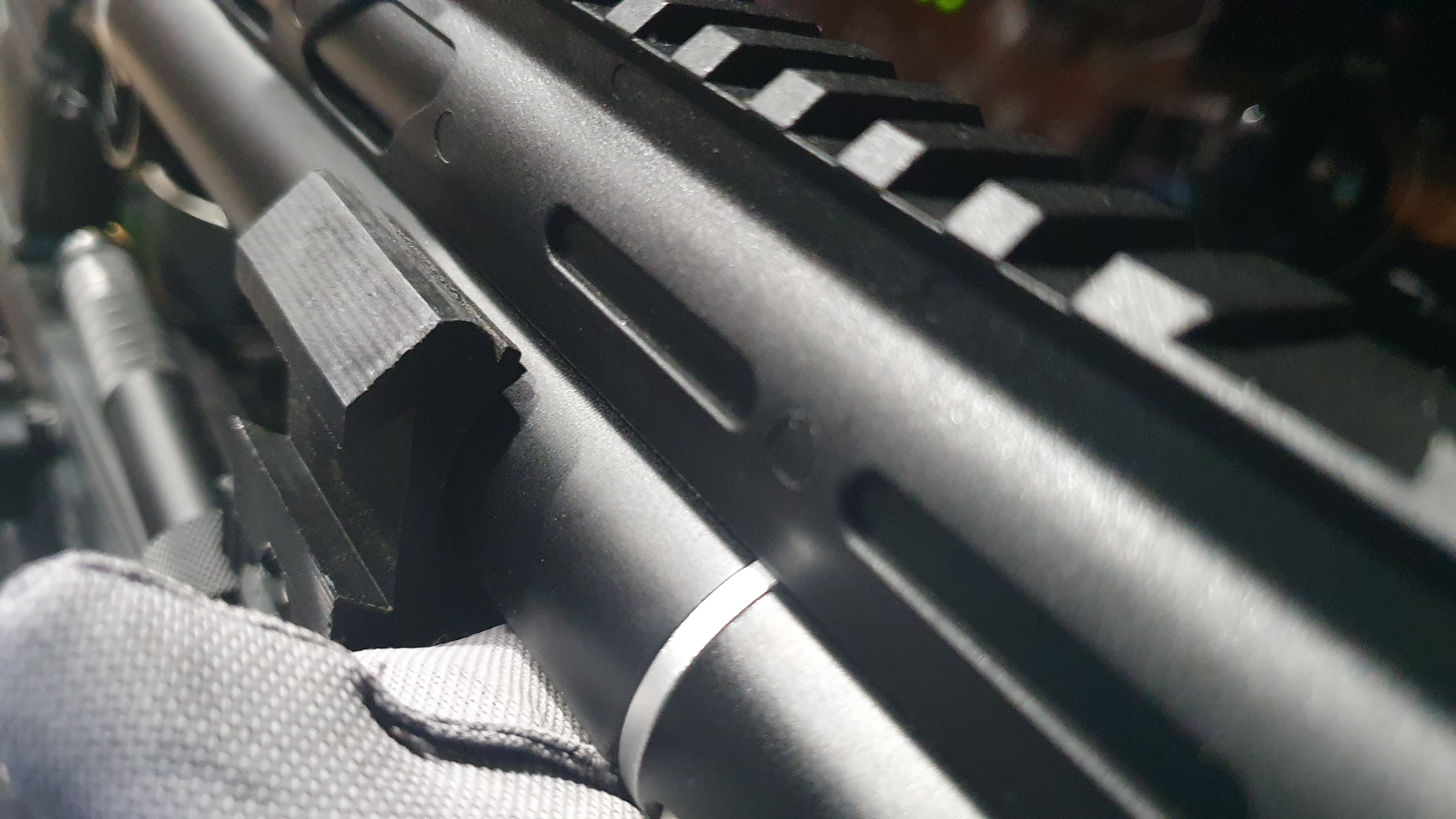

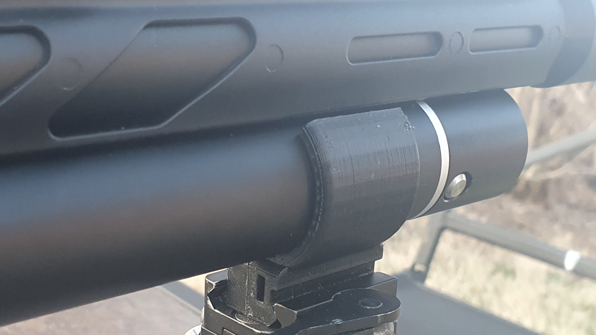

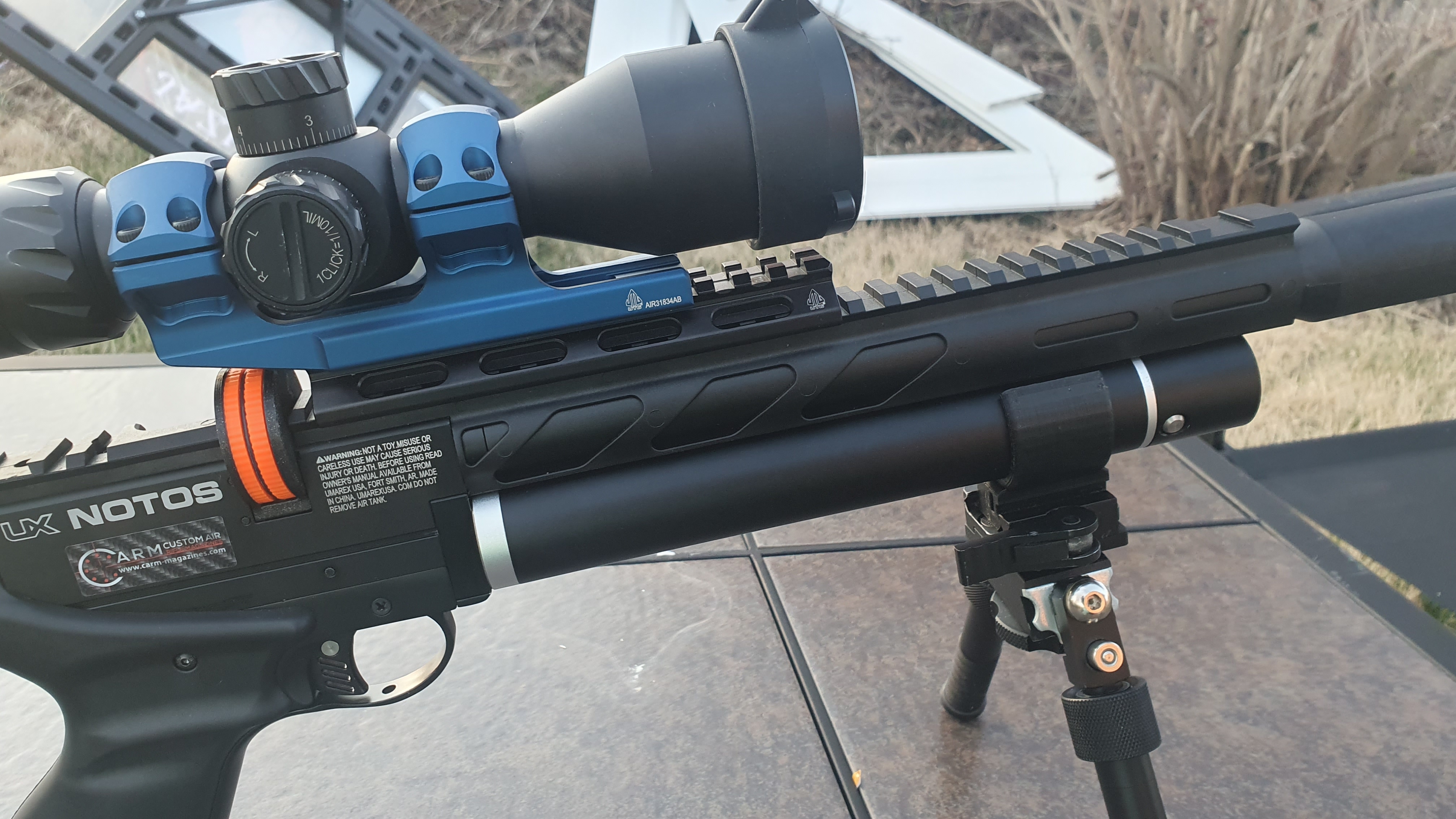

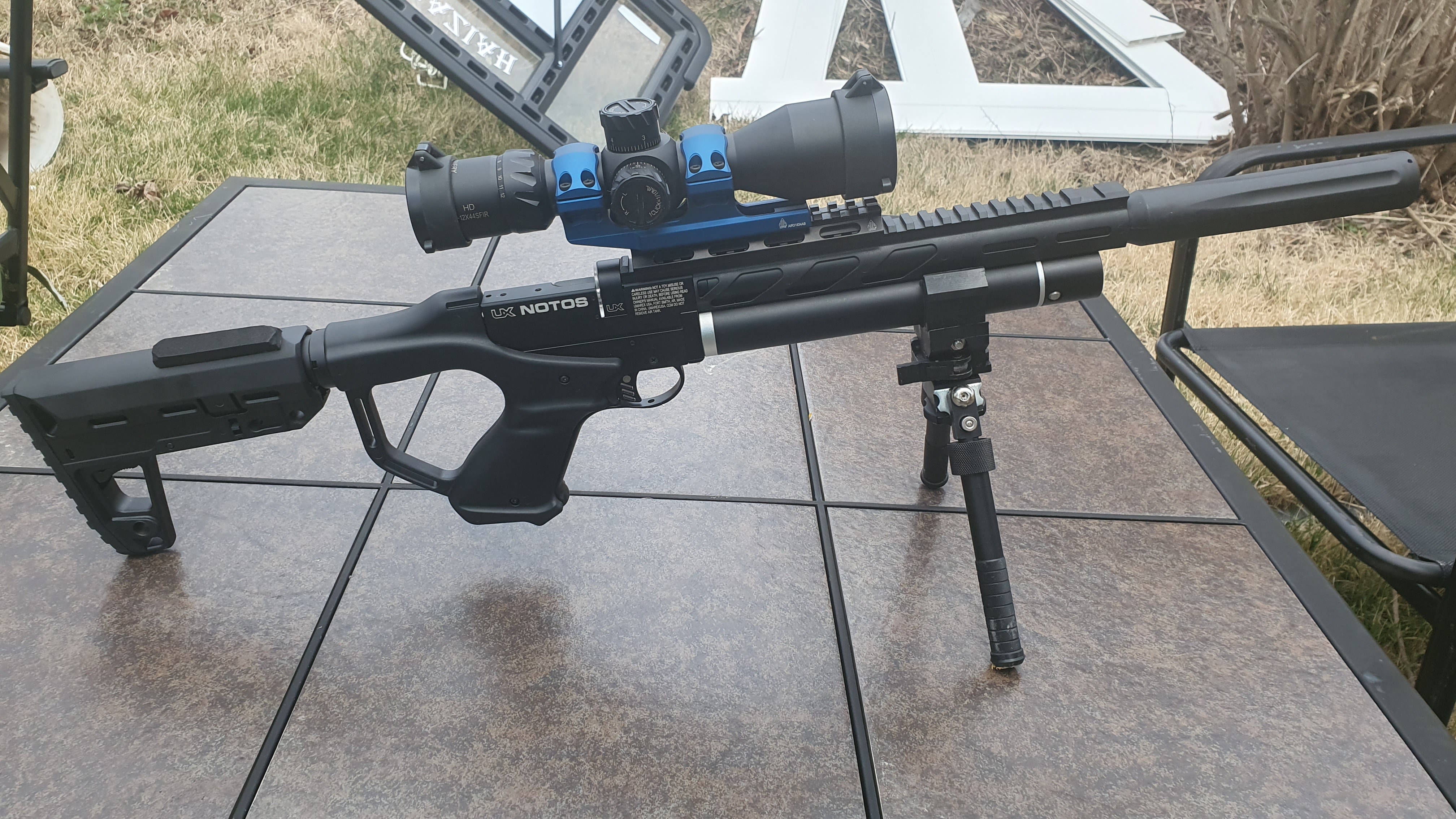

bipod on a notos?......YES :)
well,
took a bit on the belt sander,
and needed a thin bit of foam rubber between the mount and tube as the mount
(air venturi quiver and bipod mount from pyramyd)
is 1mm larger in diameter than the tube on the notos.
but it works :cool: bipod on a notos.
i have another bipod mount for the pp750 coming in the mail that will fit the tube better,
but dont know if it will work without removing the large top rail on the notos,
as the rail/shroud section sits tight against the air tube.

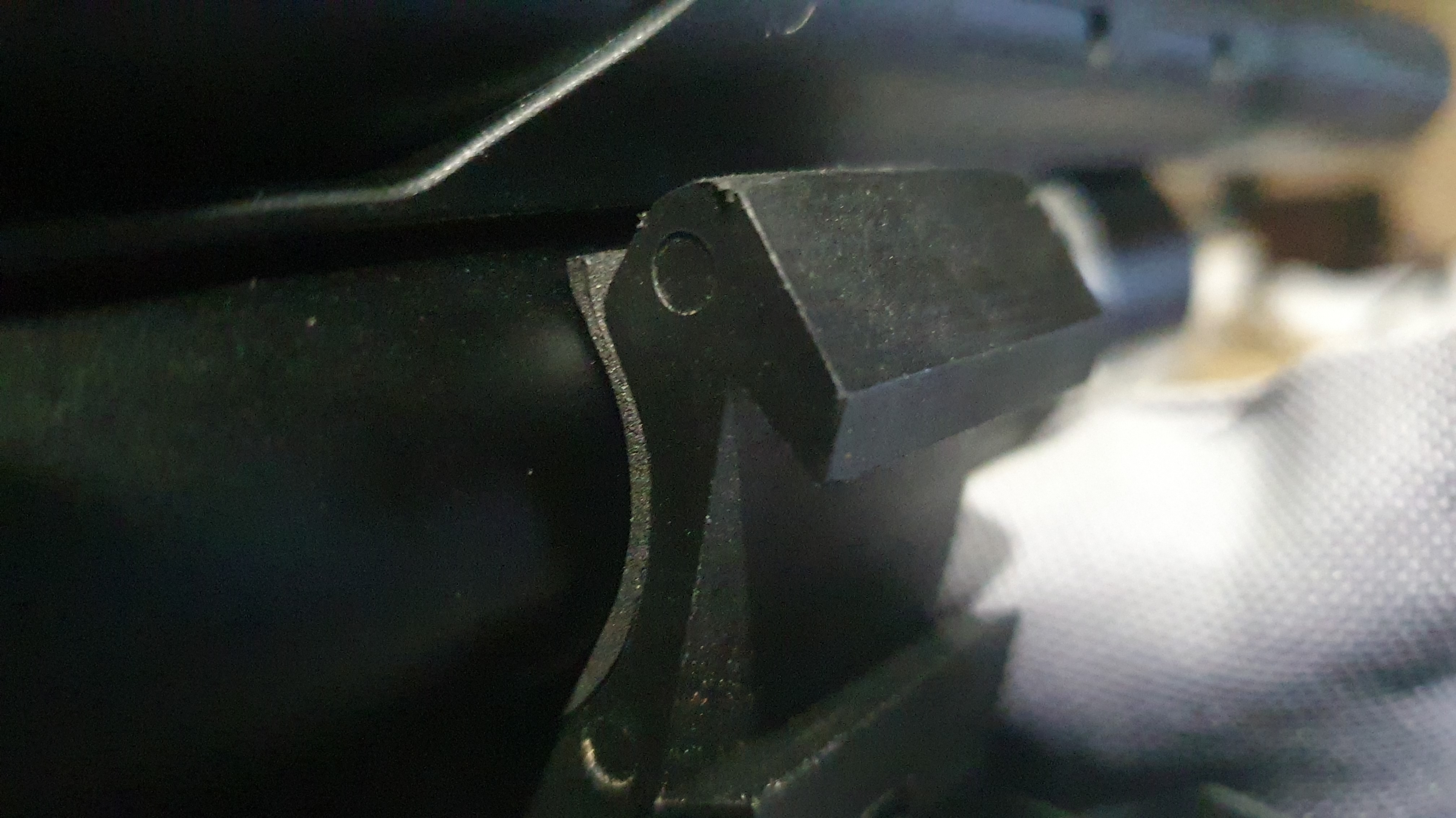

update!
the pp750 bipod mount from wes came yesterday,
its a WAAAAAAYYYYYY better choice than the mount from pyramyd!
it only took cutting out a portion of the center section so it didnt touch the rail/shroud,
and added double sided t-rex tape to the inside of the mount since cutting it in half reduces the clamping strength,
its much more solid than the pyramyd mount,
plus its smaller,lighter,and more streamlined.

Just ordered the mount from Wes. Thanks for the information, Anyway when I get the mount I am assuming the mod will be obvious? Thanks
