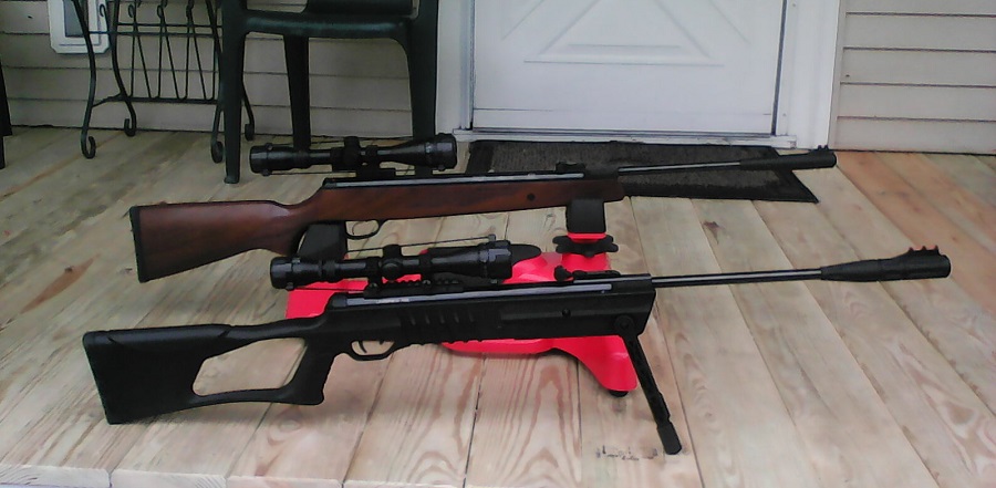

Umarex at one point actually made a rifle called the Fuel. Bought it 7 years ago before I joined forums and learned more about spring/gas rammed guns and bipods.
Pretty much the same idea as the set Airgun Detectives sells, but Umarex actually built theirs into the stock. No pic rails, they were mounted with screws through the stock to allow them to pivot when you wanted them. Unless they were designed to move back and forth when the gun recoiled, they were a bit wobbly.
My Fuel in .22 was also one of my oddball rifles because it actually shoots better with a firm hold than it does with the artillery hold. Also must not have been that great a seller since it's been a few years since they made them.

Downside is that if it doesn't, the OP now has holes in the stock he drilled to mount the rails for the bipod arms...lol.
For the little it's worth, I have a set of AD's setup. Bought it for a PCP that has pic rails but never did use it.
The Fuel I mentioned above I ended up taking them off. They tended to get in the way of holding the rifle
and if I wanted to try and use them to brace on something, I lost time and shots opening them.
