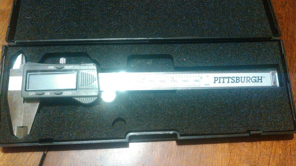

Caliper I was using to measure in inches how far off the pellet holes were from bullseye:
