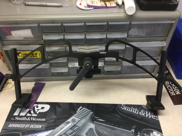

If I am shooting for X’s this is the bipod I used in F class shooting for years very stable, The regular Bipods tend to be unstable no matter what the price. I use a bag when shooting several different rifles on the range.
