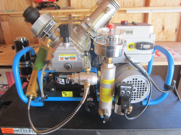

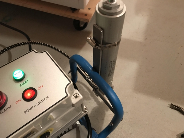

Got the carette unboxed, indeed it looks like a nice design unit, very quiet, I need to fab up a bracket to hold to the alpha filter on the mount for the factory carette filter, can't stomach hose clamping the filter to the frame, also going to fab up a expansion tank for the cooling system, no actual use yet but overall looks well built

"dirtbikerick"Thanks grandfather, I Did just that, ran it today for the 1st time, topped off my bottle and played with the auto bleed system, still waiting for my owners Manuel, so you opted for the alpha filter over the carette also, meaning yours did not come with the other vertical filter that's shown in my pics.
No, it has BOTH filters. It goes thru the smaller one first and thru the Alpha just before the air enters the fill tank.

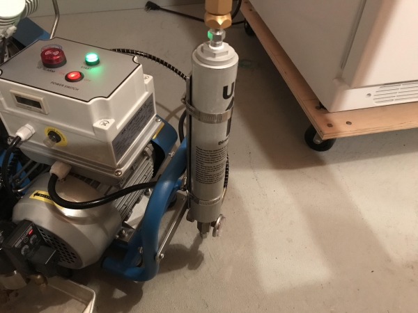

It's too late for Dirtbikerick, but as a Carette (not Alpha Carette) owner for a year now, I can tell you buyers interested in a Carette that the factory configuration pictured before he removed the factory filter to replace it with the Alpha provides perfectly adequate moisture removal at a lower cost to the owner. Alpha filters are nice, but redundant to the function of the filter that came with the unit from the factory. The purpose of the Alpha filter is additional profit for the seller.
