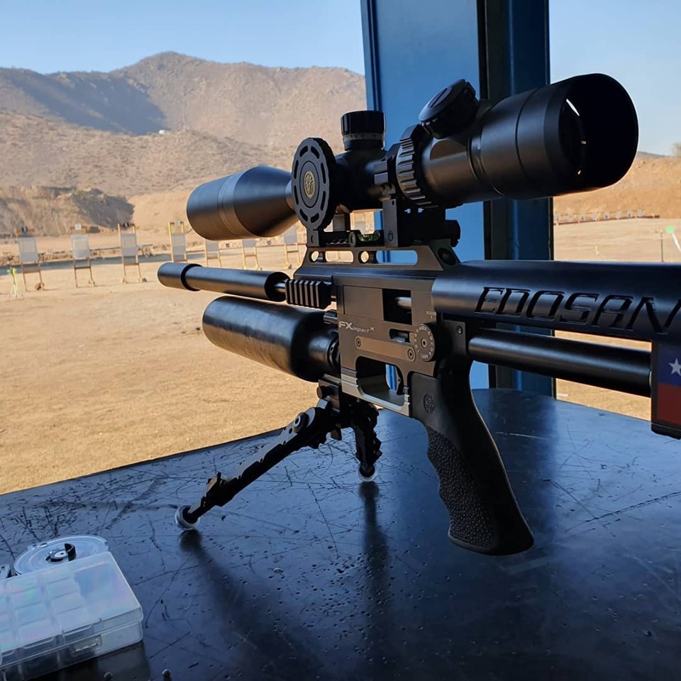

Wind was not so rough, and I did not use a FrontRest, only my bipod, here is a pic just before shooting on 25m (or yards ... mmm donno)

@nomojo65, I didn't mean it that way. I was more thinking that in swirling winds, 744 is just about impossible, so his "winds" were probably light and not swirling. Look at the overall winner at RMAC 2019 at 25M BR, who had a score of 732-28x out of over 60 shooters and won with a .22 Impact. And that is in Unlimited Class where some shooters were shooting 50 FPE .22 caliber RD Monsters. But even with light or no winds, 744 is a great score...
I like to put names on my Rifles, Silver Surfer is the Big Kahuna! jajaja (my other impact) but this one I will call it BLACK MAMBA (accurate bite!) , still need work to do and get 0.177 and a few more things... new scope ... :D (just having fun guys)

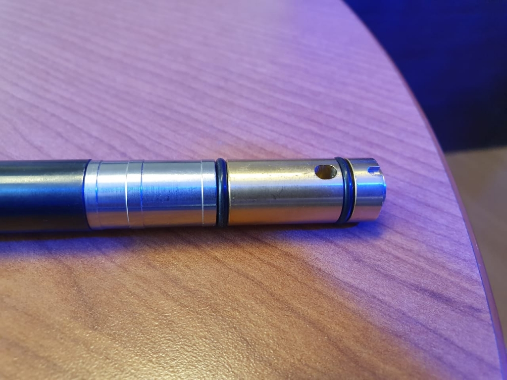

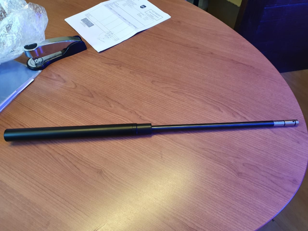

I will also fit a LW barrel, I have seen in poly air chocked with 6 and 12 grooves, any advice? fx have 500mm only...I prefer 600 or 700mm
I’ve had really good luck with LW-poly barrels in both of my RAW’s but they came directly from Martin Rutterford but do believe they hand picked and lapped etc.? As far as land & groove barrels my LW-12 groove was extremely accurate on my TM model! I don’t have the skill or machinery to do what your thinking or I would try it, my main concern is getting a .177 FX barrel to shoot in USARB HV CLASS and if I can get velocity down to about 820fps with 13.4gr jsb’s and still be accurate? I was thinking 500mm barrel, I think that’s all the .177 is offered in?
Well edosan, I want to make it clear, most will tell you the poly barrel is the way to go! And I agree for the 13.4 jsb’s (maybe I just had an exceptional 12 groove?) also the 12 groove liked the 10.3’s better! I believe it has more to do with the thinner skirts of the 10.3’s conforming to the land’s & groove’s for a better seal between pellet and barrel? IMO?
