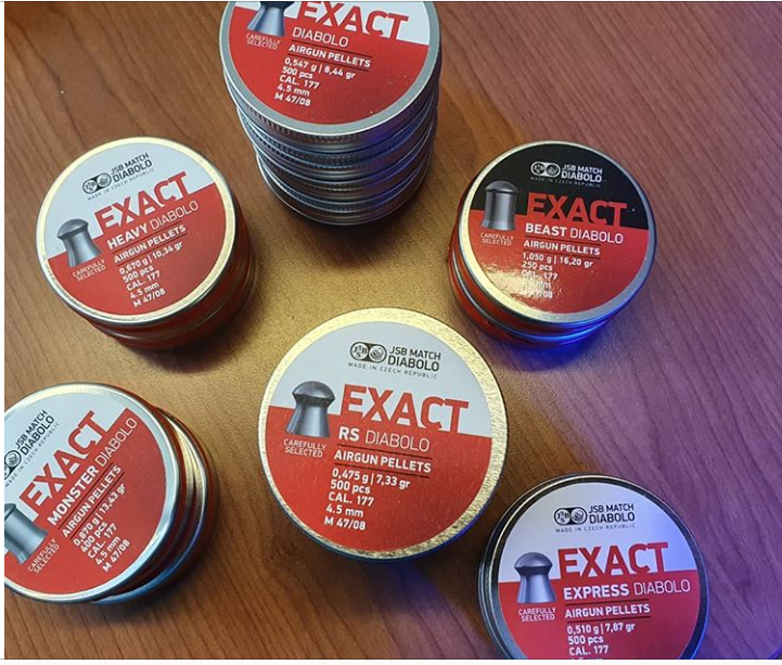

Today I manage to make the mods and speed went up from 850 to 910, but accuracy with the jsb 10.3 gn is just not there. Test from 800 up to 910 no luck, groups over 1 inch @ 30yards. Next week I will get a bunch of other jsb in different weights for testing.

Yesterday in another benchrest competition I end up in open class, shooting the 18gn jsb 0.22 cal @ 890fps with 246 points on gusty but light wind. Hopefully I will get my .177 pellets this week to continue my tests with BlackMamba on LV and HV categories!
