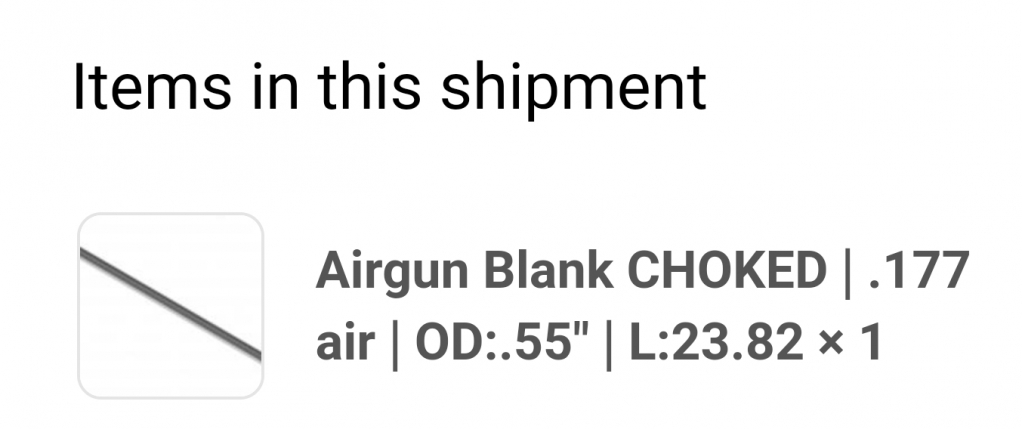

Well, just finished my testing and I have to say that the 0.177 fx stx barrel 500mm suck for extreme accuracy. Liner is too pellet picky (wide), and I manage to make a few good groups, but nothing extraordinary. For sure I will never use it in a br comp. the 0.22 is another story. Test 6 different jsb pellets from 600 to 900 fps and big nono! For hunting is ok, for precision shooting 👎 (just my experience)
Just bought the lw poly choked air 12 grooves to fit, will see how it goes

ppd, have you got a link to the barrel blank you ordered please.

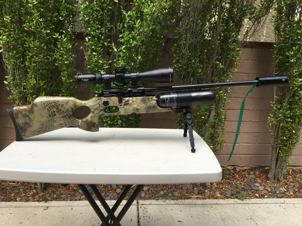

Cool. Of course the .177 barrel had to be modified to fit the Crown. I have no shroud just a CF tube “sleeve” and DonnyFL Tatsu. Was shooting it this past weekend at 50 yards and getting 1/2 inch groups with the pellets I mentioned above. This is my Hunter FT gun but I am shooting it 25M BR just to confirm accuracy and for the fun of it. About 19 FPE. Something to be said for the “old” solid FX ST barrels... The .22 version on my Streamline shot 734-30x last month in windy conditions at 25M BR and the .30 version in my big Cat won EBR 2019 at 100 yards. All three guns have the solid ST barrel pre-liner...
