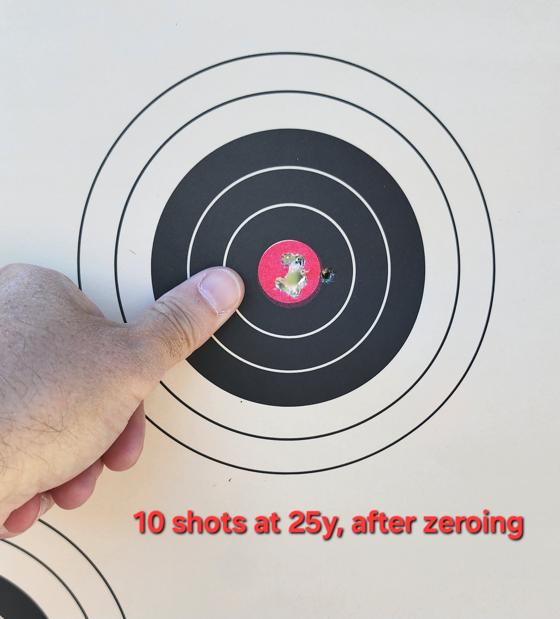

nice!
moderator must slightly decrease FPS ??? unless it's so heavy it tips the barrel down... which i doubt.
were you on a stable bench?
The moderator will tip the barrel down! Do it at 50 with your ghost and it will be different too! Its more on the blackwolf cause the black wolf barrel hangs out there more!

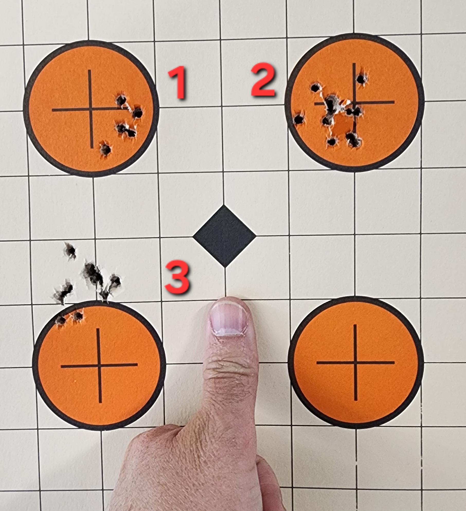

So I built a rubber mulch pellet trap this morning and messed around with my Blackwolf a bit. I had some luck with group improvements with the regulator at 130 and power around 16. I only have room for a 20 yard range so I'm not reading too much into it until I can get back to 50 yards at the range. But at least I'm getting more shots per fill, and having fun as well.
I took the gun apart to degas the bottle. I don't think I had to but the manual said to, so I did. I also took the barrel off just to check things out. I couldn't get the shroud completely off because I didn't have a tool for the end cap.
One big surprise was that the laminate stock was very light when I took it off. Shocking, really. I didn't weigh it though.
I'm going to leave the regulator setting in place until I get a chronometer, and just experiment with different power wheel settings for fun.

Check classifieds... a certain cave person has a brandnew MK3 Air chrony for sale.
Also you could drop that reg pressure down to 115 as a starting point.
And YES you always have to degas the gun completely to decrease reg pressure...
you can increase reg pressure without degassing.

Yep, as others stated degas is necessary to decrease reg pressure. Since you can go up but not down under pressure, you’d start tuning with a “likely too low” reg and then work your way up slowly until you hit target speed (on the knee of the curve, meaning max speed a tad higher than target speed). Buuut you need a chrony to make that process worthwhile ;)
