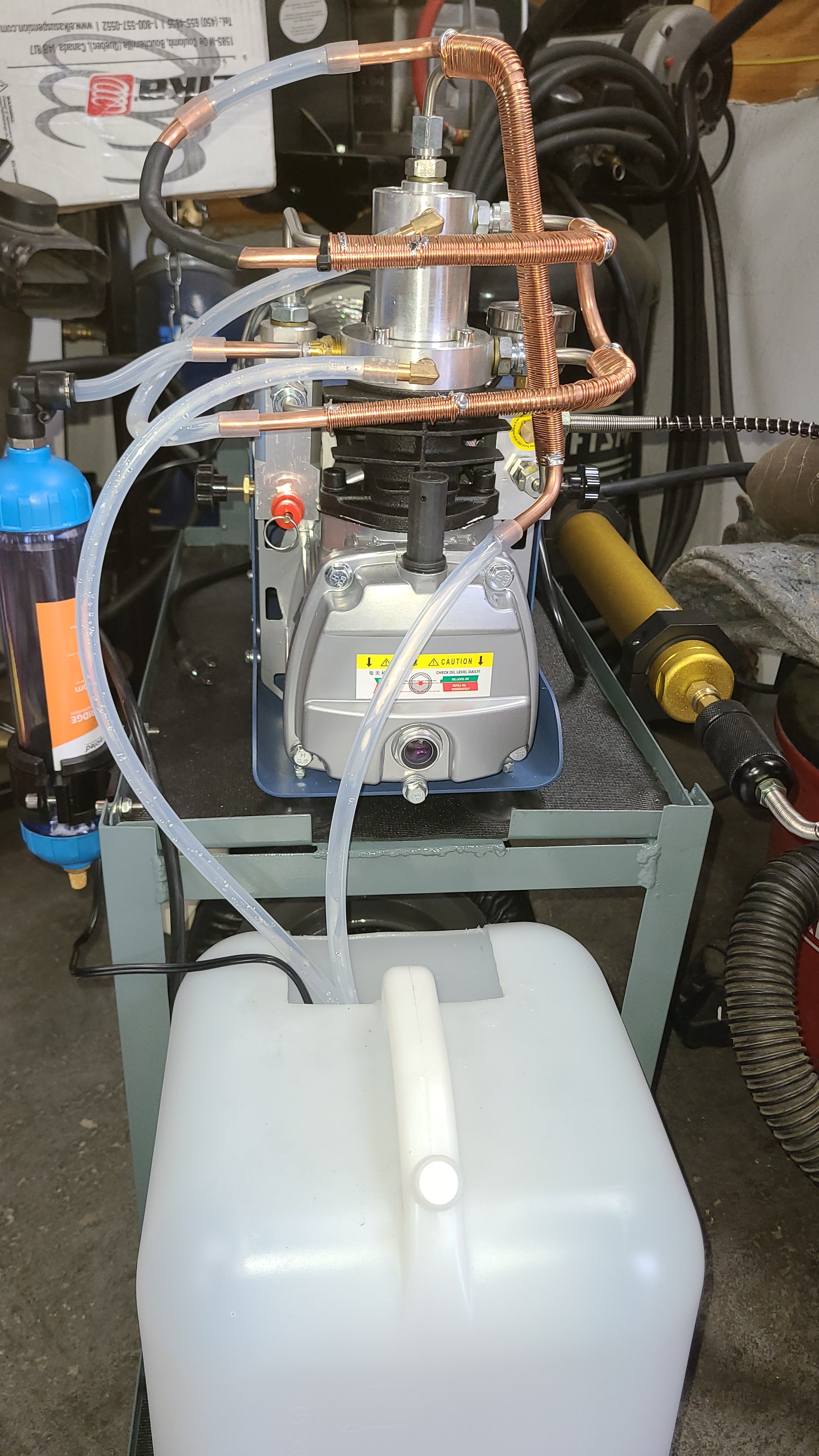

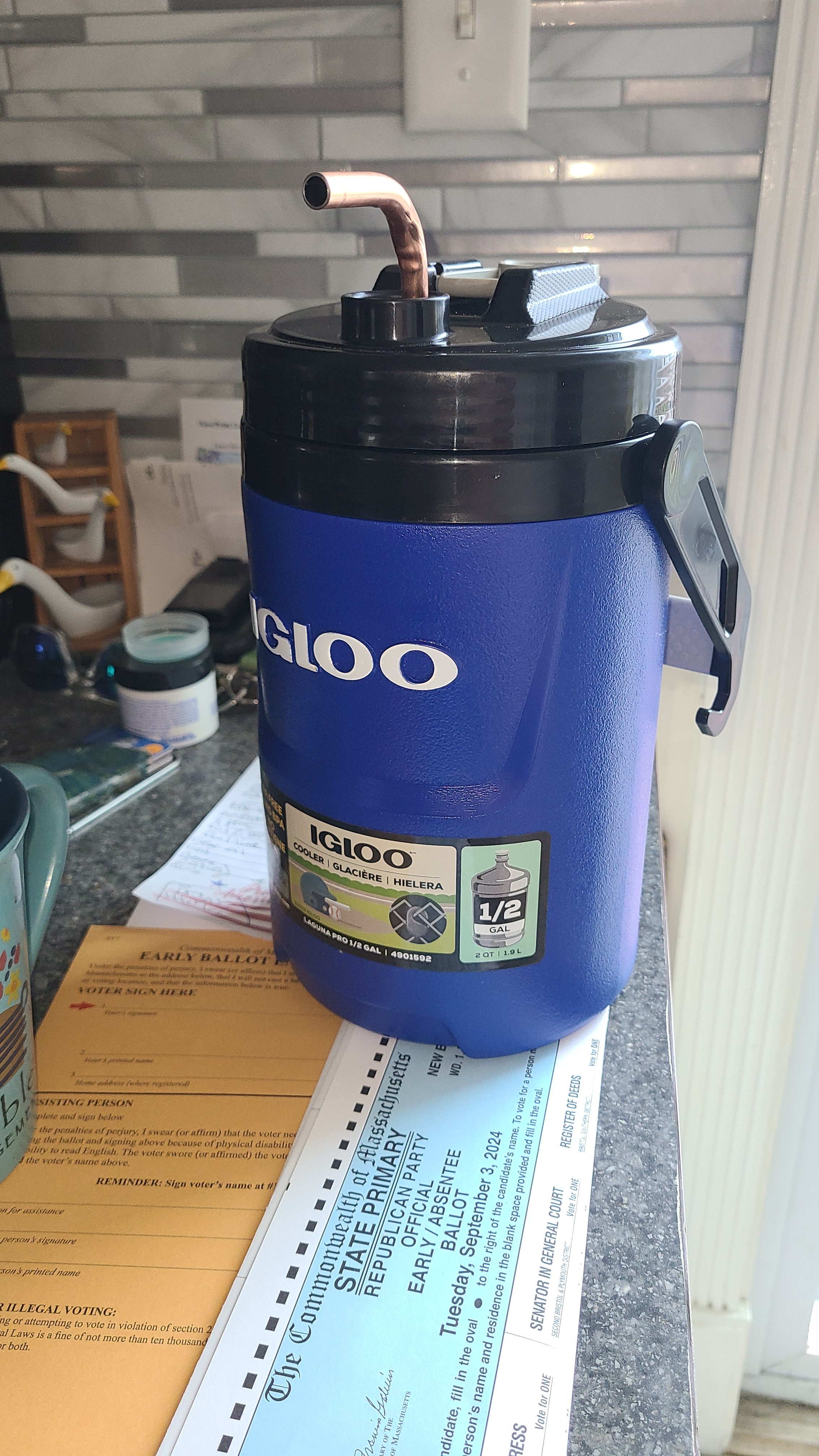

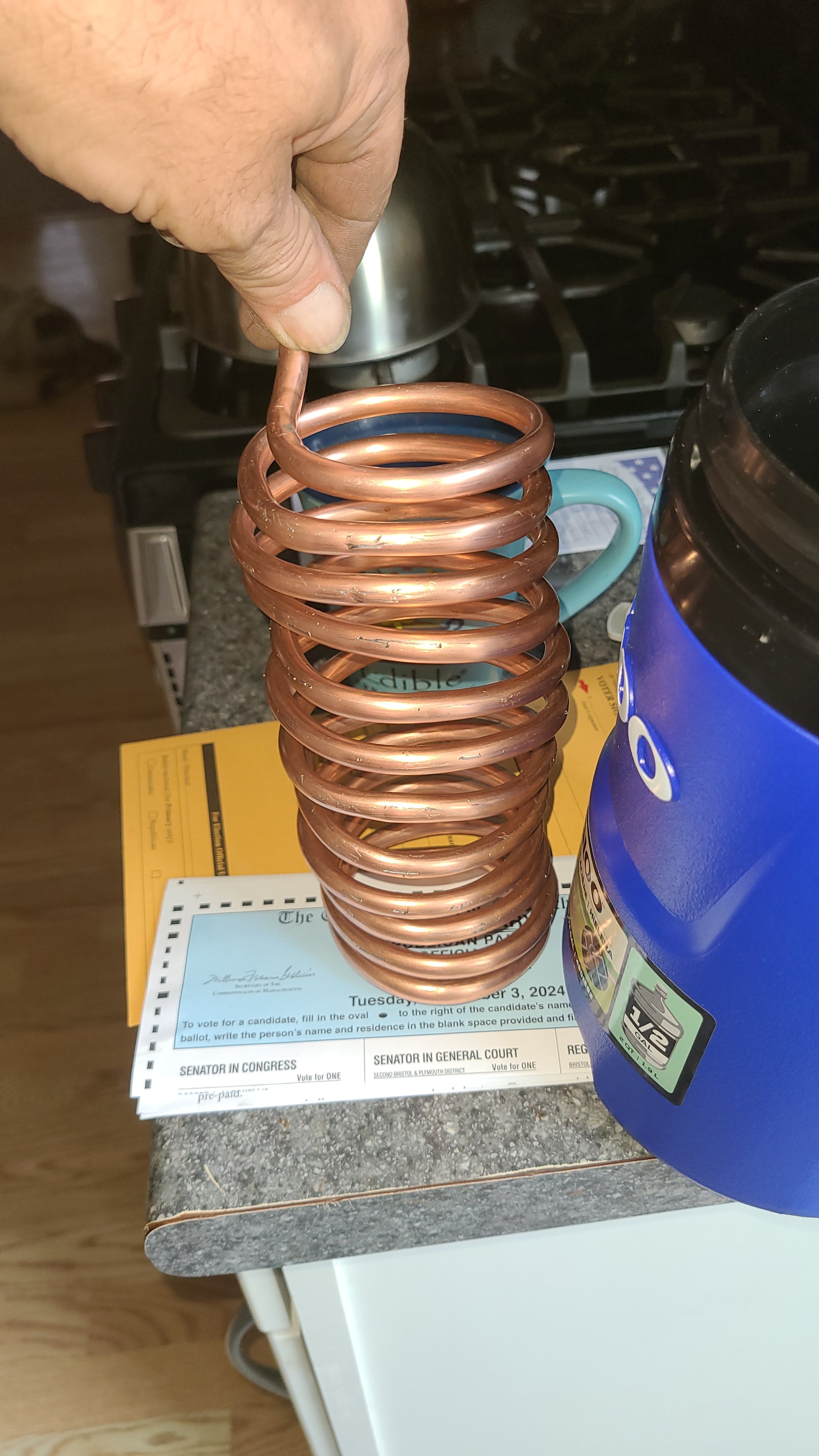

i just made a simple cool can with 1/4 copper tubing and a 1/2-gallon igloo round cooler full of ice
put it on the return line and it cools the water going back to the 5-gal tank
i also wrapped all 3 high pressure lines their water cooled as well.
i can run this compressor 1/2 hr=40 min and keep temps to 45c usually fill 1 1.6l bottle at a time

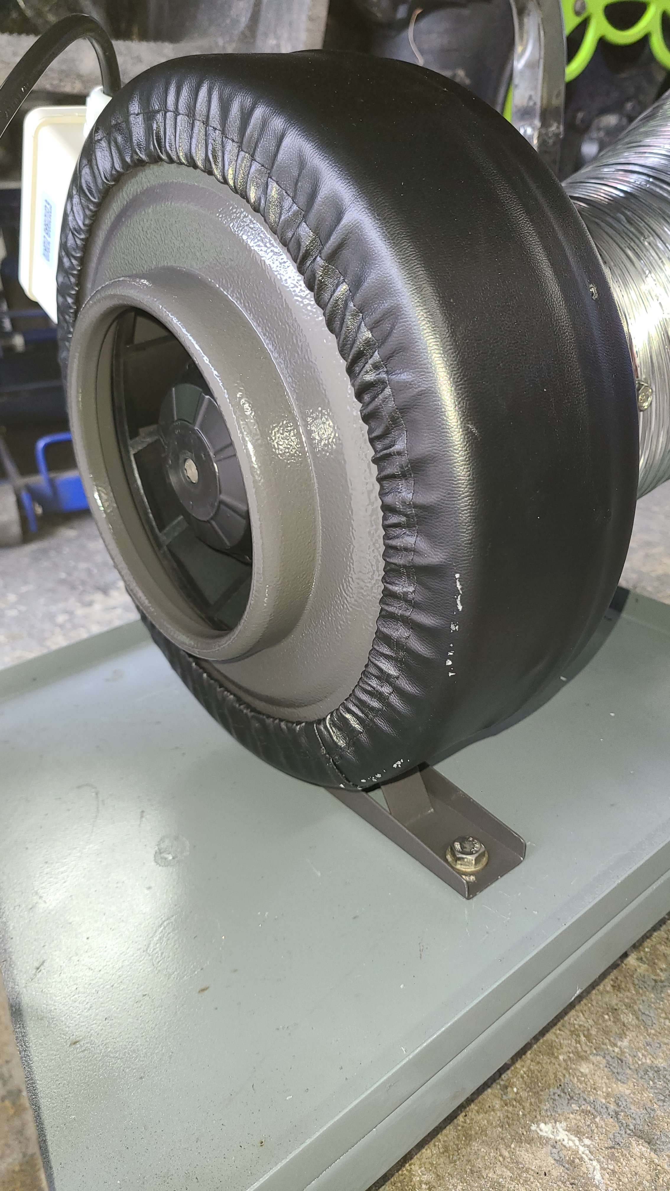

1 also added a 8 in 480 cfm cage fan keeps the Elec motor and electronics cool as well.
i use royal purple (been using for 20+ years in my drag cars no issues) i also added an hrs. meter and change the oil every 3 hrs. of use
That's some fine "cooling mod" work you did but I have a question. With the time you invested in cooling off the water return (back into water reservoir) do you think your water going into the compressor would be any cooler than MY water? I keep 2, .5 gallon plastic milk jugs full of water, frozen solid in my freezer & drop into bucket when I run the compressor. I'm willing to bet that after all that work you invested in cooling your return water it's not any cooler than mine going out (to compressor). Only takes me a few seconds to drop my "ice blocks" into the bucket or return them to freezer. You did NICE WORK but was it worth time & mat'ls invested?
Same here using frozen jugs out of freezer. I think the weak link is the top aluminum 2nd stage shroud and its ability to transfer heat. I have seen considerable inside corrosion build up from Cotton's 5 year old rebuild. I'm trying out Red Line water wetter instead of antifreeze, in the past, to avoid any issues. I think I'm a bit faster off the line...
