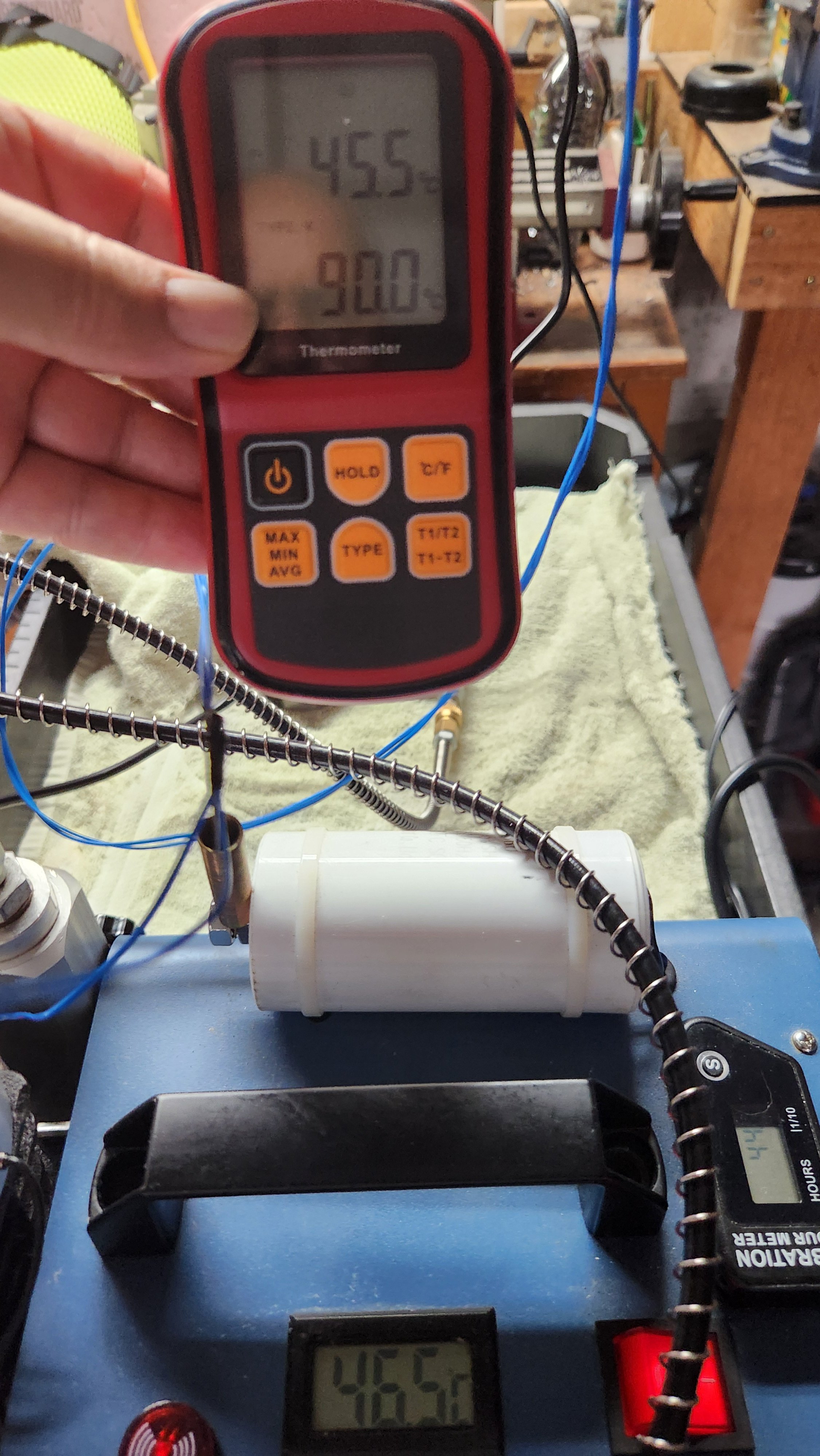

i just made a simple cool can with 1/4 copper tubing and a 1/2-gallon igloo round cooler full of ice
put it on the return line and it cools the water going back to the 5-gal tank
i also wrapped all 3 high pressure lines their water cooled as well.
i can run this compressor 1/2 hr=40 min and keep temps to 45c usually fill 1 1.6l bottle at a time
1 also added a 8 in 480 cfm cage fan keeps the Elec motor and electronics cool as well.
i use royal purple (been using for 20+ years in my drag cars no issues) i also added an hrs. meter and change the oil every 3 hrs. of use

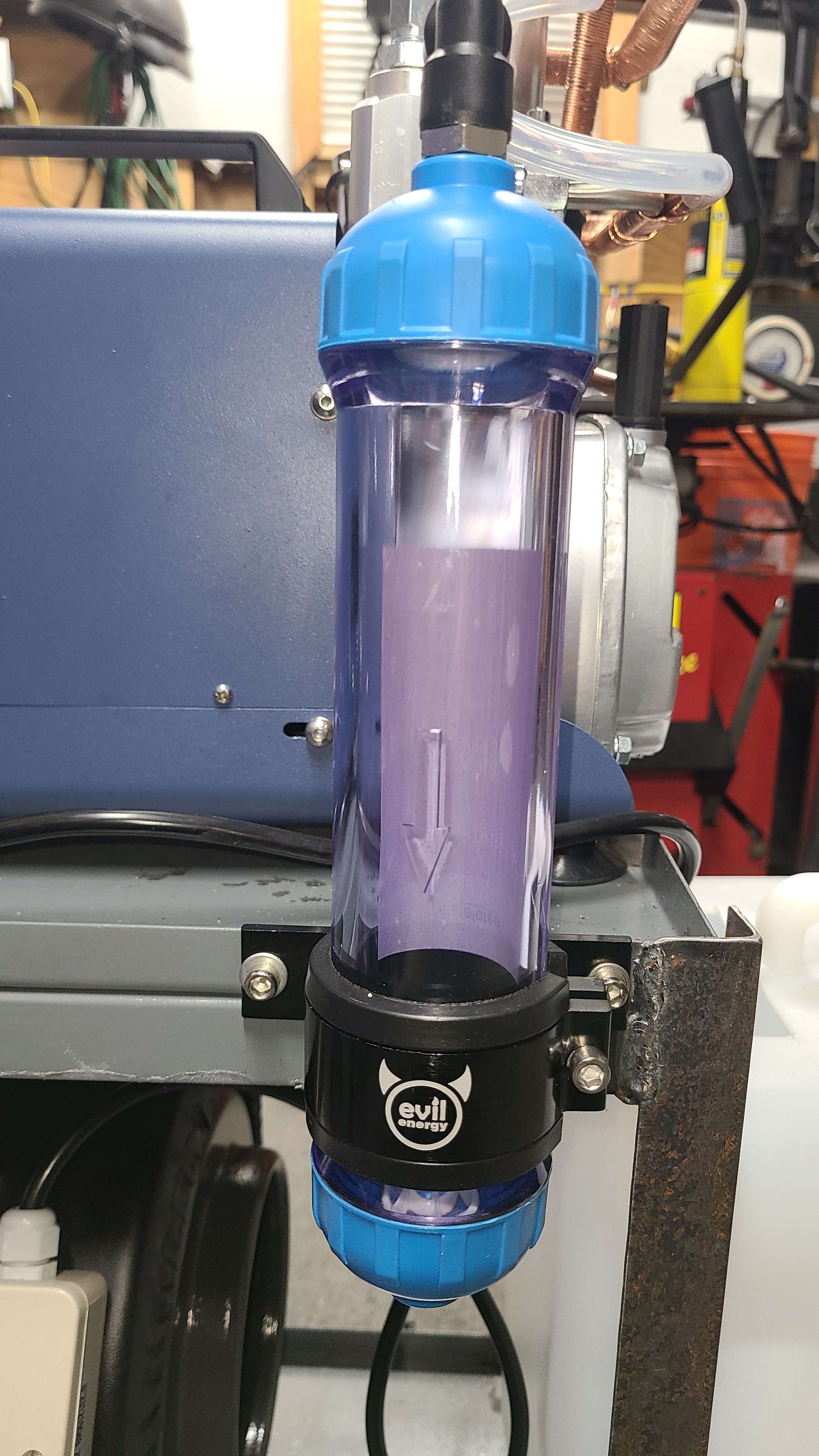

i have a water filter housing filled with beads connected to the intake of the compressor. that made a big difference in moisture along with cooling the lines slowing the water circulation down through the cool can and back to the tank as well comes into play can't cool with water gushing through it.

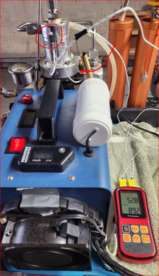

About heat on cylinder heads...here are 3 readings on a freshly rebuilt first+second stage from a kit. The pressure is about 250 bars in this picture after some 15 minutes run time.
The Temp #1 probe is attached to the most highest point on first stage = low pressure cylinder ribs deep to the main body;
The Temp #2 probe is attached to the most highest point on second stage - high pressure cylinder - cap;
The YH Tamp sensor shows the water flow.

That motor gets blazing hot, no? I have been using a big box fan to force and cool whole unit including clamp on fins on SS tubes instead of wrapping with copper. Makes easier for any work needed.

thats why i used a 8 in grow tent fan it moves 480cfm and is adjustable and whisper quiet

i run mine for roughly 1/2 hr. 40 min tops never exceeds 45C cyl temp stays between 130-135 degrees head temp between 82-98 degrees
using the home made (cool can) be full of ice does 2 things 1 slowed the water down and 2 is cooling the water going back into the tank
that was a win win these compressors have an operating temp so to see cyl temps between 130-160 isn't out of the norm
cooling to much can also cause problems so id say if you're up to 45-50c your fine
