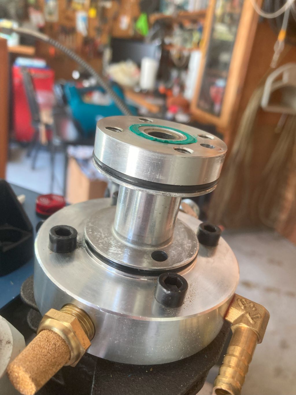

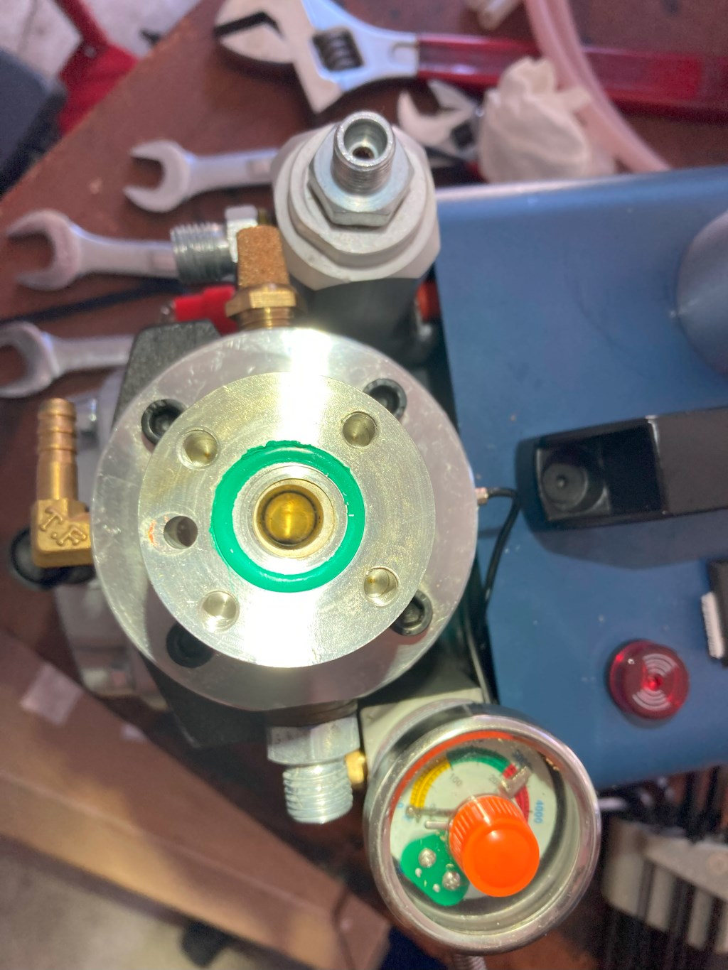

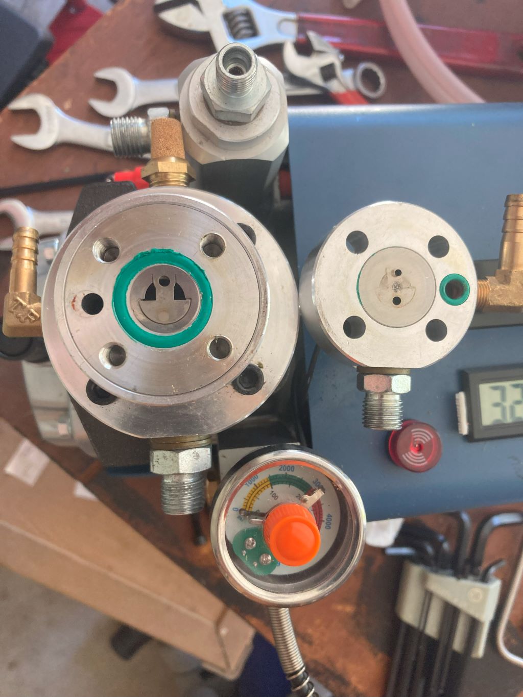

Pulled top cylinder head and tank. All was super clean with no visible black gunk on top of 2nd stage piston. I think I’m going to reverse here and reassemble then clean all check valves. I’ll reorder the seals used and wait for another 10 hours or so. I’ll see about ways to further lower tank temp to avoid the blackened oil if possible.
Distilled water and light mix of antifreeze used for first 2.5 years, switched to Red Line distilled water for the last 2 years. The Seco Lube seems to be holding dieseling down in the 2nd stage for last 2 years.

My pump pressure is fine, From the posted pictures do you see anything nasty about the valves? The uppermost reed valves are light tan with no build up.

Looking at the drawings,oil mist thru bottom piston rings gets filtered thru the moisture / oil separator, front left. The bottom half of the 2nd stage could see some oil mist through the rings, no? I'm thinking the 2nd stage pressure seals center and self lube and wipe the 2nd stage bore to keep any dieseling to a minimum. I saw no evidence of black carbon on the output side of my second stage, top reed valves very light tan to bare looking.
