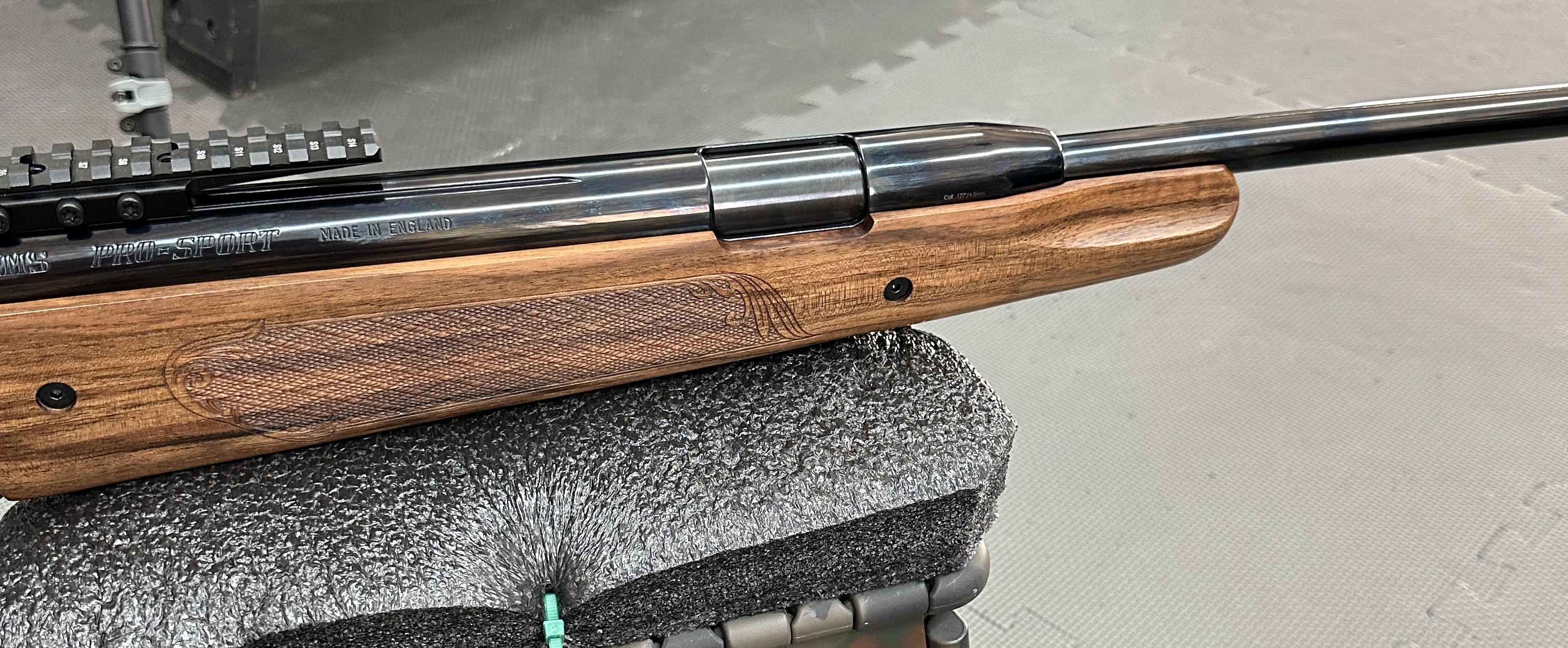

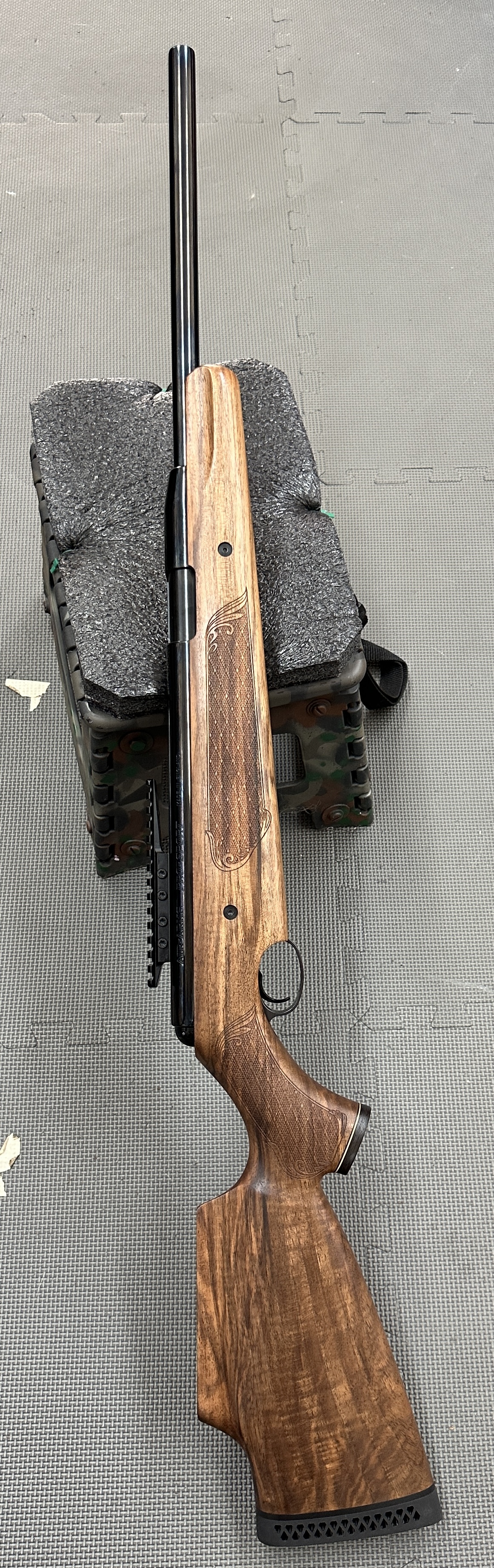

Anyway, lets start with a picture of the rifle after I took it out of the box, with it's bone dry wood, but it still looked good...
Happy camper that day. Since then I've tinkering on it, and have changed pretty much everything from stock form. Quick run through of the changes I did... Stripped all factory lubes, made new spring guide and top hat, relubed with Krytox. I then blued the safety button.

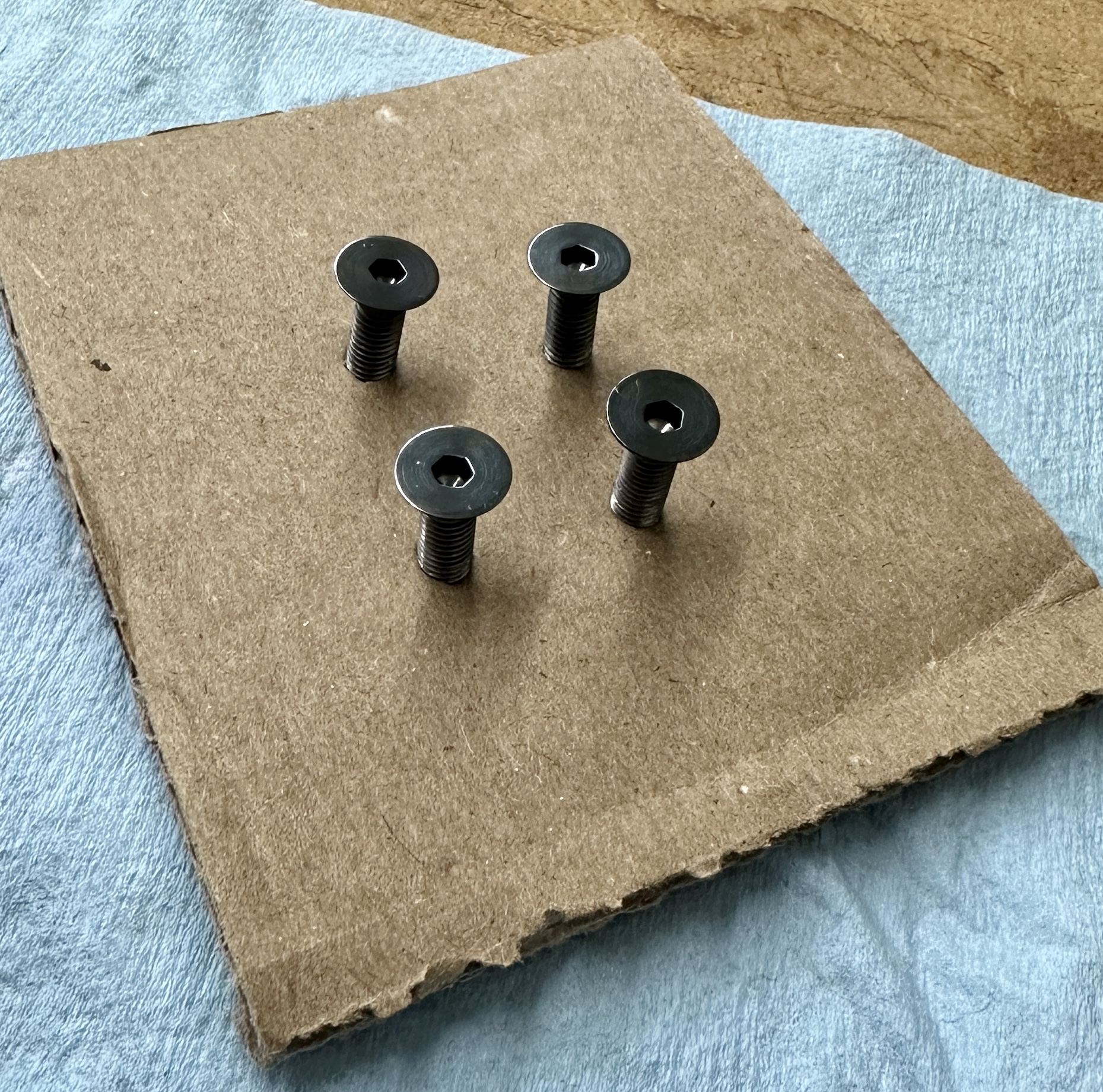

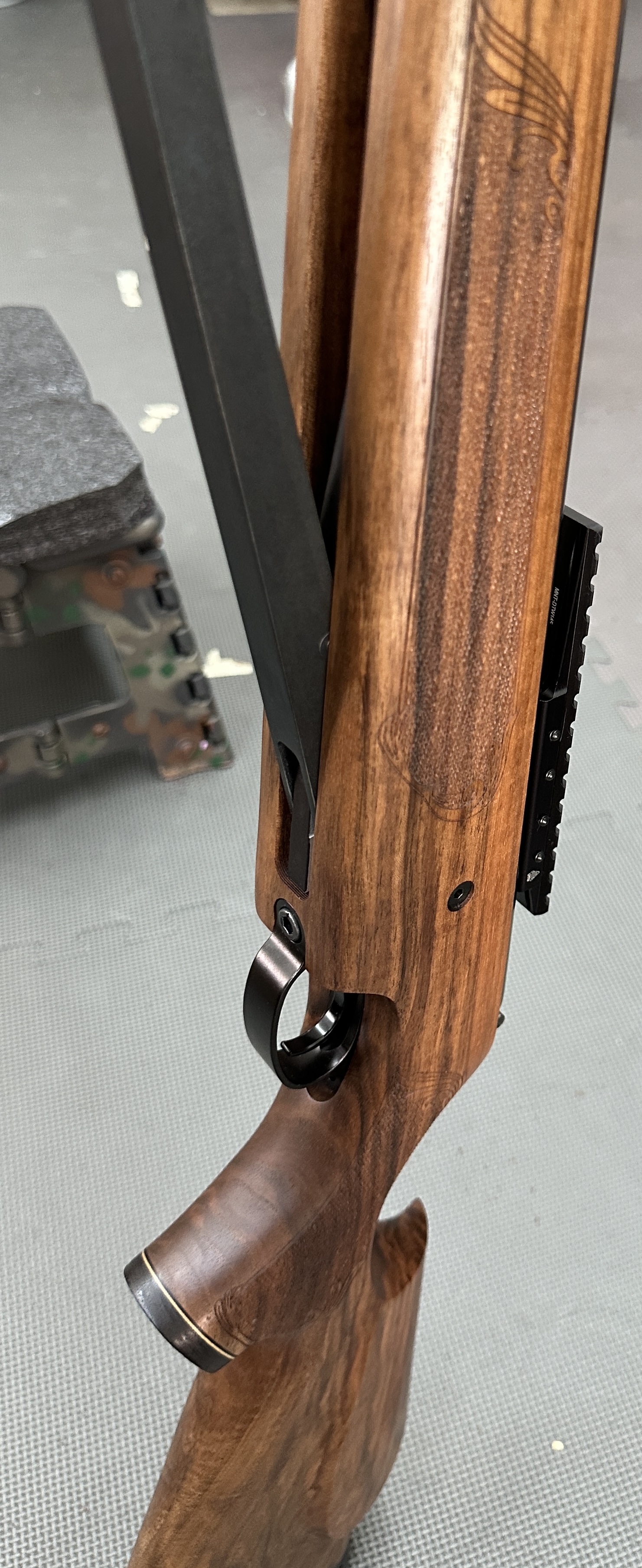

Followed by polishing and bluing the stock screws.

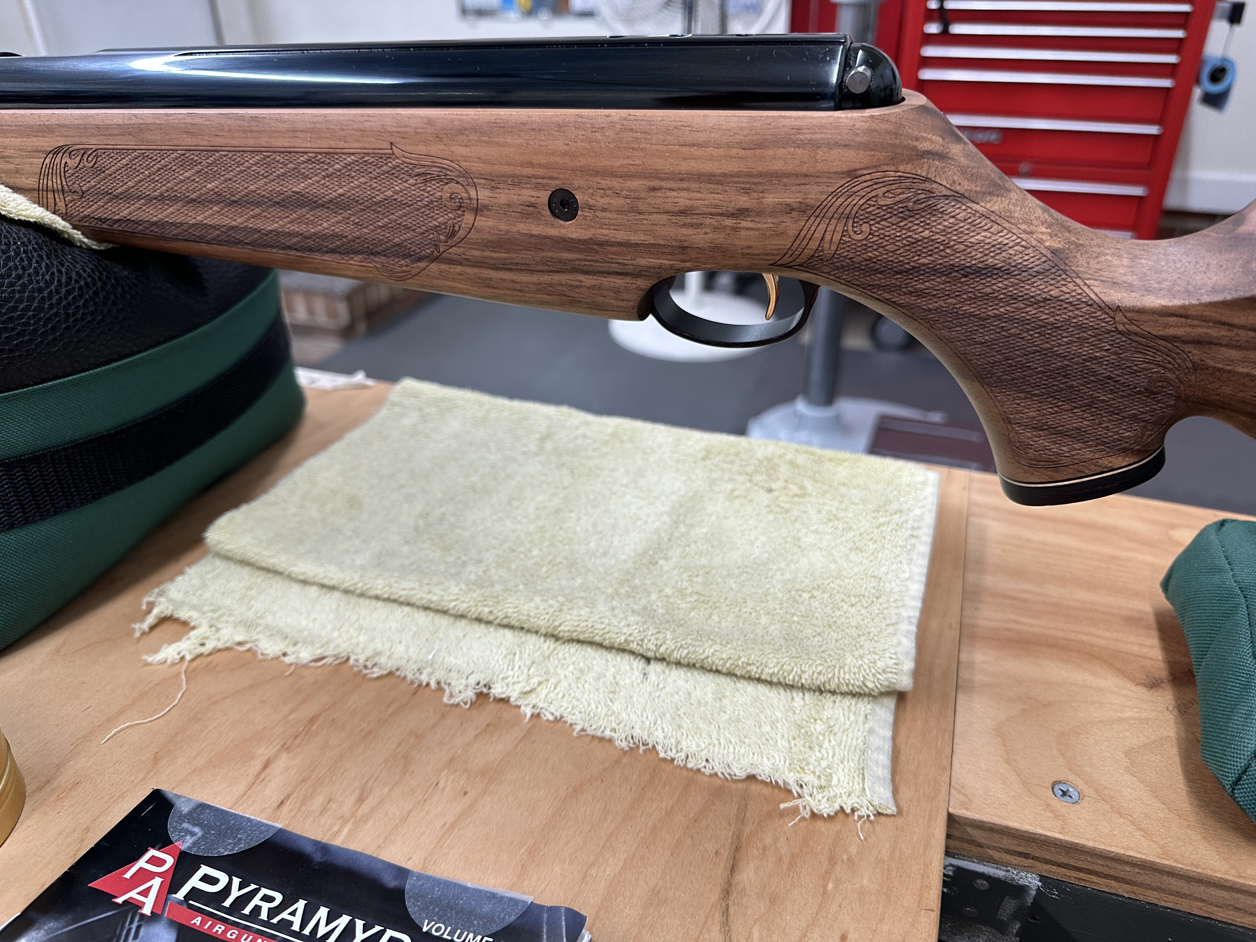

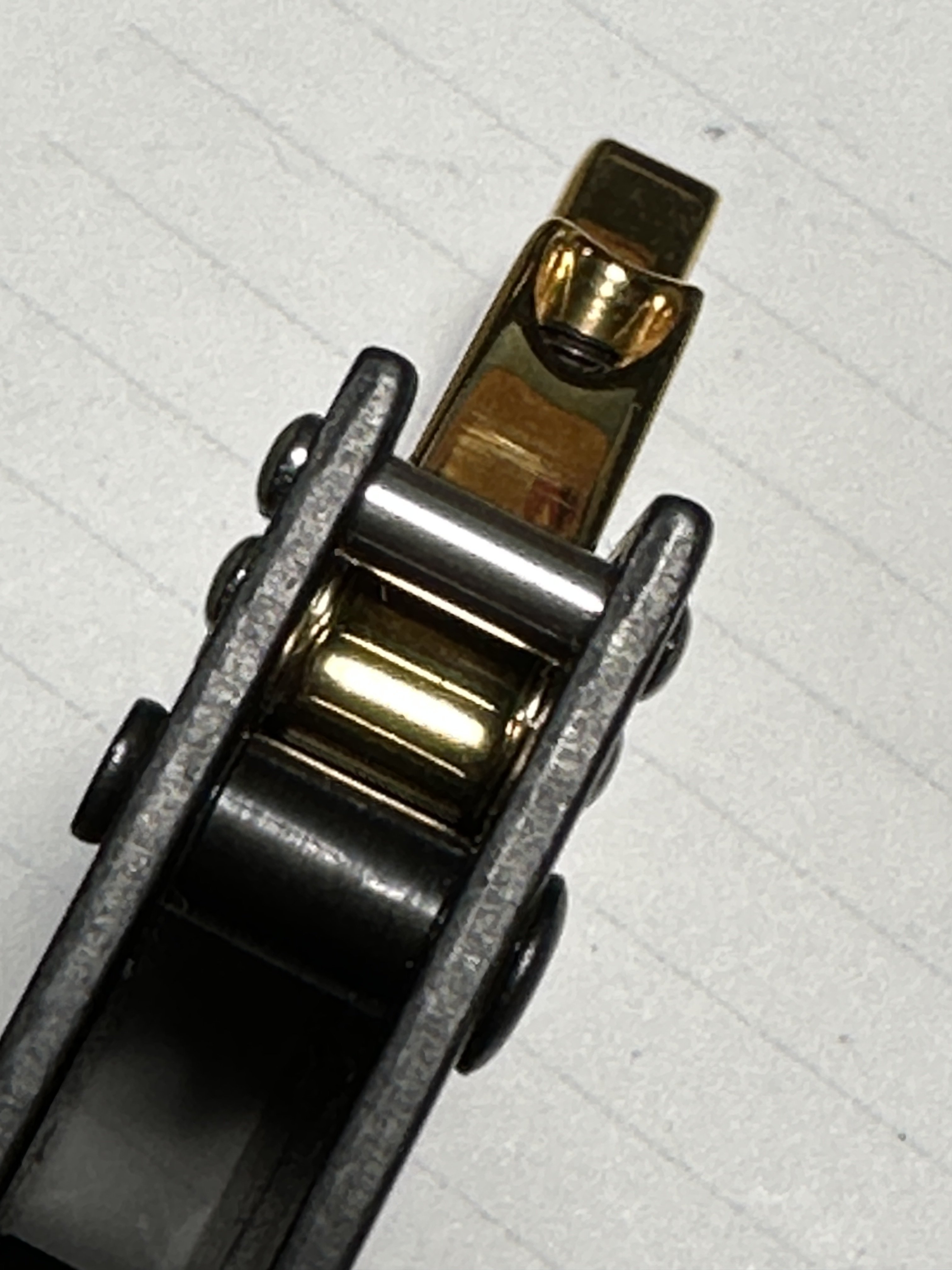

Then polished out the trigger sears and made washers to help with side to side trigger blade play...

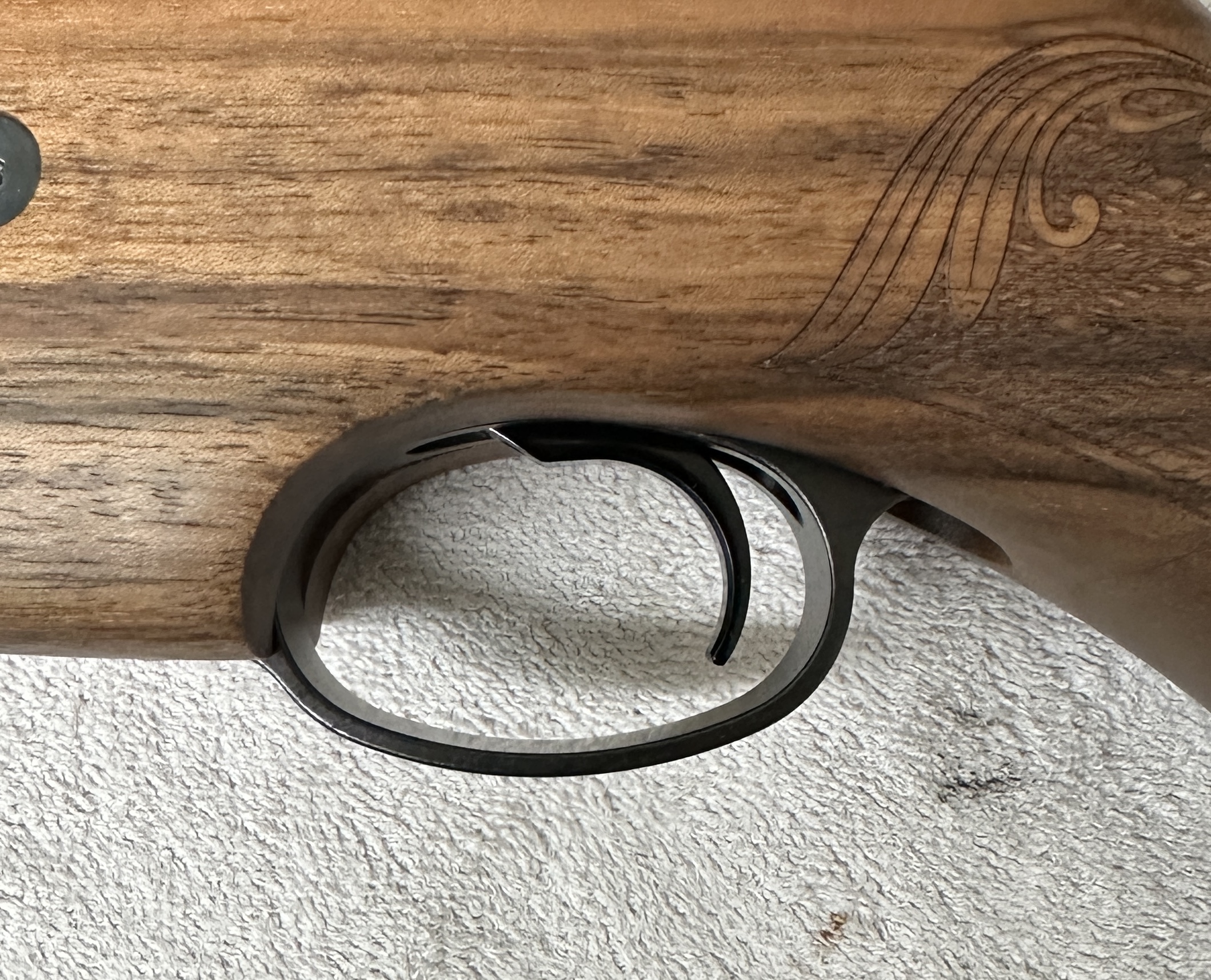

Next was to replace the gold trigger with a Rowan set back trigger in BLACK.

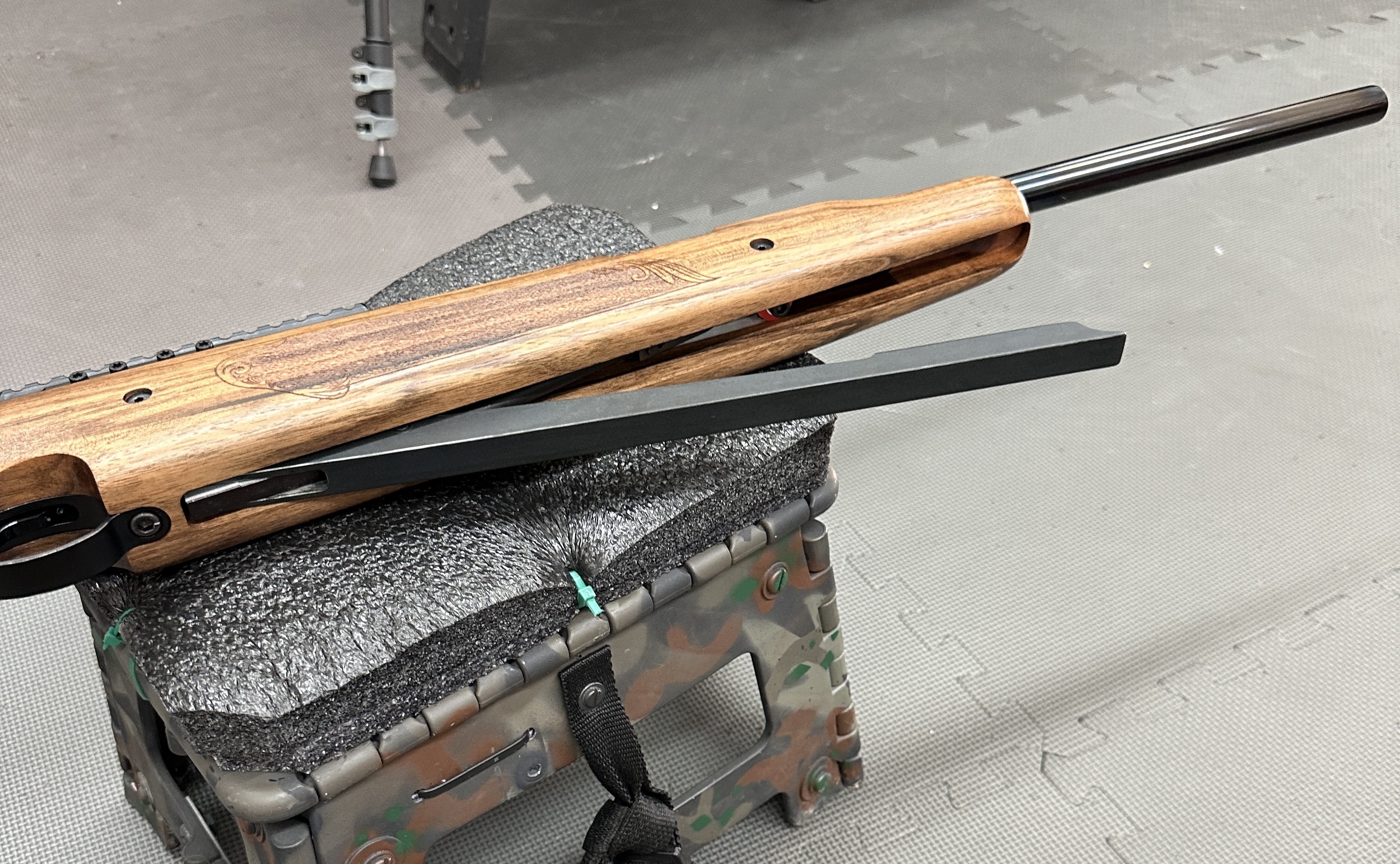

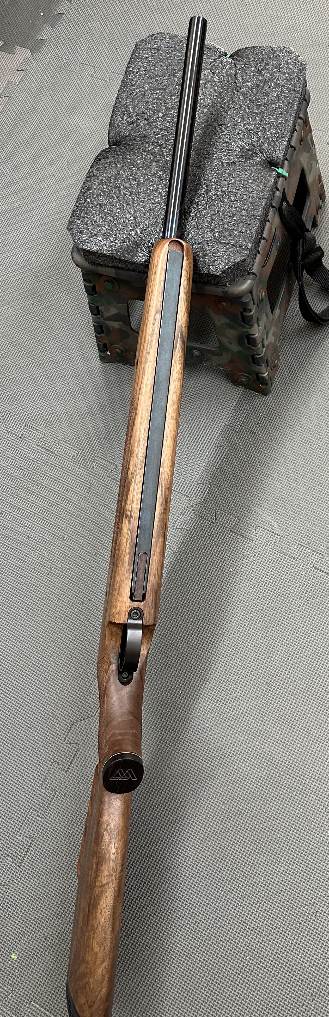

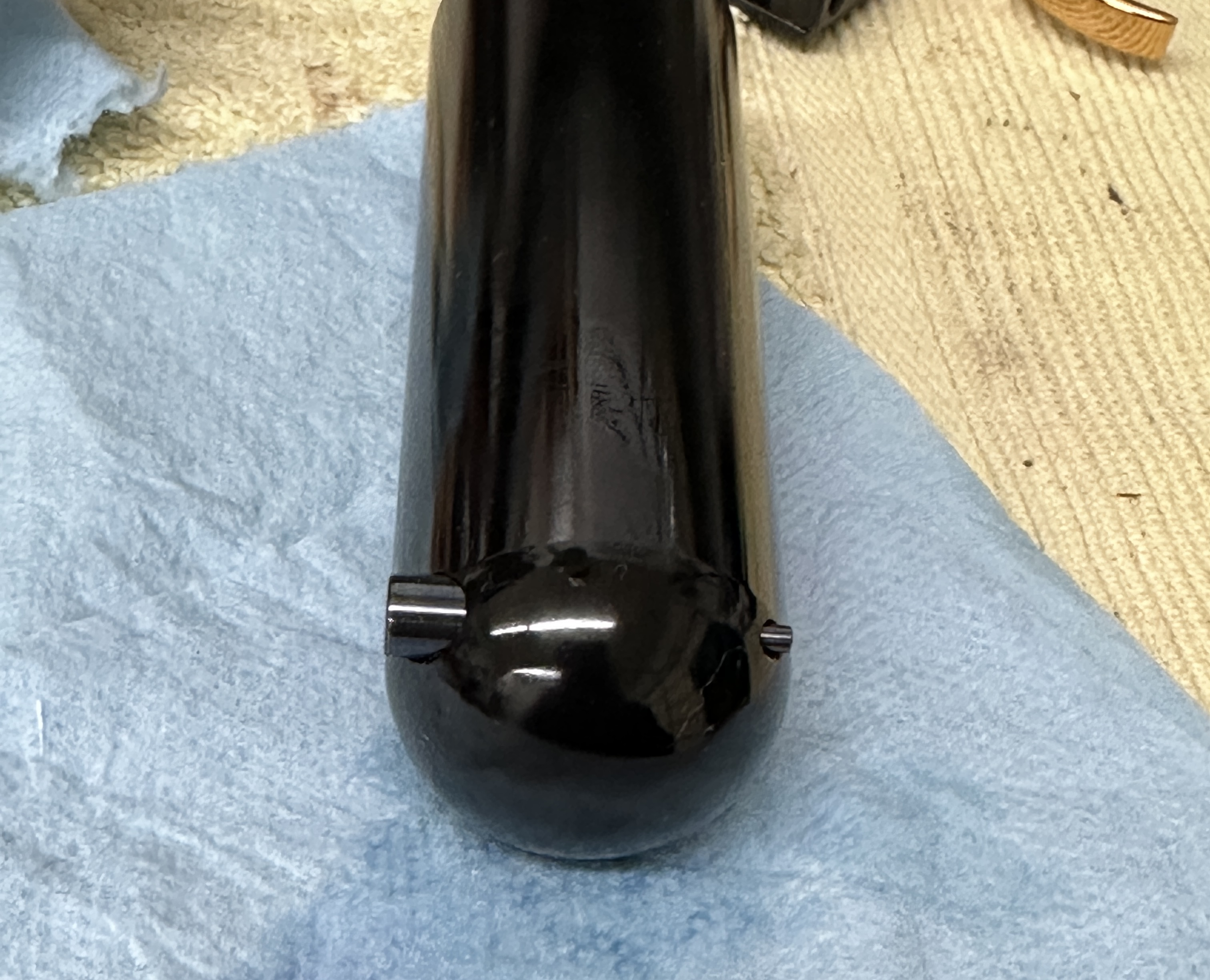

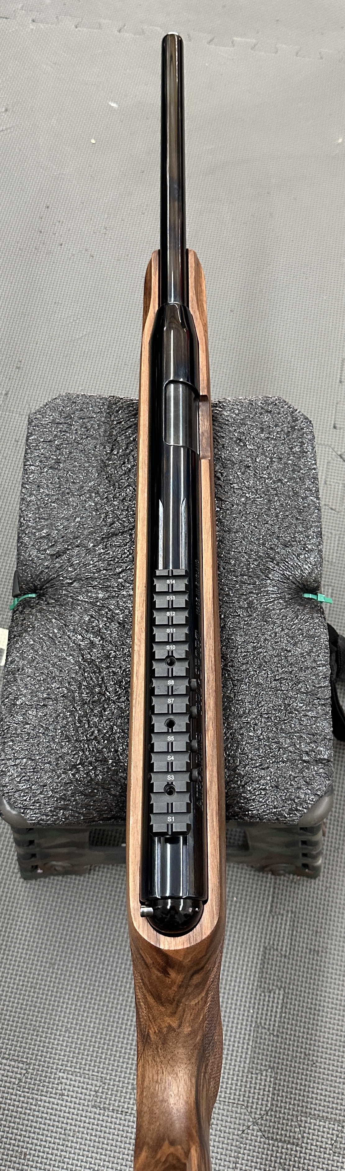

After these mods I had it in my mind to black out the rest of it, so after some work here's what it looks like now...
Compression tube, and cocking arm done.

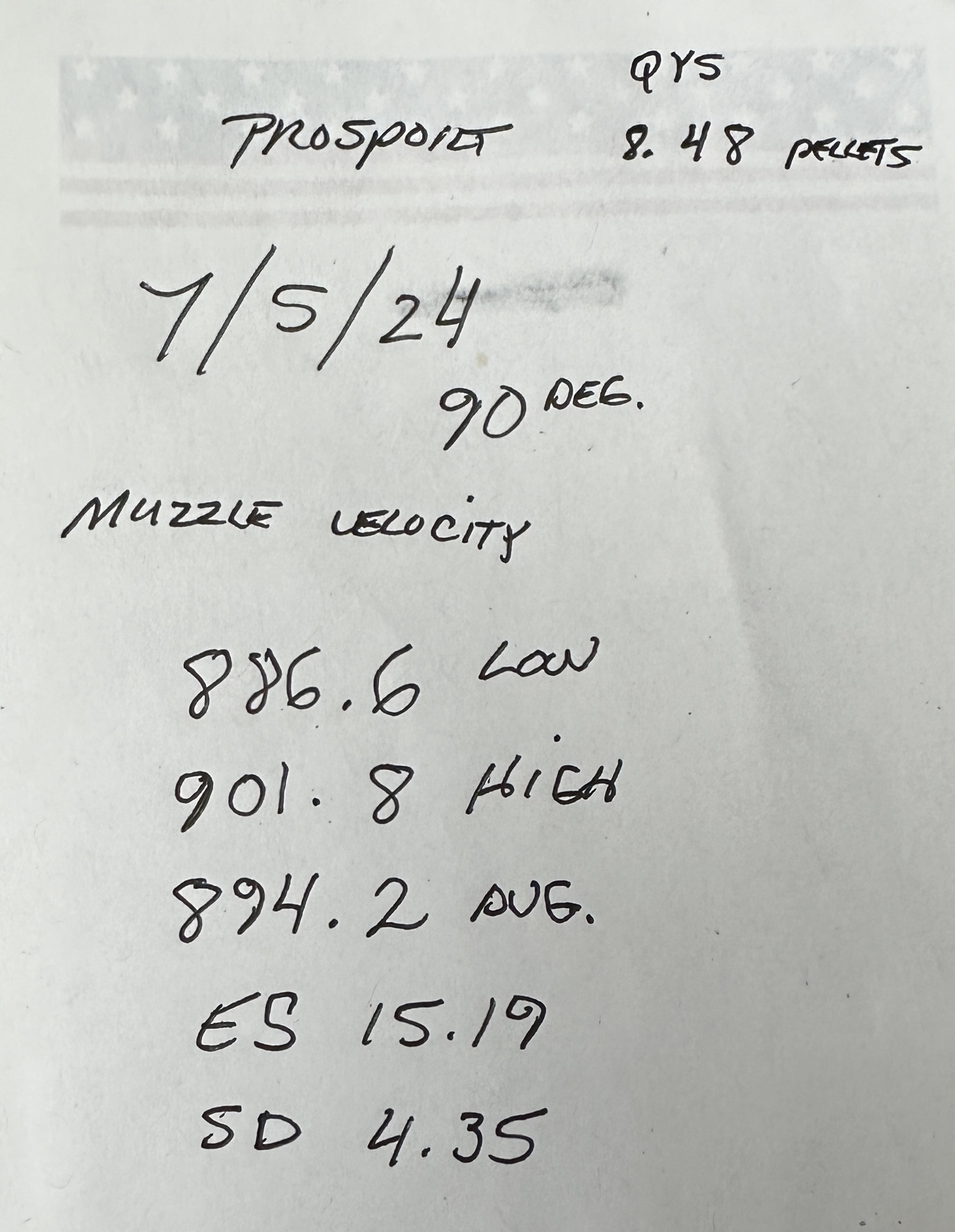

It's not perfect by my standards, but I'm really pleased with the way it looks now. After reassembly with new Krytox, I shot a 10 shot string over the crony with QYS 8.48's it's preferred pellet and got these numbers.
Not bad, I'm sure the ES will drop some after I run some shots through and it settles back down.
Or it could just be because I was off handing thru the crony and the angle changed
