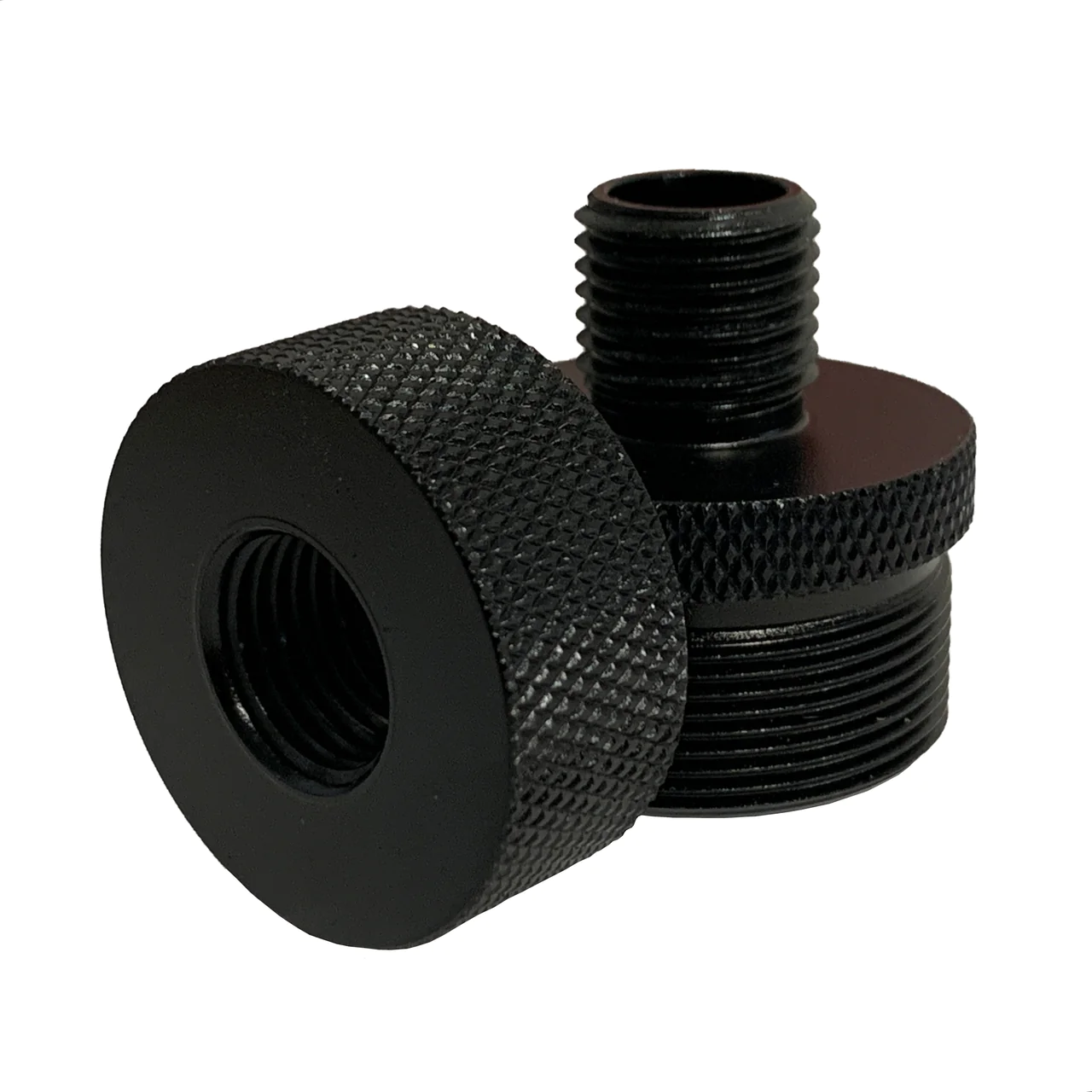

Link to the Donny FL Adapter

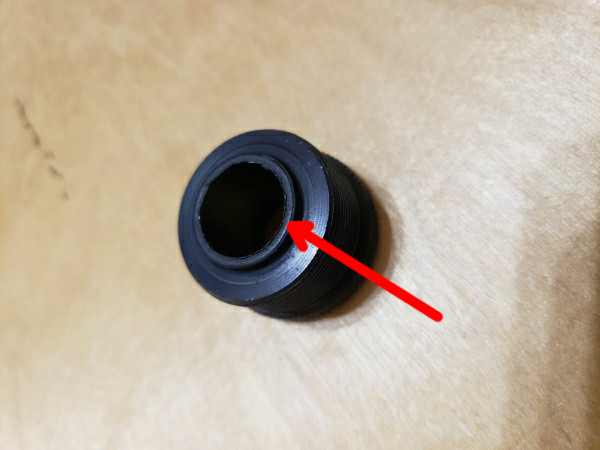

It looks like the threaded length inside the shroud is pretty close to the same. Does it have the raised ring on the bottom to keep the spring centered?

Yes it does have that raised end an it holds the spring like the standard endcap that comes with the blitz.

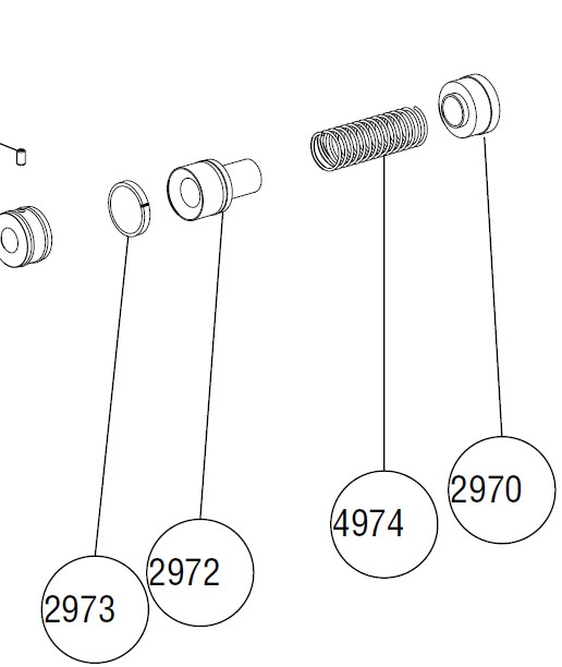

The one at the end of the barrel that attached by to end cap.
Yes, the one in the barrel, part 4974 och the exploded view
https://hatsanairgunsusa.com/wp-content/uploads/2020/12/Blitz-Exploded-View.pdf

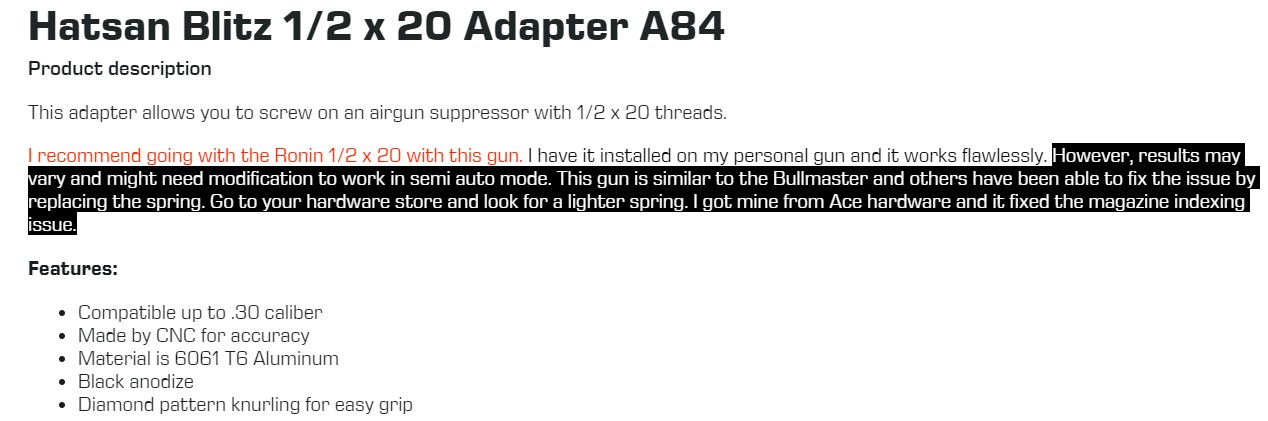

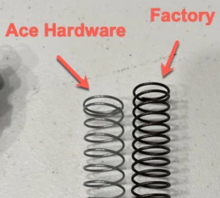

Here is a picture on the Donnyfl Hatsan Bltiz adapter page, it shows the spring he replaced with. Text says to get a lighter spring, I guess it's one of those trail and error things you need to try until you find the one that works.
https://donnyfl.net/products/hatsan-blitz-1-2-x-20-adapter?_pos=1&_psq=blitz&_ss=e&_v=1.0
