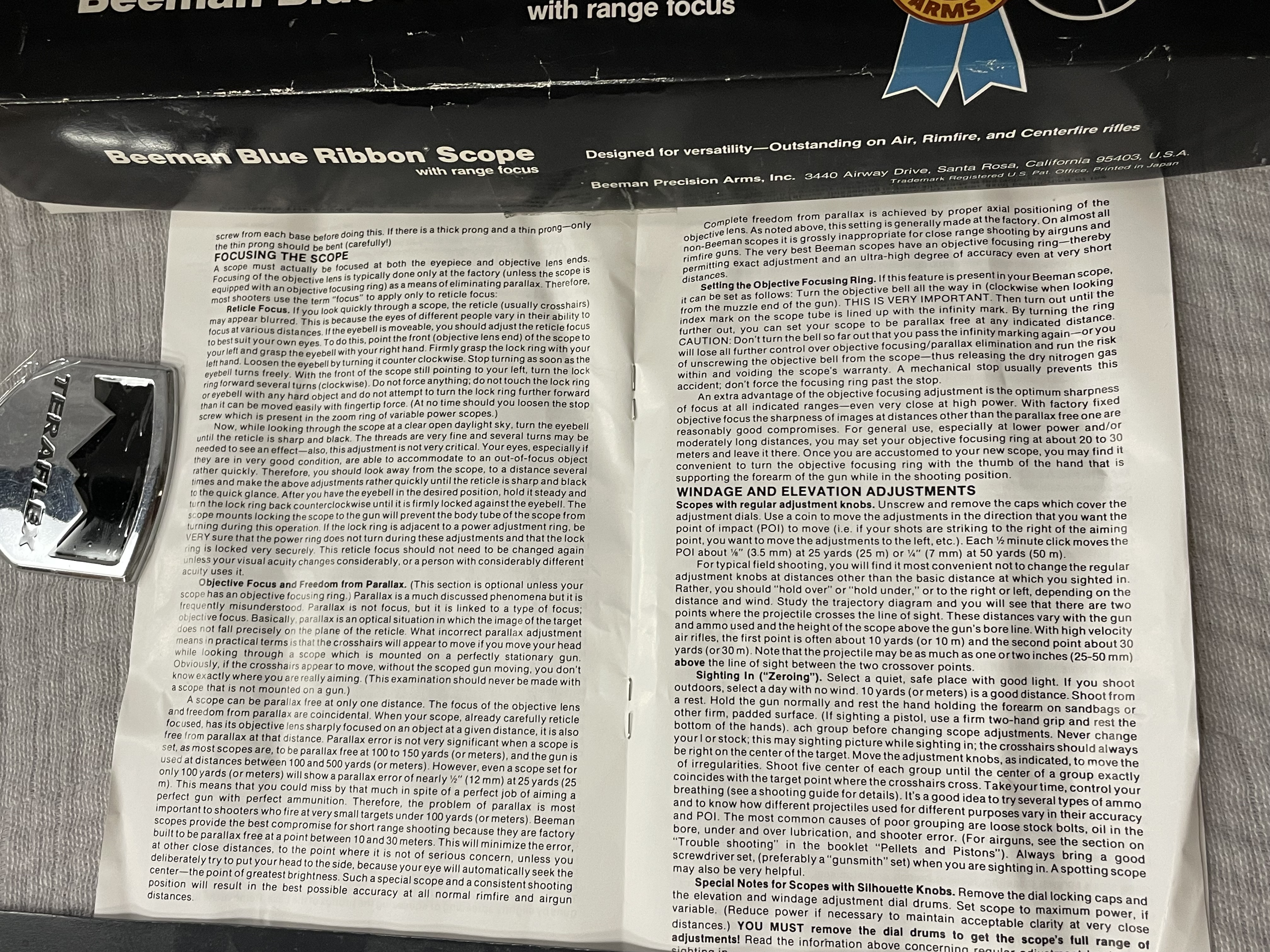

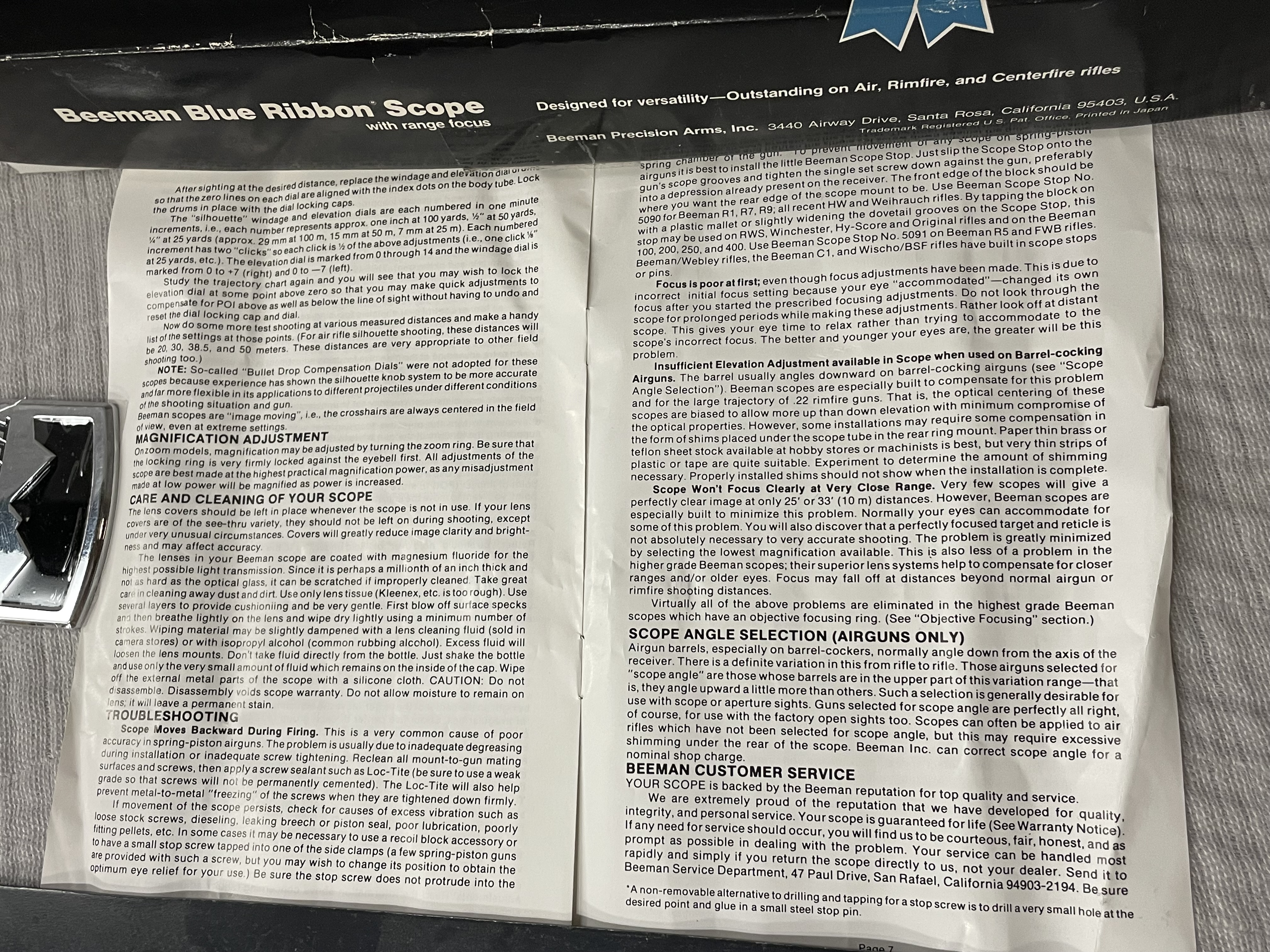

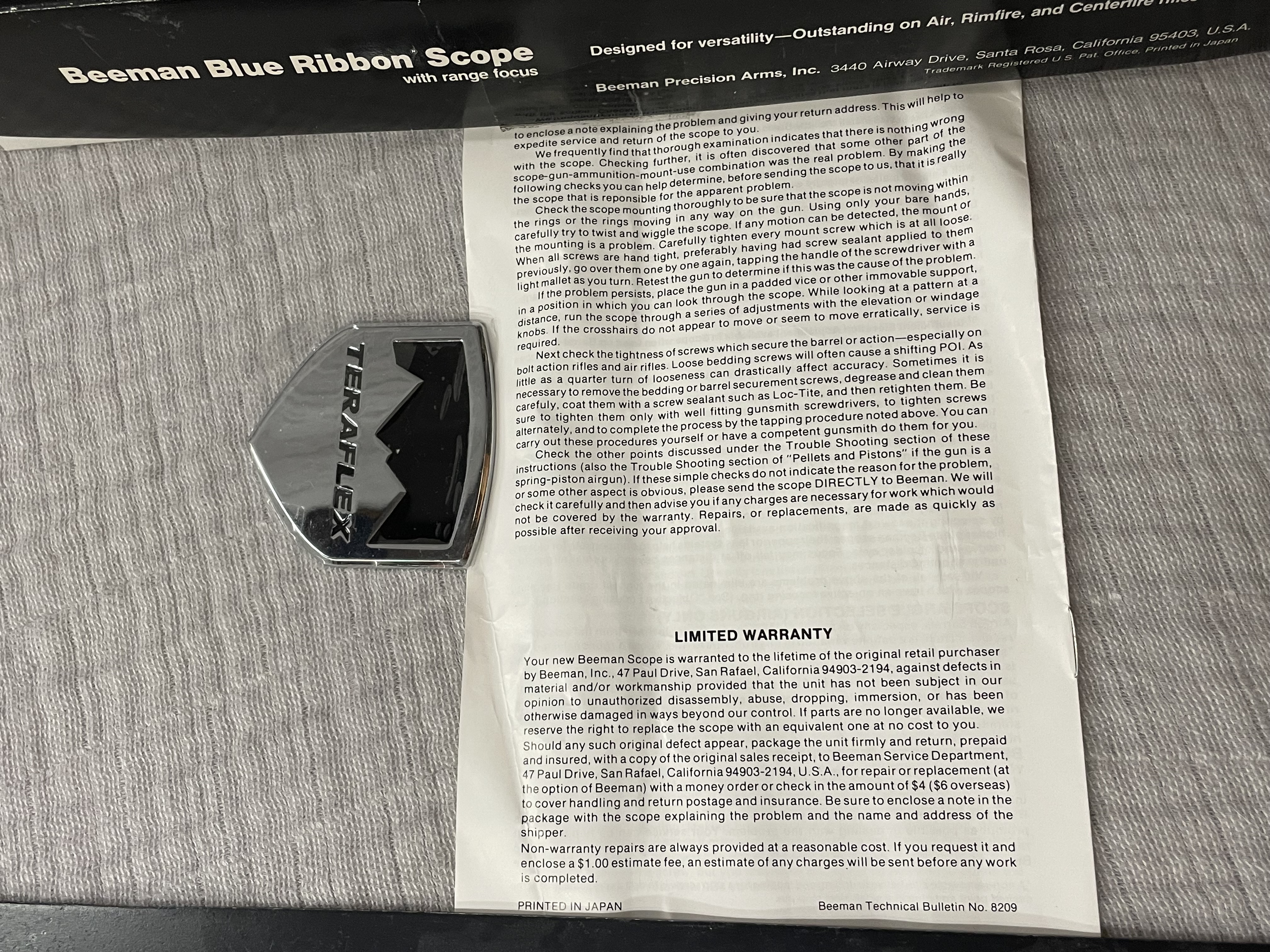

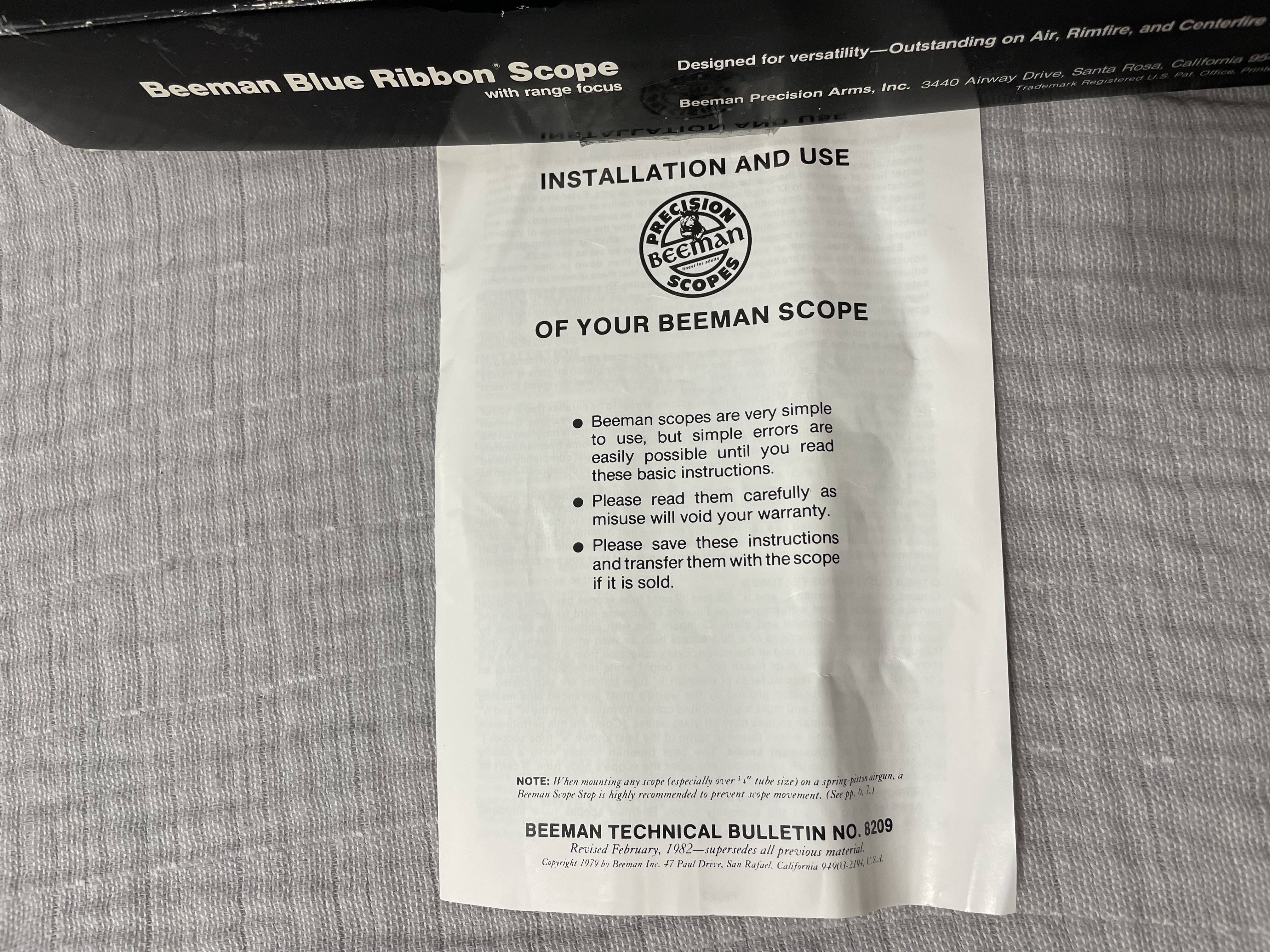

I bought an old Beeman Hw77 and it came with a BR 66R scope. I don't understand how to focus it and lock in the adjustment. It seems a stupid design. I go to adjust the focus and the magnification changes. Or vice versa. Is it designed to rotate the entire occular to change the magnification? I hate this thing
Those Beeman Model 66R were excellent scopes in the day. Made by Hakko Japan. I have hand full of Blue ribbon scopes, I dug out my Model 66R 2-7x32 - took pictures of The owners manual for you, hopefully will help you.
