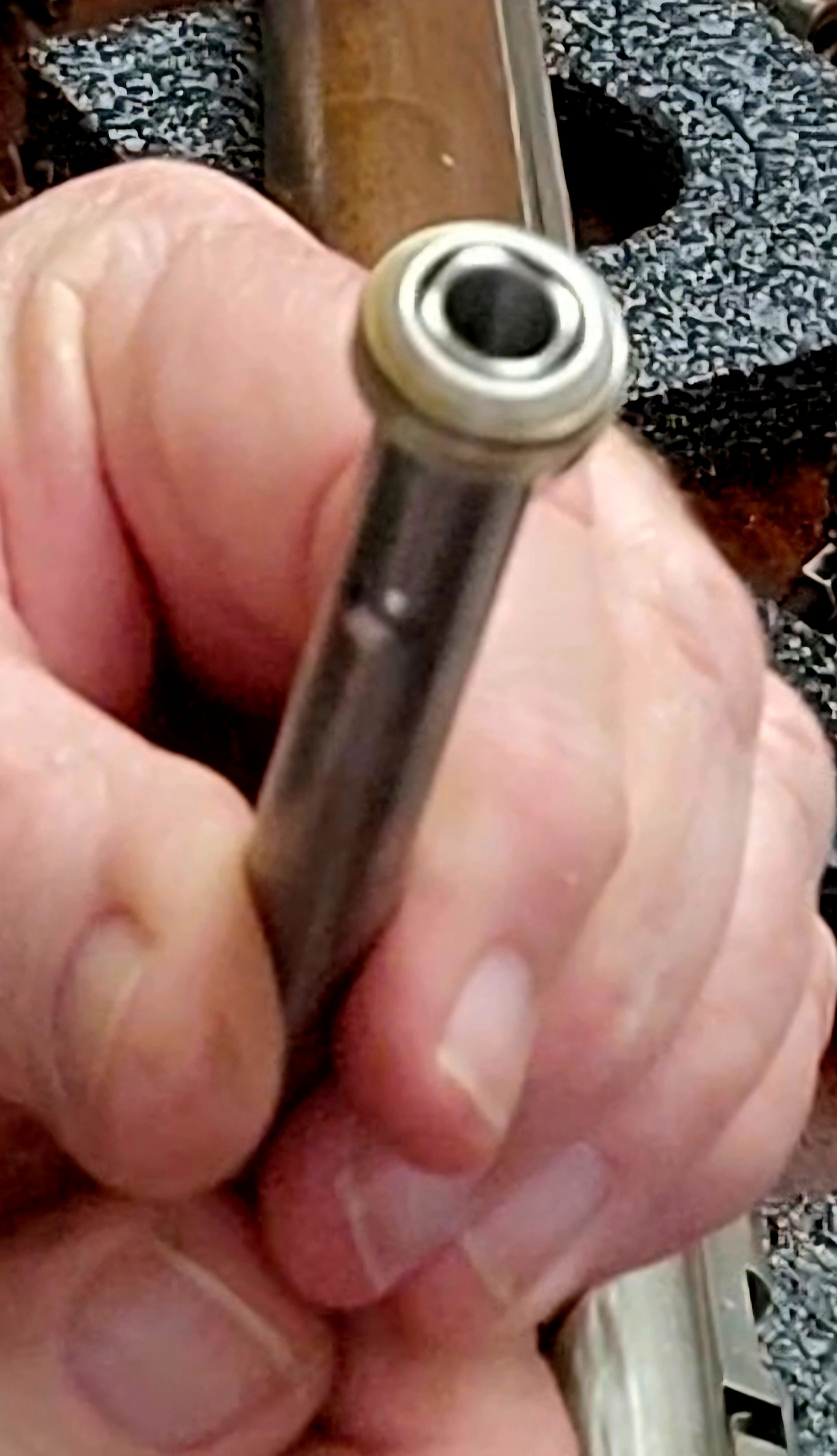

I had this issue and turned the nut backwards and it went right in.
I knew it was original, and how it came out, but had nothing to loose at that point
This was how it came out.
