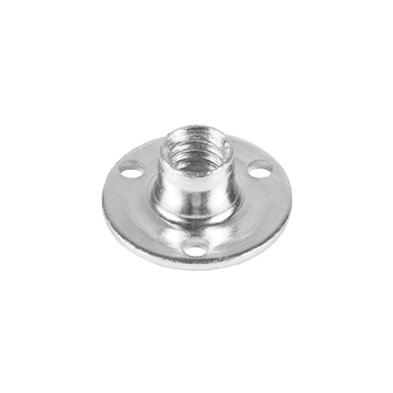

Blue thread locker in wood?
you are just screwing into wood ???? you would be way better off putting in woodserts
https://www.google.com/search?q=woo...CBxAAGIAEGAqYAw2SBwM4LjKgB-hn&sclient=gws-wiz
Ya, id think so as well.
I kinda like this with a spot of Elmer's and never look back
https://www.lowes.com/pd/Hillman-2-...012569-_-local-_-0-_-0&gad_source=1&gclsrc=ds
I used huck bolts inserts to good results in metal so id have no issues with wood types like that screwed in one for a gun stock thing
When bolting things (bipod mounting brackets or sling studs) to the forearm I epoxy a stainless steel t-nut from the inside. The t-nut accepts a machine screw, spreads any force over a larger area and the epoxy binds the t-nut and stock together.
Just be sure to degrease the wood before gluing.
I carve out a relief and modify the head of the t-nut as required to fit.
