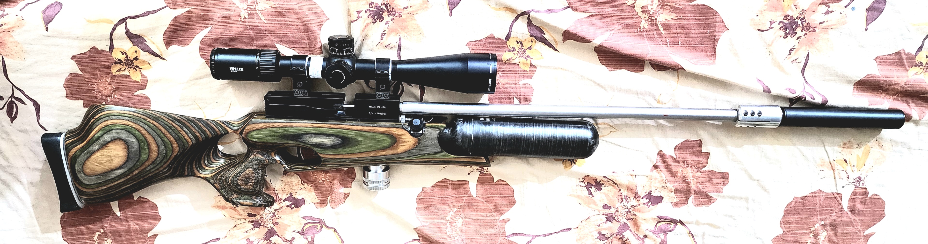

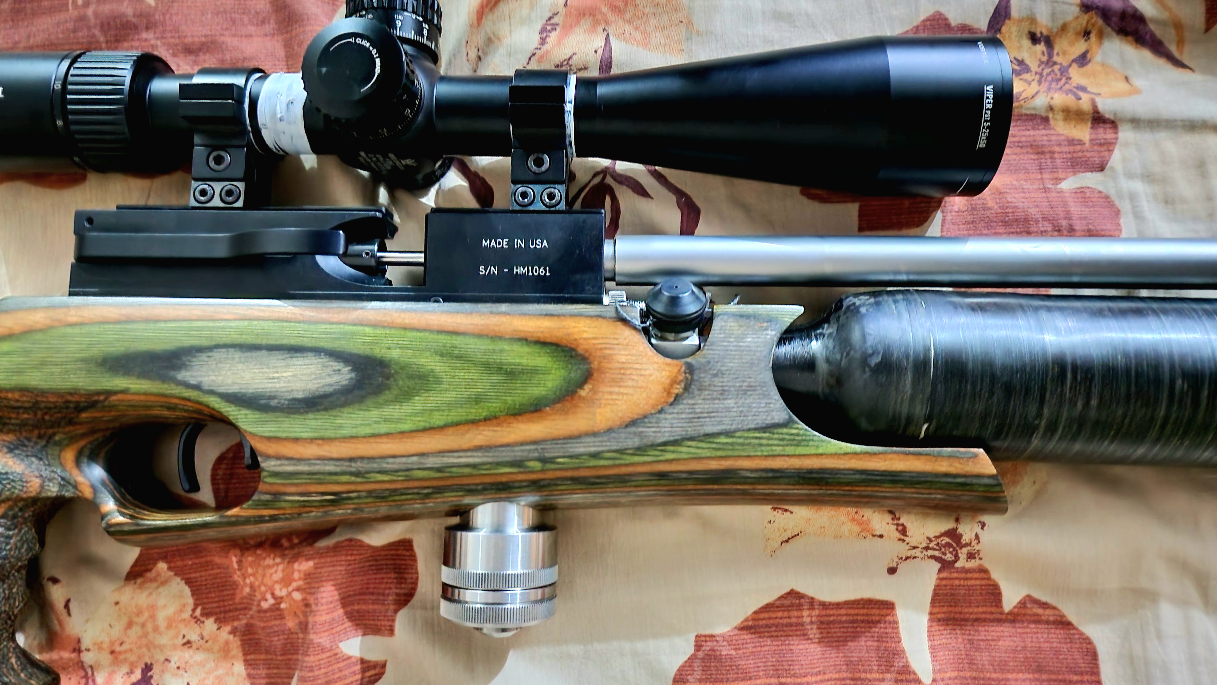

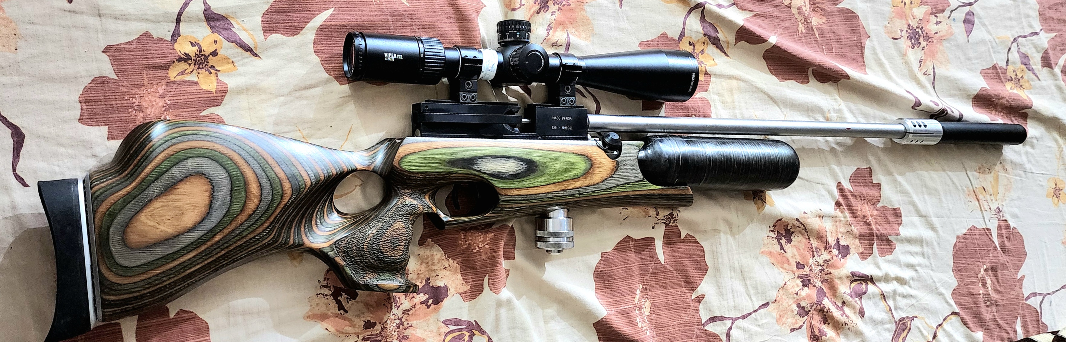

Following is my HM1000X. It has .22 barrel of my BM500X right now.
I was able to shoot BM500X at around 925fps without external plenum when I used high efficiency valve and SSG.
Then I installed the same barrel in my HM1000X with larger transfer port. My HM1000X has also external plenum.
I can achieve upto 980 fps in this setup with 25 grain pellets.
But again I think getting it done by Martin would be better for you, as I don't know about your technical skills.
