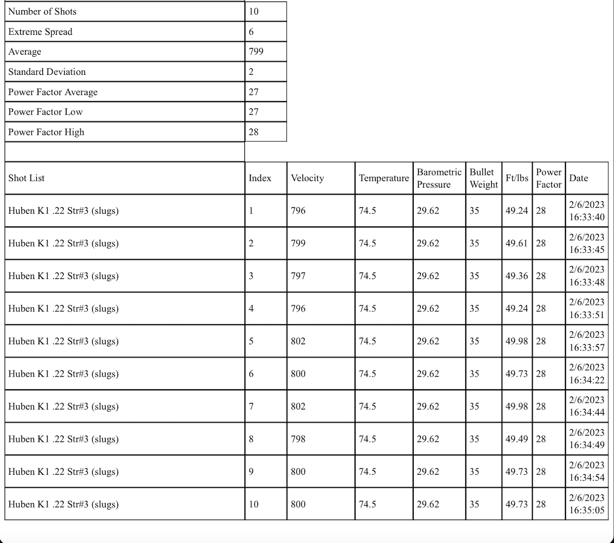

@EdinGa I shot them from my .22 Huben K1 with 35 grainers. Here's a shot string.

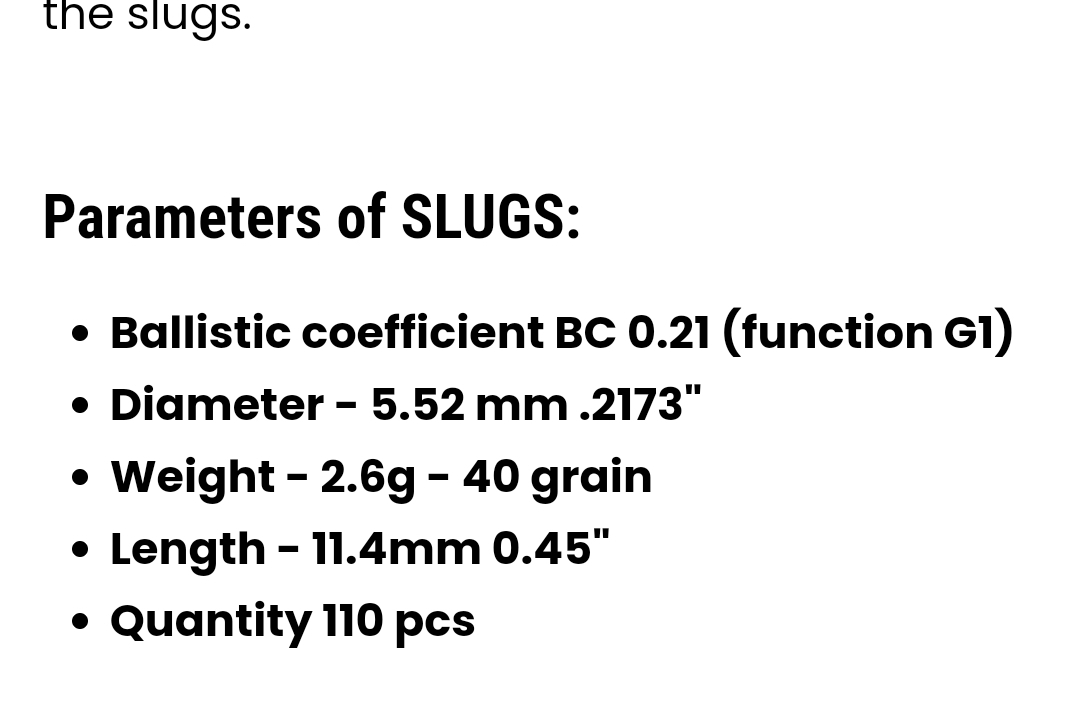

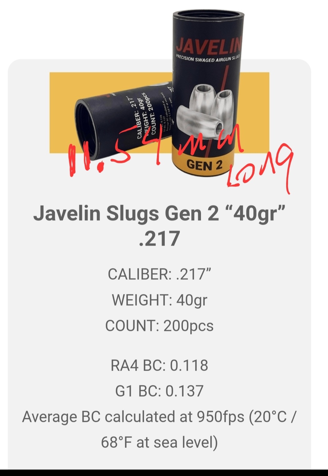

Although I'm sure I still do not know how to use strelock that well yet. Make this comparison between a 40 grain Javelin going at1080 FPS compared to Altaro's 40 grain going 900 FPS and see What kind of speed and foot pounds of power you have at 300 yds and beyond.
And the Altaros boat tail slug
For me at least it will be a lot easier to make my gun push a 40 gr to 900 fps than 1080 fps.
Even though it's not maynot be the right function to use, it give some very interesting values to look at.

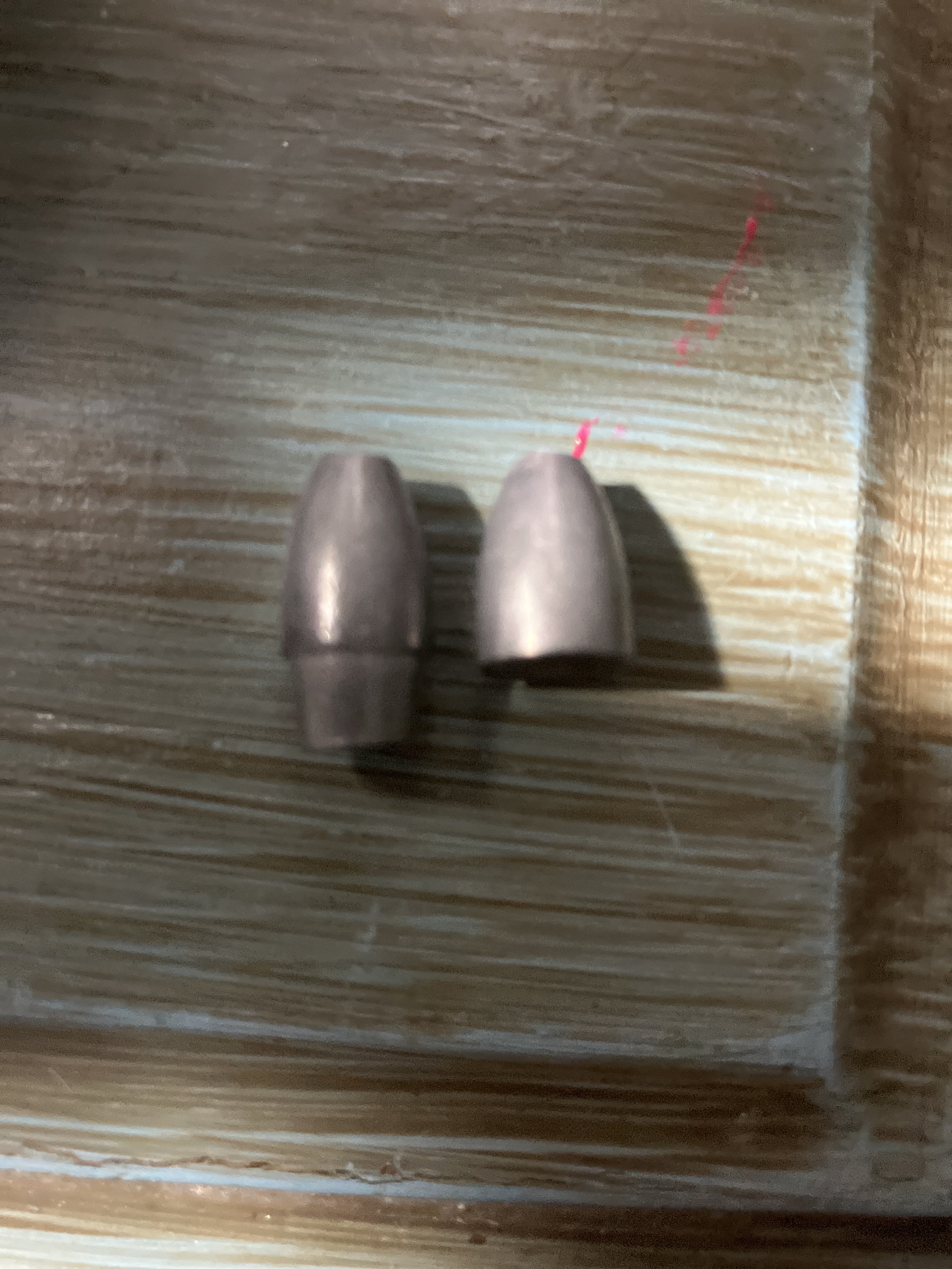

You’re saying that you compared slugs of equal weight and the boat tails were running faster than the flat or dish base? I also am confused by your last statement. More power with less energy? What do you mean by that? Energy and power more or less refer to the same thing. What were you referring to? Also I’m pro boat tail but they really excel at long distance shooting. They take a second to stabilize when they leave the muzzle. I’ve not had a chance to test any boat tails out of My V3s yet. They’re just too long. I have some Griffin 73 grainers and they’re just too damn long for the breech. You can see in the photo how much longer a boat tail is compared to a dish or flat base.
