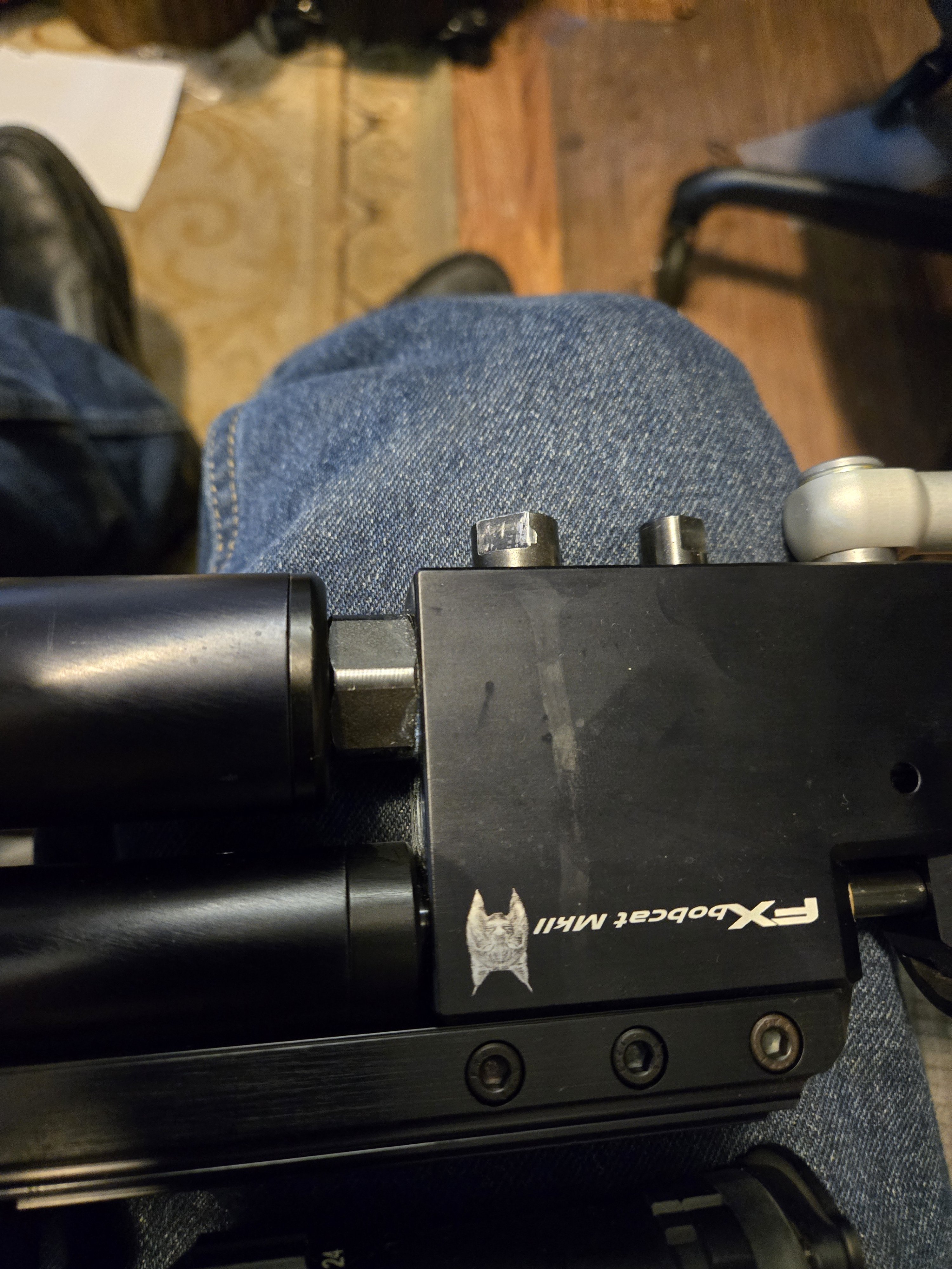

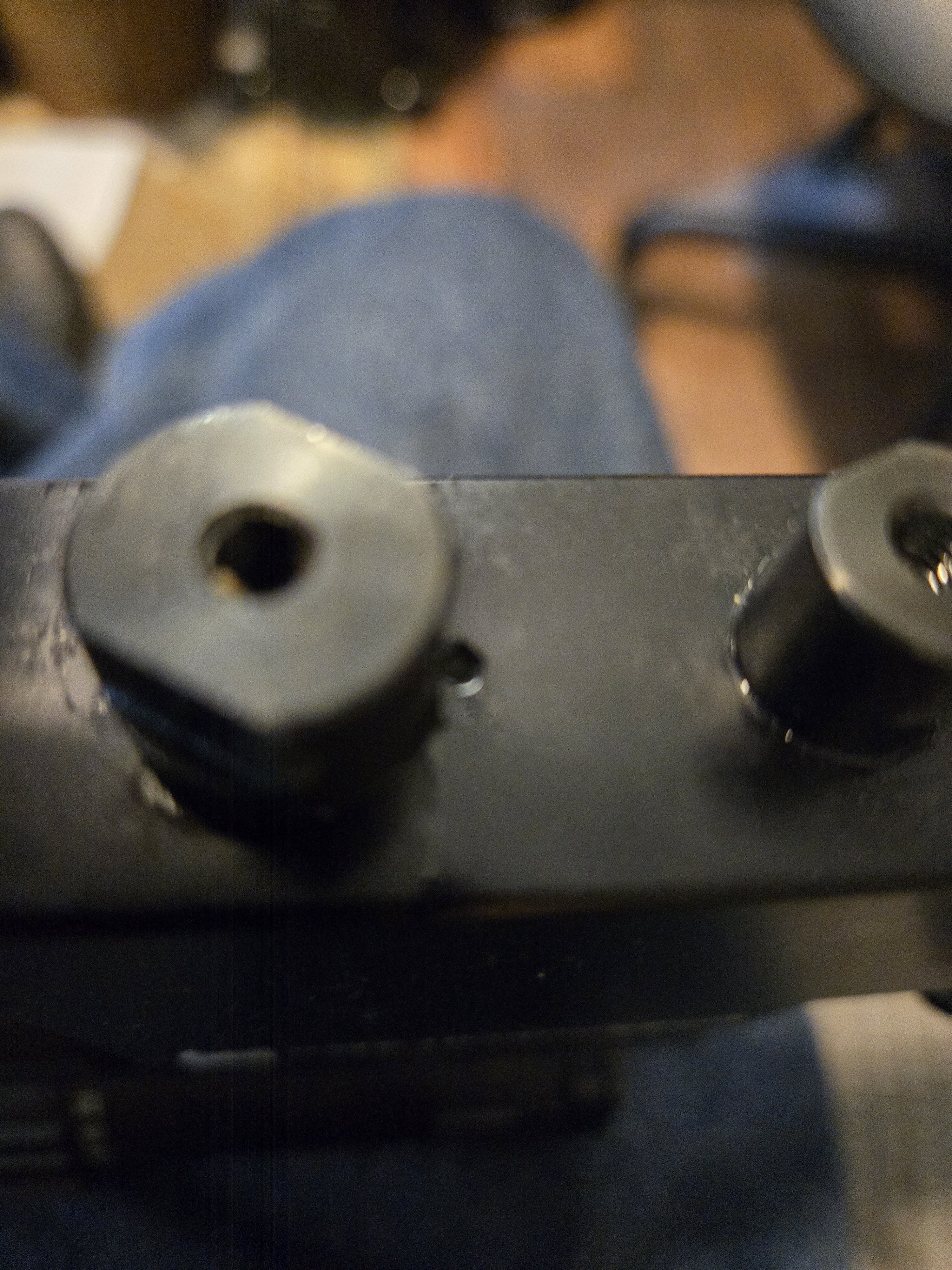

I acquired an .30 FX Bobcat MK2 that has an air leak and I don't see how to seal it. So I figure one of you FXperts will point me in the correct direction. Under the trigger assembly are two bolts. A 13mm and a 10mm. Next to the 13mm is a small hole. It appears the leak is coming from there. But I do not see anything the would allow me to seal it. Any help here would be greatly appreciated.

View attachment 521362View attachment 521363
I believe that's the regulator vent hole. I think you might have a reg issue, not a gun issue.
So rebuild the regulator?

The Ernest Rowe Master Class video posted above is the way to go. When the reg in my FX Boss (same platform as Bobcat) went bad I replaced it with a Huma Air reg. BEST thing I ever did to it. It MIGHT be as simple as the o-ring on the part shown in your picture (reg relief/stock screw housing) so try that first. I might have extra external reg o-rings and the part in pic if you need to work on it. Contact me if you're in need.

I also have a Bobcat mk2 in .30 that I inherited , it had a leak that I had a hard time finding. Found out it was under that bigger trigger mount bolt , there are o-rings under each on of those bolts. Fixed it for me gun shoots great and holds air.This was my first pcp so I was just winging it from info on the web and forums. The Huma reg is my next buy.

I actually thought that the larger one was the leak. So I did replace the orings under both. But it is the regulator hole beside the larger bolt. I clean up the regulator but did open it up and still leaking. So I ordered the Huma and it will be here Monday.
The oring in the outlet cap of the air tube was bad too.
