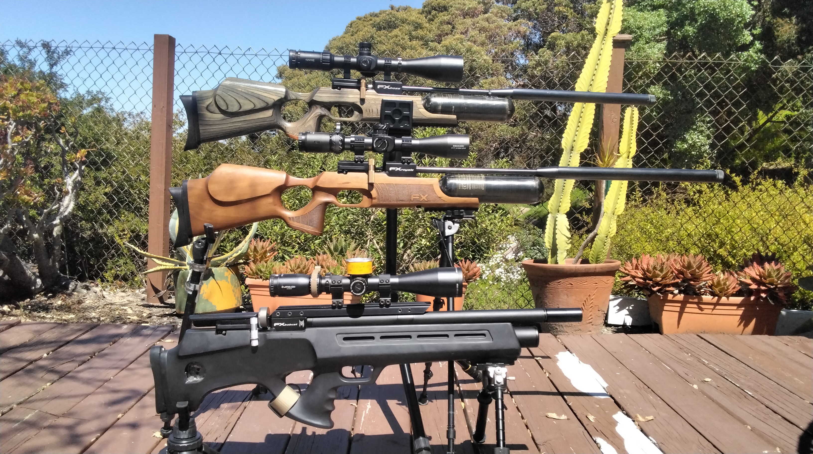

"Limited to 45 yards"?!?! Where'd you hear that, or am I misunderstanding? My Bobcat1, .22, after being gifted to me, made a 102 yard head shot on a ground squirrel on my 1st hunt with it, 1st shot! All the guns of this platform (Bobcat, Royale, Boss) are WAAAY more capable than just 45 yards.
"Limited to 45 yards"?!?! Where'd you hear that, or am I misunderstanding? My Bobcat1, .22, after being gifted to me, made a 102 yard head shot on a ground squirrel on my 1st hunt with it, 1st shot! All the guns of this platform (Bobcat, Royale, Boss) are WAAAY more capable than just 45 yards.View attachment 521833
