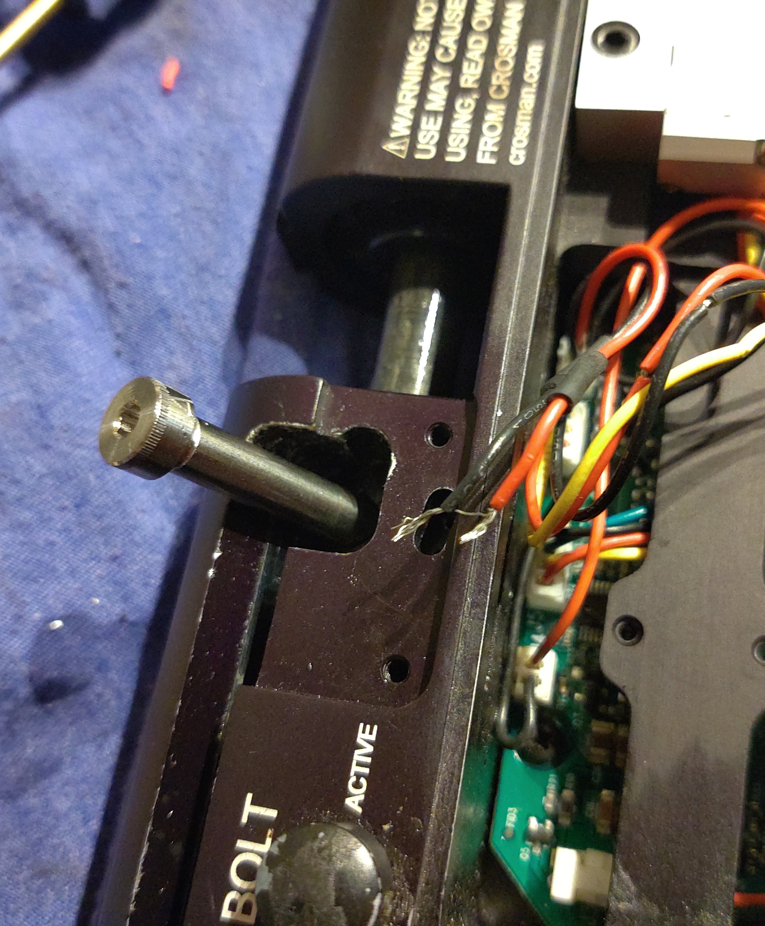

Hope someone can help me find a replacement bolt probe handle. It's for a .357 Rogue. I snapped it off in the probe but was able to back out the threads and remove it.
It's 55ish mm long and stem is 6mm. I'm guessing thread is 8x32 which I think is standard for benjamin ?
Just looking for where to get a replacement or if someone can machine one ?
haha, this gun is far from pretty
Well... Pretty ragged .. not to say I don't got some ragged out myself that shoot good still ..

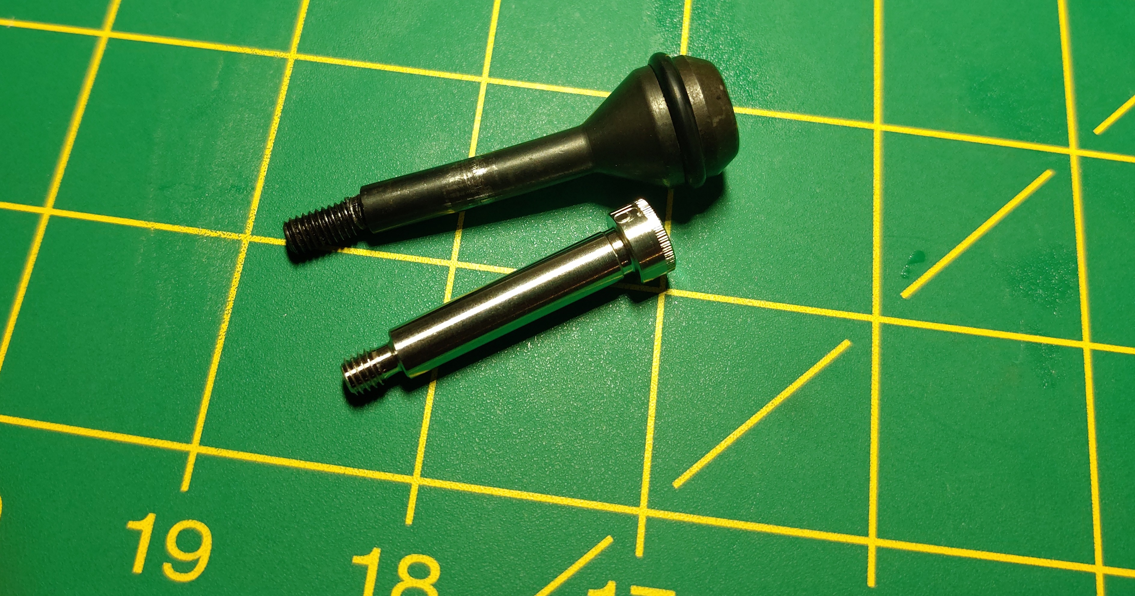

Ya, one said. Cut and drill ... I could see cut the bolt head off thread it then the gun bolt handle "ball" off. Drill and thread it and screw it on the new bolt with a drop of red .. it almost looks factory then ..lol
