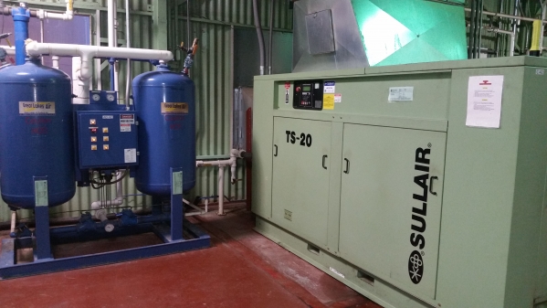

I like my little Shoebox because I can bring it to work and use all the air I want, with an industrial dryer getting a low dew point. The Shoebox is also a easy to service unit and if I have a big issue I can talk to the owner of the company that can have me the parts in under a week.
I also think a big percentage of people already have a air compressor in their garage. So It fits my mold well.
