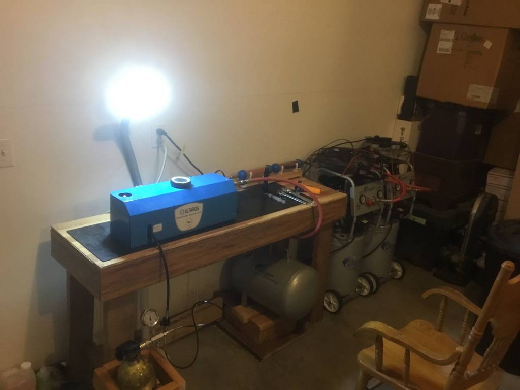

I opted to run an Altaros booster fed by two CAT compressors. At first I tried it with one compressor but it does run far faster and produces less water with two.
No complaints, much slower than the B2B booster, but I enjoy watching it work. Takes a couple hours to top my 30 minute tank off from 3000 psi to 4200 psi about once a week. Regards

My 2 CAT compressors were used as they are oil free and I did not want to retire to 220v and did not want the oil smell in my house. The compressors cost $400. At the time, now $465, and I can easily ship them south to San Diego for repair and still run on one, albeit slower.
I researched the bottle 2 bottle conversion kit for mine, but decided to wait and see how my setup works as shown above. As is, it produces all the air I need for shooting at the 11 yards I am forced to shoot these days.
The 2 CATS run very quietly, 71 decibels, I have to place my hand on the compressor to determine which one is actually running, as does the Altaros booster and they run at a cool temperature, aided by the fans I installed on the top of each. They also are better suited for shipping as they have a built in roll cage and we all know the damage our shippers cause with packages. My first compressor, shipped from the east c9ast, not a CAT, arrived damaged, as did my CAT 10 gallon auxiliary tank which I purchased from a dealer on the east coast. I repaired the tank, but the damaged compressor was returned. That was when I discovered Walmart would pick it up at my front door for free and refund the price. As a result, I buy using Walmart or directly from the CAT factory.
Having stated this, if I were shooting as much as you and Henrih, and had the access to a fill for that 2nd bottle I would be boosting bottle to bottle.
