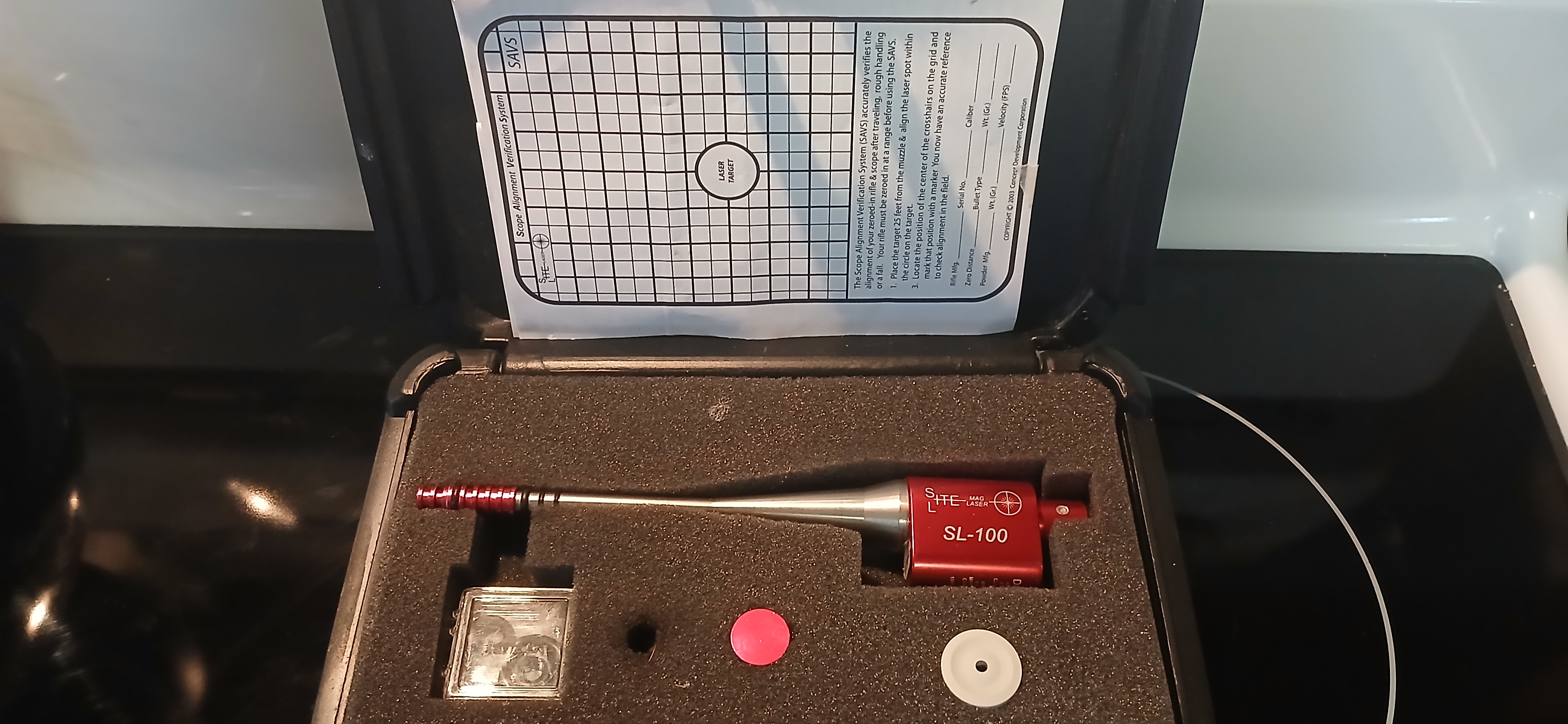

So, this leads to the question: Which/what Bore sighting device will work with these airguns? I've already tried the "laser bore sighter" which isn't long enough to reach any of the barrels of these guns (its getting returned). At one time I had an old Bushnell bore sighter....the one with the grid pattern, and interchangeable adapters, that worked on both a Maurader and Gauntlet 2.... but I have misplaced that device, and before I plunk down the money for a new one...... it's be nice to know if it will work on the guns I've mentioned??

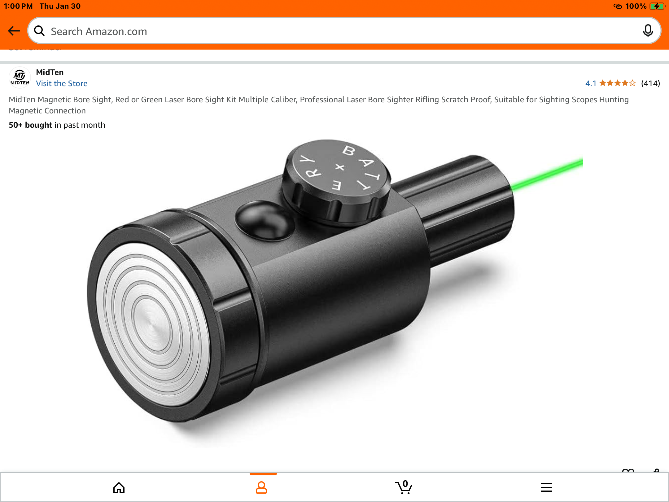

I have one of these that works on barrels, if you have a non magnetic shroud it won’t work but I have used a 1/2 x20 nut to thread it on guns that have threaded shrouds. It gets me on paper.
I have one that looks like that from Caldwell. End with the rings attaches to muzzle end magnetically. If you do not get it centered on the bore it will introduce some parallex, either vertically or horizontally or both, depending on position, but still will get you close onto target.. Biggest variable will be if the muzzel is square to the bore axis.
