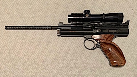

My carbon sleeve was a very tight slip fit on my custom 600 barrel, even with Super Lube. I used electrical shrink tubing to cover the exposed brass (bronze?) barrel left exposed to leave room to remove the tube cap.
