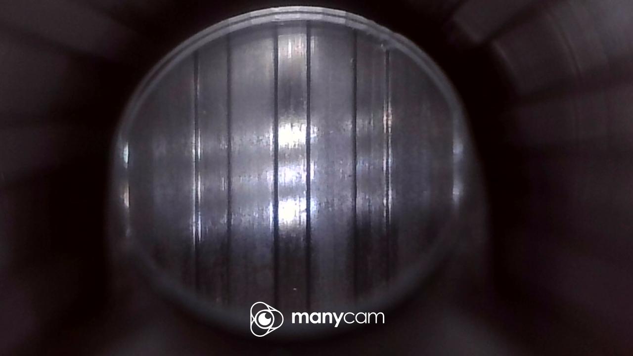

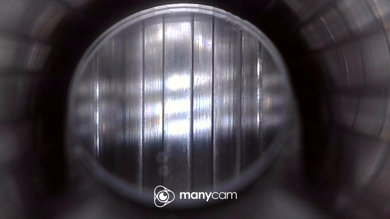

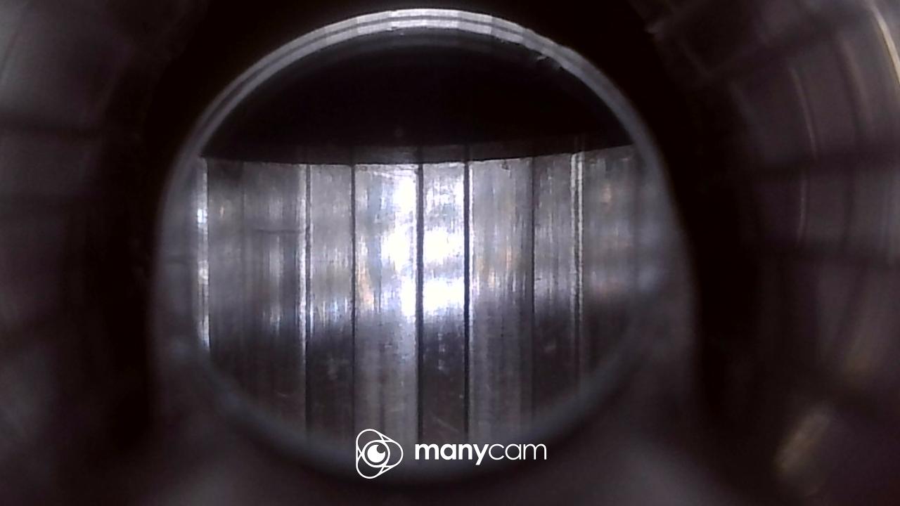

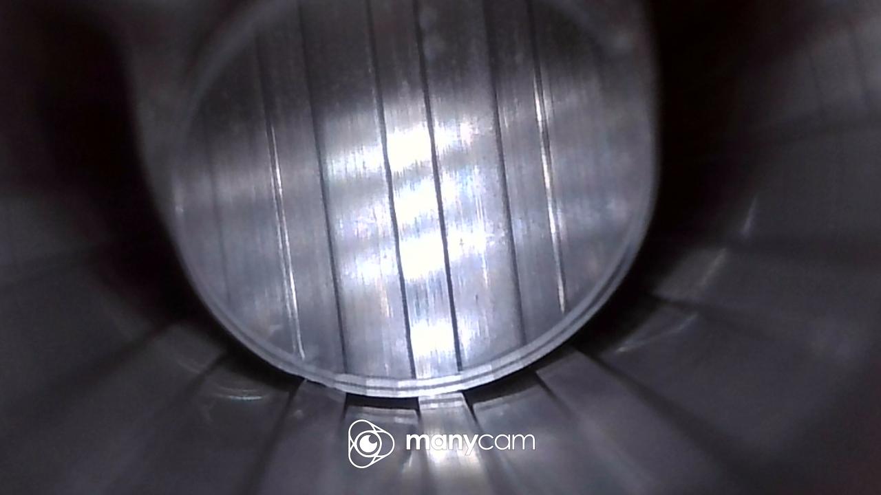

A few images (720p) taken with Teslong model TSNTG100 of a Walther .22 blank.
Pics 1 and 2 show the rifling with a small illumination adjustment.
Pic 3 is with the mirror rotated relative to the camera.
Pic 4 shows the crown area.
Hope this helps.
Ron
