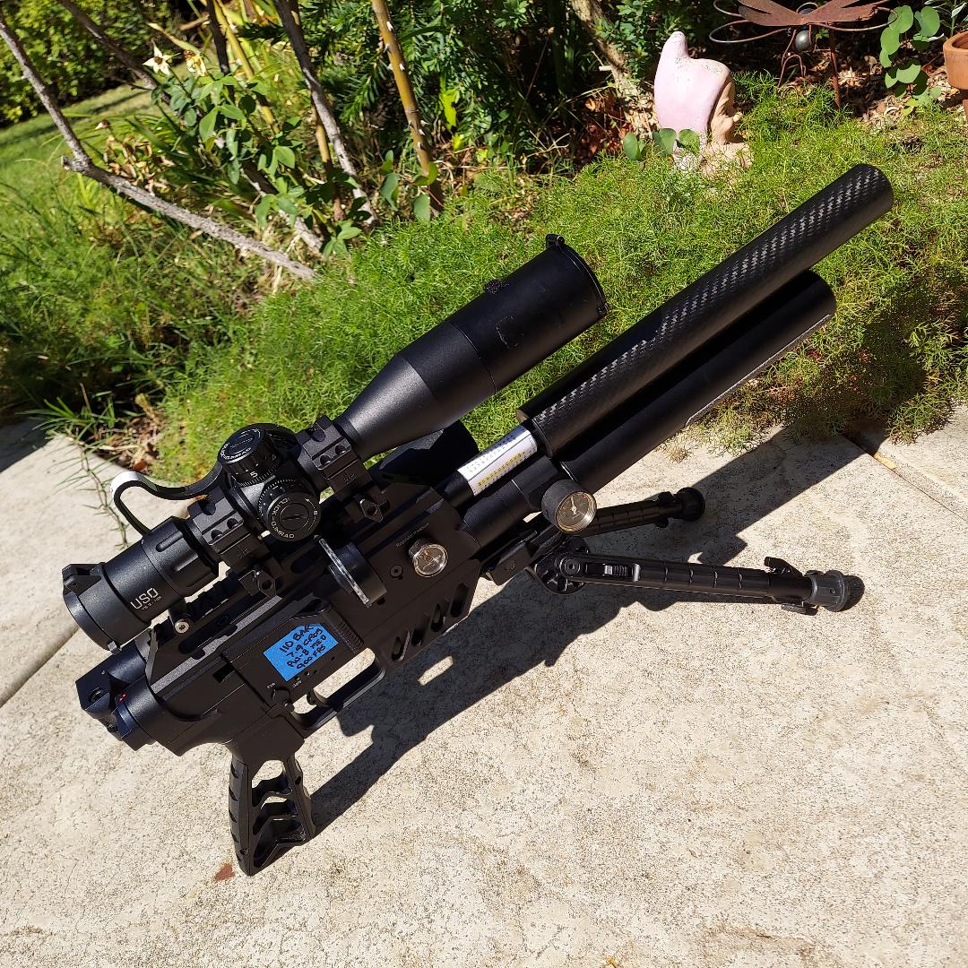

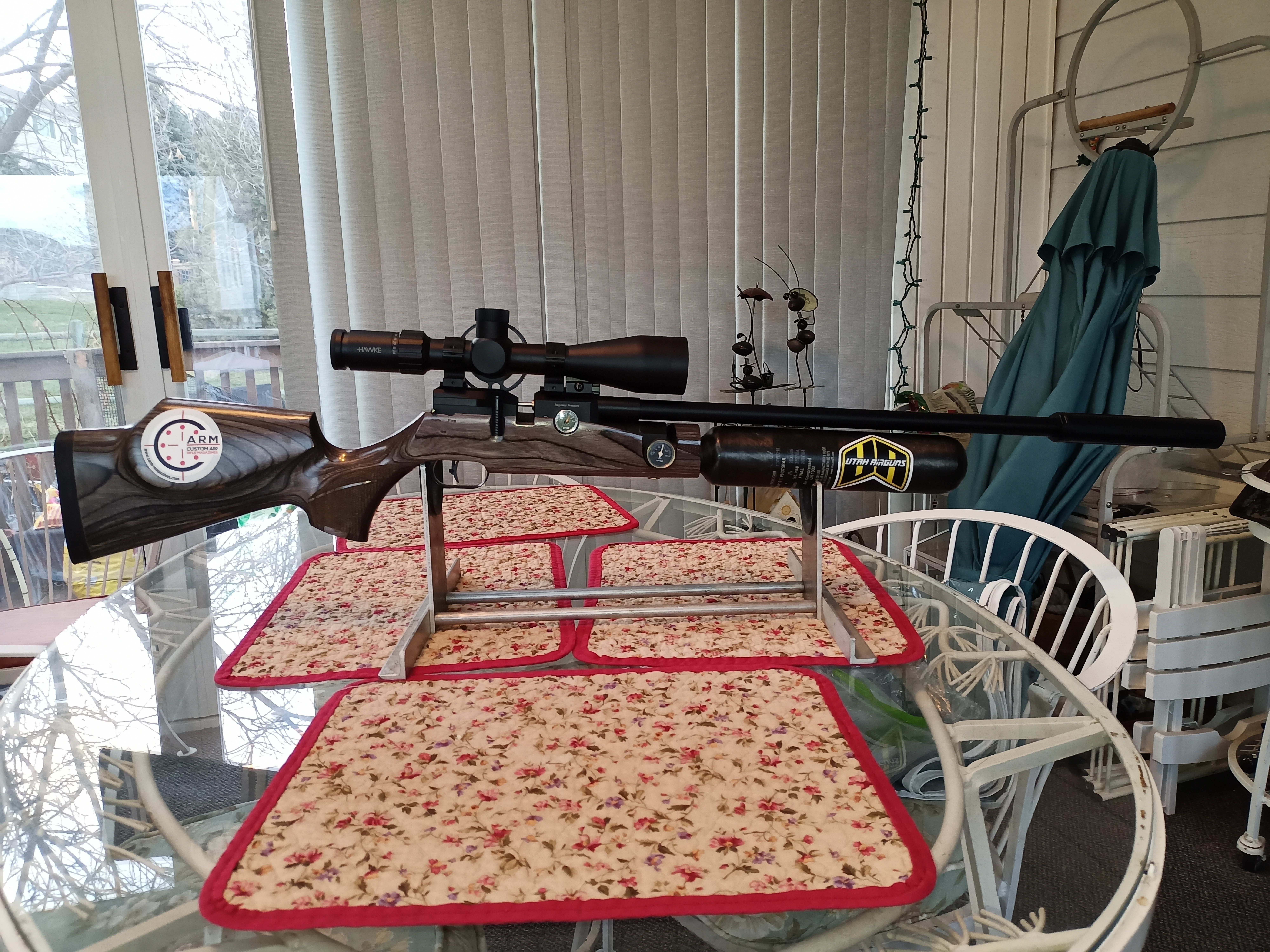

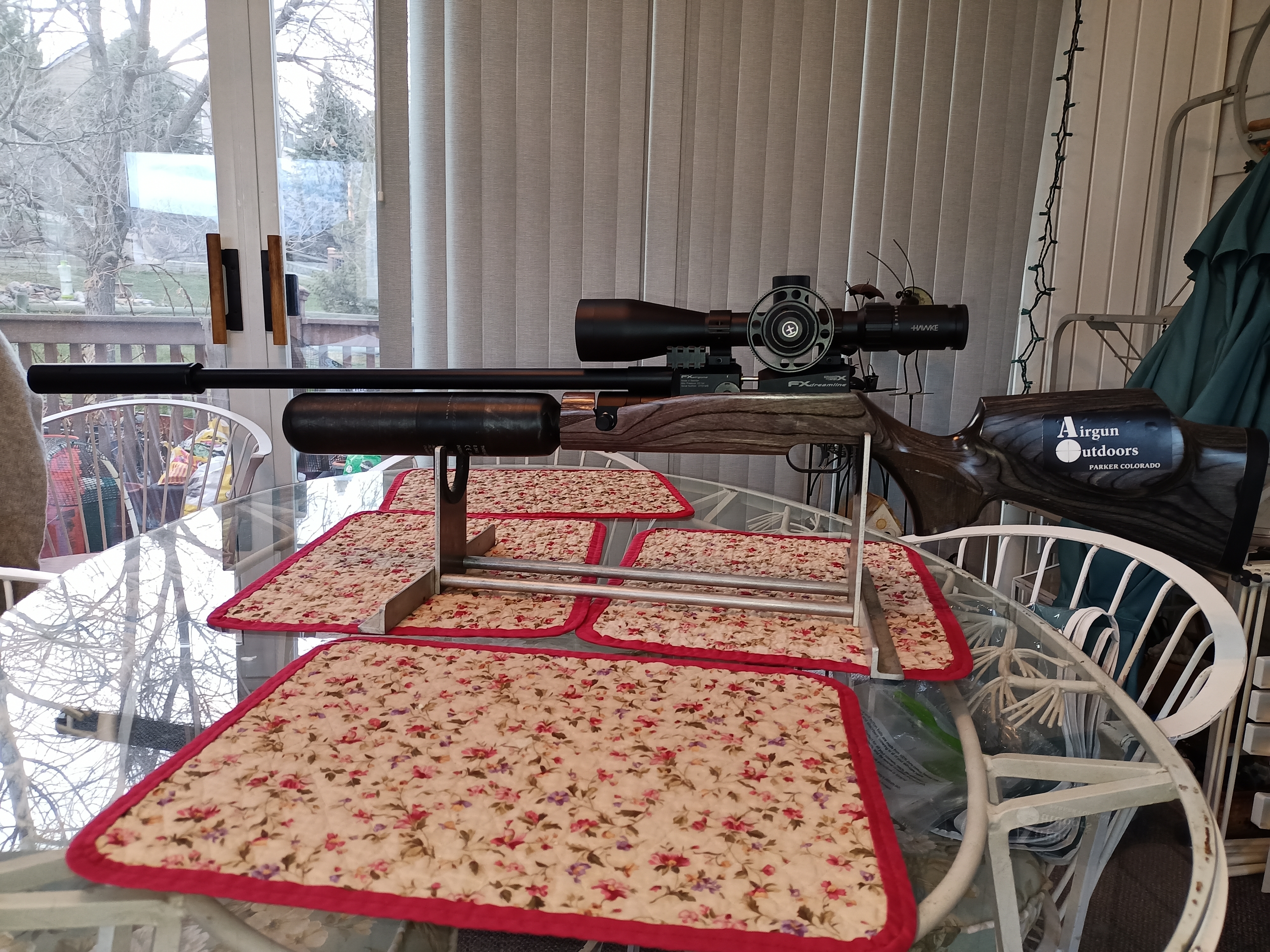

Thought you folks might be interested in some modifications and groups I've shot with my .177 FX dreamline. I already put an extra power hammer spring in it and have a heavier hammer and heavy slug barrel on order. The oem barrel does not group slugs good enough for long range shots on appropriate game.

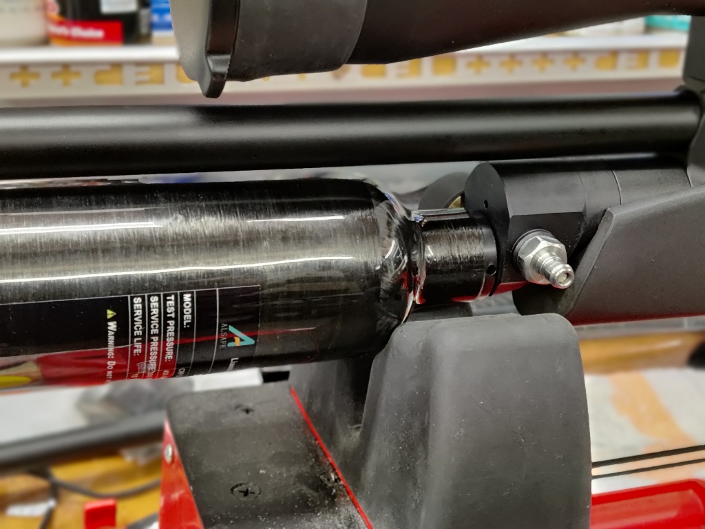

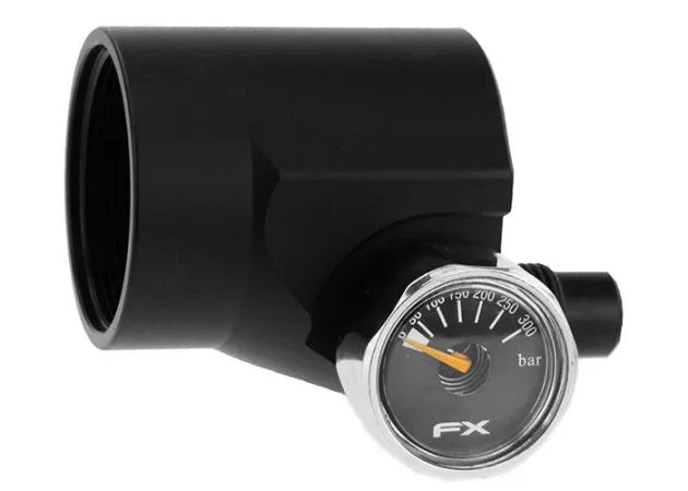

The bottle conversion required a new regulator, it was difficult to get it exactly where it was set before but I got it close on the second try.
