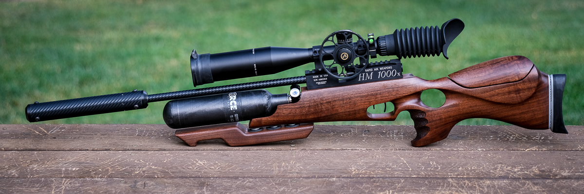

I've always been nervous about setting my rifle on a bipod at the bottle (although my rig does weigh over 12lb). It could be my own wonky thoughts, but I just feel like it stresses the threads at a weird angle. I ended up building an extension so that I can still have the advantage of being able to rest the gun further out on a bipod. It definitely helps mitigate some of the movement when shooting hunter style FT.

Al that being said, the ghost is so much lighter and shorter that I probably wouldn't worry about resting the bottle on a tripod.

Great idea on extending the placement of a Bi-pods contact beyond stock and off the bottle.
Sadly by AAFTA rules what we're seeing is not legal in Hunter being the point where the notched area where yoke of a bi-pod rests, it has 2 stops being both in front and behind. We're only allowed 1
just a friendly FYI

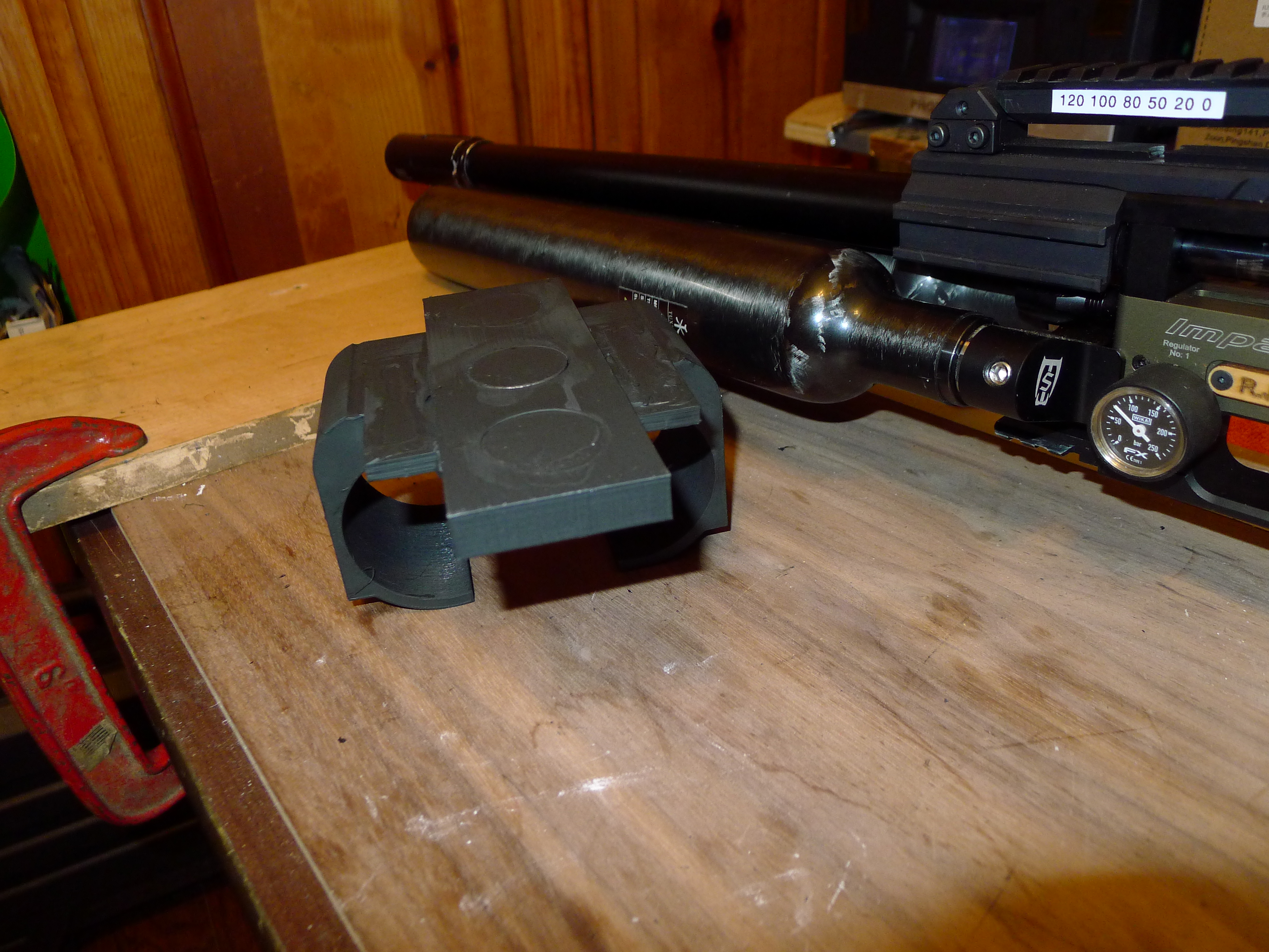

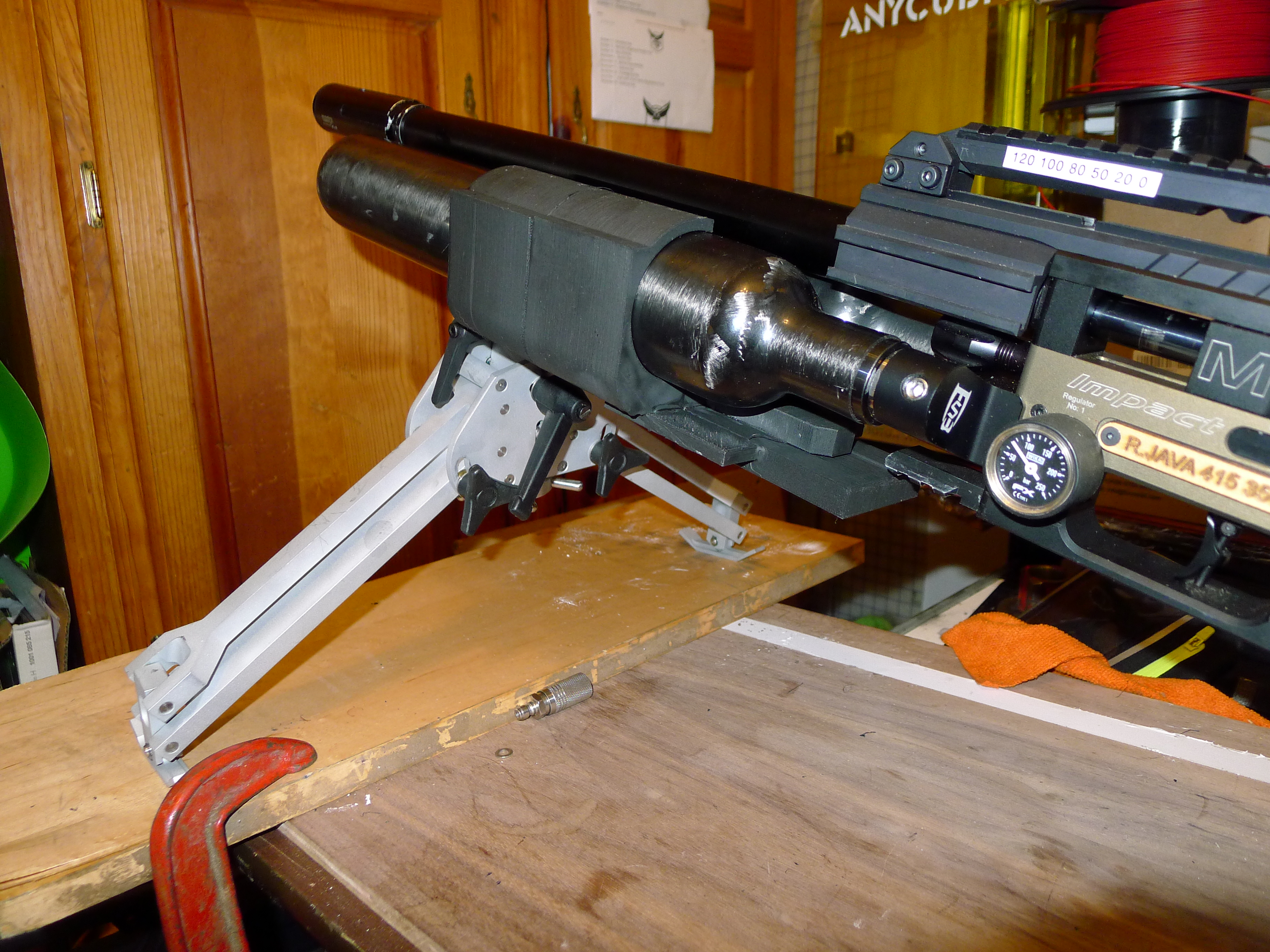

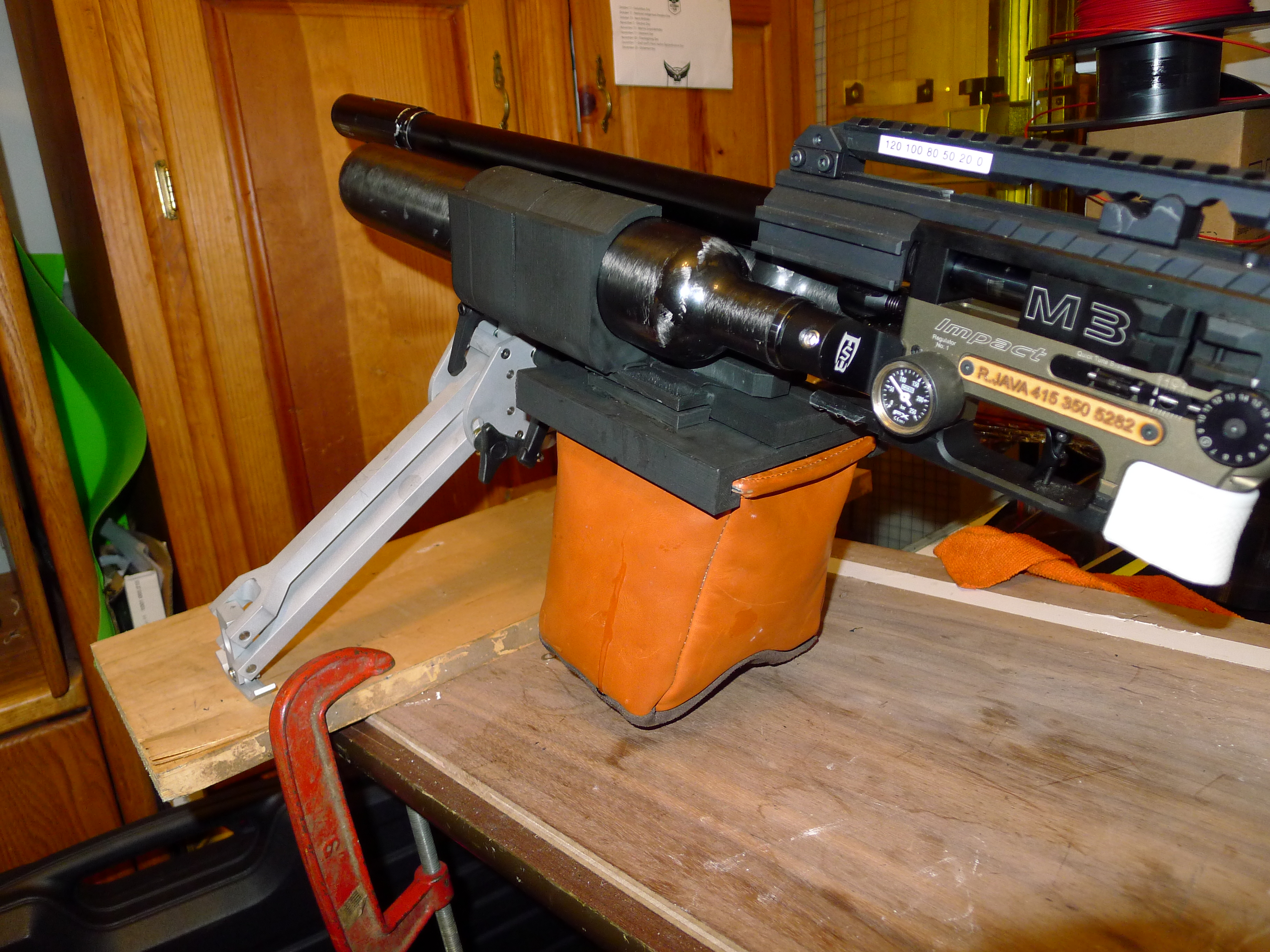

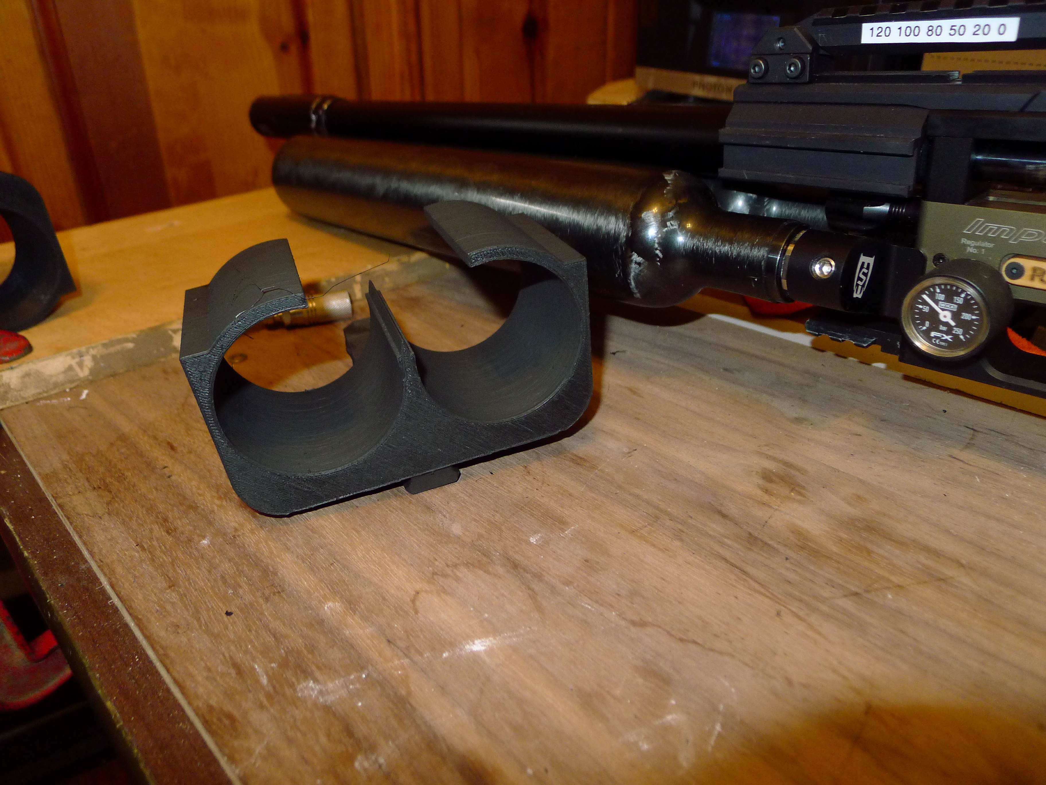

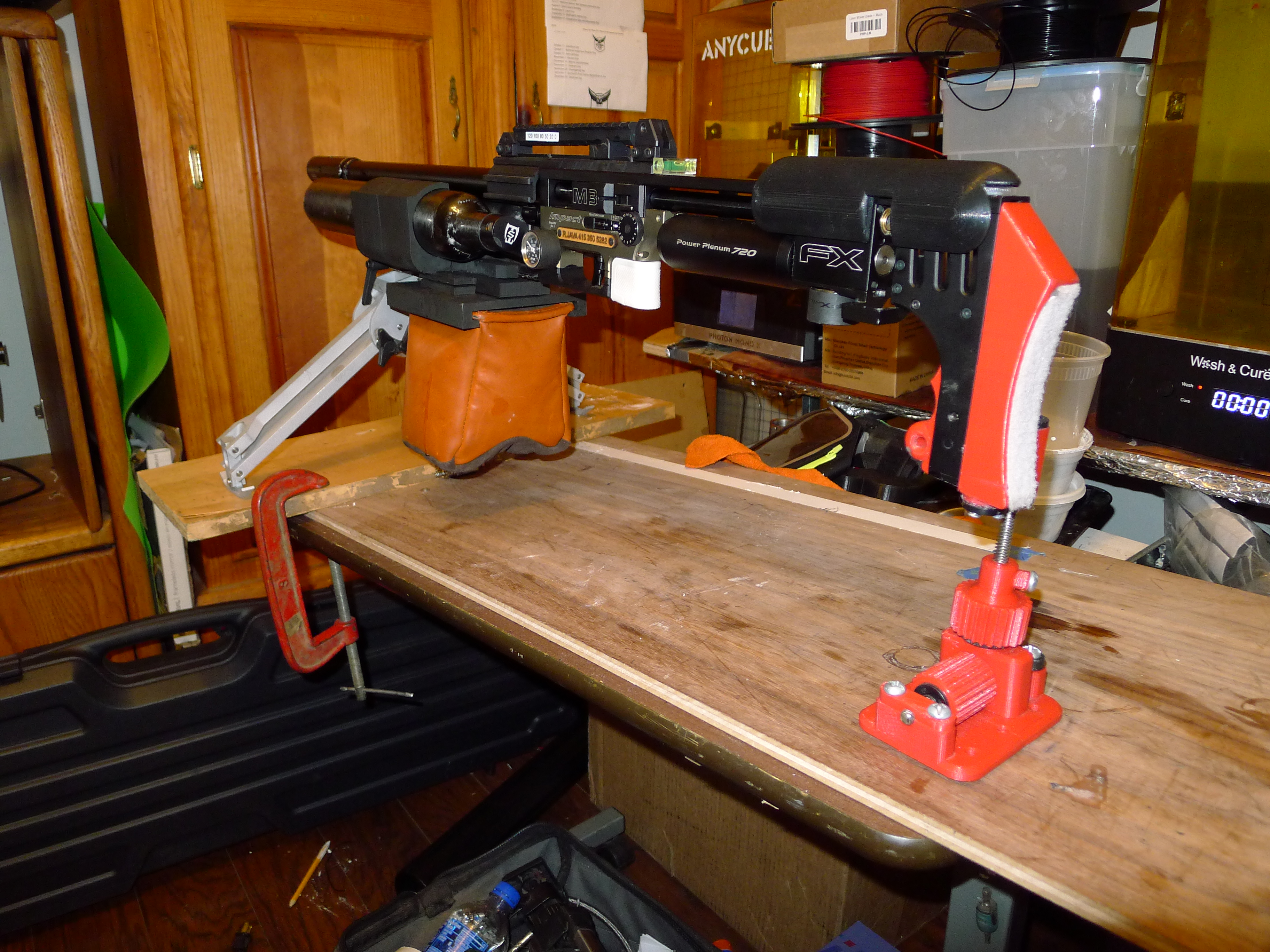

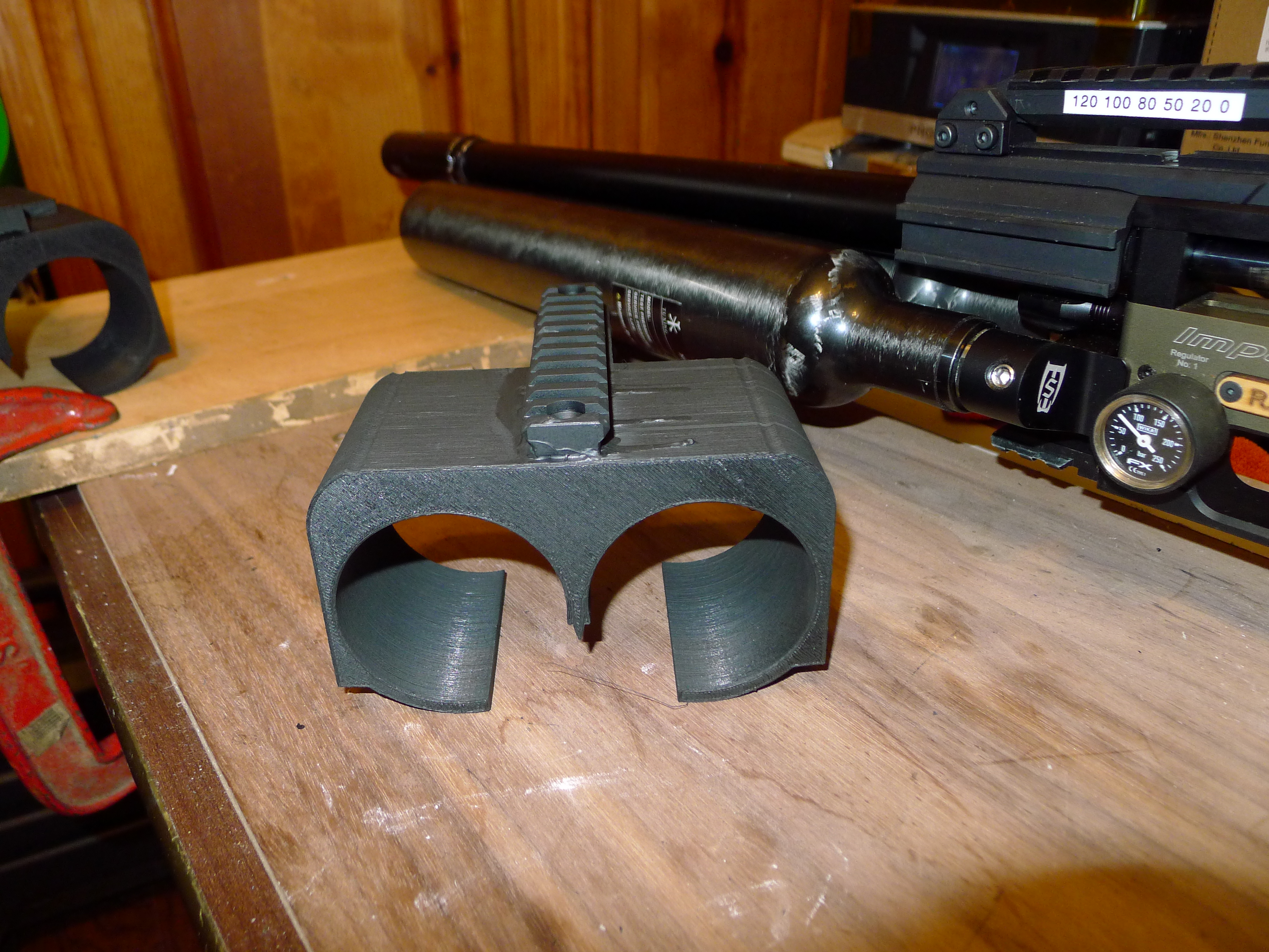

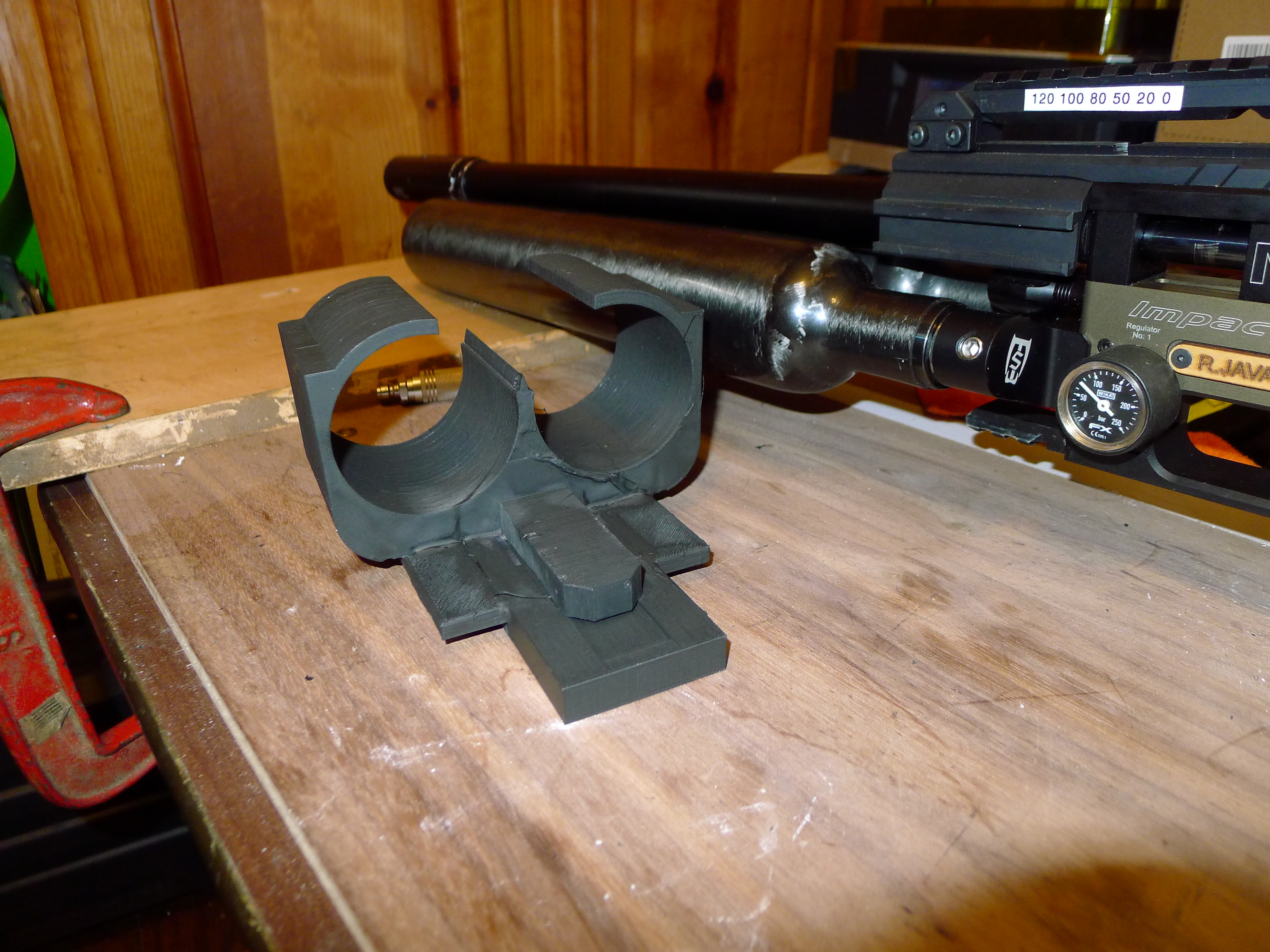

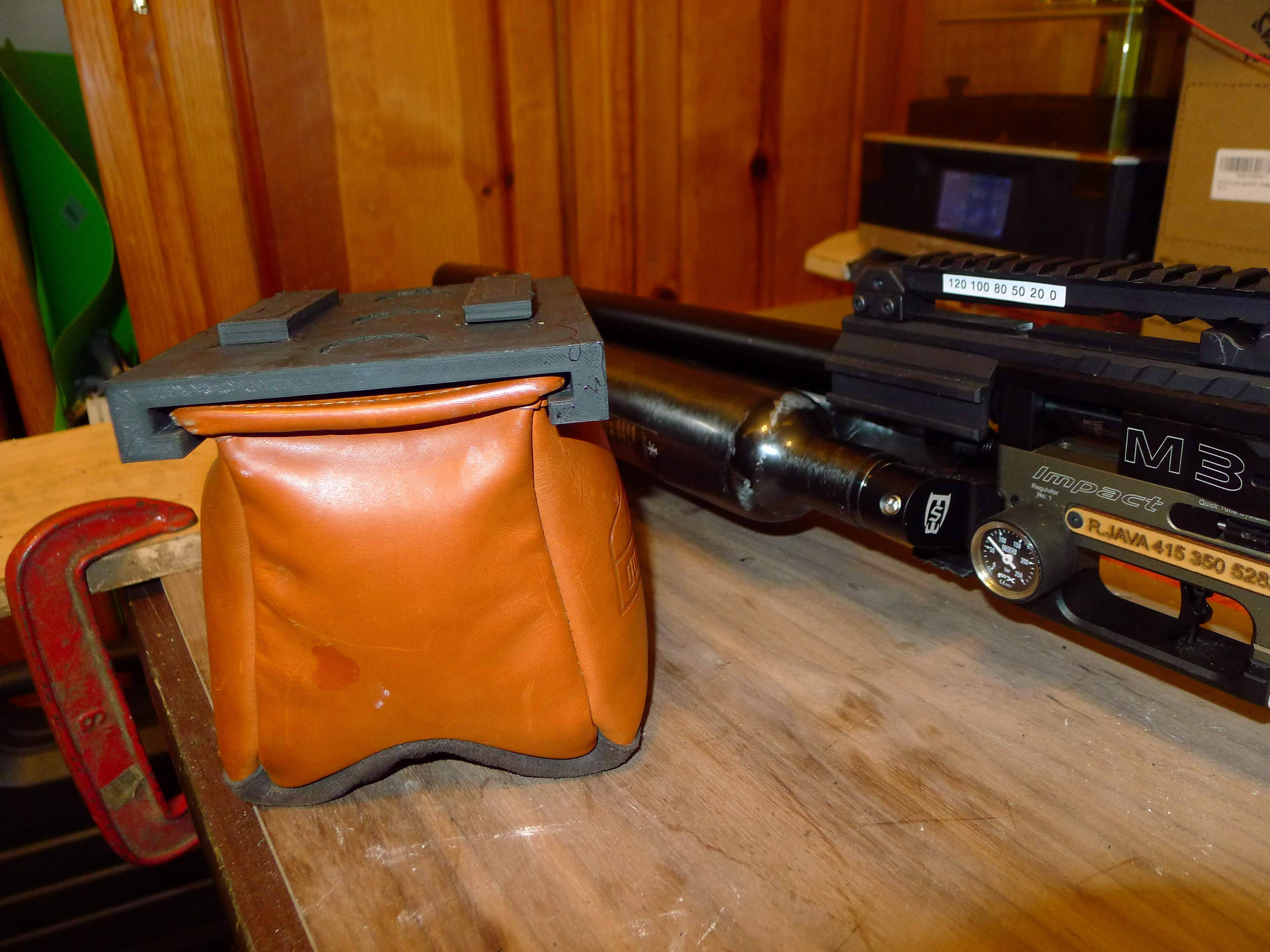

I admit, I am a bottle clamper and also a 3d printer addict. When clamped by the bottle in the front and supported with rear mono pod, it makes a rock solid foundation. IMHO it does not put any undue pressure on the bottle threads since it's balanced. I bench rest differently from other BR shooters by adding some weight towards the front using magnets. Like those high end BR setups, I practically don't need to touch the gun after making my final aiming adjustments. Just a light trigger pull.
Most important is that the clamp should not touch the barrel! I feel that the barrel should always be free standing.. So a dual use barrel/bottle clamp should not be used. I'm sure that my BR setup would probably be banned in some competitions, states or countries. lol But it definitely helps with my 2-3
inch groups at 200 yards.
Oh yeah, my Rumpel F-class bipod helps a lot too!

Beautiful work on the extension. Excellent color match. And outstanding looking complete rifle. 👍👍
