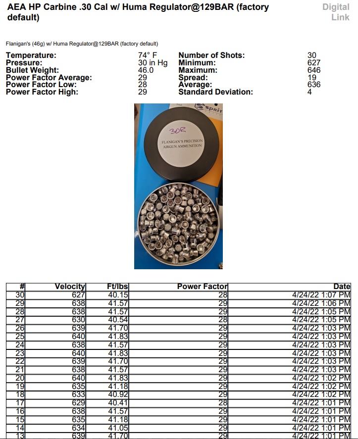

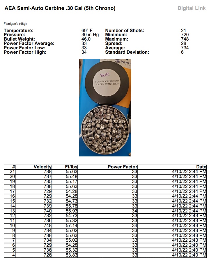

I have a question: I just bought a HUMA-AIR Bottle Regulator for my AEA HP Carbine Assassin/Backpacker w/ the CF bottle, in .30 Caliber. The HUMA Reg. came set (label on bag) @ 129 BAR. (I have a threshold of 70 – 155 BAR I can use) I went from an average of 730 FPS +/- (w/o the REG.) with JSB .30 Hades-44.75g or Generic eBay-46g Pellets, to 635 FPS +/- when I added the HUMA REG. (?) The AEA HP Carbine already has a generous shot count as is, unregulated. I want to achieve similar power levels (700+ FPS) with a consistent "FLAT" "Power Curve" (more important to me) as opposed to more "Shot COUNT". Any suggestions on the REGULATOR's setting or hammer spring to achieve this? I'm not sure if the AEA HP is hammer adjustable or not (?) Any info or tips would be HIGHLY appreciated! Thanks.

So even at 170 BAR (which seems to be beyond the recommended max of 155 BAR), that is still not enough to get near MAX power with a Flatter power curve out of the AEA HP Carbine with the HUMA Bottle reg.?
Again, I have the same rifle but in .30 caliber. I get around 730 FPS with 44.8g pellets non-reg. & about 635 FPS w/ HUMA @ 129 BAR.

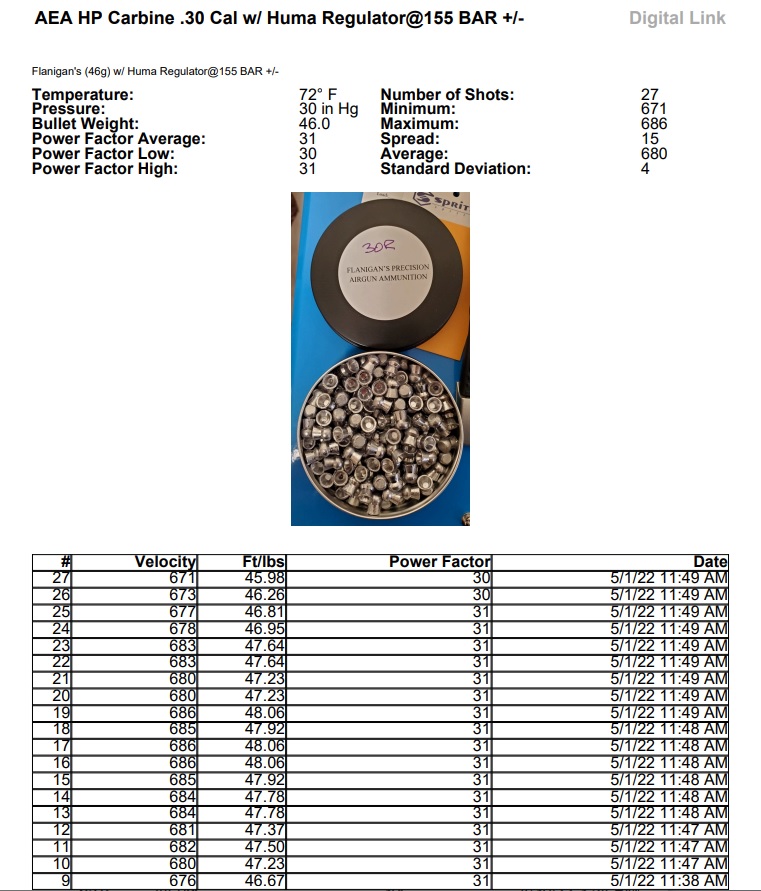

Thanks for the info fiv. VERY Helpful. These are my results: <attached> The 1st one @ 734 FPS is UNREGULATED / DEFAULT full power. (all tests w/ 46g pellets)
The next 3 are w/ the HUMA Reg. attached at different pressures. I notice I'm getting about 48 FPE with what I thought was 155-160 Reg. pressure from what I noted in the 3rd screen-shot. But, from what your saying ("with the increase to 170 bar, the power got up to ~46 fpe.") - it must be 170+/- BAR it's set at. (?) Also, curious if it will go beyond 170 BAR reliably (e.g. 185+ BAR). The site mentions this at the bottom of the page:
