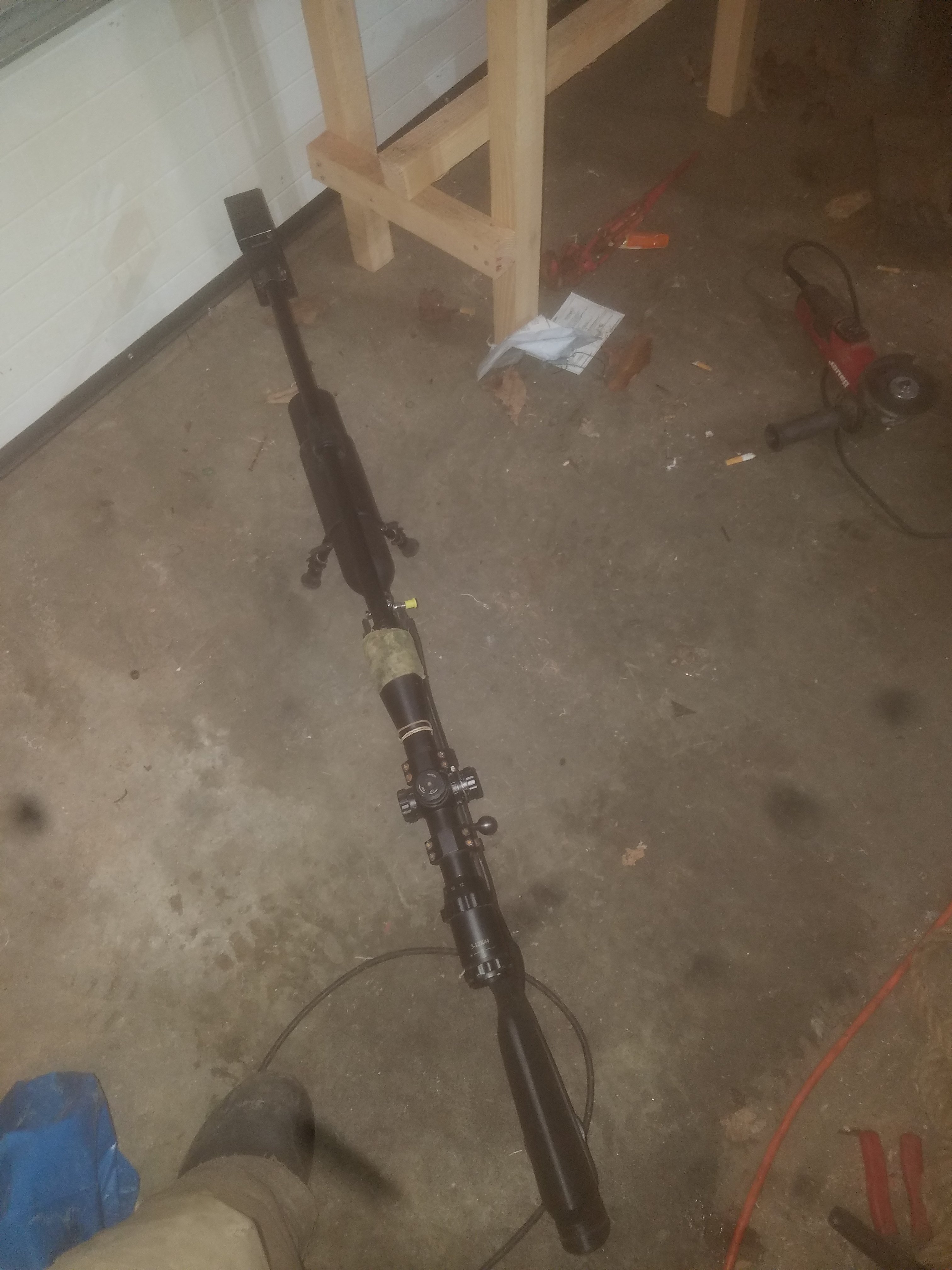

The thing is a little is a little crazy now but found a metric regulator and got a 28 grain slug moving at 980fps
