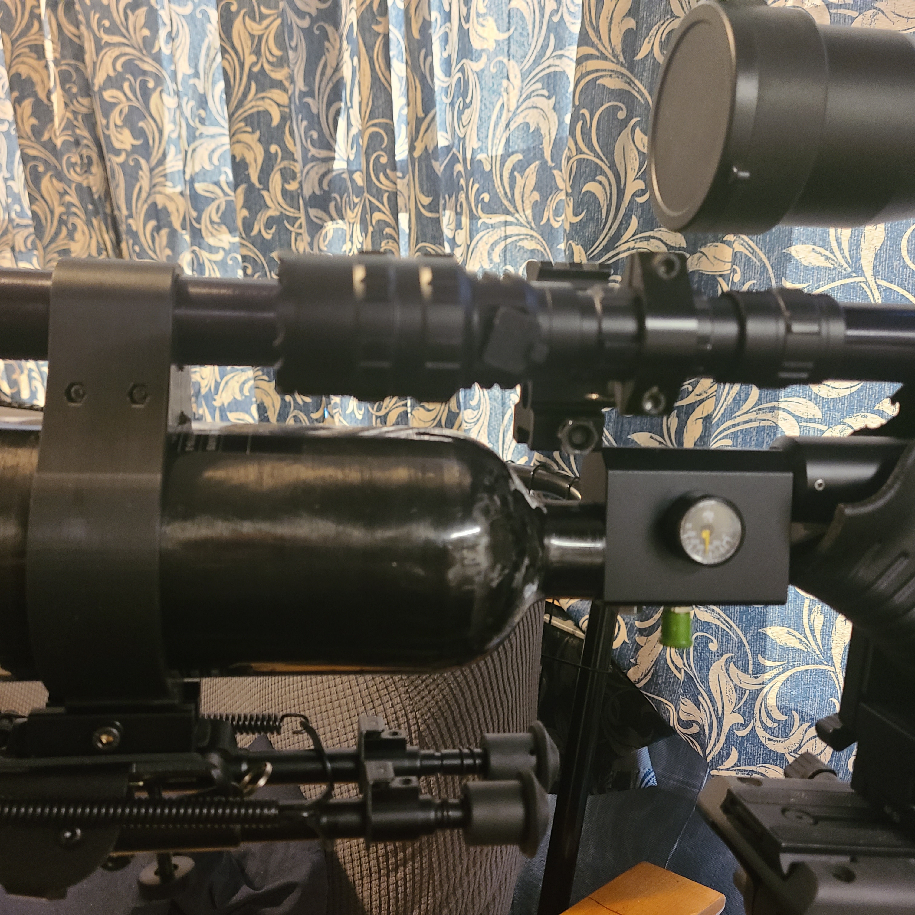

I wanted bigger cylinders on a couple of my semi-auto.
Above 0.7 (now 0.8) 61mm diameter cylinder you jump to 86.5mm diameter or larger on the 300bar CF cylinders.
Huben Power Dream Valve offsets ~30mm from the cylinder inlet centerline.
I have 1.1L cylinders (86.5mm) and given the spacing on those rifles I could go as big as 2L (96mm)

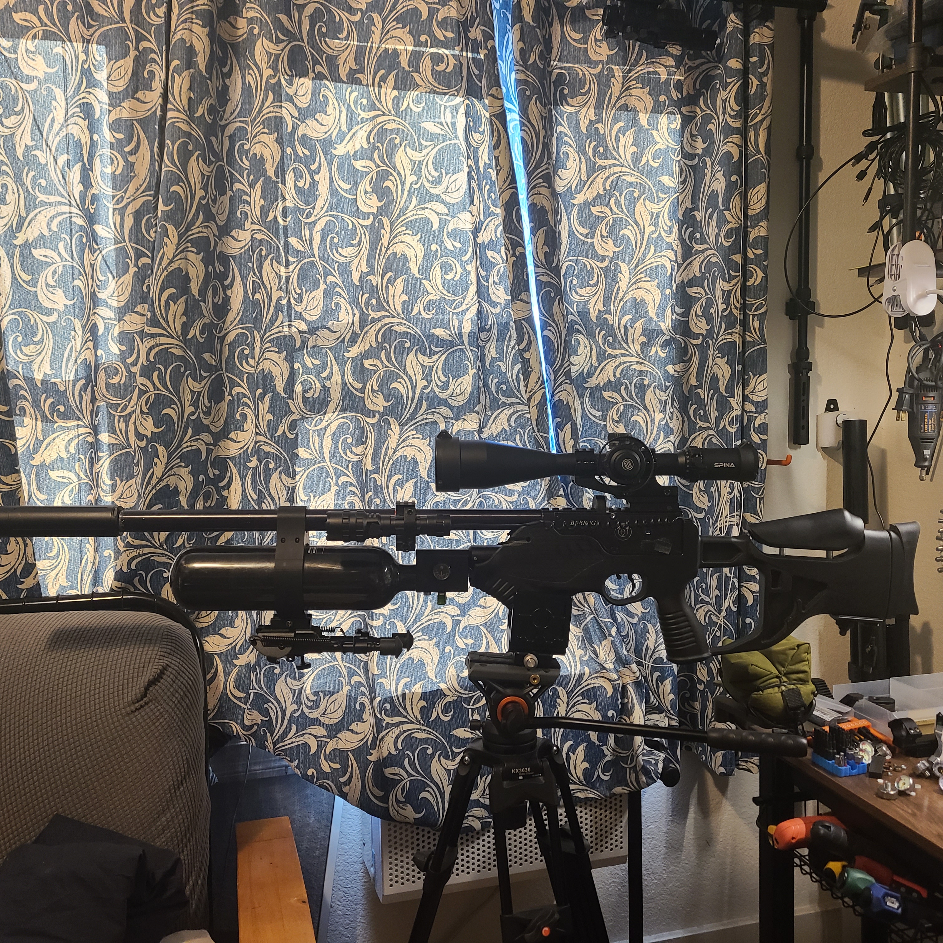

now, i want to see a picture of a gun with an 1.1L cylinder, please. do you carry them around?

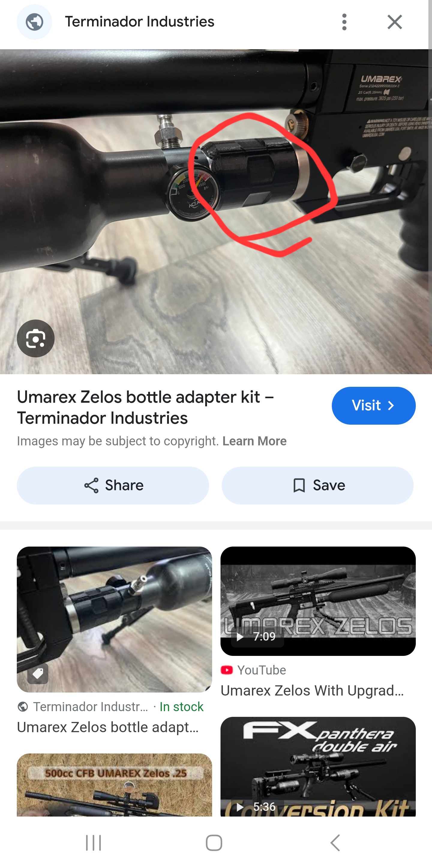

for a max. 250bar HPA adapter, i find the 3D printed look pretty creepy.
in the pictures on their website, it seems like there is some metal inside the adapter,
but no ratings or further description of the material whatsoever. =(
... of course ratings can be faked and all, but i would not trust this one.
Don't be paranoid. It's made by terminador. They a company that makes good products. You don't think they would be making sht without testing it? Here is video of the zelos with their bottle conversion.
Hatsan Barrage .22
Had to cut the stock down for the Dream Valve. Custom barrel bands from Jake at jb3dpd.com. My Hatsan Bullmaster .25 got the same treatment.
As for carry around, I have my Evanix Sniper X2, Niksan Ozark or Hatsan Sortie. I generally shoot my heavy creations off the tripod.

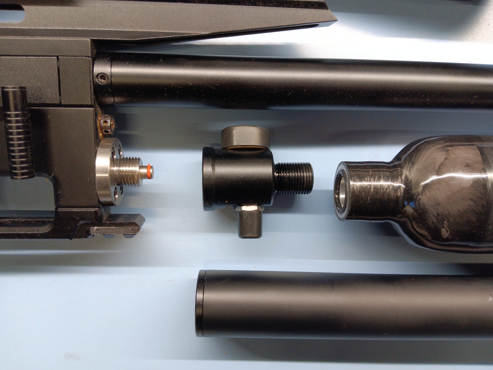

Will you guys help me understand why I can't just unscrew a tube and screw on a bottle? I understand that it isn't that simple but I don't understand why. I would like to upgrade my Zelos to a bottle. Thanks for any advice.
Threading is only one issue, the needed adapter has a plunger seal, pressure gauge and fill foster on it to adapt it to the guns air-port.
The Zelos air tube already has all the parts on it as well as the correct thread pitch.
Here is the bottle kit and the tube along with the guns air-port.
