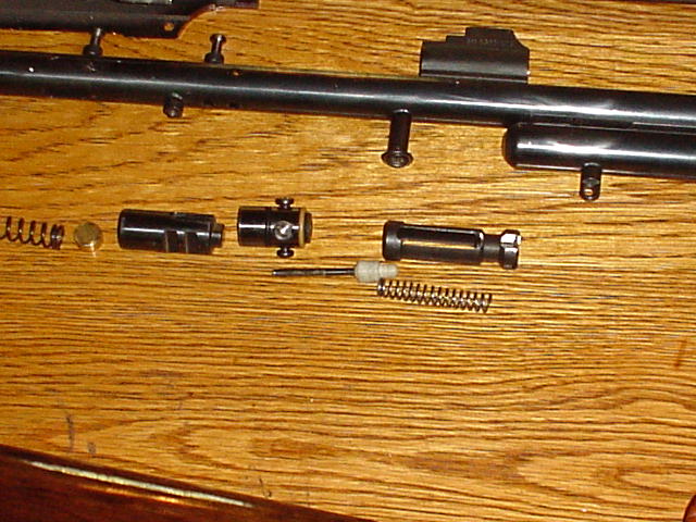

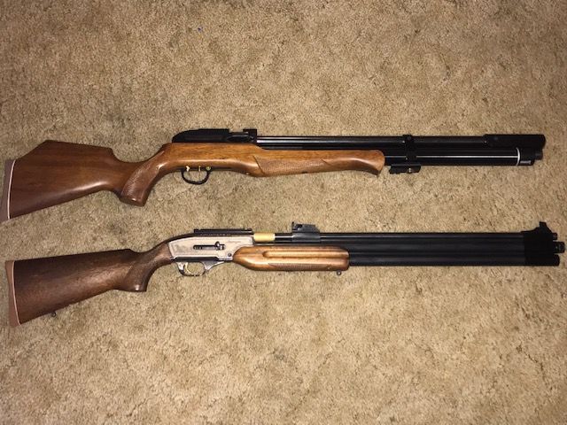

I bought these Korean Beauties the other Day, they showed up Yesterday afternoon, they are leakers I picked up at a good price, the Dragon 50 had several leaks and a Bad Poppet, the 909 had several leaks at the fill end, I took apart the Dragon first, found the O-rings needed replacement and the poppet was really worn out, so I replaced all the O-rings and resurfaced the Poppet on the Lathe, re-assembled and pressurized to 3000 psi.
I took apart the Big Bore 909 .45, the O-rings were shot, so I replaced all of them, checked the Poppet and it was good, re-assembled and Pressurized to 3000 psi,
left both guns over night and re-checked the pressures this morning, both guns holding pressure at 3000 psi, leaks are fixed and guns ready to go to the range,
these guns are very easy to work on, not very complicated at all, so if you are intimidated by your PCP, don't be, It's a hundred times easier to deal with than doing your Taxes......😂

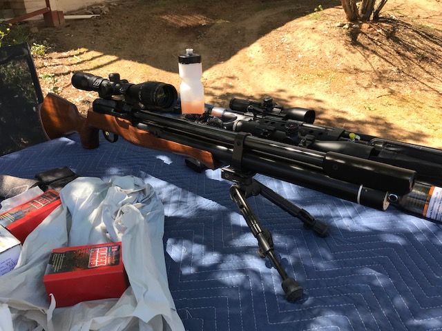

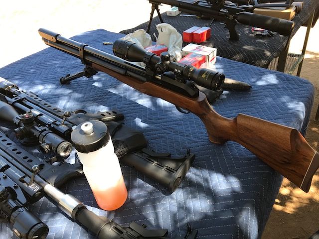

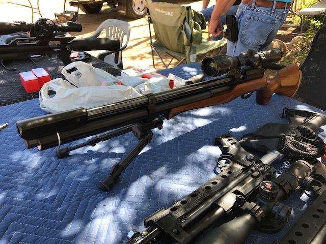

They work...... shot them Yesterday at the range, both shot flawlessly, put about 80 rounds through each, the 909 45 was very accurate with both round balls and slugs, it liked the .452 250grn long colt slugs the best, the Dragon Slayer like round balls the best, but still liked the NSA slugs, both had plenty of power to take down a deer or a pig, these guns are fun to shoot, the accuracy is on par with the Texan or better......👍
