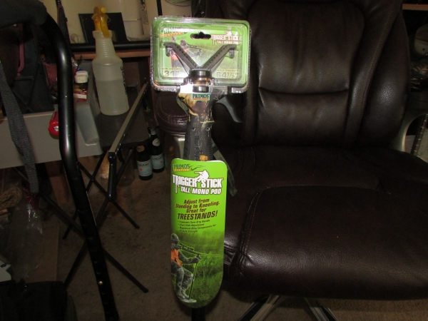

I just got a couple tins of H&N hornet pellets a week ago. I got these in .25cal @ 24.38gr(previous version, newest is 23.16gr) from Pyramid Air. And they weren't cheap. But should make a great pig pellet. Gonna test'em as soon as it stops being so cloudy and dark so I can film it. Will shoot at short range target through chronograph. Maybe 8 yards or so indoors? I also finally got my Trigger stick, which I think I'll use in place of the bench bags just to get used to using it.

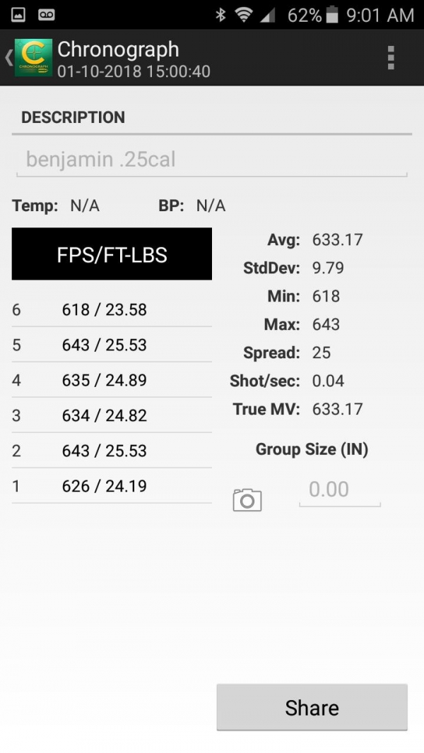

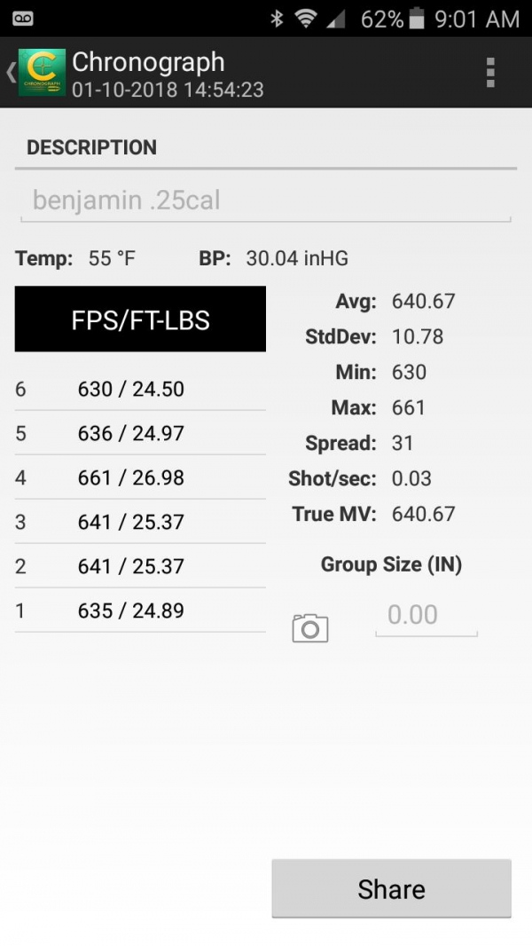

I didn't input the BC; that's what the Caldwell Chronograph APP puts in as default. Idk what the BC is off-hand? And I also tested the JSB King .,25's @ 24.39gr. Here's some readouts to ponder;
​JSB King .25, 25.39gr;
​H&N Hornet, .25cal, 24.38gr;
​And H&N FTT, .25cal, 19.91gr;
Again, BC numbers are default.
