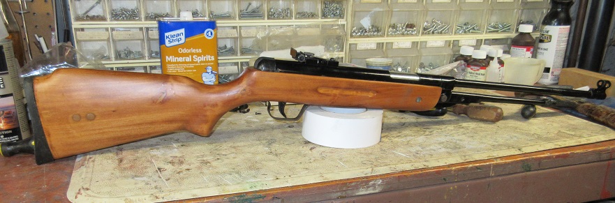

For me 99% of the fun is in doing it myself. I'm also on my second B3 ressurection-from-the-trash-heap, and there may be more... I already built a spring compressor for the B3, and figured out a dandy metal spring guide replacement for the factory ABS guide.
I have safety gear and a kevlar blanket for catching flak - I certainly don't recommend that other folks risk life-and-limb to save $20!
