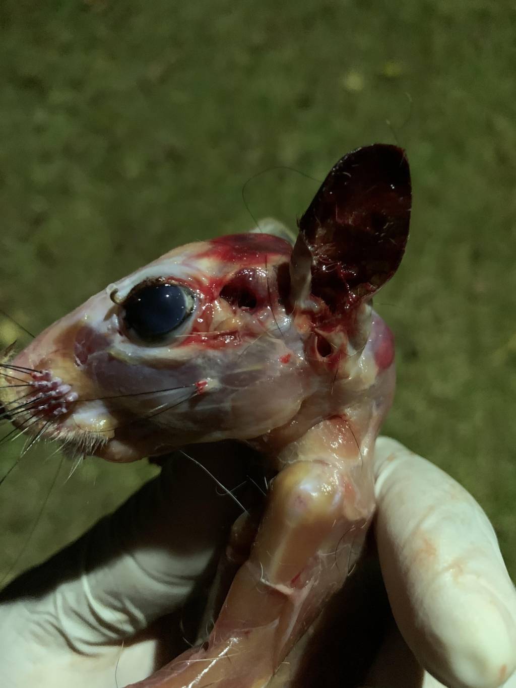

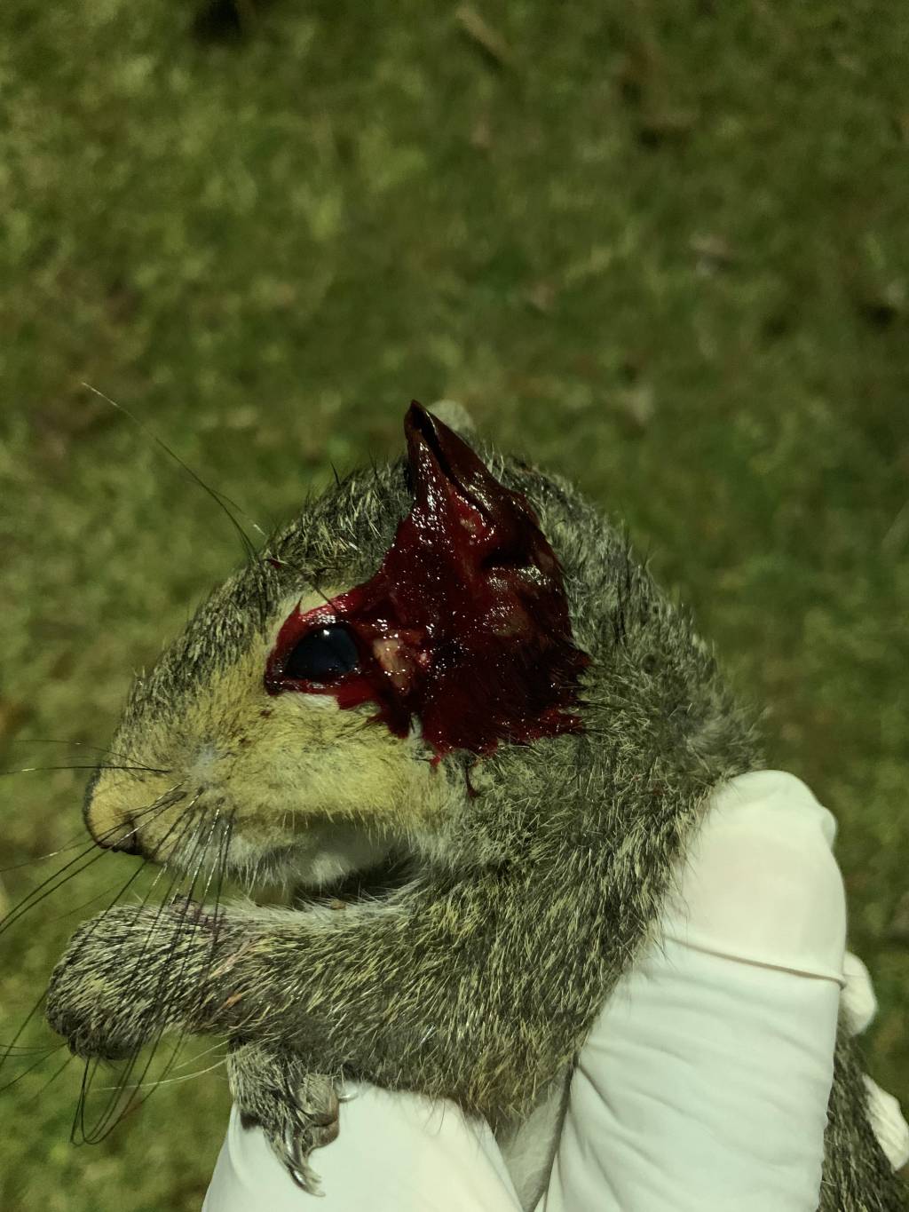

@markT It’s been discussed on AGN. I don’t recall if squirrels specifically have been discussed in this fashion. Ideally, shooting and hitting them from the side, between the eye and ear, has been very effective in putting squirrels down quickly and humanely in my experience.
From the front, hitting them between the eyes puts them down fast as well, although they tend to flop around more from my observation. These are violent, convulsive types of movements.

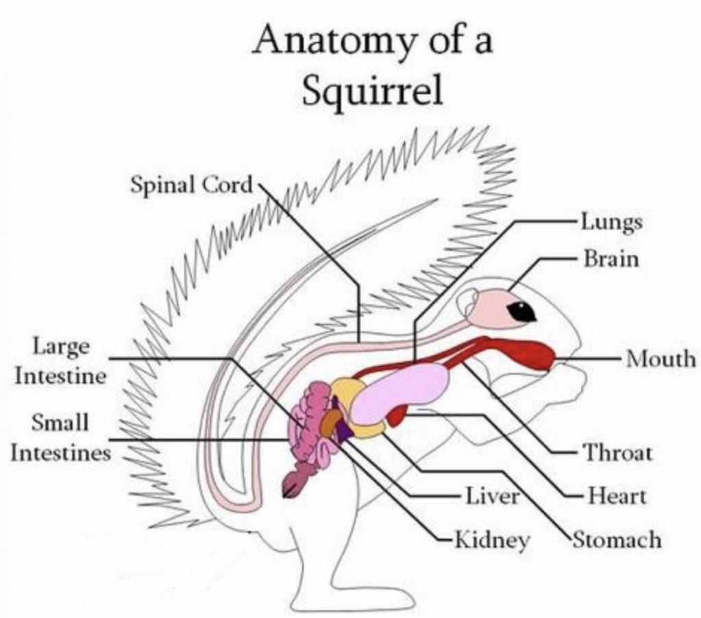

Edited to add diagram and link.
The above diagram came from this airgun blog https://www.ctcustomairguns.com/hectors-airgun-blog/the-other-side-of-an-accurate-shot-iii
I cannot attest to the accuracy of all of the author’s claims in his blog post.

It’s a worthwhile topic of discussion. I hope that the culmination of the experiences of contributing airgunners remains accessible on AGN to help others. Thanks for posing the question. Strangely enough I didn’t see much in the way of decent diagrams on squirrel anatomy for hunters. Since I started eating them I have learned more about their anatomy from skinning and gutting them. I still have much to learn and posts like this are beneficial to me.

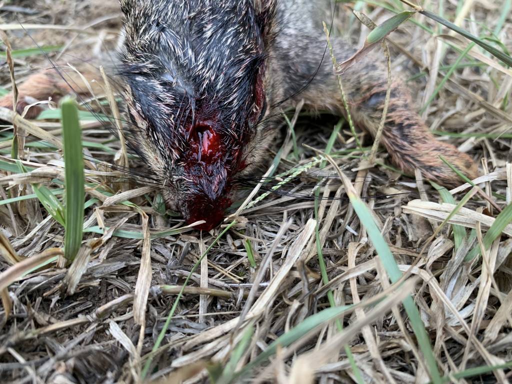

I also appreciate ezana's excellant post and I agree with the information it contains. I usually aim for the brain but my shooting is not always that precise. I've found that neck shots kill about as quick as brain shots. So aiming for the portion of the head towards the neck not only targets closer to the brain but if you are a bit further back you get the neck and the squirrel still dies very quickly. I've been shooting them this year with my P35 using FTT pellets at 850-900 fps. I hit one smallish squirrel (about half a pound) on the forward part of the head, in front of the eyes about at the joint of the jaw and it still dropped immediately and even did the brain dance. I think the 25 caliber pellet pretty much crushed the skull, that's what it felt like when I was cleaning it. I don't know if my much lower power Prod would have killed it as quickly with this placement. I keep a few statistics and I put head and neck shots in the same category. They seem to have similar effect with squirrels dropping quickly from both. Even with the P35 I have had squirrels run as much as 15 feet with a body shot - but it is rare.

🔸 I'd love to see a series of diagrams or photos of different animals — from different angles and different body positions — that show where to hit, taking into account brain shots and heart & lung shots.
Same for pigeons.... — just like Ezana4CE, I have learned more from preparing them for consumption — than from the poorly done diagrams published in our forums.
