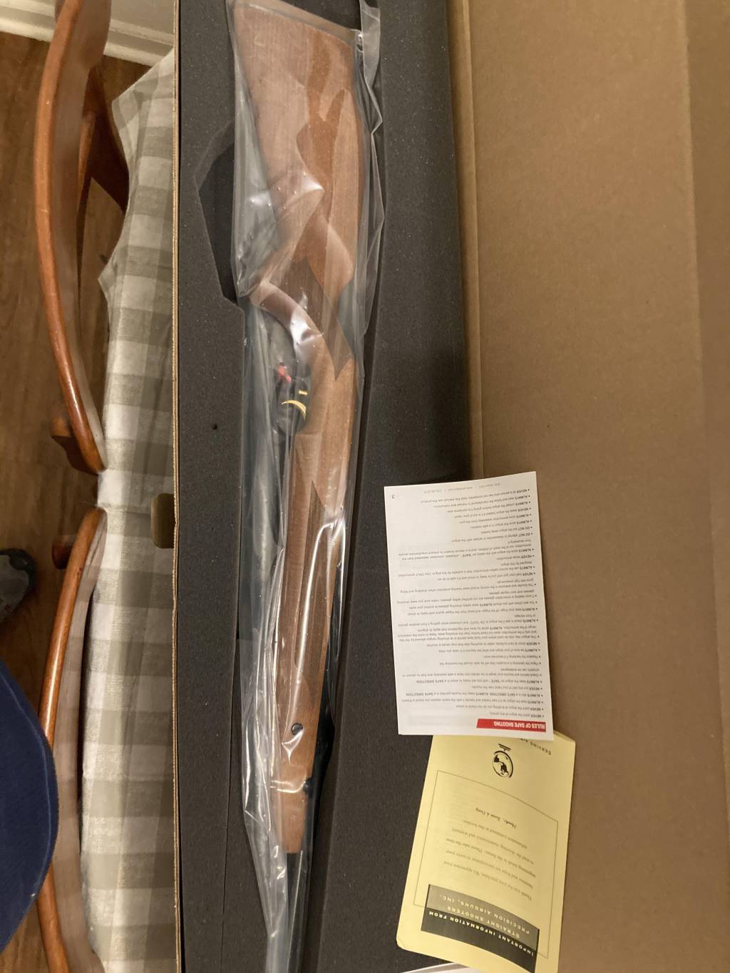

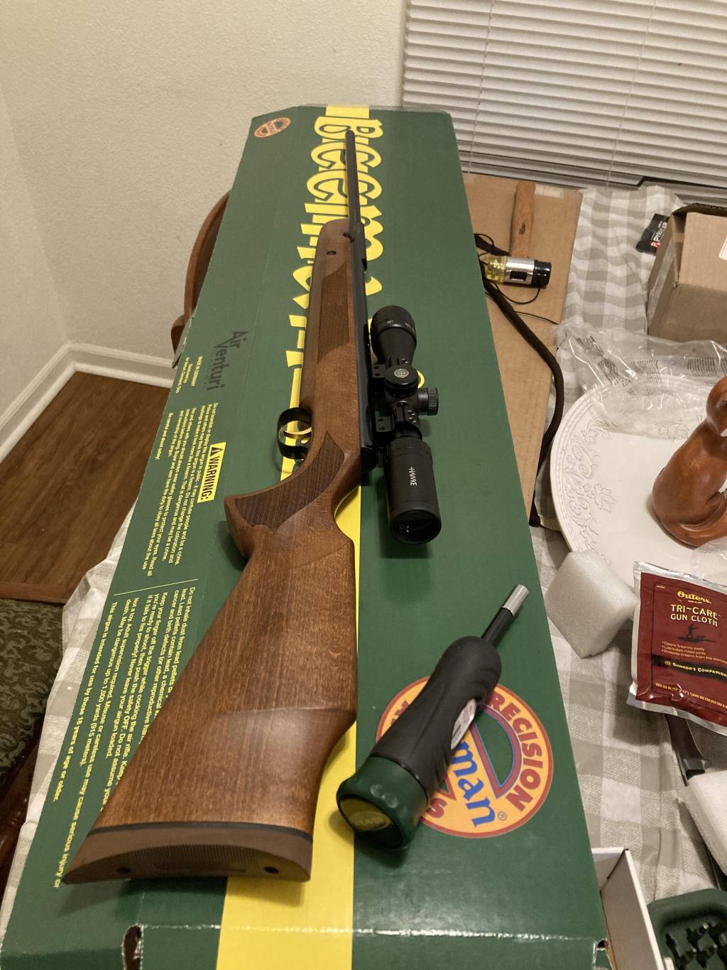

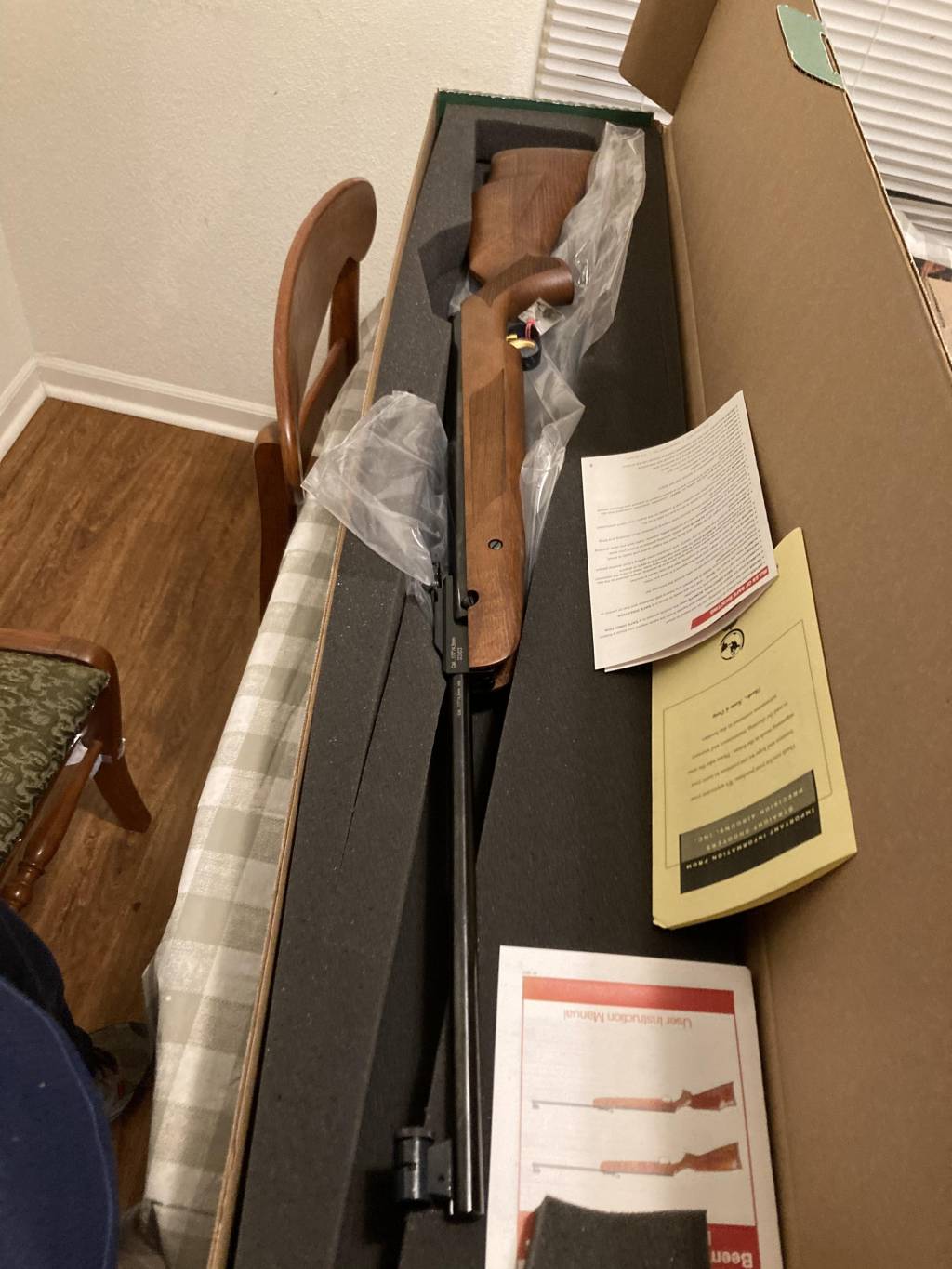

I ordered a .22 Beeman R9 from Straight Shooters, they accidentally sent me a .177. I like the gun so much, I decided to keep it anyway. I asked to exchange my .22 pellet sampler for .177, but they told me to keep it and sent one in .177 for free :) I also ordered a Hawke 2-7x32 scope and rings from Pyramyd. While I was getting this gun dialed in today I decided to make a quick range review out of it.
Boxes, last night...

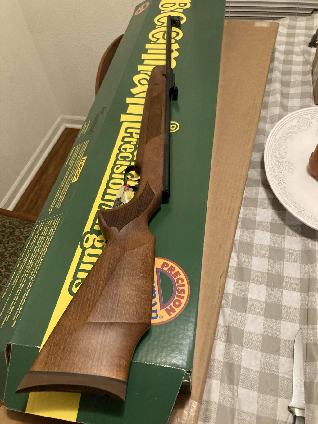

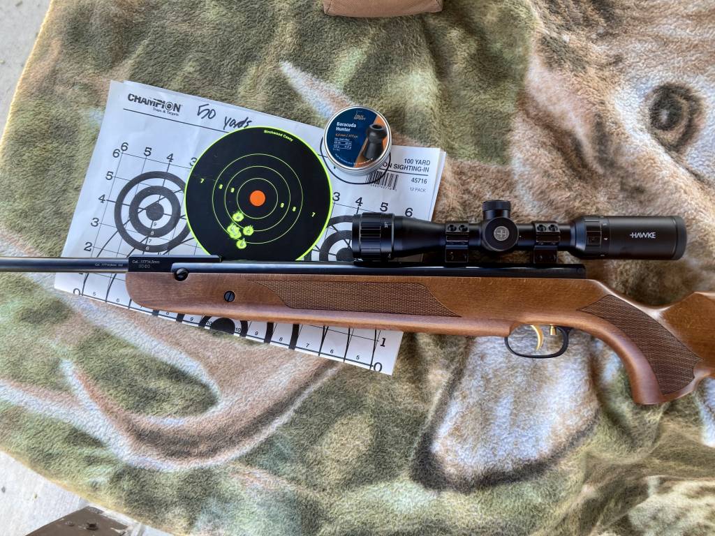

I really like the height of this scope. Hawke 2-7x32 and Hawke low rings on this rifle are a match made in heaven.

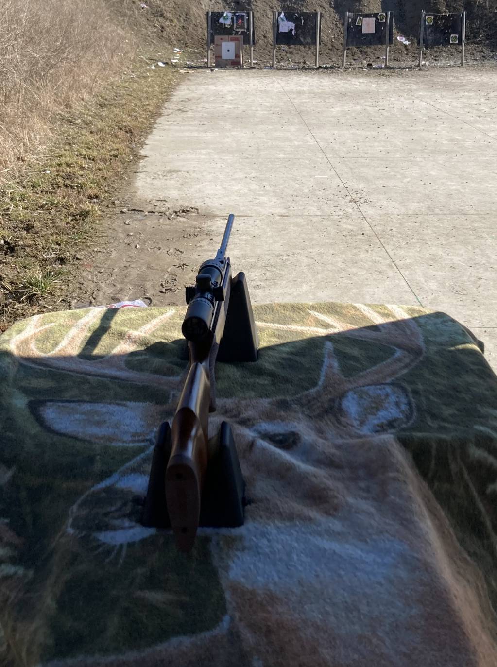

Range, this morning...

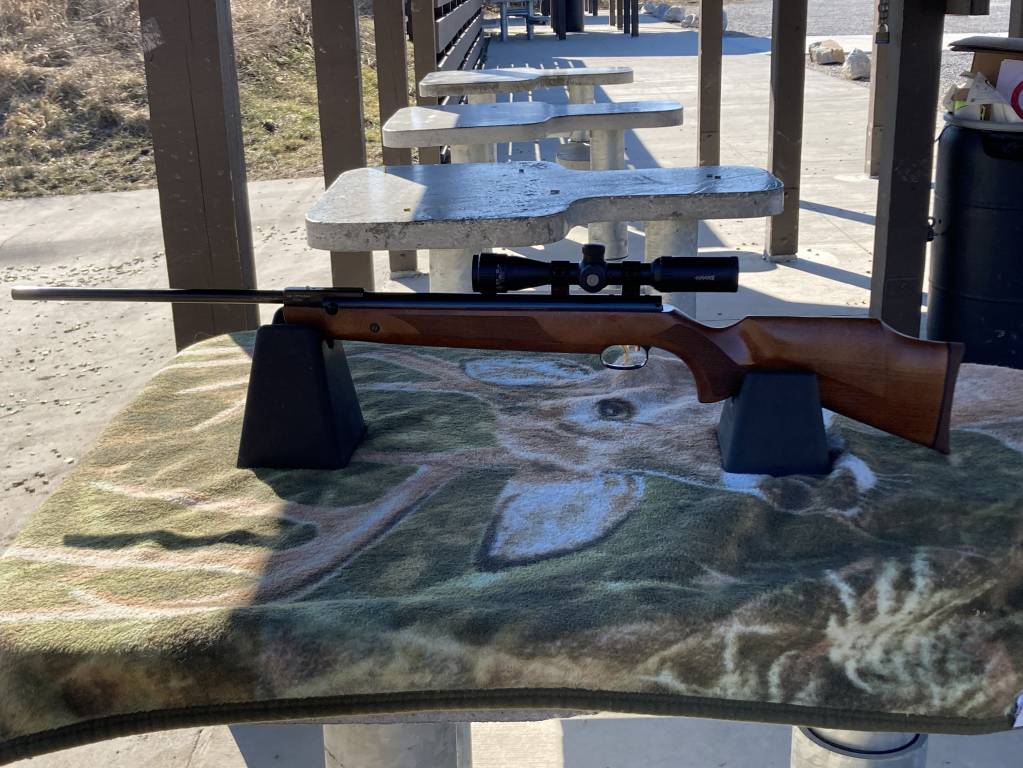

Sexy beast right there, and literally ROCK SOLID concrete benches. I love this range!

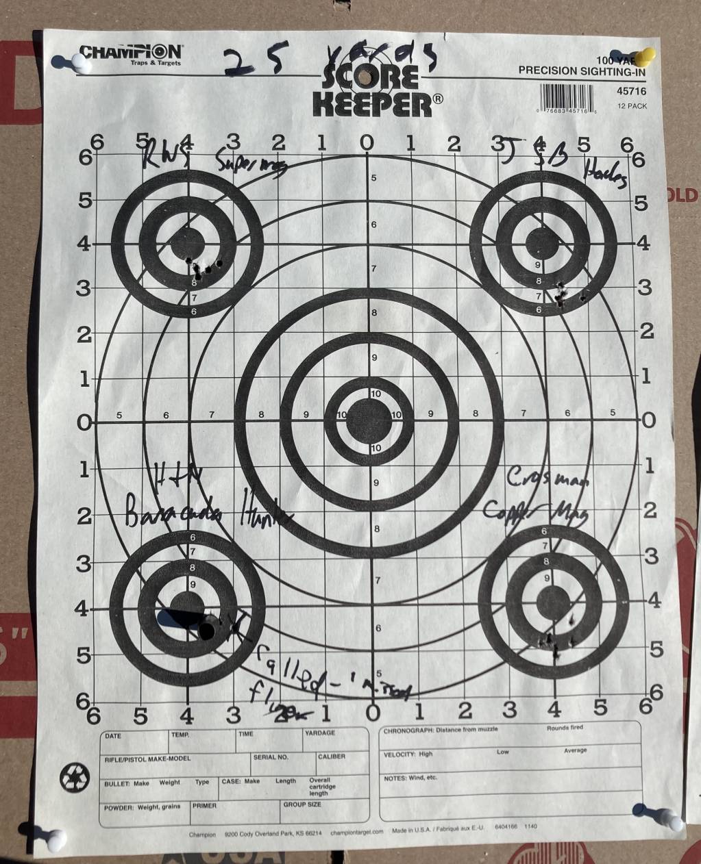

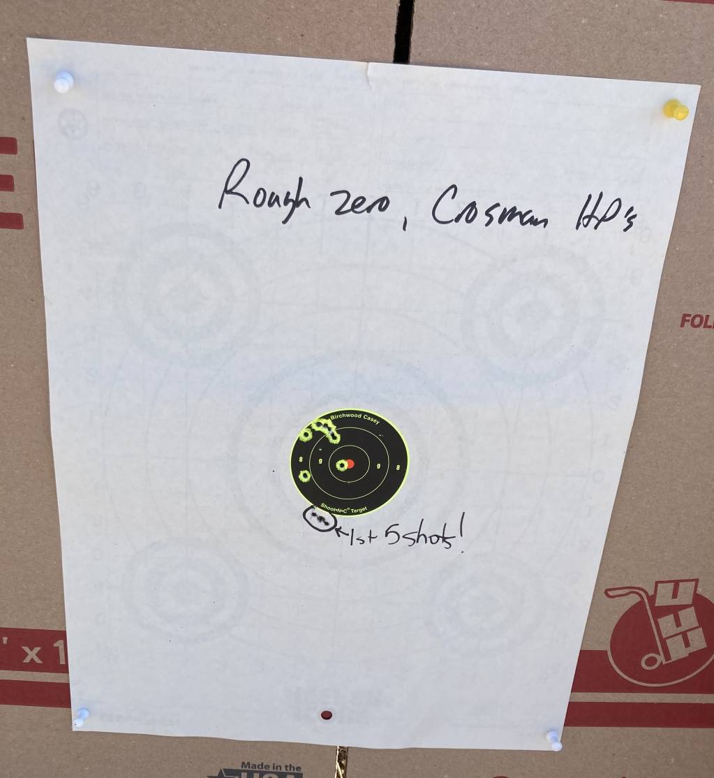

The first 5 shots, plain Jane Crosman Hollowpoints, 25 yards. Sub half-inch group. I love these cheap pellets! Accurate and hard hitting at close range.
Rough zero with Crosman Hollowpoints. I had some trouble with the scope adjustments, and started to think they were actually 1/2 MOA. Once I figured that out, one more good adjustment got me on target. In hindsight I think I just screwed my math all the way up, but we will get back to that in a minute.

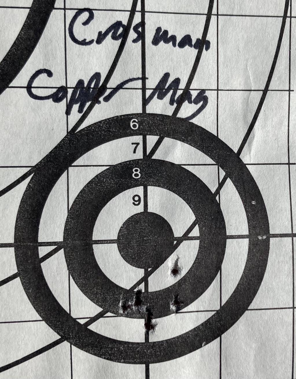

4 more different pellets, all 1” groups or better. I tested RWS Supermags, JSB Hades, H&N Barracuda Magnum, and Crosman Copper Mag. I would not hesitate to hunt with any of these with this accuracy.
Hard hitting heavy wadcutters. Respectable accuracy for a .177 wadcutter at this power level. These hit HARD!
Crosman Copper Mags. Good enough to hunt, but I really expect more out of a good dome pellet. This isn’t the one.
I threw one out of this group, the flier was my fault so I shot one more. That is 5 shots that nearly fit under a 9mm case head

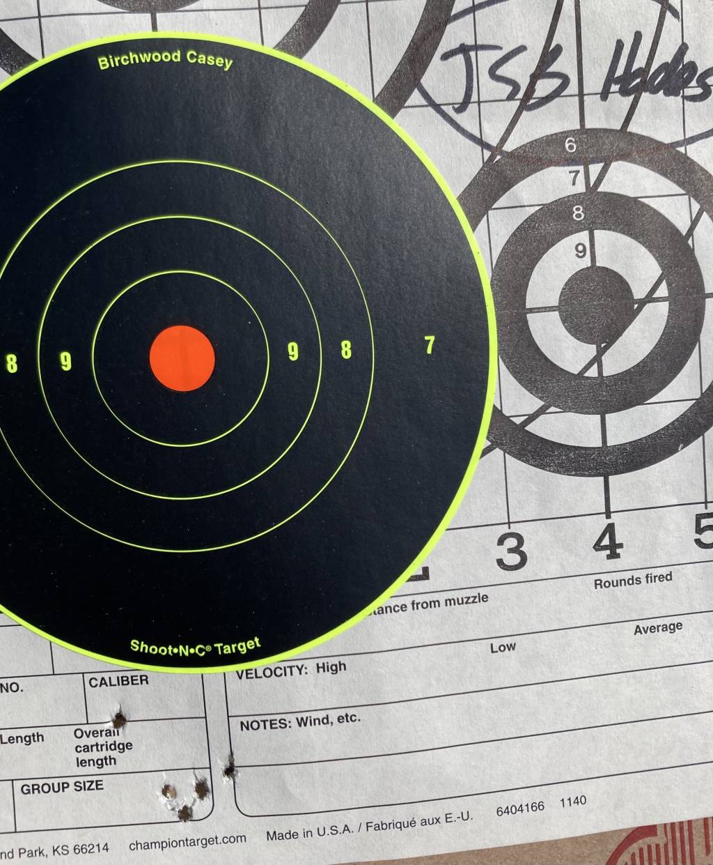

So far it looks like the Barracuda Hunter and JSB Hades are about tied. I don’t think the flier in the Hades group was my fault, but I could be wrong. I drive a rig so I can’t practice every day. I miss sometimes, it is what it is. Even with the flier, I am getting about a half inch with both these pellets.

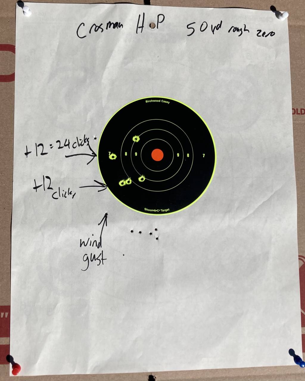

These Crosman Hollowpoints are great out to 30 yards. Past that I would use another pellet if it isn’t dead calm out. The wind was pushing them all over the place.
I called the outlier on the far left on account of the wind kicking up. One more shot and there are 5 shots about and inch and a quarter CTC. Spread out in an almost perfect line left to right.

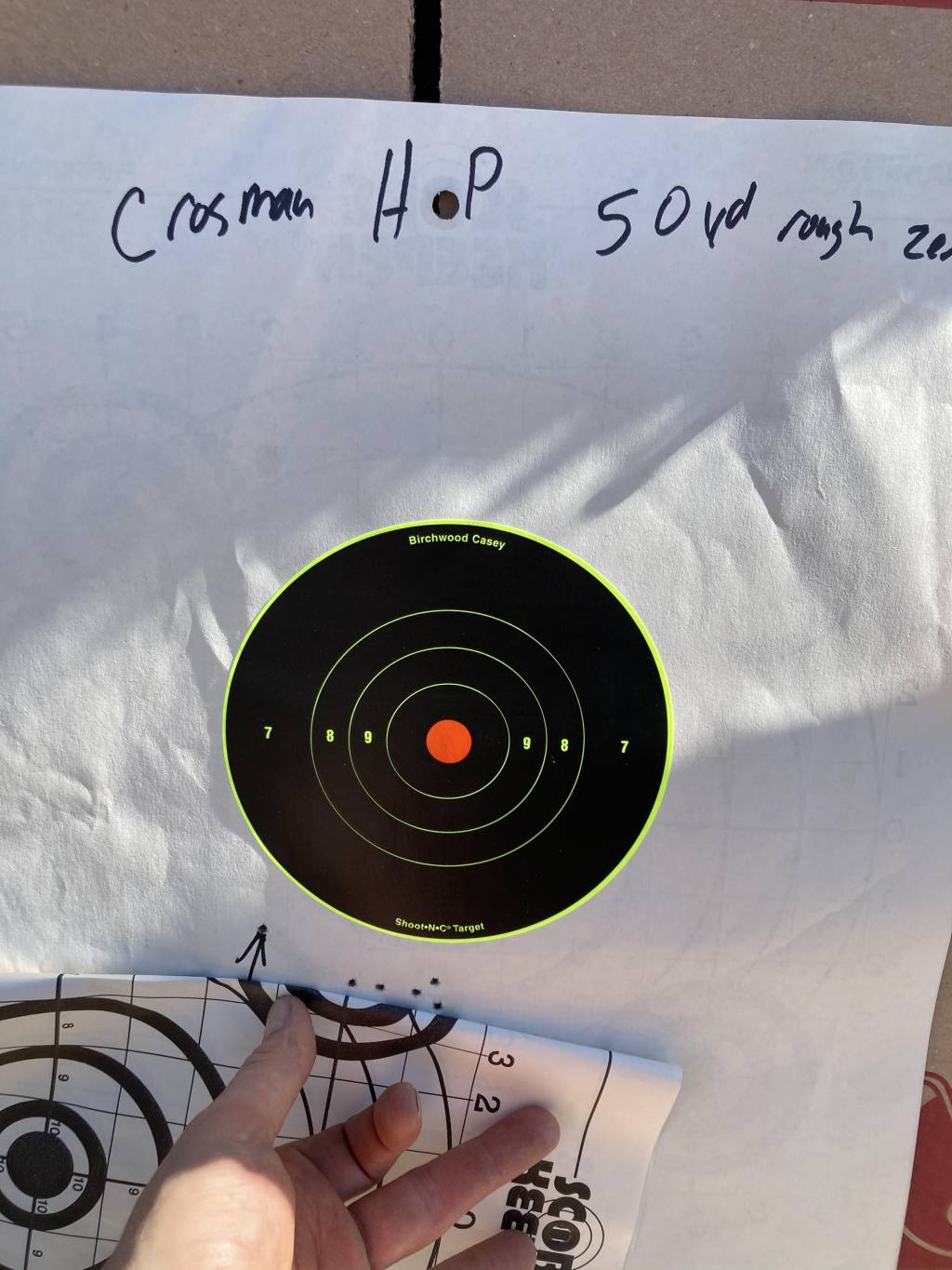

These pellets dropped exactly 4 inches from 25 to 50 yards.
I dialed up the elevation 12 clicks based on 1/2 MOA adjustments and it got me half way there. At this point I realized I just suck at math. Dialed up 12 more, elevation right on point based on 1/4 MOA adjustments. The wind was blowing these pellets all over the place.

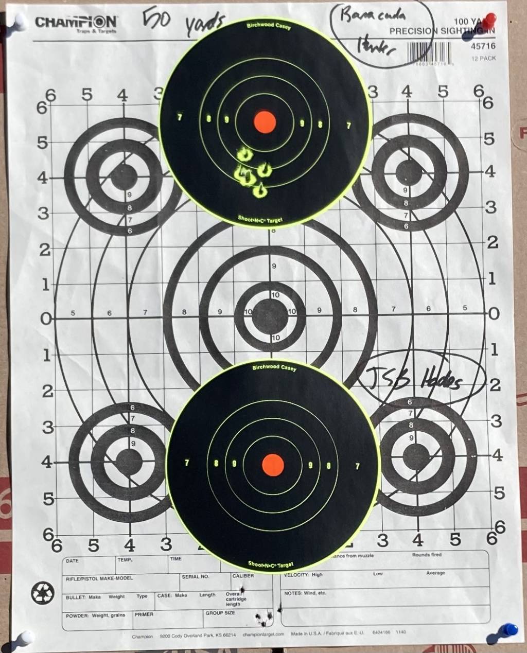

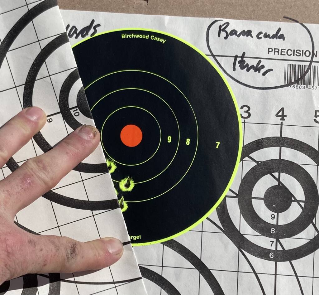

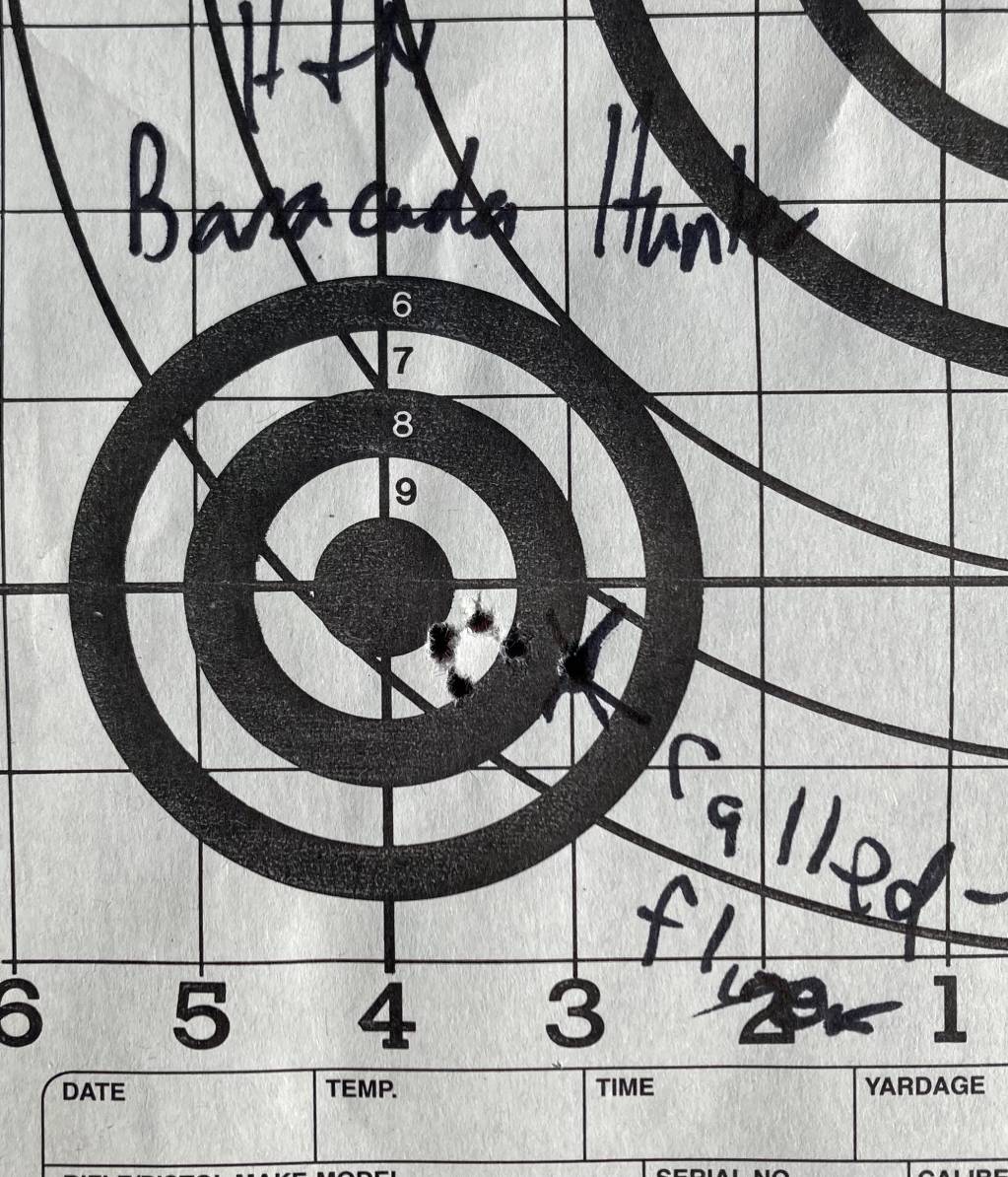

Next up, H&N Barracuda Hunter and JSB Hades. These results had my adrenaline pumping! It was all I could do to mitigate my heartbeat for these shots.
Barracuda Hunters, just a smidge over an inch center to center at 50 yards. This might be the one.
JSB Hades, about the same results. This group is a shade bigger than the Barracuda Hunters group, but the flier might be the wind or it might just be me. If so, the edge would go to the JSB’s, but regardless that is less than 1 1/4” including the outlier.
For now I decided to settle on the Barracuda Hunters. Mostly because they have a screw on lid vs the JSB Hades that came open in my range bag.

Side note- I re-zeroed at 25 yards with the Barracuda Hunters and shot a 50 yard group to determine holdover. Barracuda hunters drop 3” at 50 yards, vs considerably lighter Crosman Hollowpoints that drop 4”.

The very first 5 shots hit about 1 3/4” low at 25 yards. That is a 3” target on there, those “first 5 shots”. Brand new scope, I did not check to see if it was optically centered when I mounted it but I would not call that droop.
