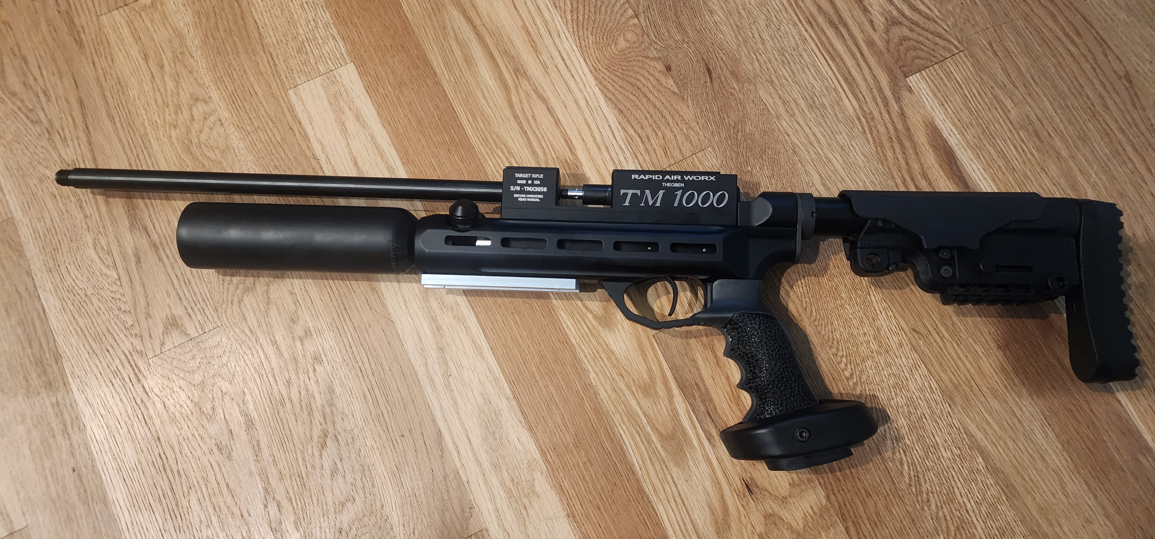

RAW Rapid Brand New RAW TM1000 for Rifle and Pistol multi-use platform.
I just received my new tm1000 from Rapid air worx.
When I received the gun it was set up for 12.1 FPE all I had to do was back off the hammer spring a half a turn to bring it where I needed it. I filled it to 200 bar and shot 36 shots over the chronograph, looking at the pressure gauge I only dropped 25 bar. It appears this gun will get roughly a hundred shots or just under per fill.
It's is a real sweet setup. Just got a scope mounted last night, I made a uit rail for the m lock system, installed some modified dovetail to picatinny adapters and this is almost exactly how I'll be shooting it in competition.
I will be installing a proper butt plate, a kneecup style hamster shelf and one of my magnetic detachable side Wheels on the scope. The scope is the brand new falcon X 505 ft which I will be testing to see if it is something I want to use this season.

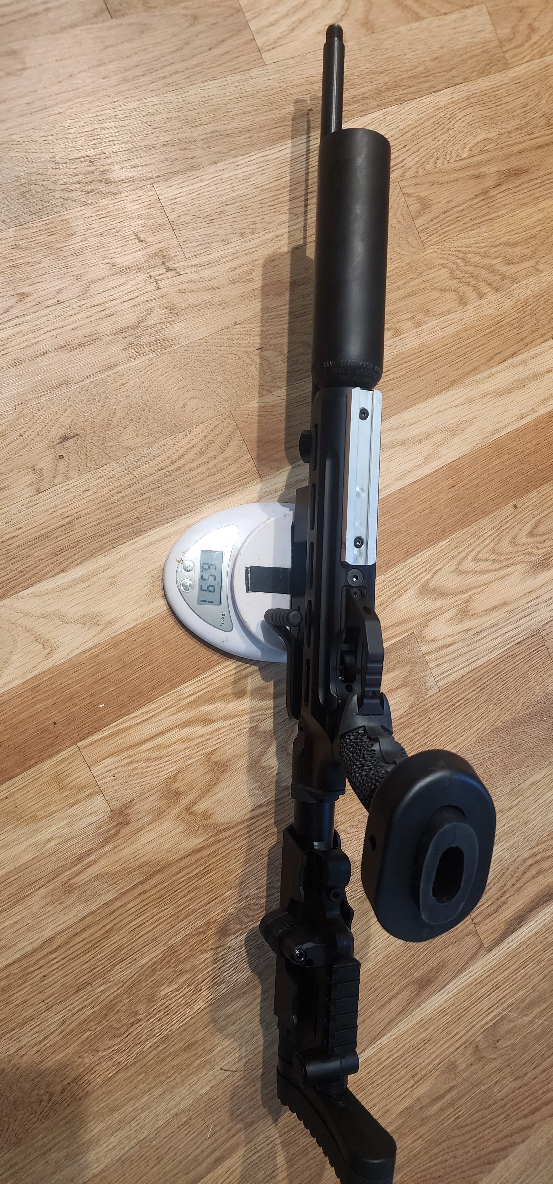

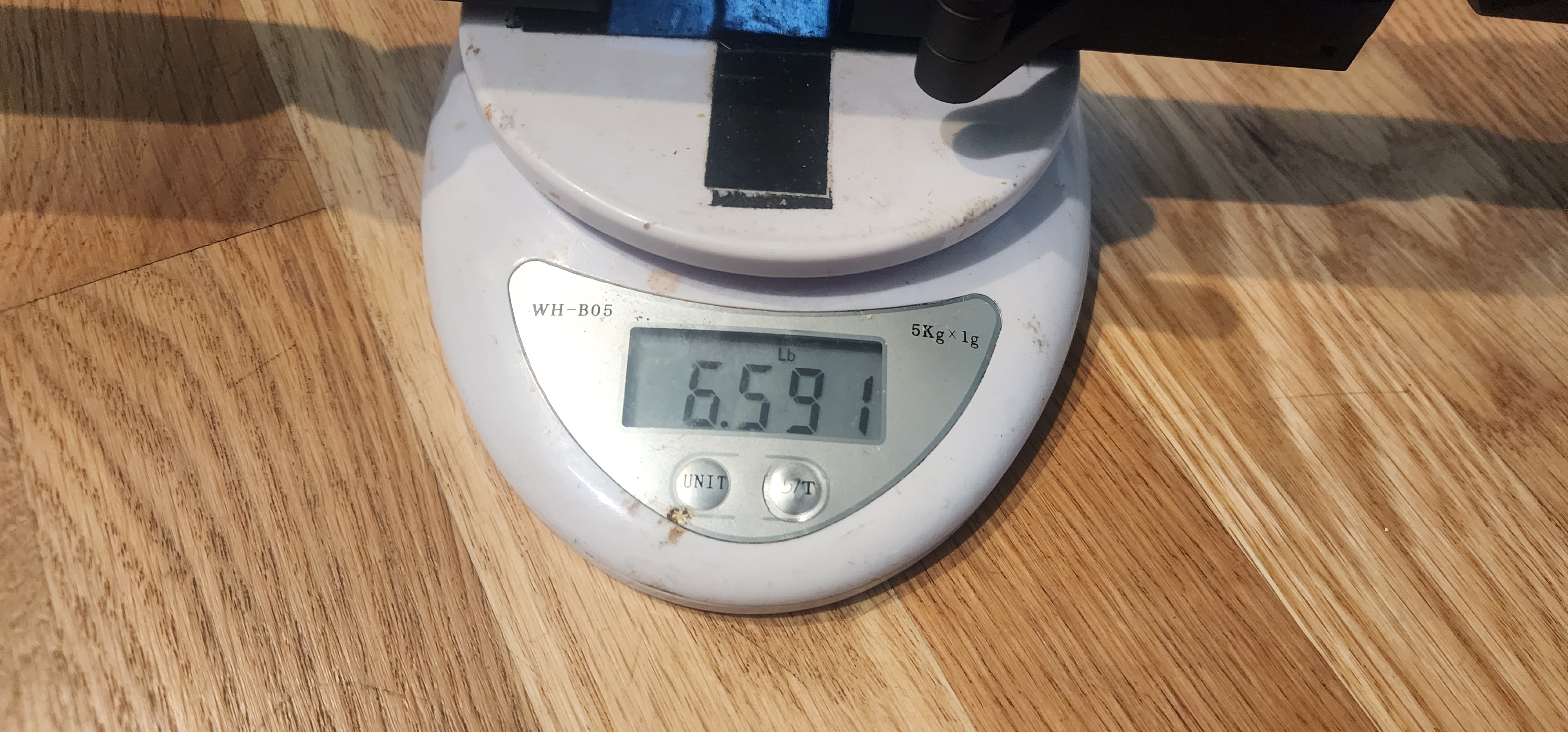

Mostly just curious what the "dry" weight is. No scope, no hamster. So maybe just gun and rear buffer tube stock.
If youve already got the scope zero'd and dope data don't pull it off just to weigh it though. I can wait for RAW to release some specs.
Removed the scope, picatinny adapters, hamster and this is what it weighs.
I left my uit rail installed. So shave off about 1.5oz from that total weight.

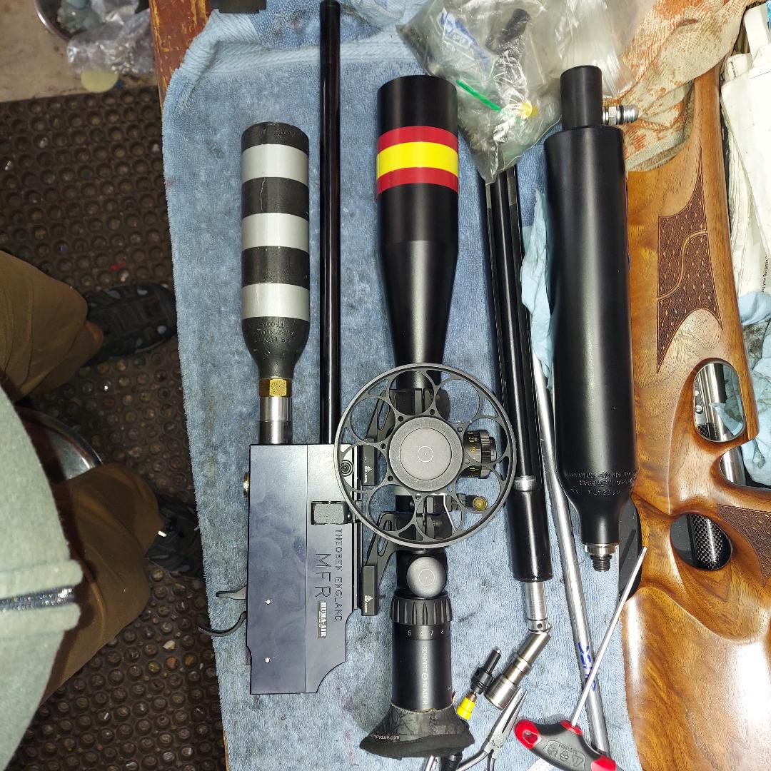

Worked on the THEOBEN MFR action yesterday. Changed out the valve/poppet, LW hammer & SSG devise.
With the LW hammer a tad over 12 fpe, factory hammer tho keeping the same SSG makes @ 21 fpe *** So yes with just a hammer swap we can hit BOTH 12 & 20 fpe power levels, tho not sure I want to being the tune being correct is a compromise for either. :unsure:
200cc BSA R-10 bottle, got a V fill/gauge manifold on order with RAW. OEM Theoben .177 barrel shortened to a tad under 15"
Some nice glass on top and we can do Pistol FT / WFTF rifle / Hunter Rifle once I get it into a RAW Chassis 🥰
